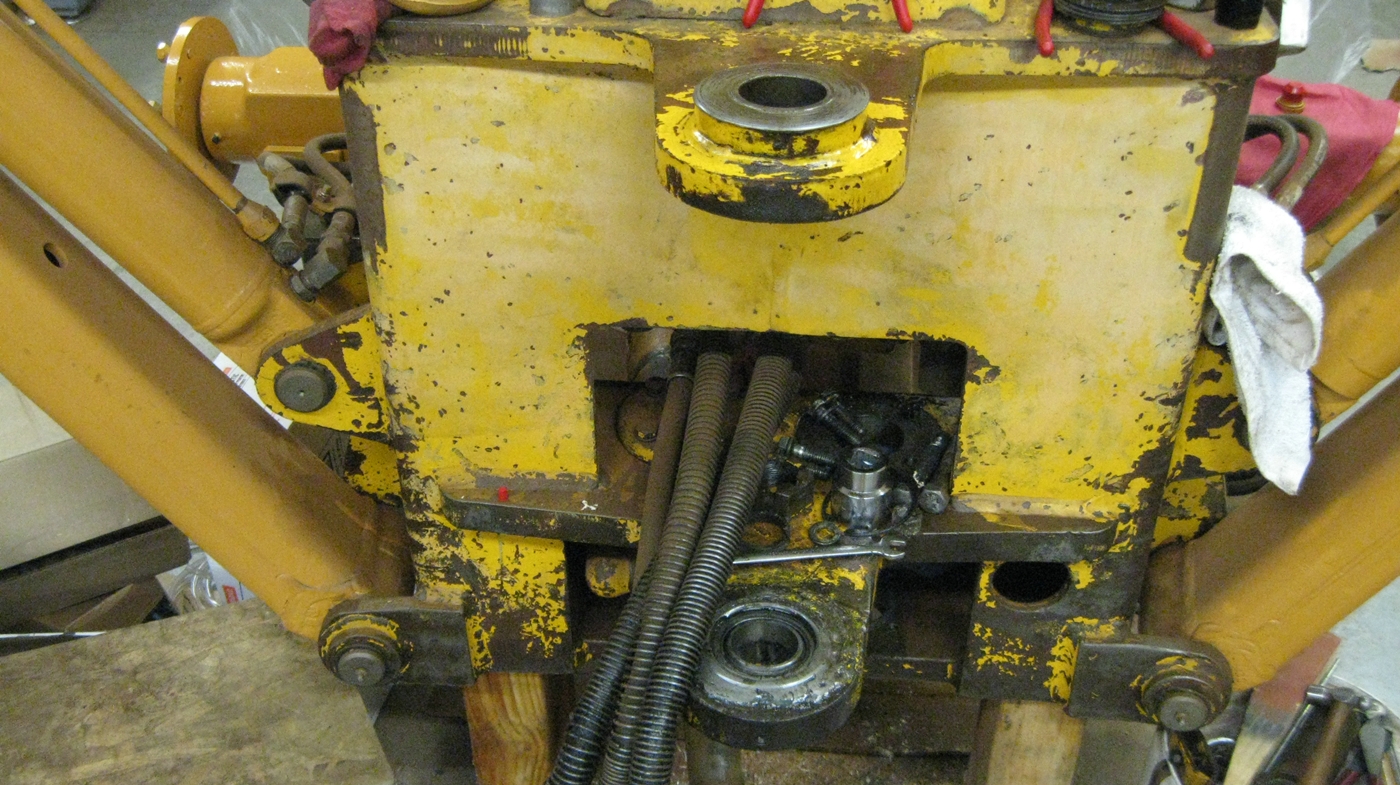

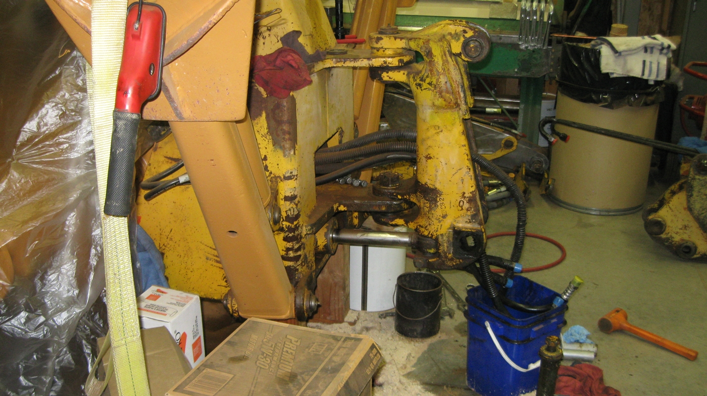

Hi Dean,
I知 back, a little late however, but here痴 a stab at answering your questions:
You asked; 電o you have any advice for getting to the connections between the Bucket's Hose Connections to the Hard Lines at the base of the Lower Boom?
Well Dean, I had a little easier condition to replace my hoses than you are dealing with, first, my whole #32 hoe assembly was torn down and apart which meant I didn稚 have to deal with the adjacent couplings and hoses and I could lay them in one layer at a time, that made it easier to deal with the particular ones that you are asking about. I致e included some pictures that I took at the time to show you how they lay in clean and fresh painted condition. You have to have the hoses loose from the boom to get a wrench into position to really loosen or tighten them correctly. There are clamps that hold each pair of hoses, boom, dipper (some refer to this as the stick or crowd also), and bucket. I had to fabricate a separator clamp for the hoses at the rear of the tower to help hold the hoses in position and that does help in keeping the hoses separated as well as keeping them from chaffing. Mine was missing when I restored my 530. As to my advice, if it were my machine and in an already existing assembled condition, I would drop the boom, take the clamps off of all the hoses so that you can pry them away from each other, then you can get to each fitting with a wrench to exert enough force to both loosen then tighten them later with new hoses. I think a guy would just have a terrible time trying to thread on the fitting while it is still being held by a clamp. Also, I never had good luck using crows feet wrenches on my fittings, they never would allow me to apply the necessary force to undo or properly tighten the connections. Maybe you値l have better luck than me but for my money I had to have the ability to get on the flats of those fittings with an end wrench.
Right hand dipper hard line and flex line.
Left hand dipper hard line and flex line.
Outer lines (dipper) inner lines (bucket)
At bottom center of picture you can see bucket goose neck hard lines and flex lines.
All hoses to show the stack, bottom hoses are connected to the dipper lines, the middle lines in the stack connect to the bucket lines and top stack connect to the boom.
Just another shot of the hose layout.
I include this picture to show how the stack of lines looks as they pass through the clamp.
Here is the pattern and bar stock that I fabricated my hose clamp from.

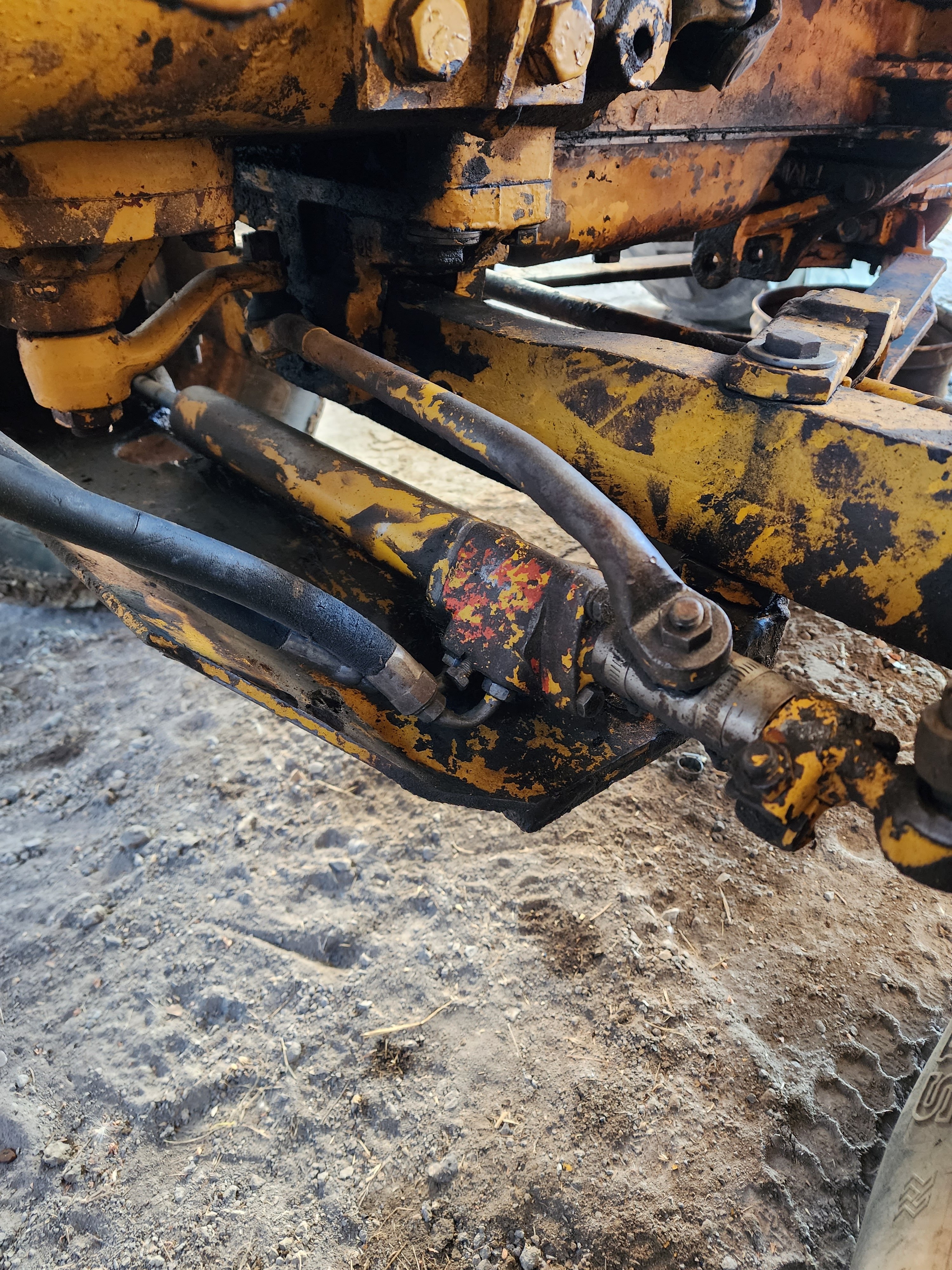

Did you ever figure out the power steering? I picked up a 530ck Backhoe as well, and the wheel is almost impossible to turn. Certainly seems like something is binding up, and the power steering definitely isn't working.
I'm trying to find some issue on the single cylinder power steering system, and like you, can't find much info about it.

Hi NBraun,
Welcome to the forum! Not sure what you mean by: did I get the power steering figured out? I never had trouble with my power steering.... However, another member (mayorbob) asked me if I could help him with figuring out his power steering. He posted pictures of his model and I had never seen that particular type before and could not give him an answer.
Post a picture of what you have and let's see if we can identify what your problem is. If it is like mine, there are really only 4 parts to the system besides the hoses and hard lines and they are: engine driven power steering pump, steering control valve, steering manual pump, and last but not least, steering cylinders. It may be as simple as one of the wheel spindles is bound up in the bearings and a quick test for that is to jack up the front end off the ground, undue both power steering cylinders at the connections to the spindles. If you can move both front wheels manually with the tie rod still connected with no resistance then you have at least isolated the problem to the power steering system and not a mechanical problem with front end.
Also, check your power steering fluid level. If you don't have any fluid or it is too low there won't be any power assist! Post a picture and let's see what you have. Thanks NBraun, good to hear a new voice.......:)

I believe mine is the early steering, with one cylinder on the axle. I checked the fluid level and it was empty. With fluid in the reservoir, the steering has gone from basically impossible to just having to really muscle the wheel. So a bit of an improvement for sure. I'm not sure if I need to bleed the system of air, and if so, how to do that, or if there's something else I'm missing.
The tie rod ends are shot, which I'm sure aren't helping anything. I'm generally pretty handy, but without seeing a diagram of the steering system i'm having a hard time figuring out what to look for next. They really managed to cover up all the systems on this tractor!

I did a little more research on the type of 530 that you have and here is what I found on another forum and this guy seems to know a lot about the 530 and 530CK Cases. Now this information does not directly answer your question about what do about your steering problem, but it will give you more information as to where to start researching your particular model of Case 530. I am just copy and pasting from that forum the response:
1960-1966 Case 530CK
If you just want to get your backhoe home, lift up the loader and put a 4x4 across the front of the hood/loader support, to hold the loader up, then take a couple of chains and come-alongs and pull the hoe up closer to the tractor so it doesn't drag on the ground when you go up the ramps. Then, back your trailer up to the machine and winch (or push) the 'ol girl up on the trailer.
Once you've gotten the loader bucket and hoe bucket off the ground at a reasonable height, if there's air in the tires, she'll roll right up on pretty easy. That's how we've moved dead hoes in the past.
As far as modifying your injection pump, don't. Just leave it as it was - no need to try to add any valves to it, as it's unnecessary. Leave well enough alone and don't add or subtract parts. Just repair what ails it, put it back on, and get your tractor running and operating again, as that's what matters.
I'm curious, but do you know how long your backhoe has been sitting, and more importantly, WHY it was parked?
I ask because you may be in for some more surprises if and when you get it up and running!
Based on your pictures and Serial Number that you posted, YES, that is a "true" 530CK that you have there.

That style of steering was used on utility and loader-tractor loader backhoes until sometime in 1964 when they changed to hydro-static steering with the twin cylinders
I hope this help you with your research NBrawn, cheers👍

Iv got a 1962 case 530ag with the ck backhoe setup on it i have 2 major problems one I can't find the right steering assist ram hear is a picture of the one I have the other problem is it's a shuttle shift I'm not sure of my problem but it won't fully engage or disengage if you have any suggestions on wear to look to fix that or any idea wear to get the steering ram i would appreciate it look forward to watching the progress on yours
Thank you for your time
