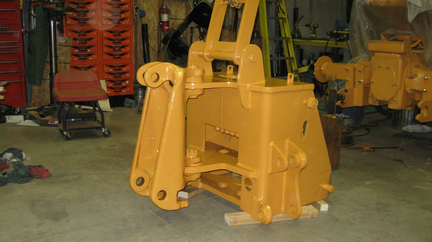

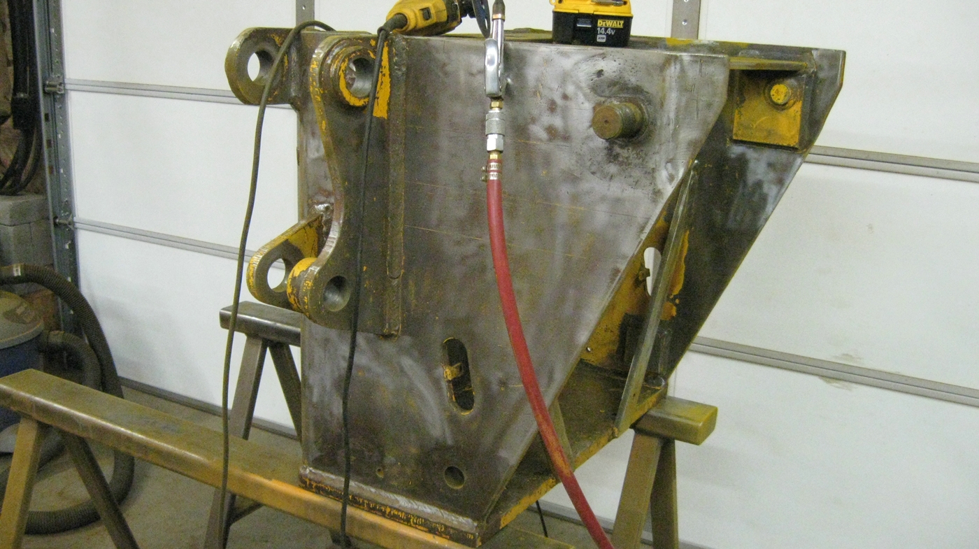

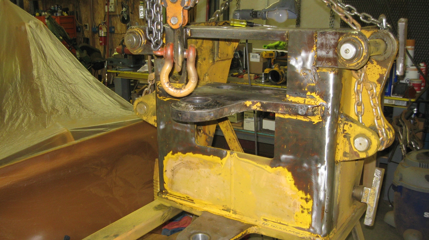

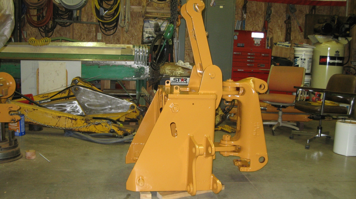

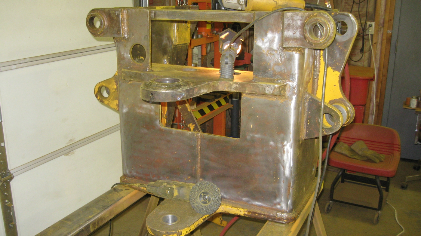

Here are some pictures of the backhoe main frame housing; cleaning, prepping and painting.... My overhead crane was really indispensable for this part of the restore. The metal is so thick and massive that you just can't maneuver it for all the operations that I needed to do, without an ability to lift, swing, tip the part.
This is a shot of the housing upside down and I was stripping paint, chasing threads and prepping for later welding.
Most of the paint off the sides, then lacquer thinner was applied by rag, to clean any remaining grease and paint dust off. I used these really neat paint removing disks on my 4 1/2" angle grinder. For me, it was less messy than liquid paint remover and faster to remove paint and rust.
Just a shot of the right side and still upside down.

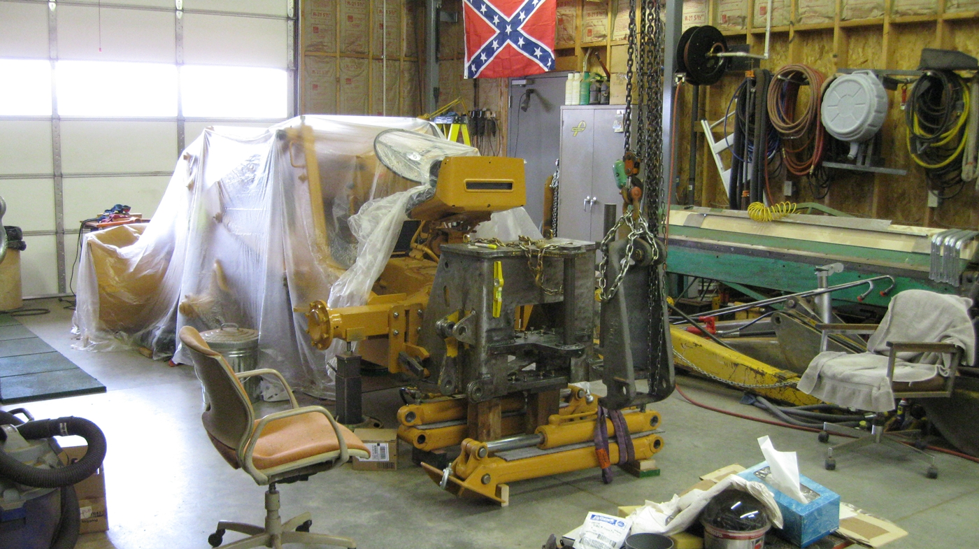

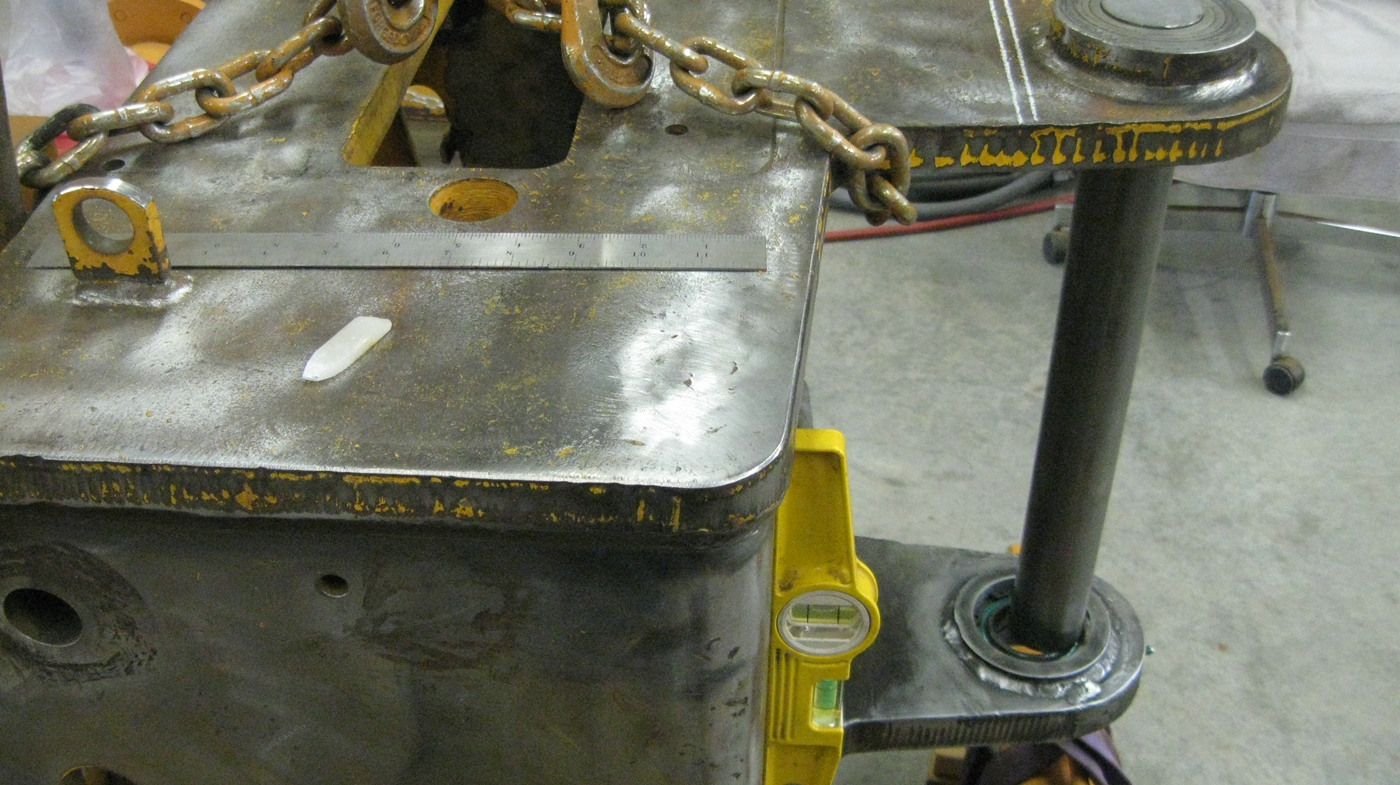

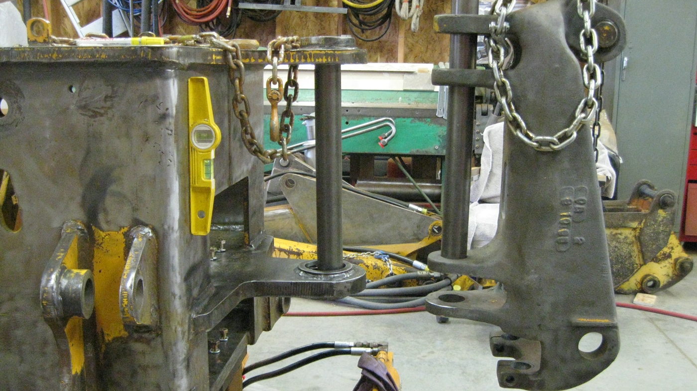

Ok, I now have the housing cleaned up and back over behind the tractor, and checking the alignment of the two bores that connect with the tower. Somehow, the upper flat had been bent up and by using a solid straight piece of round 2"bar I was able to see the problem. The lines on the flat shows where I had to heat it, then bend it down for the final alignment. Man that thick iron soaked up the heat. I turned up my largest rose bud tip and it took a long time to get it to a bendable temperature.
This one shows how much it was off. The bottom (self-aligning) bushing was in it's housing and 2'' round bar was about 1/2" off of the bore. I have no idea how you bend an over 1" thick flat stock. It's just that after installing all the new bushings nothing would line up, which means that there was an awful lot of play in all of my connection and now I know why everything was so loose!
This one is just for perspective, show how I was using the crane to align parts.

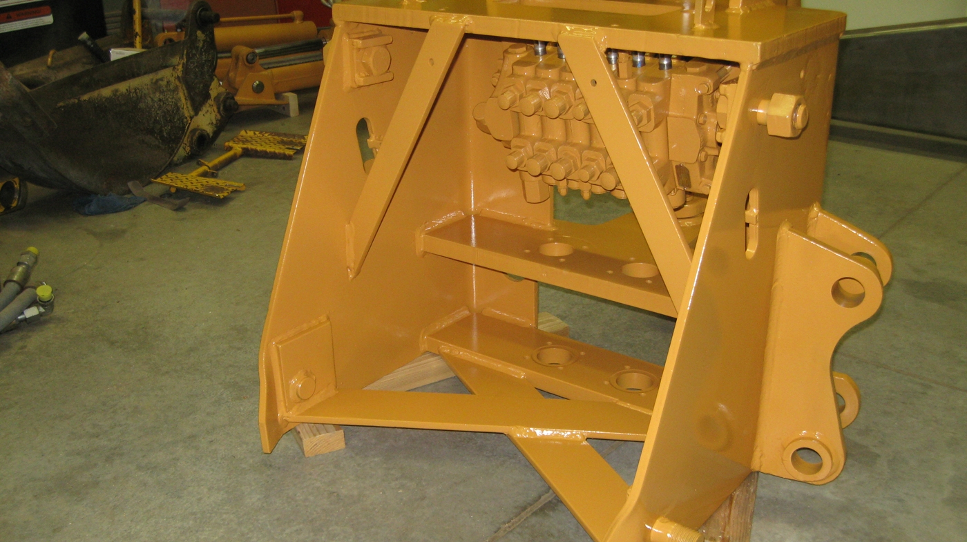

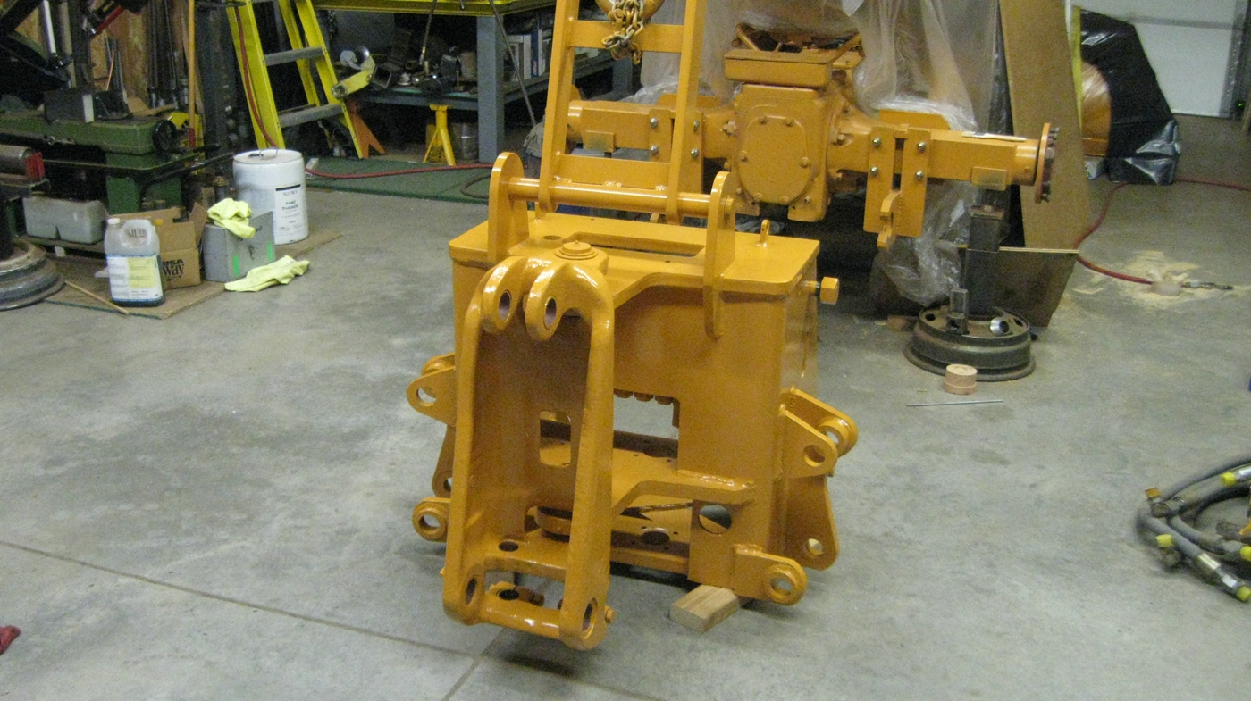

Got the valve body cleaned, painted and bolted up, ready for the levers.
This is a good angle of the boom holder that I designed and fabricated. It really came in handy as a crane connection for moving this part around. It made it so that I didn't have to scratch paint with my lifting chains as I was positioning the heavy thing.
This picture is just showing it's time to hook it up with the docking bars on the tractor.

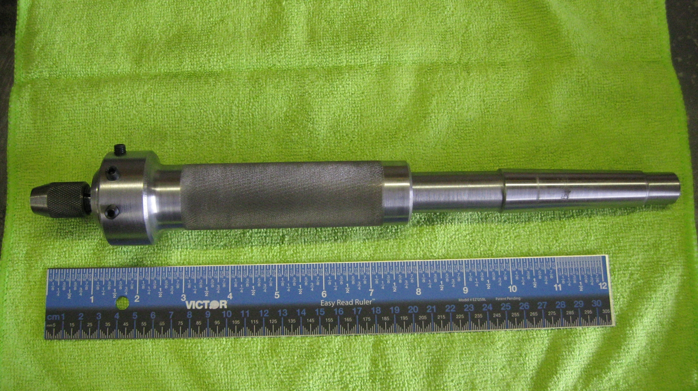

I thought maybe I would include a post on one of the tools that I machined to help me with my threading. As I got into this project I found that I needed more than one threaded rod, so out of necessity I made this. I was looking all around the internet and found several designs for threading rod stock. Kind of copied the principal from a site that was selling them complete, but since I have several different diameters of dies I decided to make my own to accommodate my needs . I had a bunch of round bar of different diameters laying around from extra stock that I was using for pins and so I made the various parts:
This will give you a idea of the size of the rod threader. The main shaft, just North of the ruler, has a taper machined on it to insert into my tailstock on the lathe, which is a #3 Morse taper. The handle and fitting just above the main shaft is what holds either the die or tap. And the last piece above the handle is the adapter for holding the different taps.
The handle is now mated over the main shaft and will slide back and forth for about 5" and still be contained and not fall off the shaft.
Now all of the parts are together so you can see how it is set up when in operation. A guy can then slide the handle with the insert and die into a pre- bored hole mounted in the lathe as it is spinning. You then grasp the handle and hold it while the lathe turns and go as deep as you want until either the depth that you are threading has been reached or until it gets too hard to hold. Just release the handle and it will continue to spin on the main shaft but because it is spinning without resistance now nothing is damaged. You then reverse the lathe, hold onto the handle and back it off until you are completely out of the bore. When you thread a piece of rod, that same principal applies. All you have to remember is to release the handle and you won't get wound up in it. The knurling on the handle helps a lot with oily hands.
Just a final shot to show the inserts (die, tap) that can be used. I can thread anything between 6-32 (all metals) to about 1/2x13 threads both course and fine. I made a hex insert that will hold my metric 6 sided set as well. By the way, I thought you should be aware that hand driven threading only works for 5/16" rod stock and smaller, anything above that I mount a lever into the handle and let the handle ride on my lathe carriage to protect my hands.
