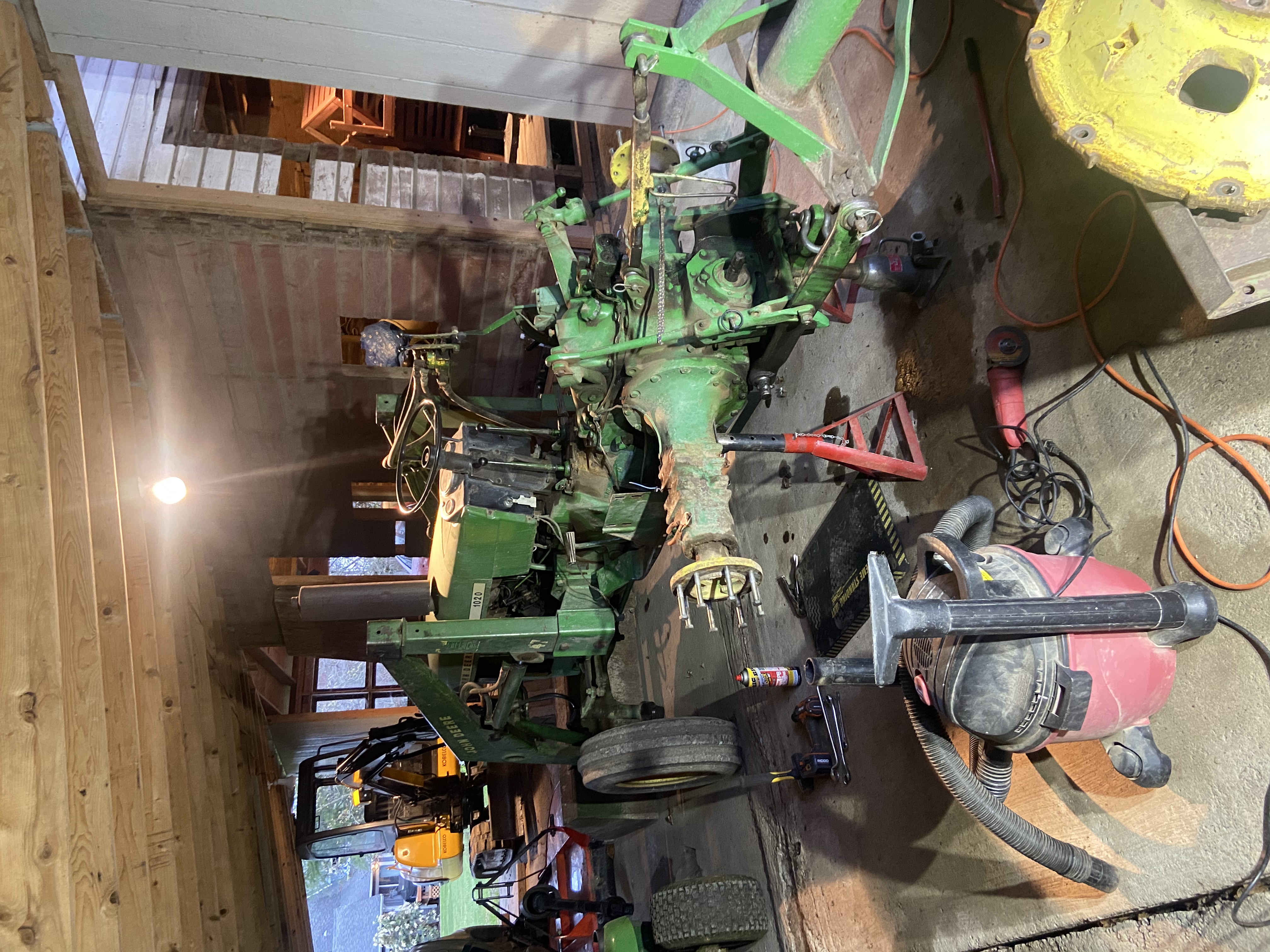

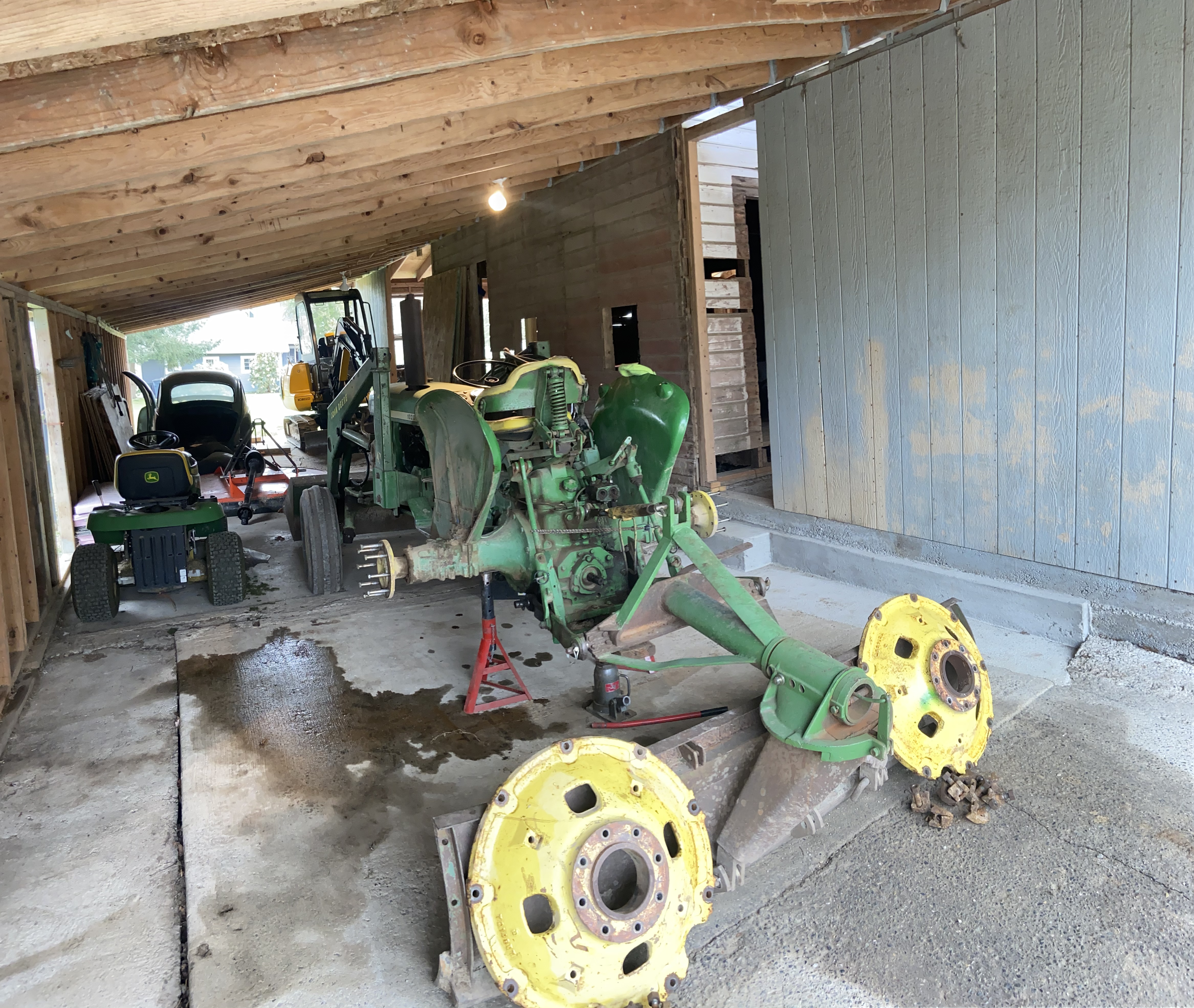

Got it home, jacked it up, and started to tear into it. I was able to remove both rear rims/tires, and separate the inner rims from the outer rim frame/tire. I loaded the two tires/outer rims onto the trailer to get new tires, tubes, and ballast fill.
Well, got to the tire shop, and they stated my outer rims were shot, and I needed two new ones. So that was not something that was great to hear, but as I said, I knew the lack of maintenance, and the fact they were calcium filled, was going to be a problem "one day", well here I am. Honestly, I think even if I had got to replacing the tires and tubes 10 years ago when Dad passed away, the outer rims would still have been non-salvageable, so I would be in the same position I am now, but who really knows.
So, now that I have the tractor on stands with the rear tires off, and the fenders removed, I thought it was time to fix some leaks, and try to fix the 3pt hitch bleeding off with the engine shut down.

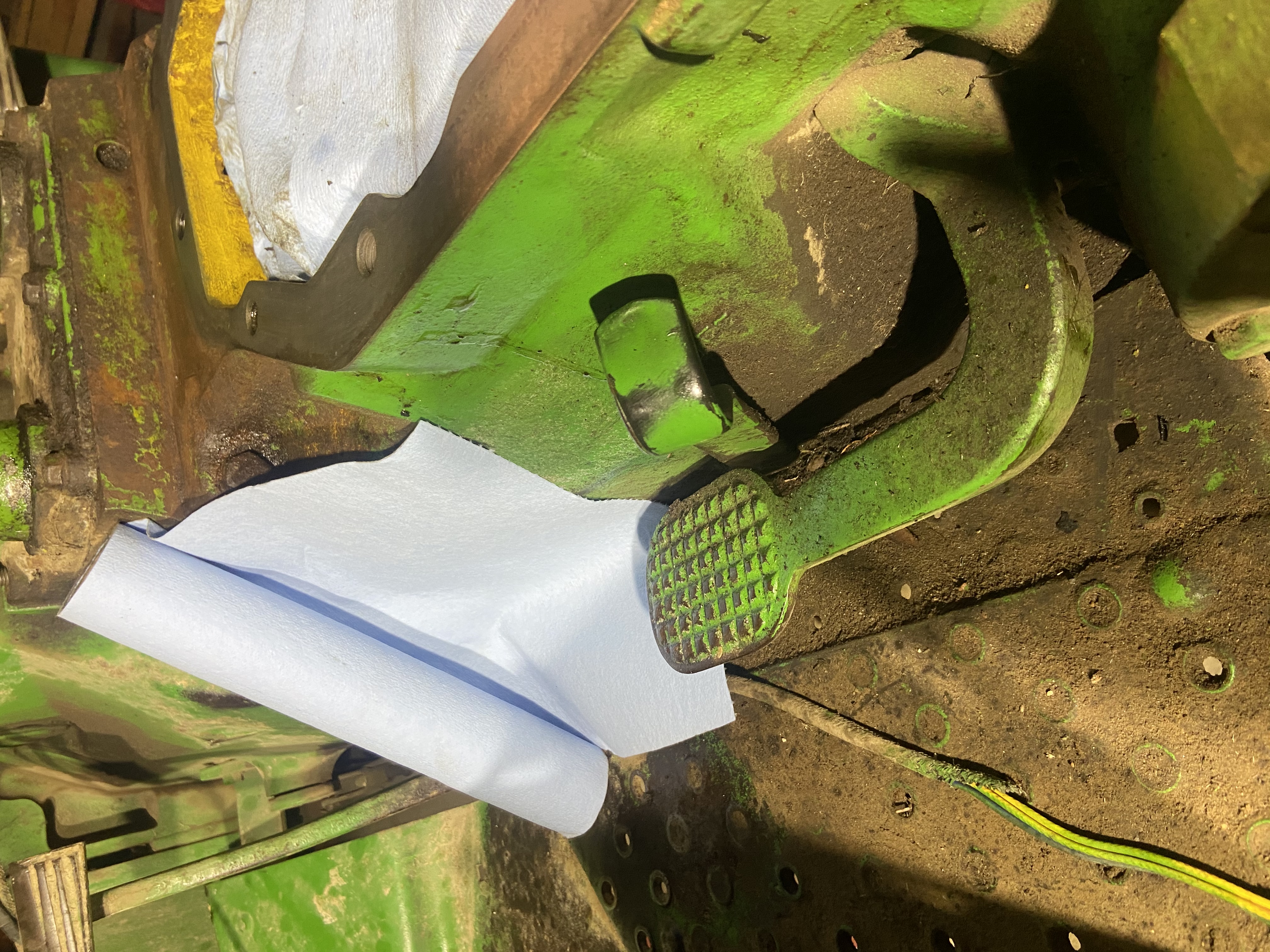

Specific leaks:
1. Drivers side 3pt lift arm drips
2.Drivers side load control shaft drips

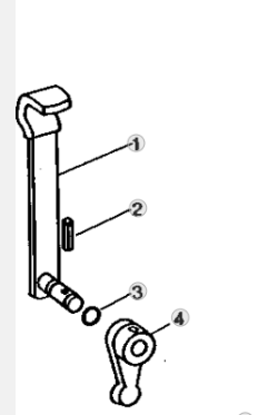

3.Rear PTO engagement lever drips (next to left heel) Can this be changed now that I have the rock shaft housing removed? Or does the tractor have to be split to get at the seal for this lever?

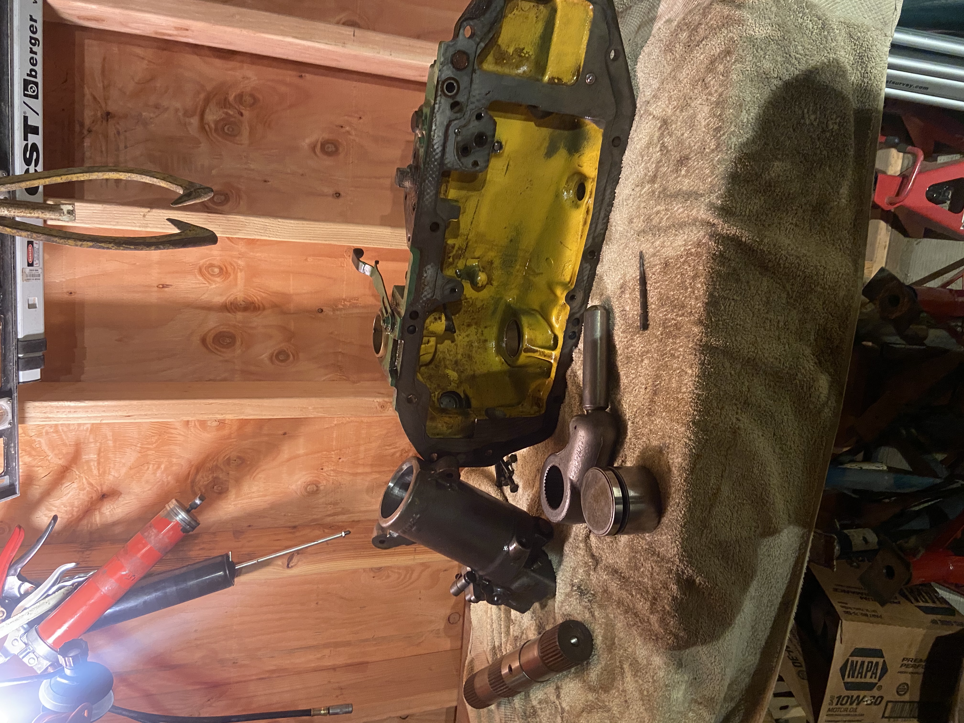

I got my manuals, and started to remove the rock shaft assembly. I was able to remove the rock shaft housing, and started to tear into it.

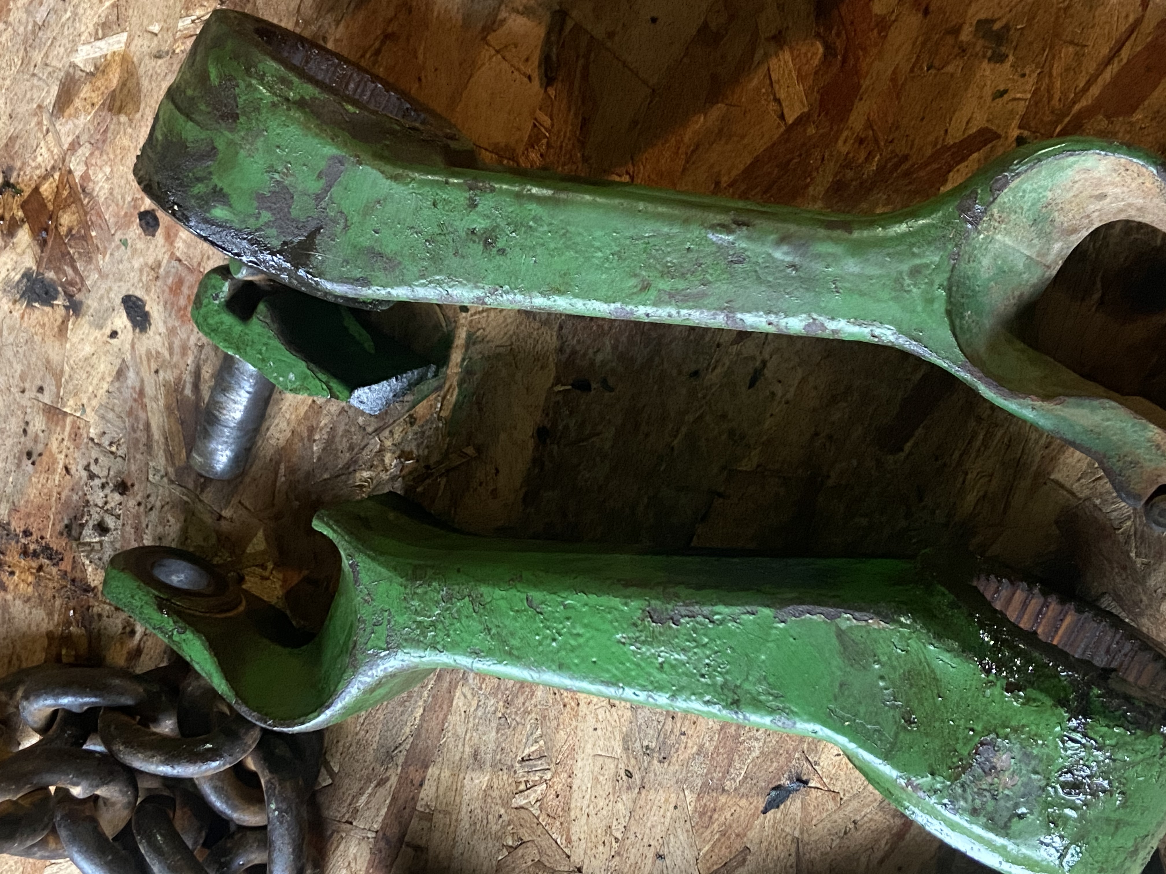

It was real fun beating the living **** out of one of the 3pt lift arms. One just would not come off the splines, and I ended up breaking it.
I then removed the 3pt control lever, and drove out the roll pin so I could remove it from the housing. I then removed the cylinder body from the rock shaft housing, set that all aside and went about removing the rock shaft cam and rock shaft from the housing.

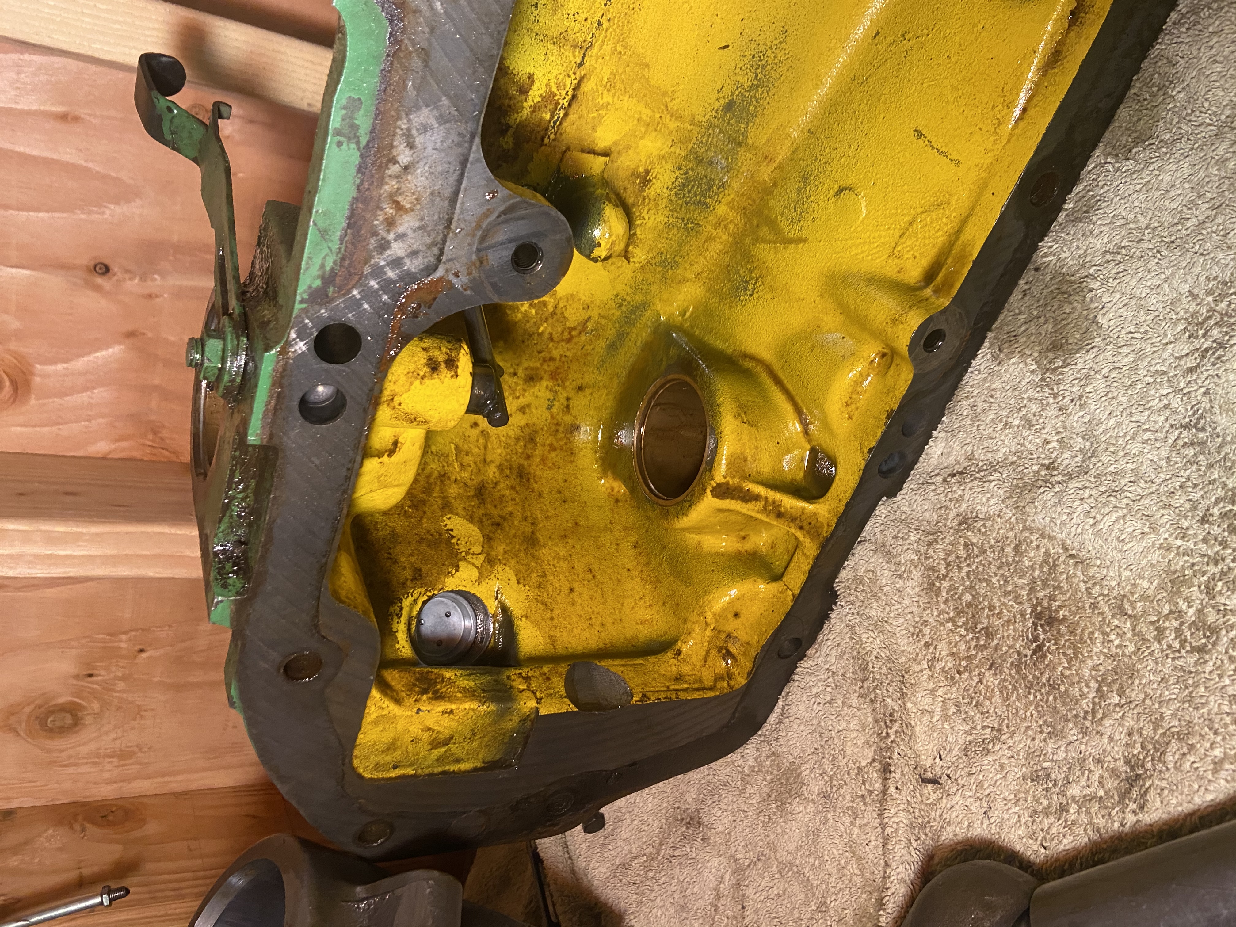

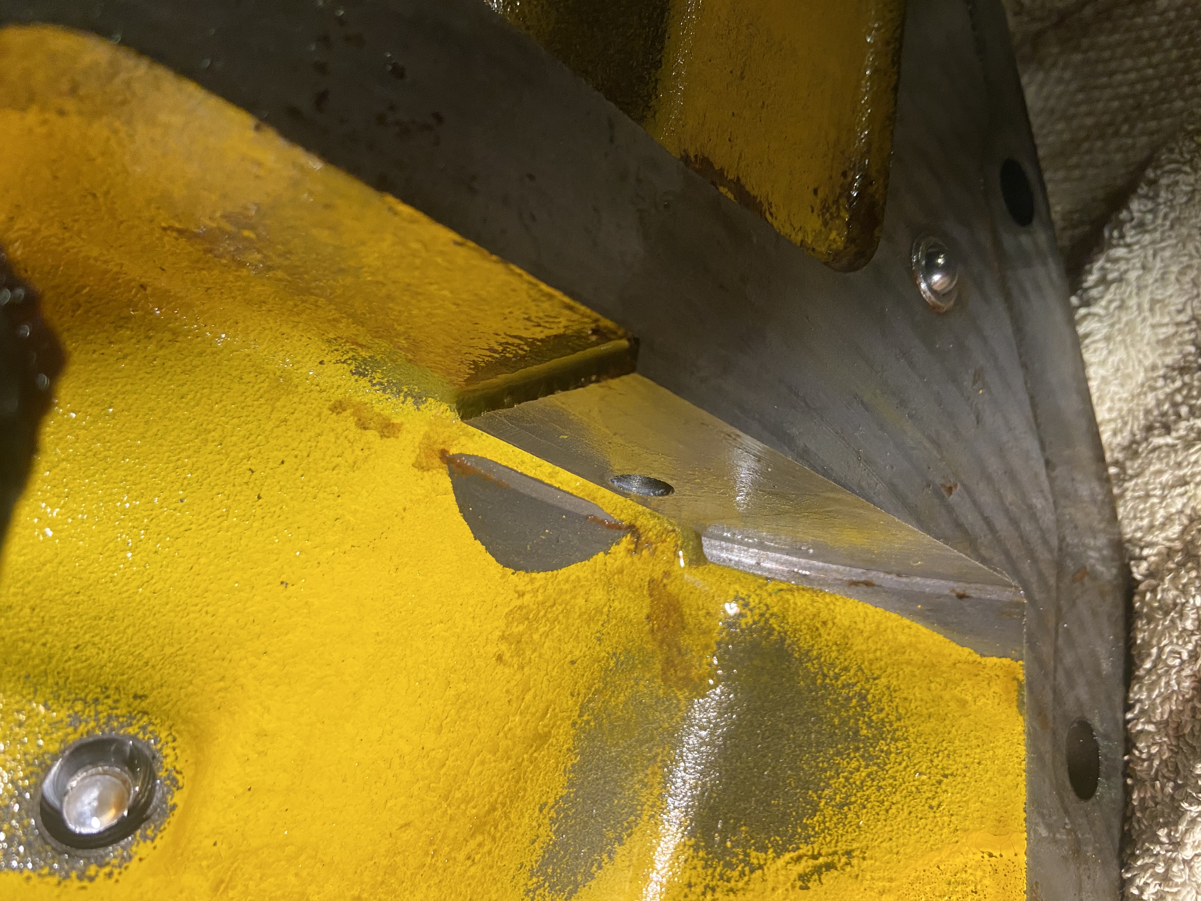

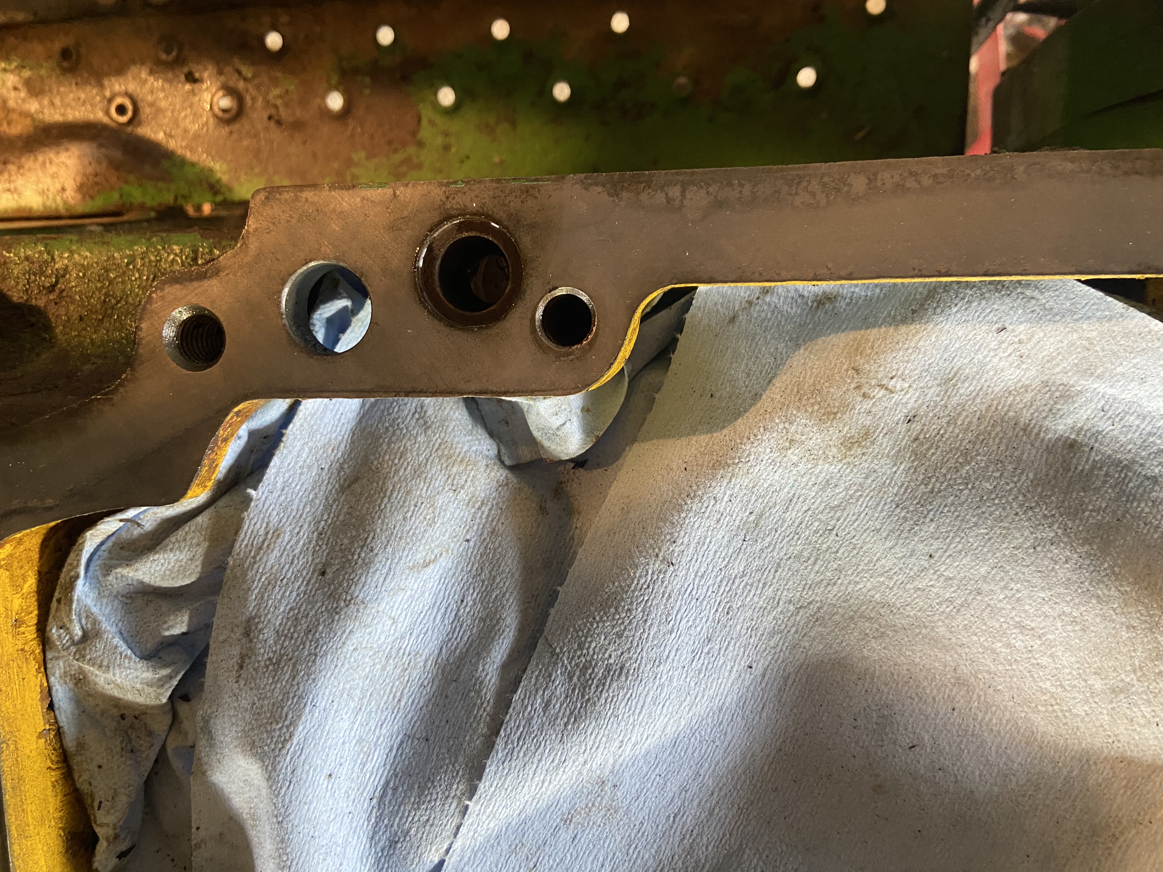

Here is where I am at right now, and it doesn't look good.

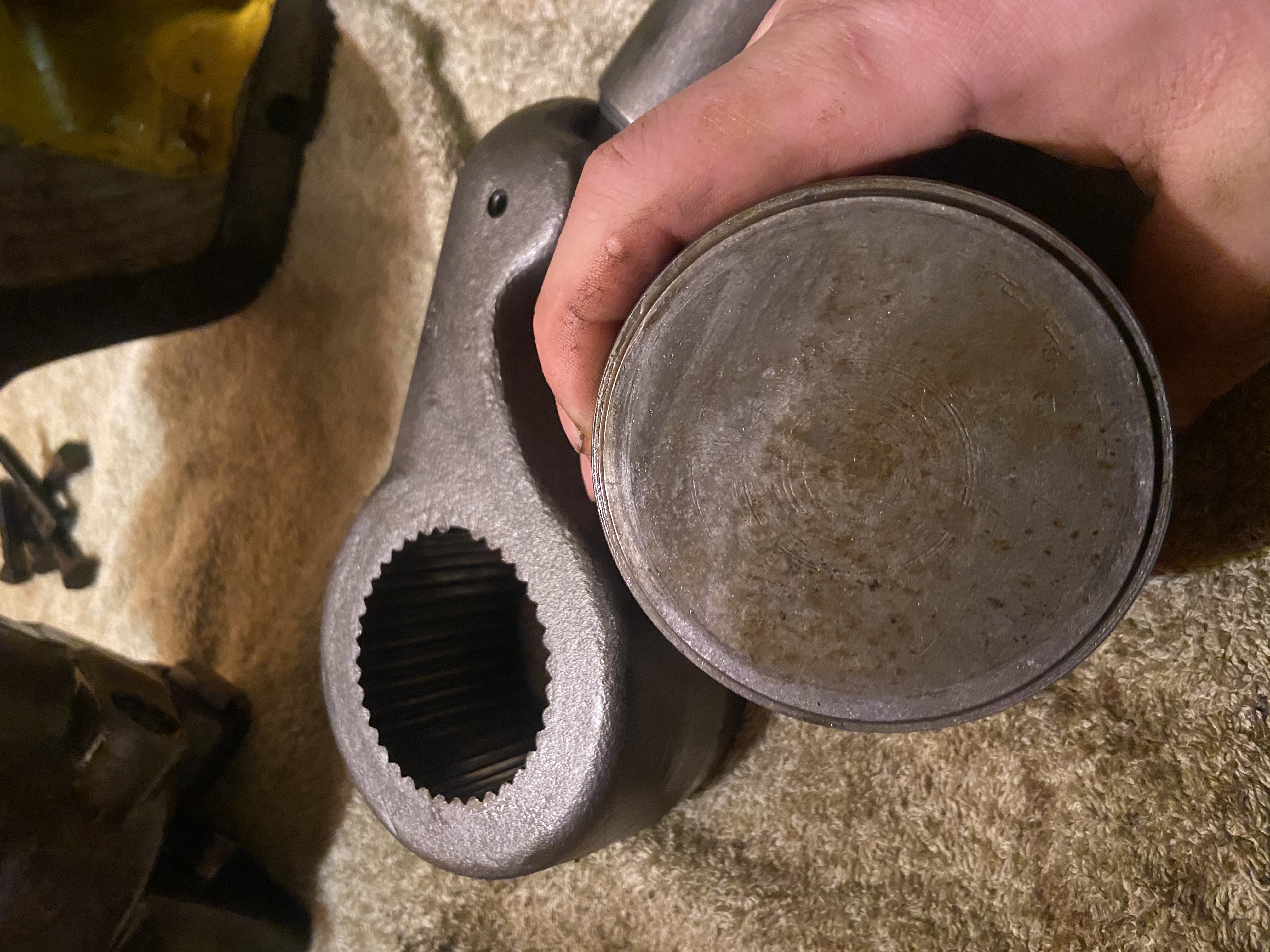

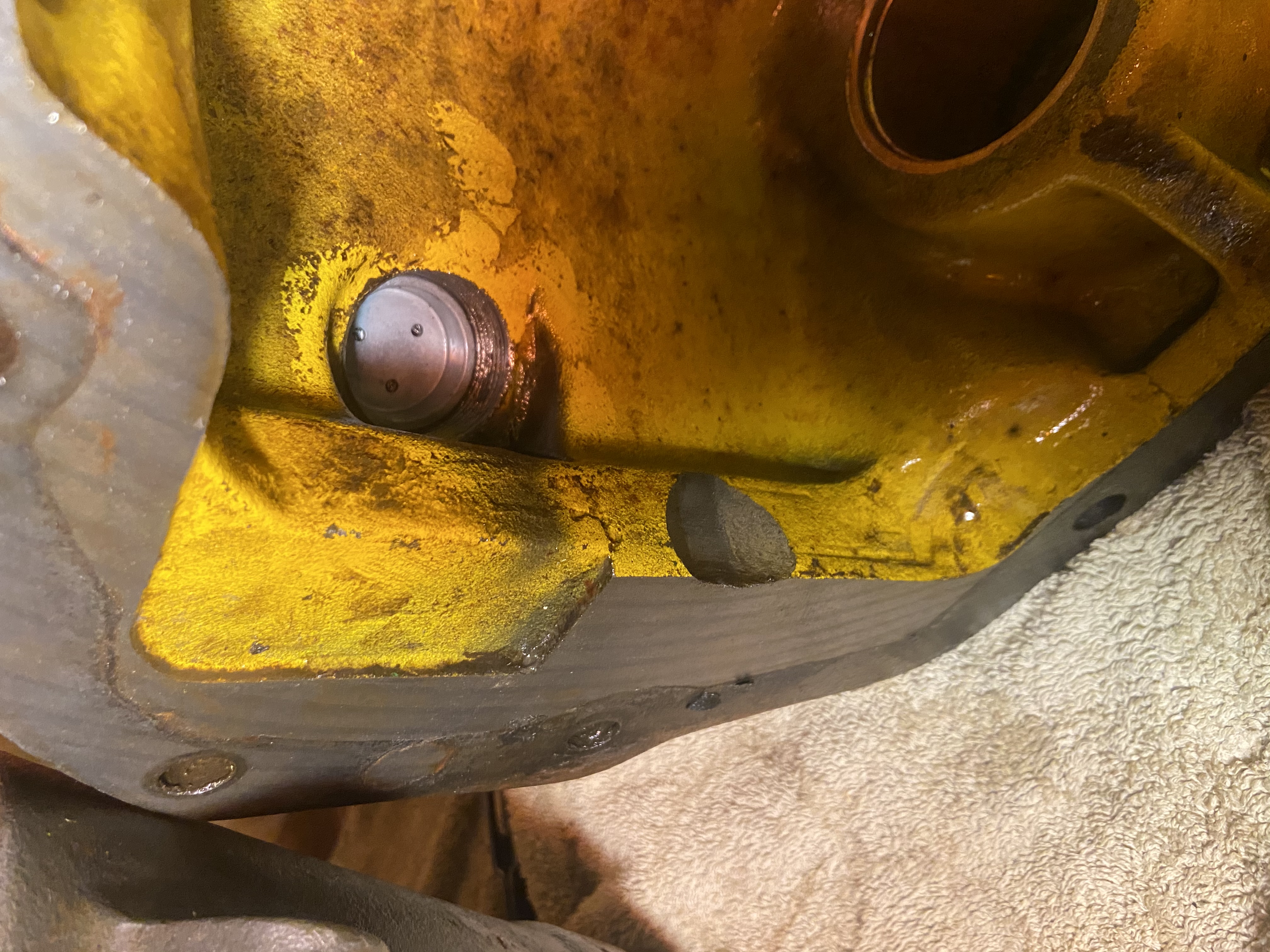

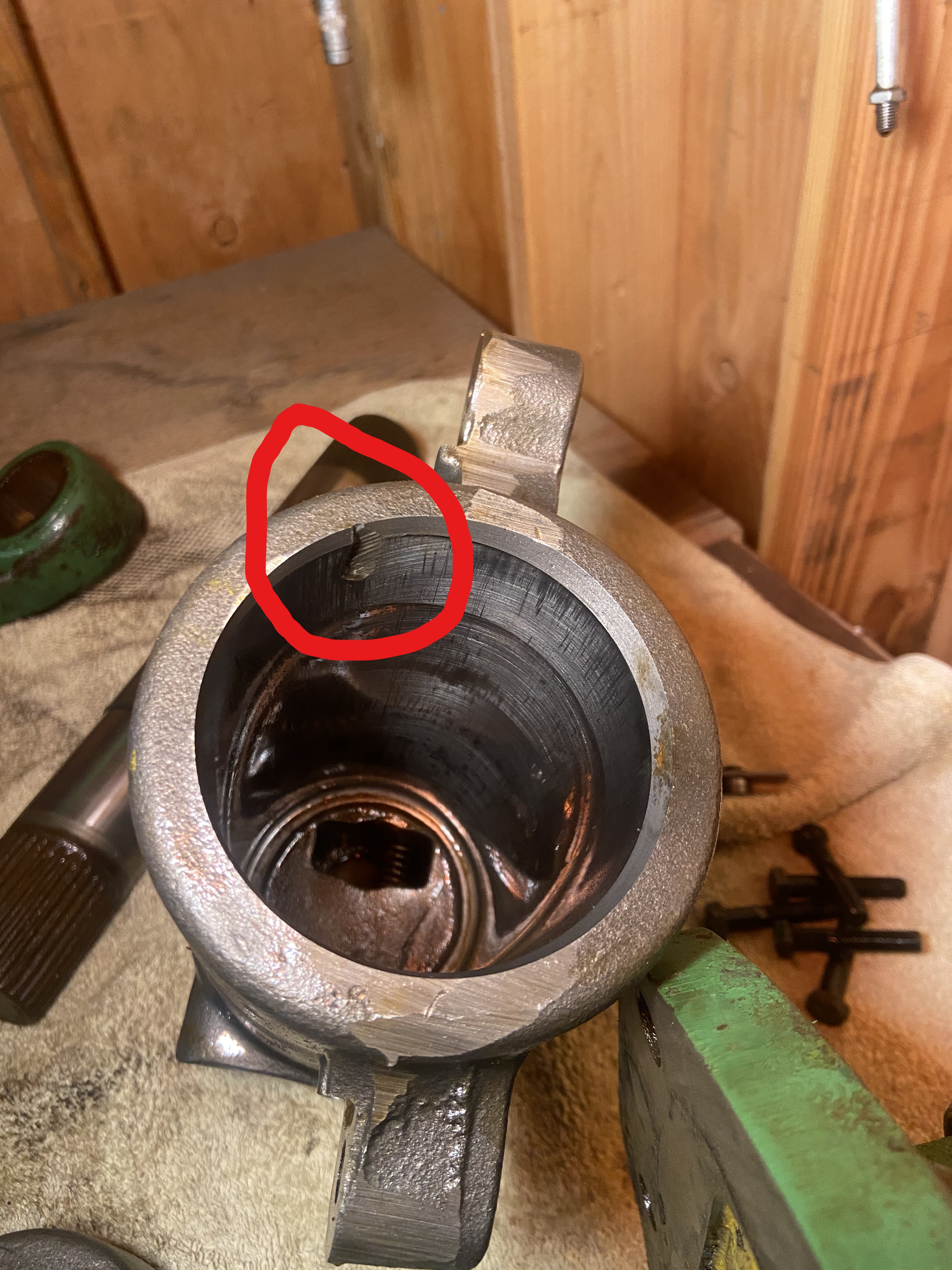

First, I see a chunk missing from the cylinder wall.

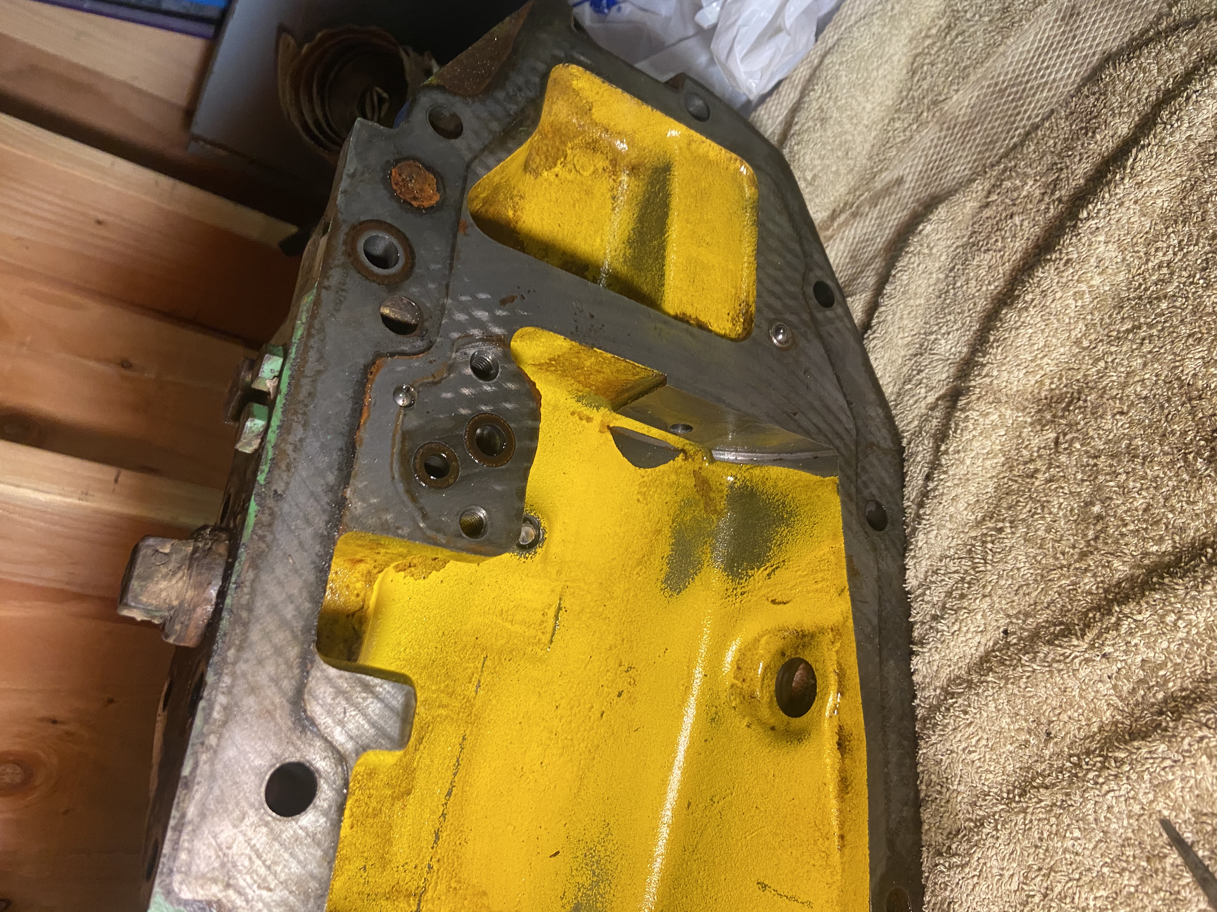

Secondly, I see what looks like wear, or contact on the inner surface of the rock shaft housing? It looks like the cylinder has been over extending maybe, and smashing into the underside of the housing? I don't know, but this definitely doesn't look normal. What would cause this? I have never had a problem using the 3pt other than it would quickly bleed off after shut down?

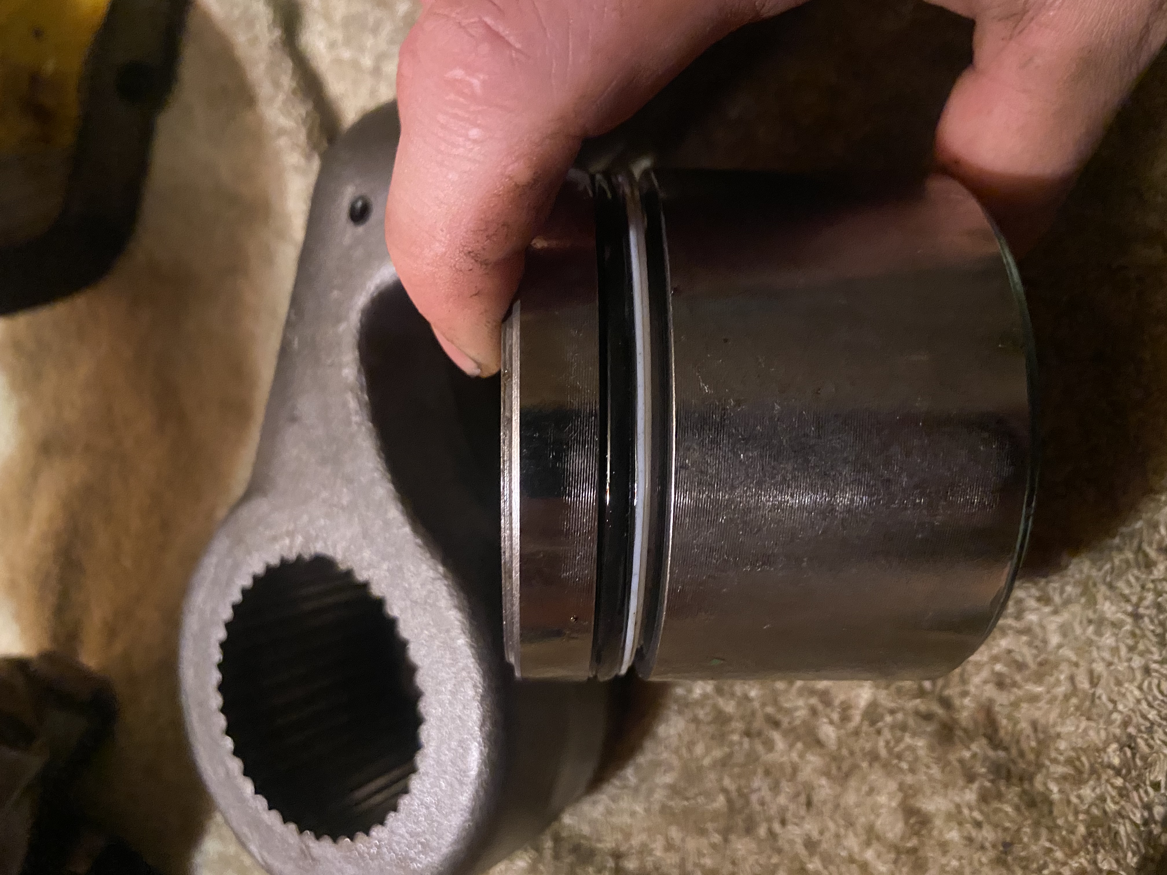

Here are some shots of the piston.

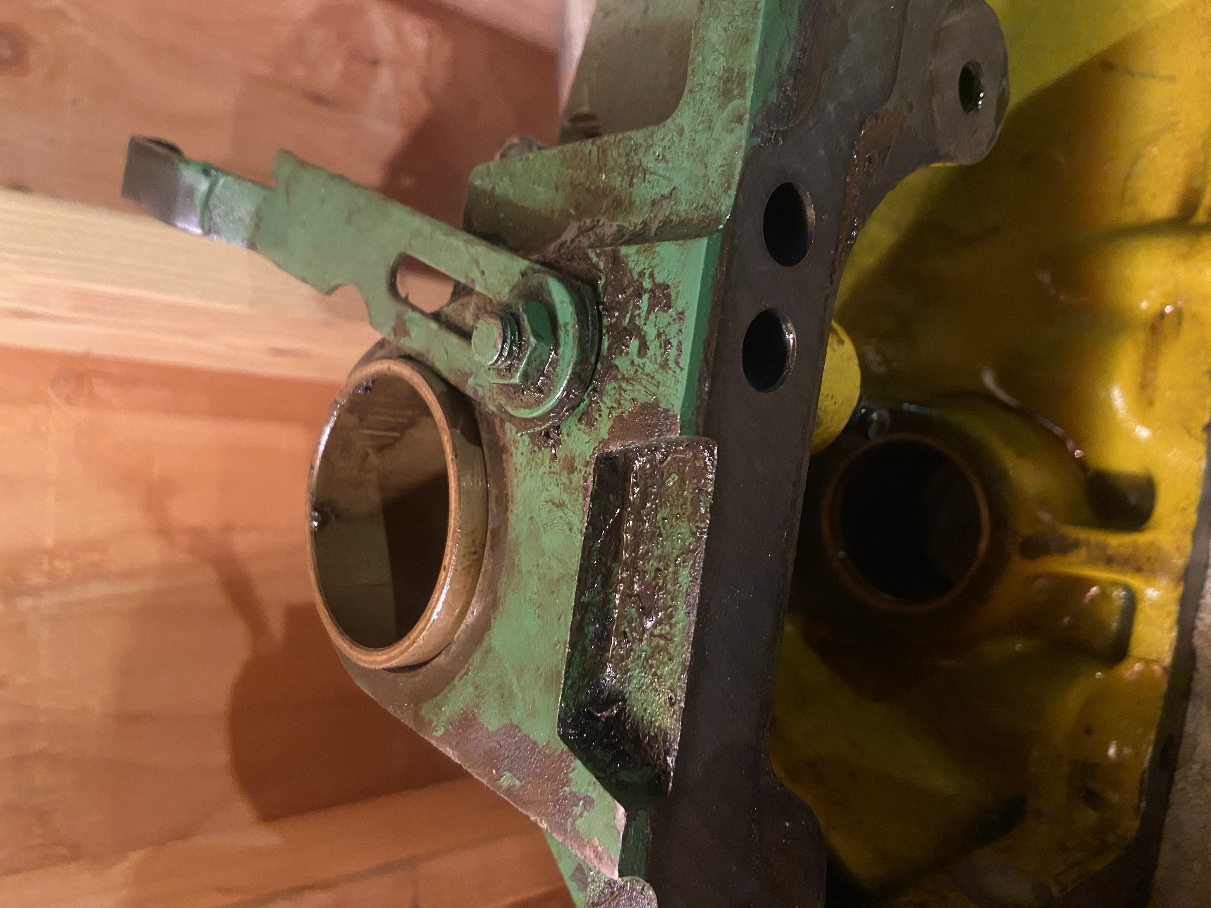

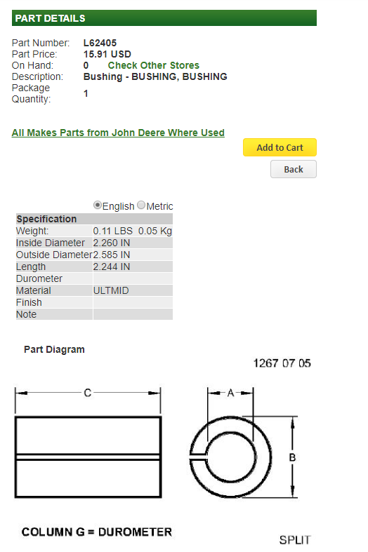

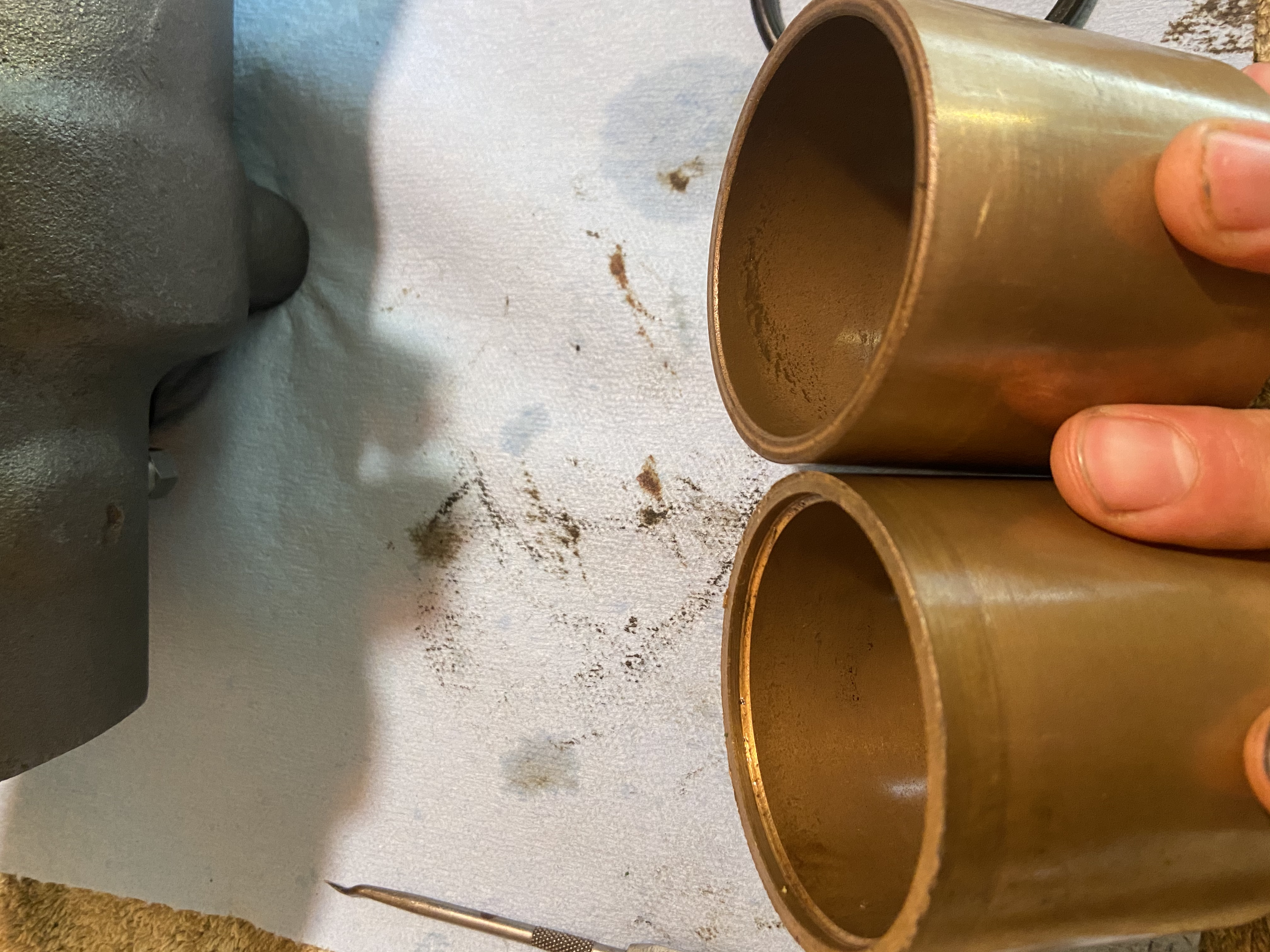

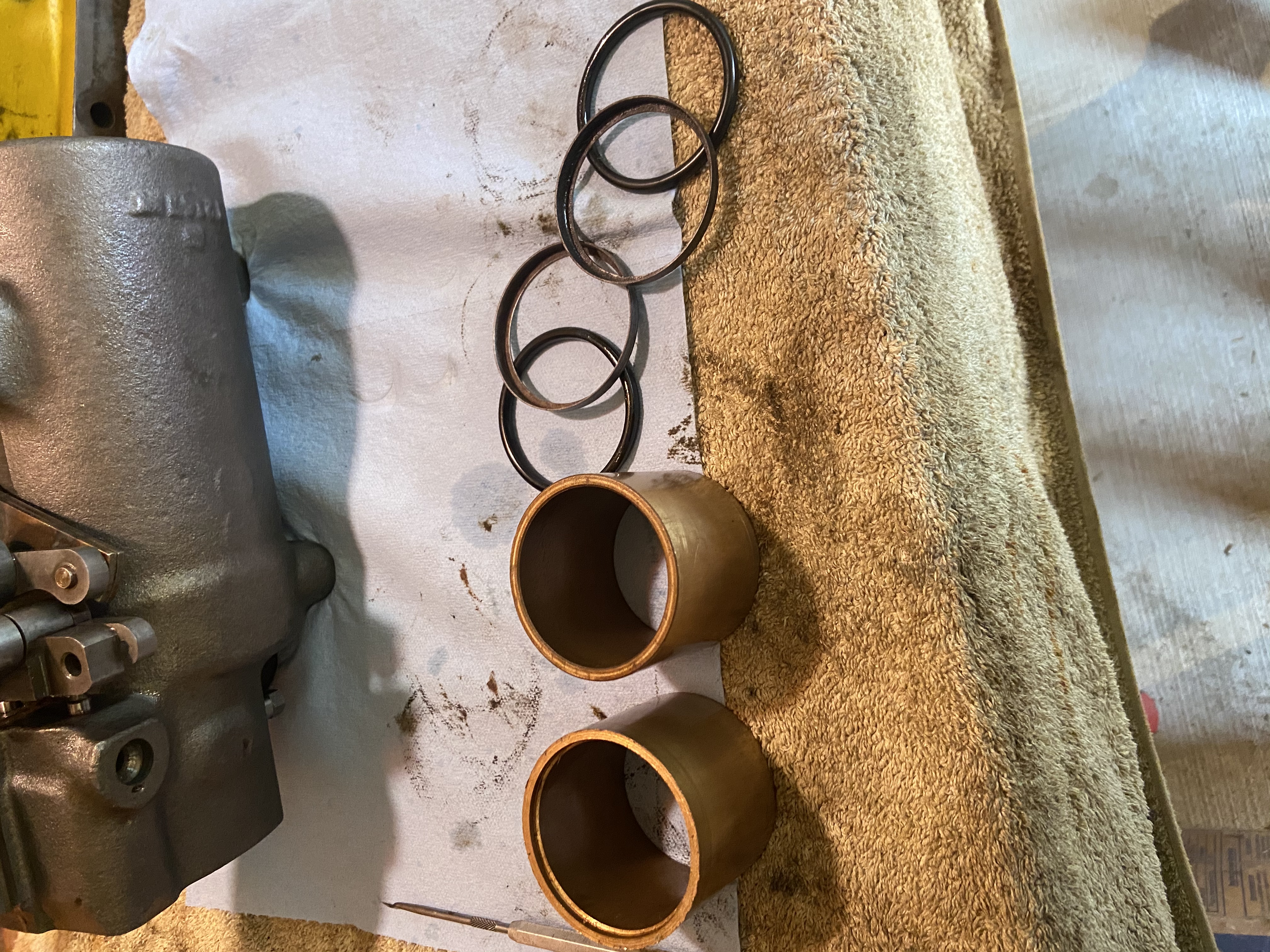

Finally, here is what looks to be one of the brass bushings for the rock shaft. One side it snugly fit into the bore, and this one just falls out with little resistance? What should I do here? Just order a new one?

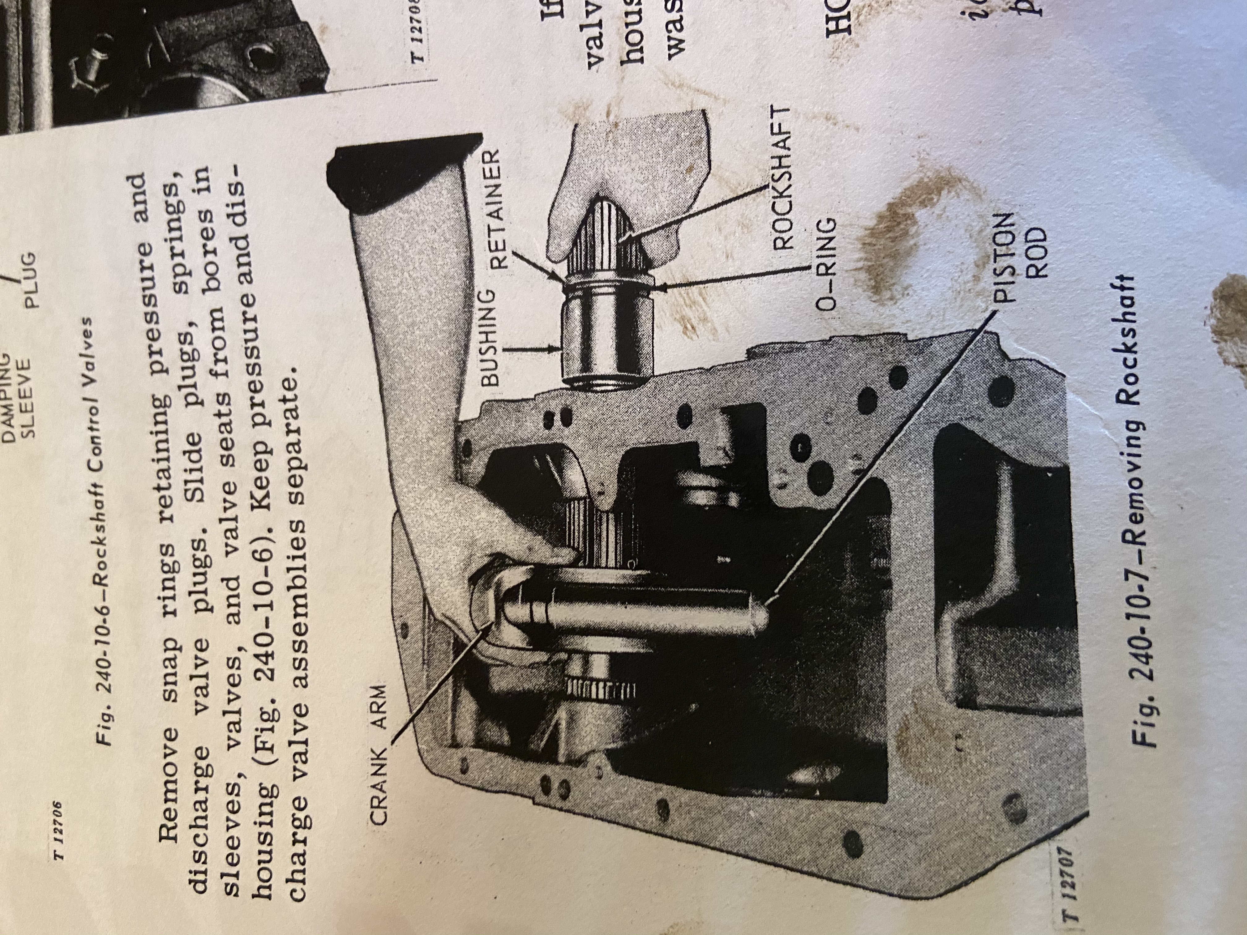

Question 3: Rear PTO engagement lever drips (next to left heel) Can this be changed now that I have the rock shaft housing removed? Or does the tractor have to be split to get at the seal for this lever?
Answer: The groove pin & arm (item 2 & 4) will be very difficult to R&R if trans gears/shafts remain in trans case.
Spec's for rockshaft bushing is shown below. You can measure your tractors RS housing bushing opening to determine if it's within spec's.

Hey Tx Jim. Thanks for getting back to me. I really appreciate it.
I kinda figured that I couldn't get to the PTO lever seal with where I am at right now. Bummer.
What do you think about the cylinder housing? It seems to me that the chunk missing is not in an area of the piston stroke? I don't know though? I looked online to source a new(used) one, and can't find anything? Ideas? Could I possible reuse it, and just put new seals on the piston, call it good? Looks like the piston has a couple white plastic seals, and one big rubber o-ring.
Also, what do you think about the two contact smash/wear points on the inner side of the rock shaft housing? I have read other posts in some forums of people with 1020s that have cracked their housing due to the lift arms going too high, and boom? There was mention of some internal relief valve in the posts that should stop this from happening?

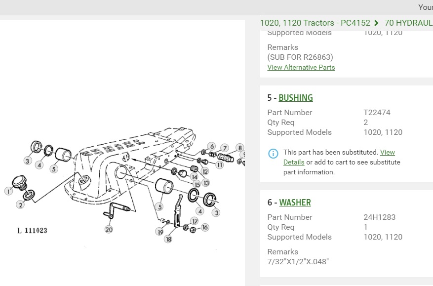

Hey Tx Jim, or anyone from the community,

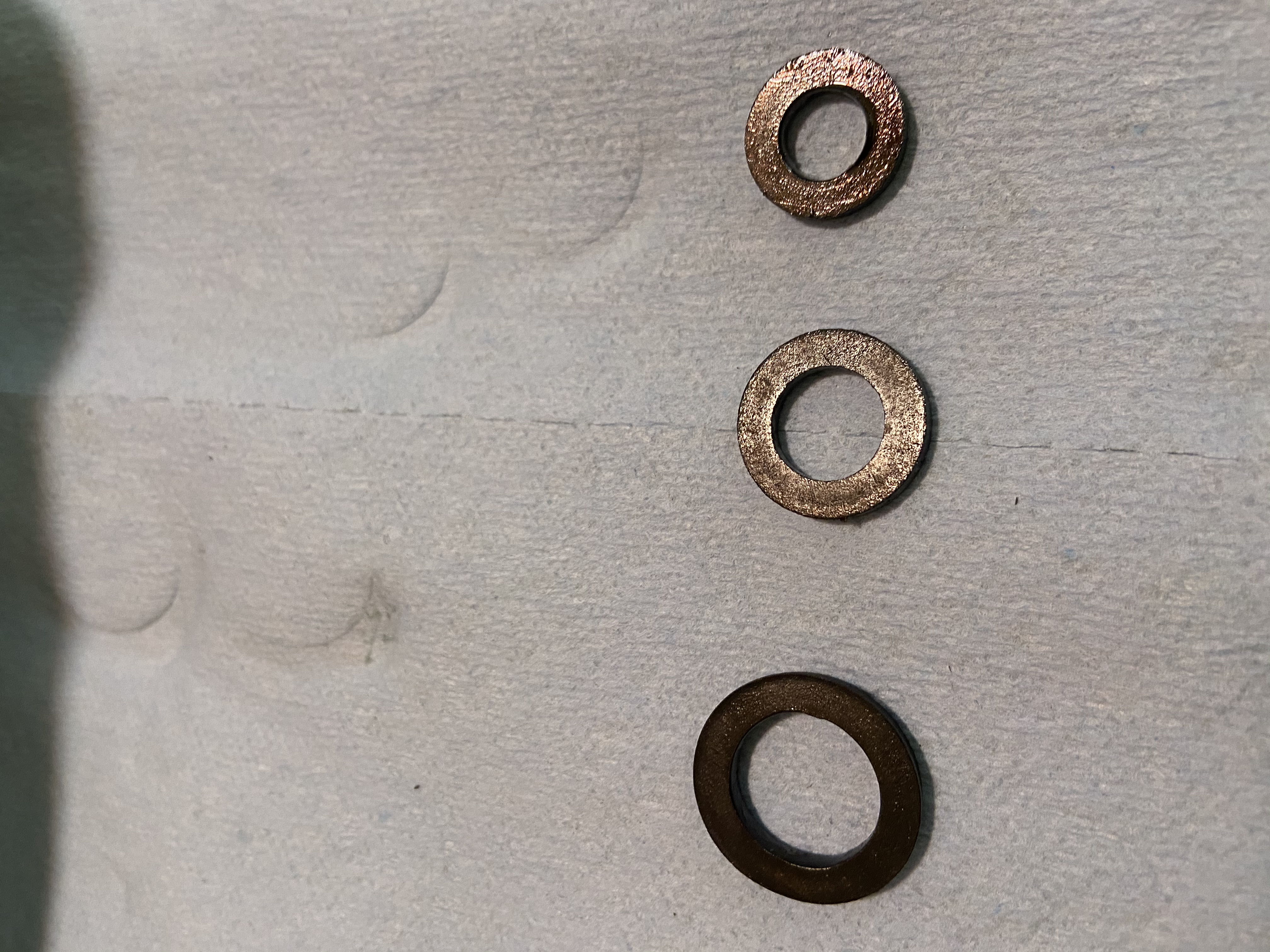

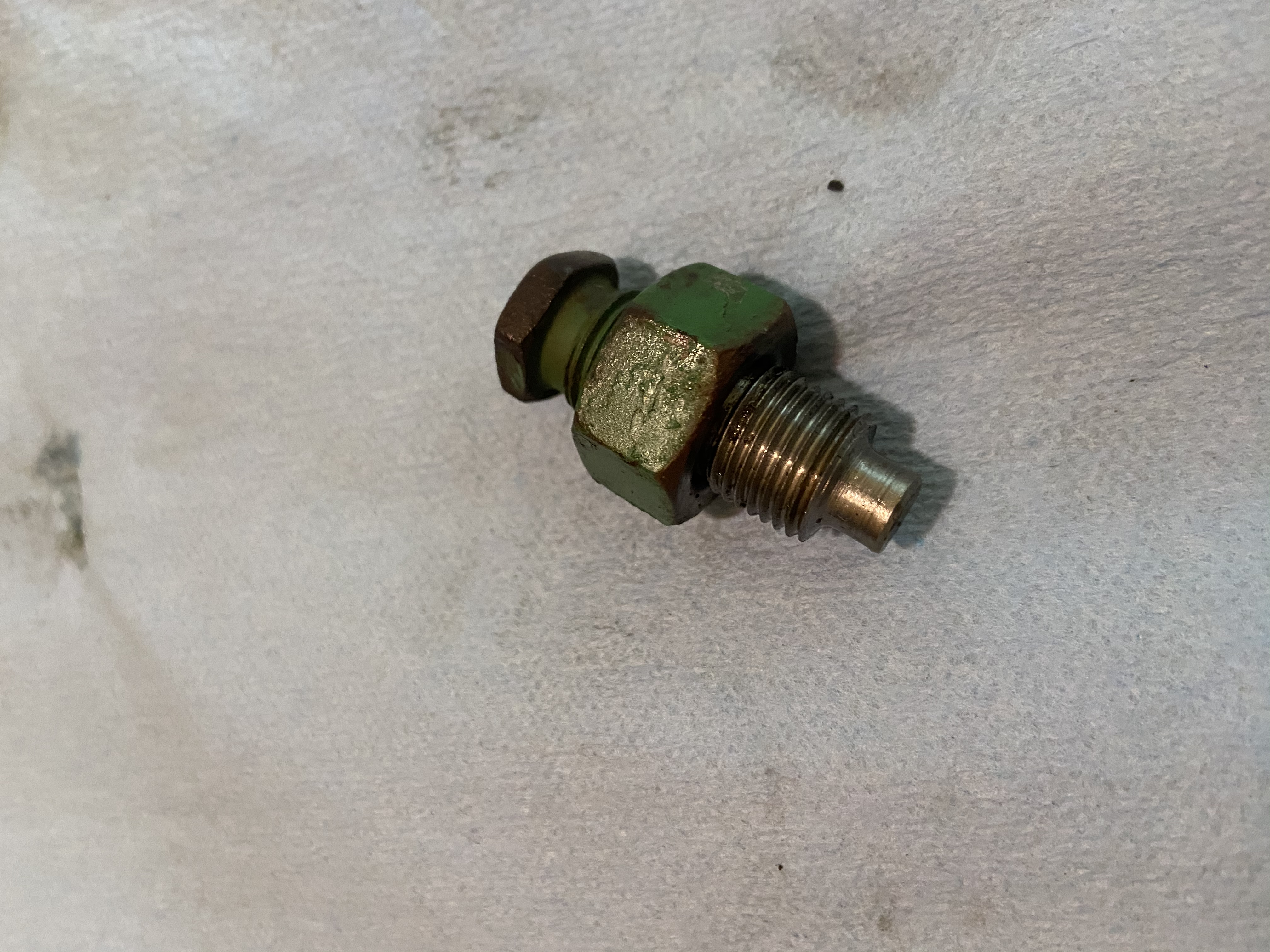

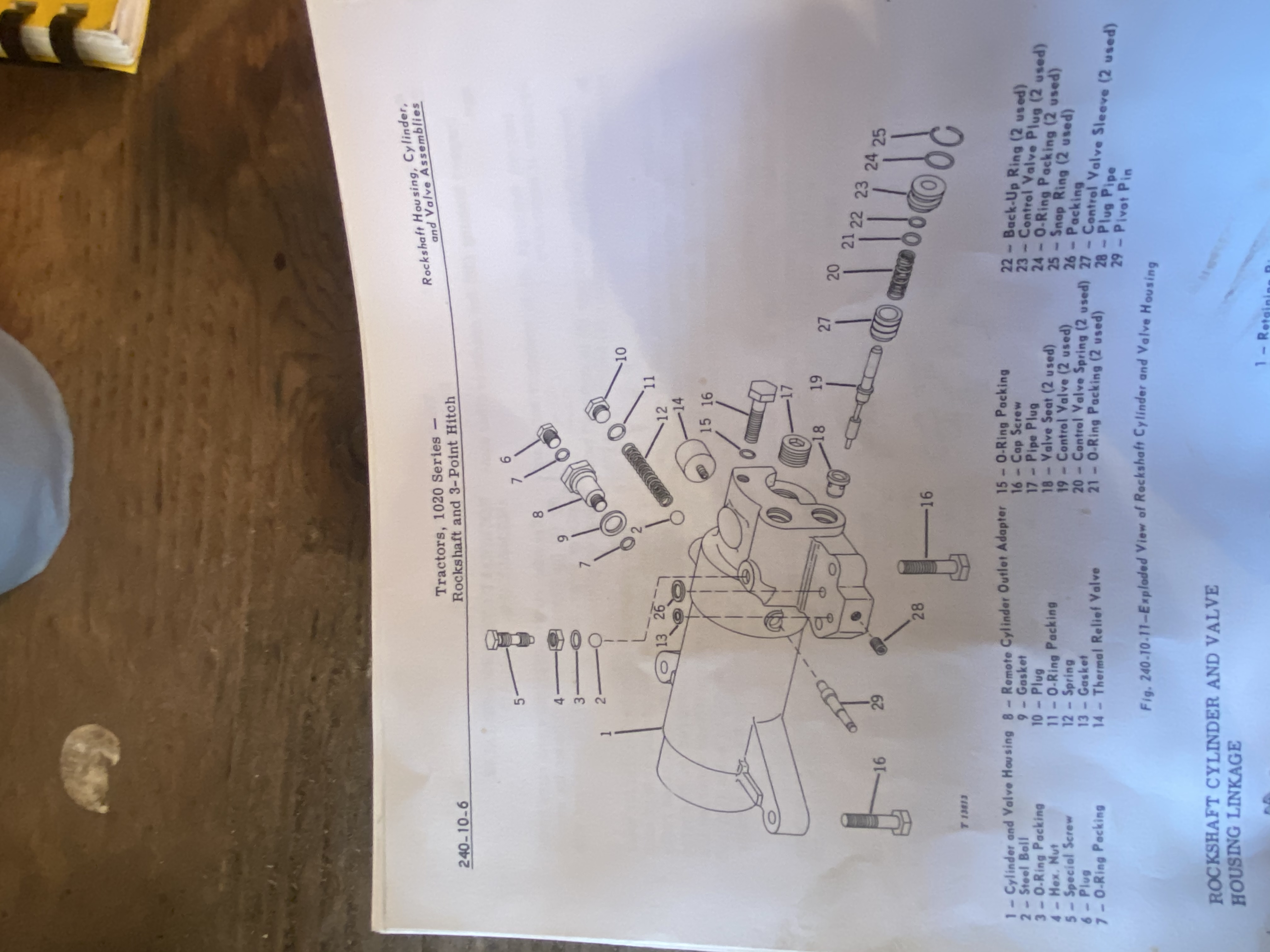

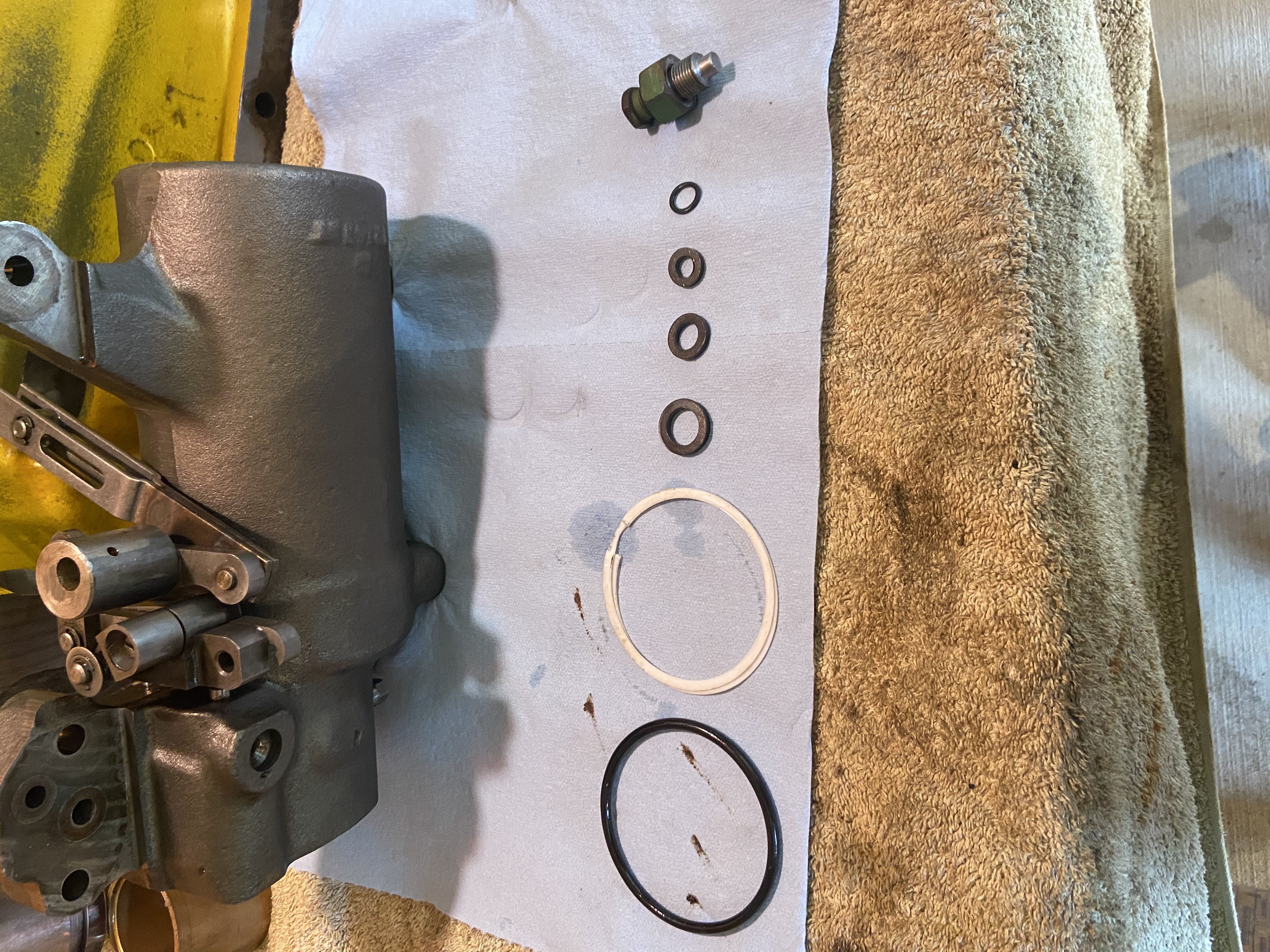

Do you happen to know where I can pull the part numbers from for these seals and o-rings? I have full service manuals but they don't provide part #s? I guess I need to buy the parts manuals for 90 dollars....
Piston o-ring and weird plastic looking oil wiper?
Three square cut o-rings. Two that fit into the piston housing items 13, and 26 in the diagram, and one that actually seats into the transmission case/rock shaft housing mating surface.
89C74240-6FCF-4631-A6C4-5B0E32D88A4A.jpegAA62BDAD-3809-4154-AD10-2F736CA576BF.jpeg07E489AE-5461-4903-BDF7-E28ACAE4C8EA.jpeg
The o-ring that goes around this special screw that holds the steel ball down? Item 3 in the diagram.
Rock shaft o-rings, metal retainers, and brass bushings. One of my bushings seems to have a score on it?
F297B09D-3713-4B44-B6BF-61E2061A3075.jpegC5525339-1221-42F1-A479-B4FDDED15A06.jpeg2C59B61D-5826-4A69-A4DB-CAECDA7B014A.jpeg
Any help or guidance is greatly appreciated. I would go down to the local Deere dealer, but it usually doesn't go well, as the tractor is so old, etc. If I have the part #s, things usually work out when I order through them.
Gotta keep the old girl going.
   / 1969 JD 1020 diesel #115

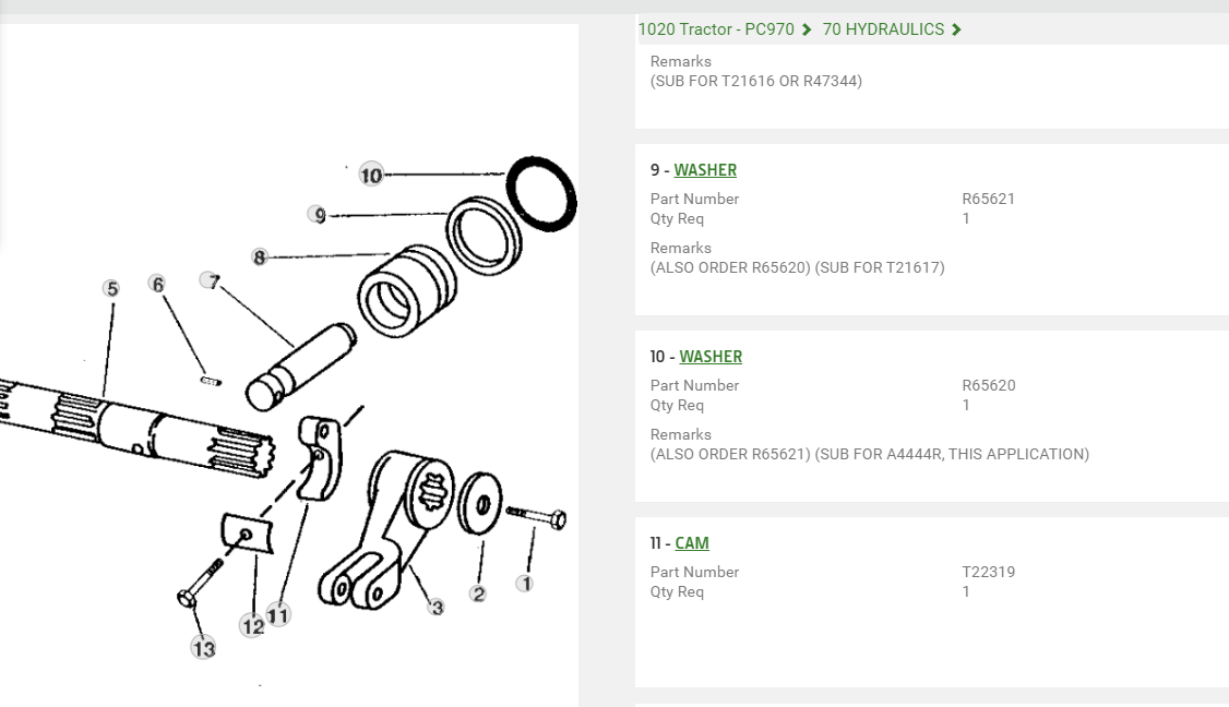

PNW
Have you accessed the jdparts system?
John Deere Parts Catalog
Put in your tractor model, and every part on it is there..
Sample of rockshaft cover..
   / 1969 JD 1020 diesel #116
Rockshaft piston seals

What do you two think about the piston housing?
   / 1969 JD 1020 diesel #118
If you can get piston & seals installed in housing without harming seals then I think utilizing damaged housing will be fine. O-ring kit for RS control valves is AR92385 + T21641 gasket

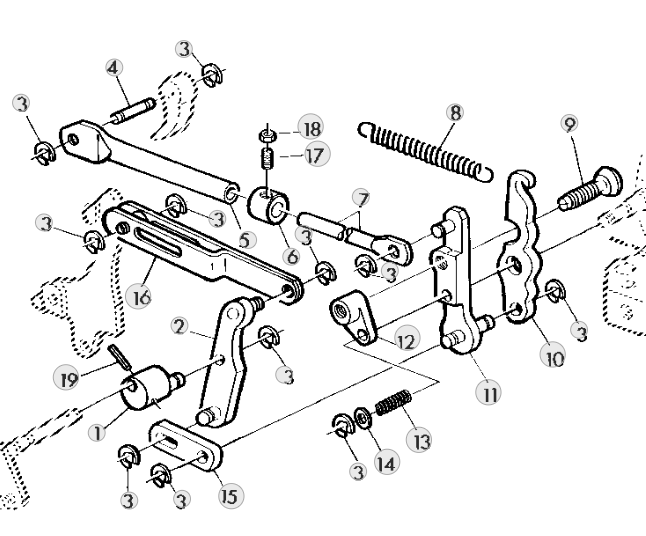

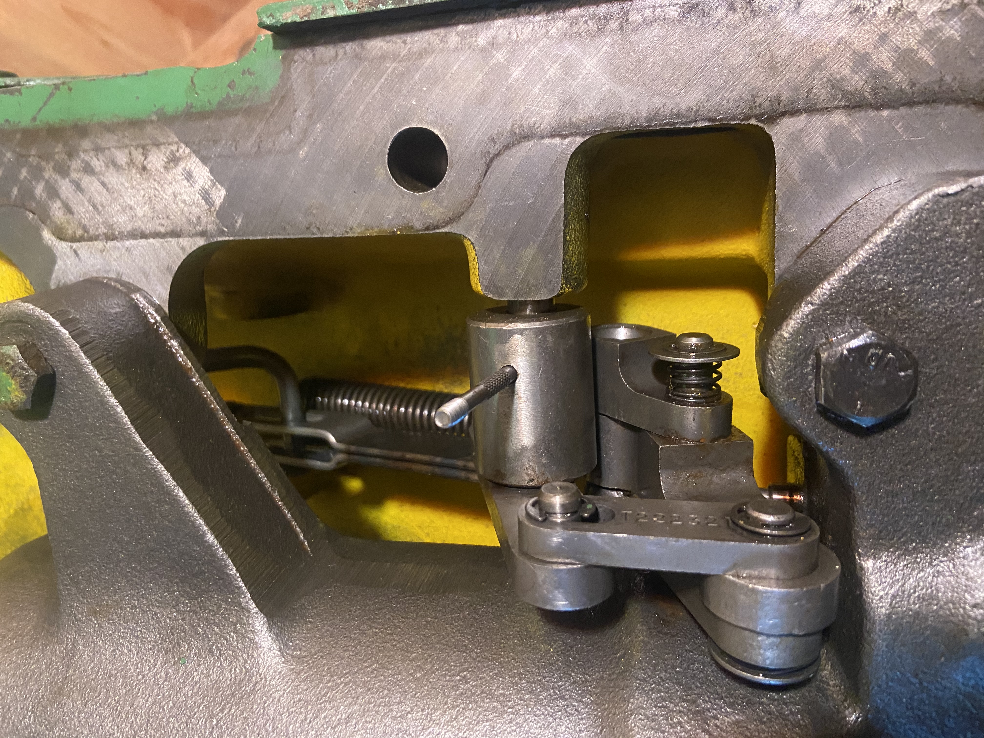

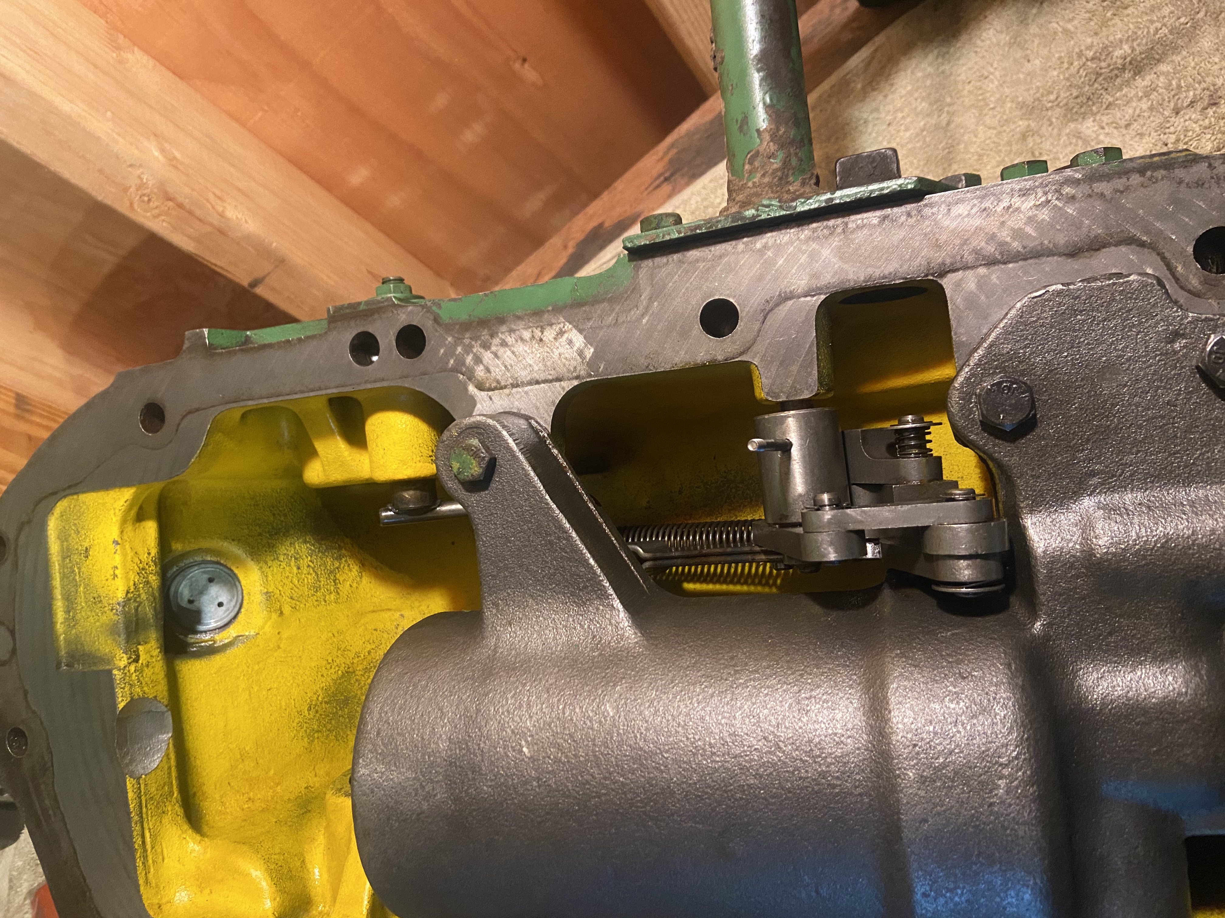

Hey everyone,
So I am in the process of putting everything back together, and this just looks off to me.
When I attach the spring to the pin on the underside of the rock shaft housing, the other end is supposed to attach to the cam on the rock shaft cylinder valve linkage.
When I do this, it seems to put all the pressure from the assembly onto only one of the piston control valves. When I attach the 3pt control lever arm, and move it up and down, the linkage seems to do nothing to move the other control valve? IDK if that makes any sense at all, but here are a few pics.
What I am saying is I would think that when you move the control lever, the linkage should move both valves on the piston housing. Move the lever up, one control valve moves, move the lever down, and the other one moves.
Have I connected something incorrectly?
   / 1969 JD 1020 diesel #120
One can't operate both RS control valves correctly until L/D control cam(outlined with dashes) is in correct location in operating mechanism to counteract spring tension.
