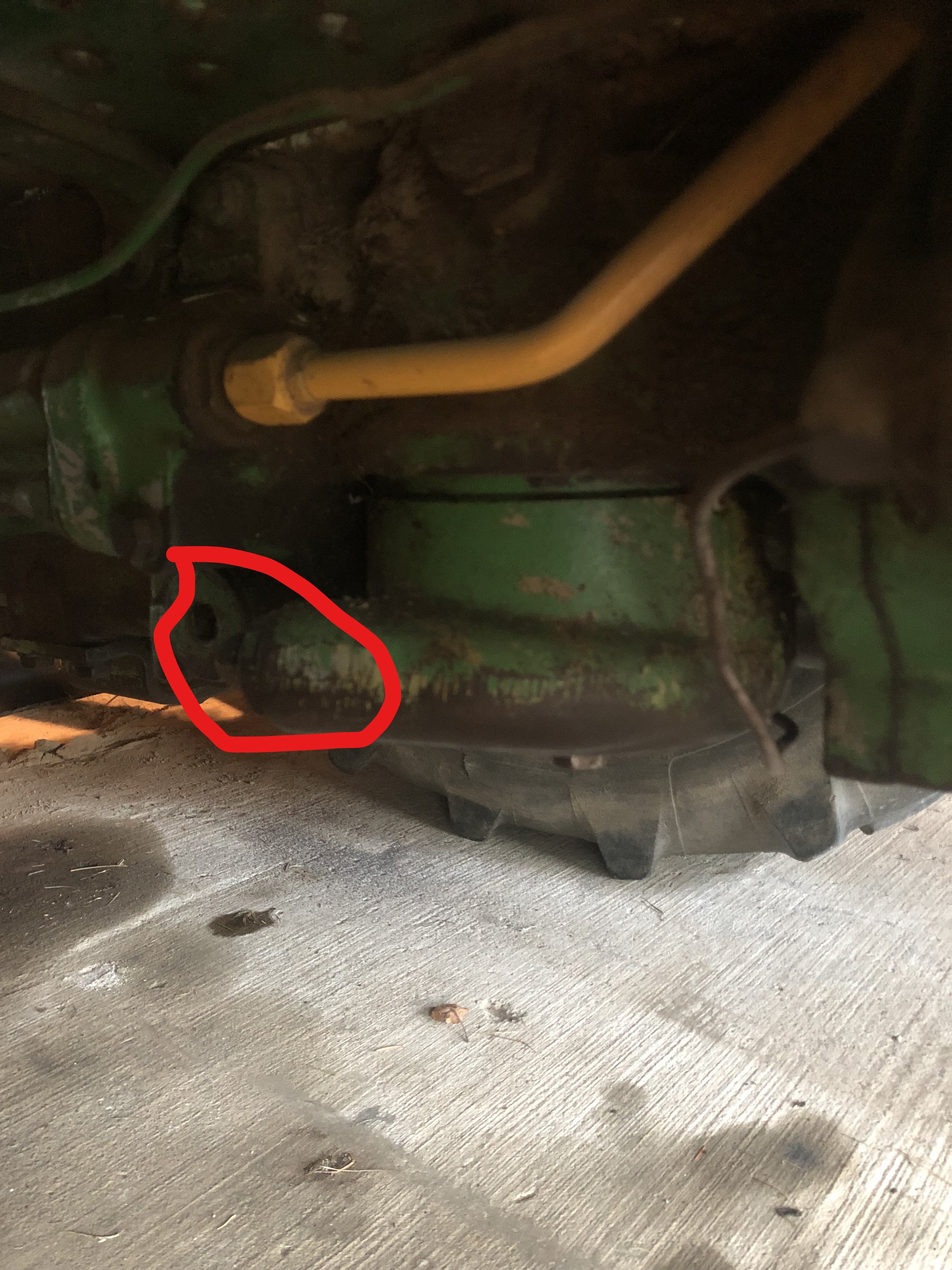

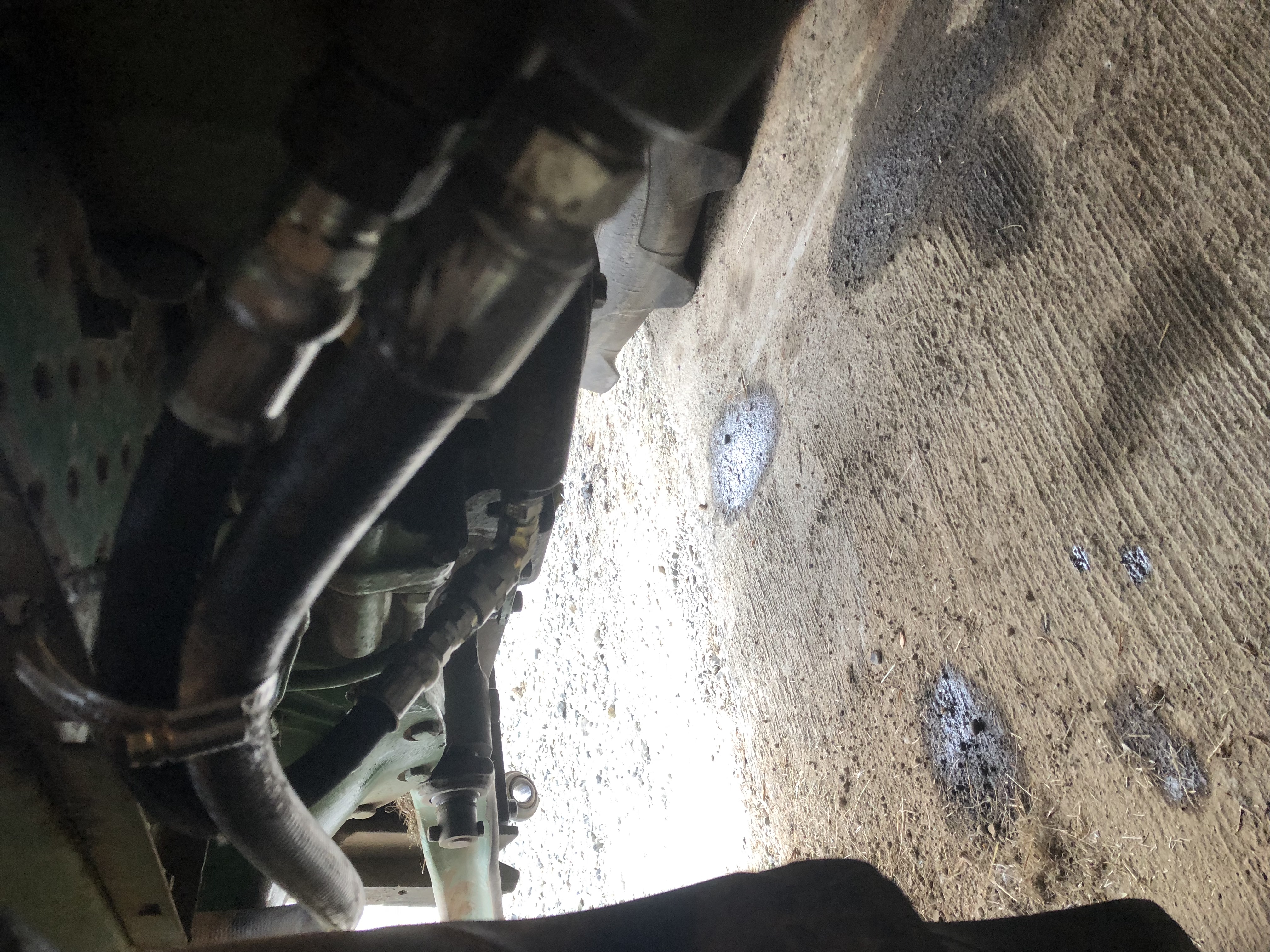

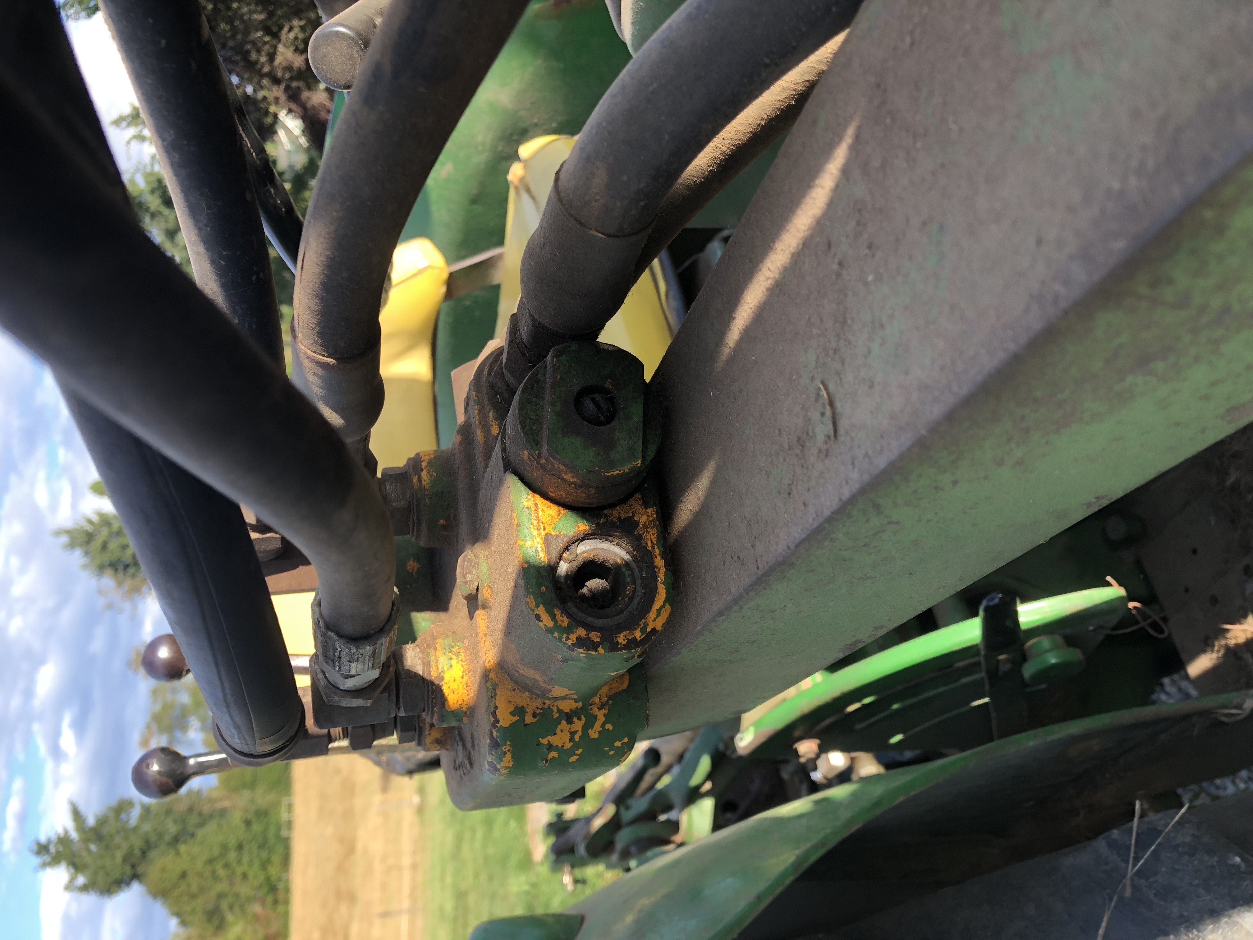

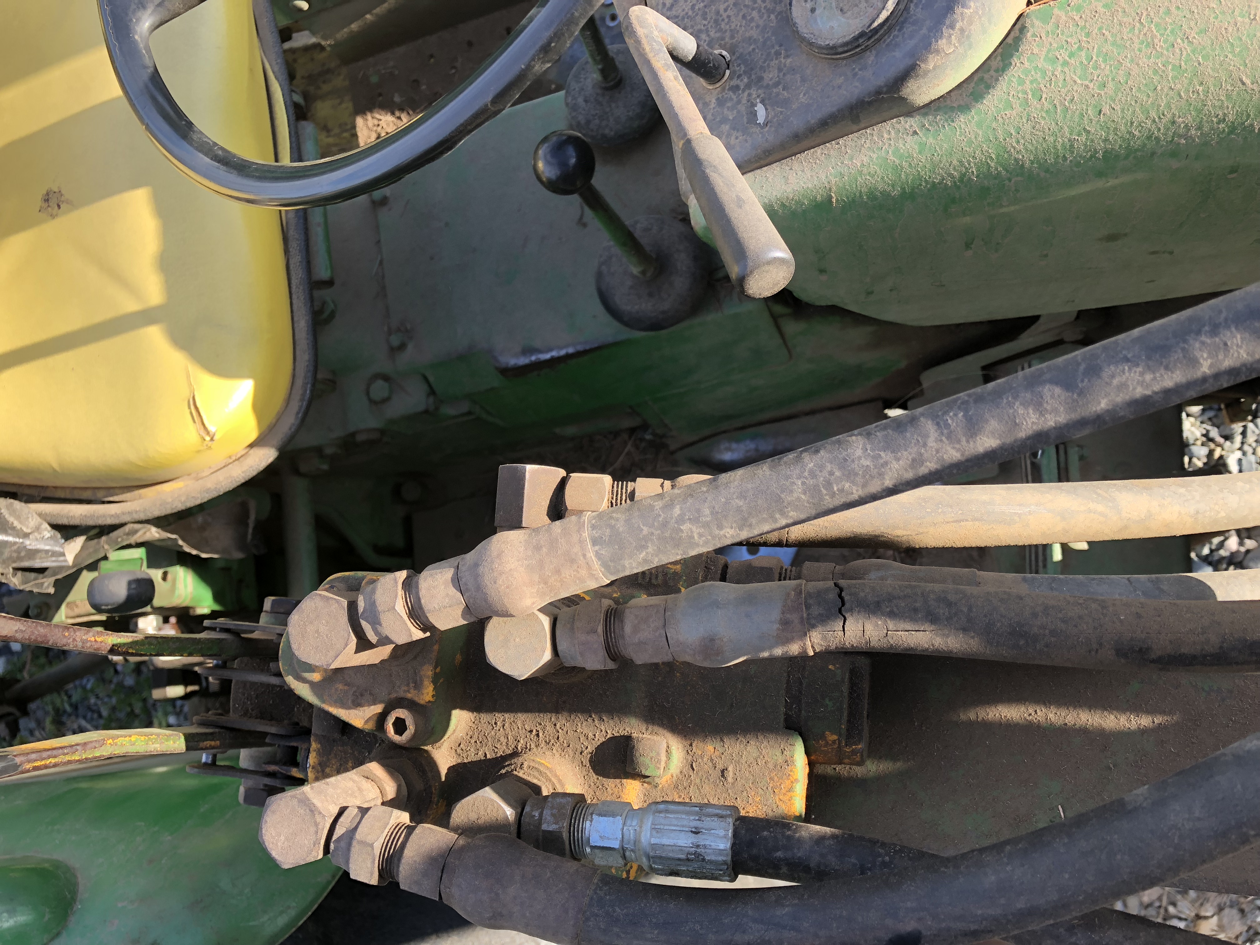

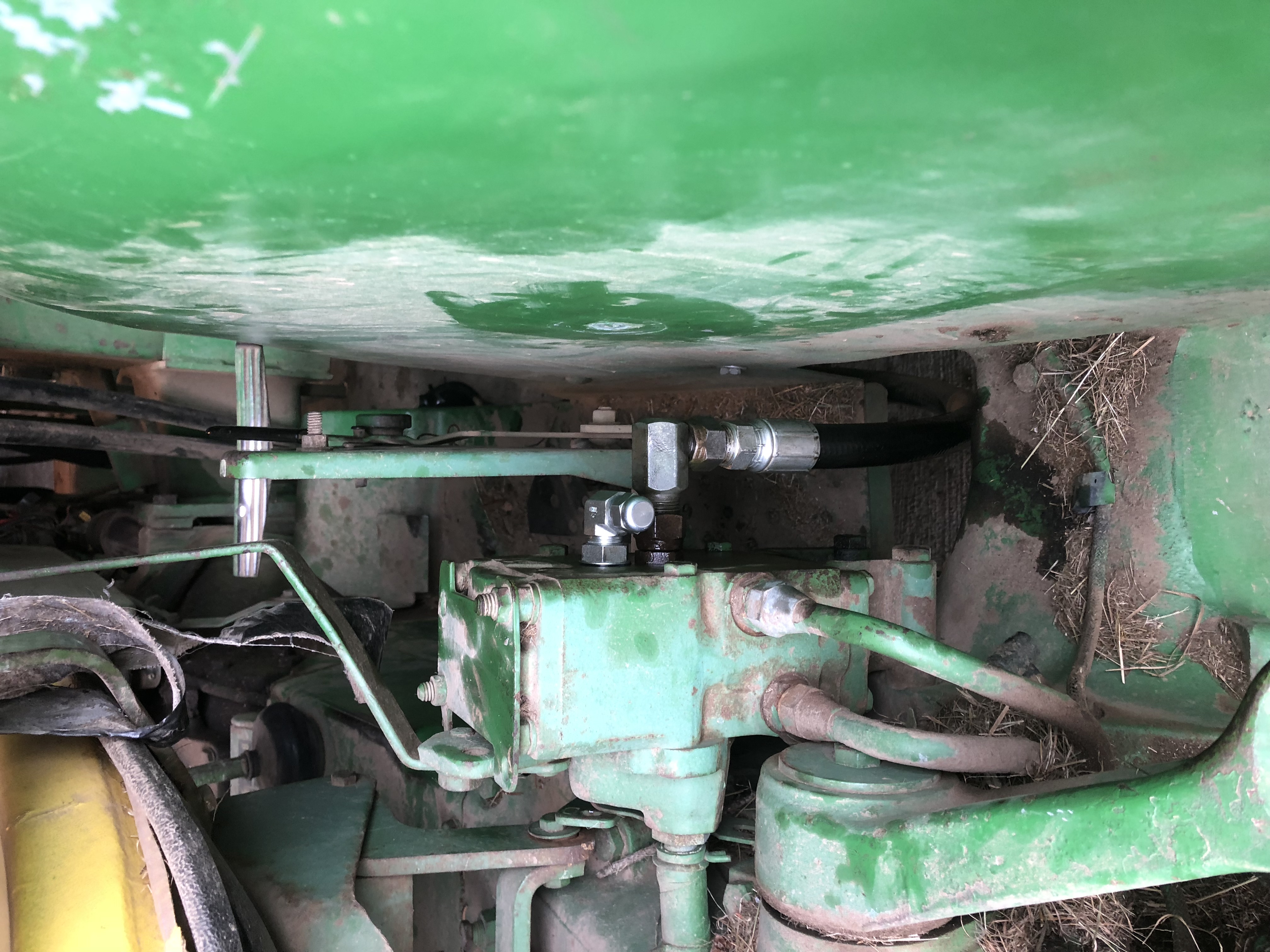

Thank you for getting back to me Zebrafive. You can click on the images to enlarge them if that provides any clarity at all? With that being said, I will try to explain what I see (please excuse my terminology).
(Working from the FEL control block back)
2) These same two hoses connect or are plumbed directly into the side (outside face) of the SCV block. InkedIMG_0553_LI.jpgInkedIMG_0552_LI.jpg

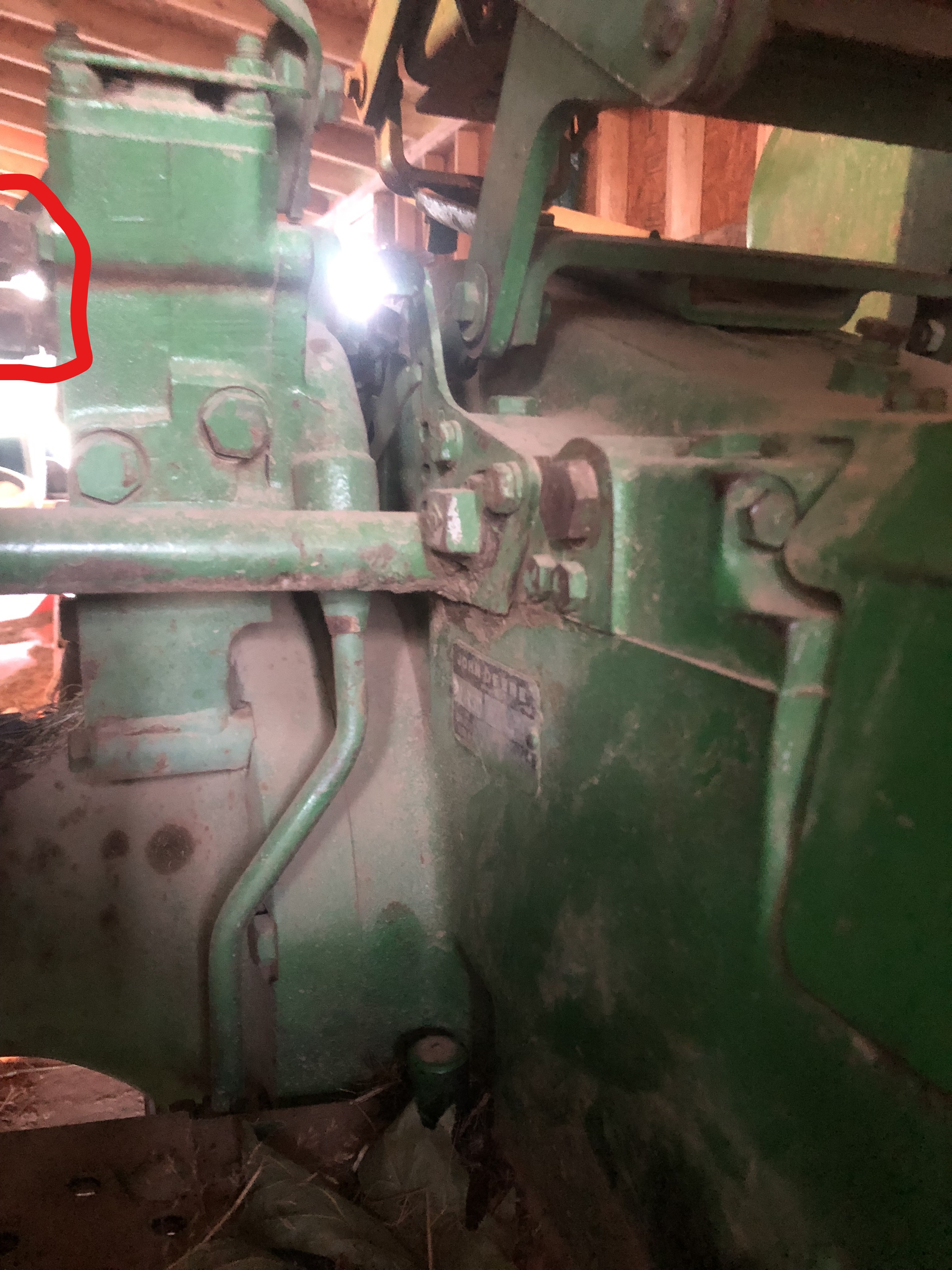

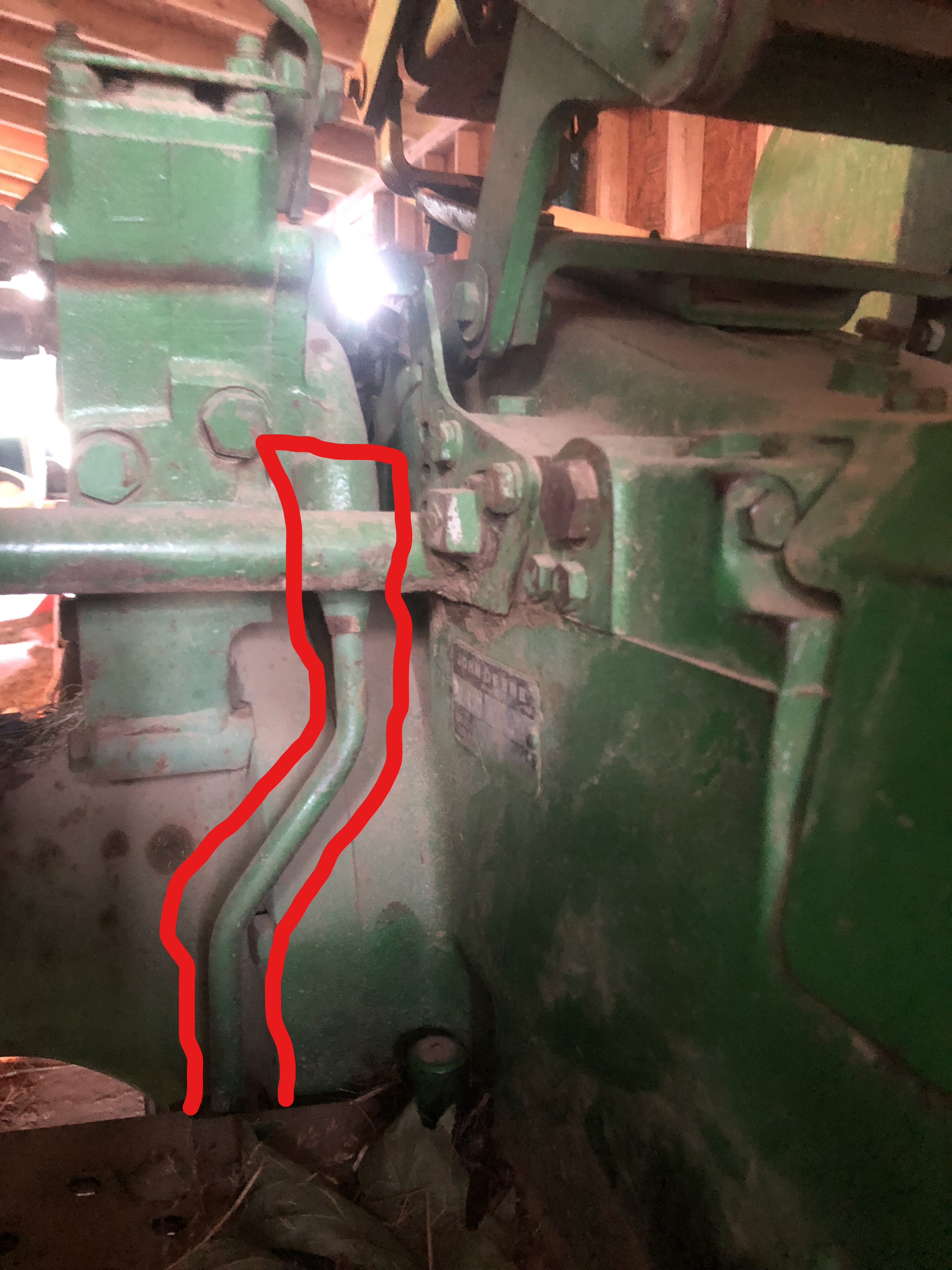

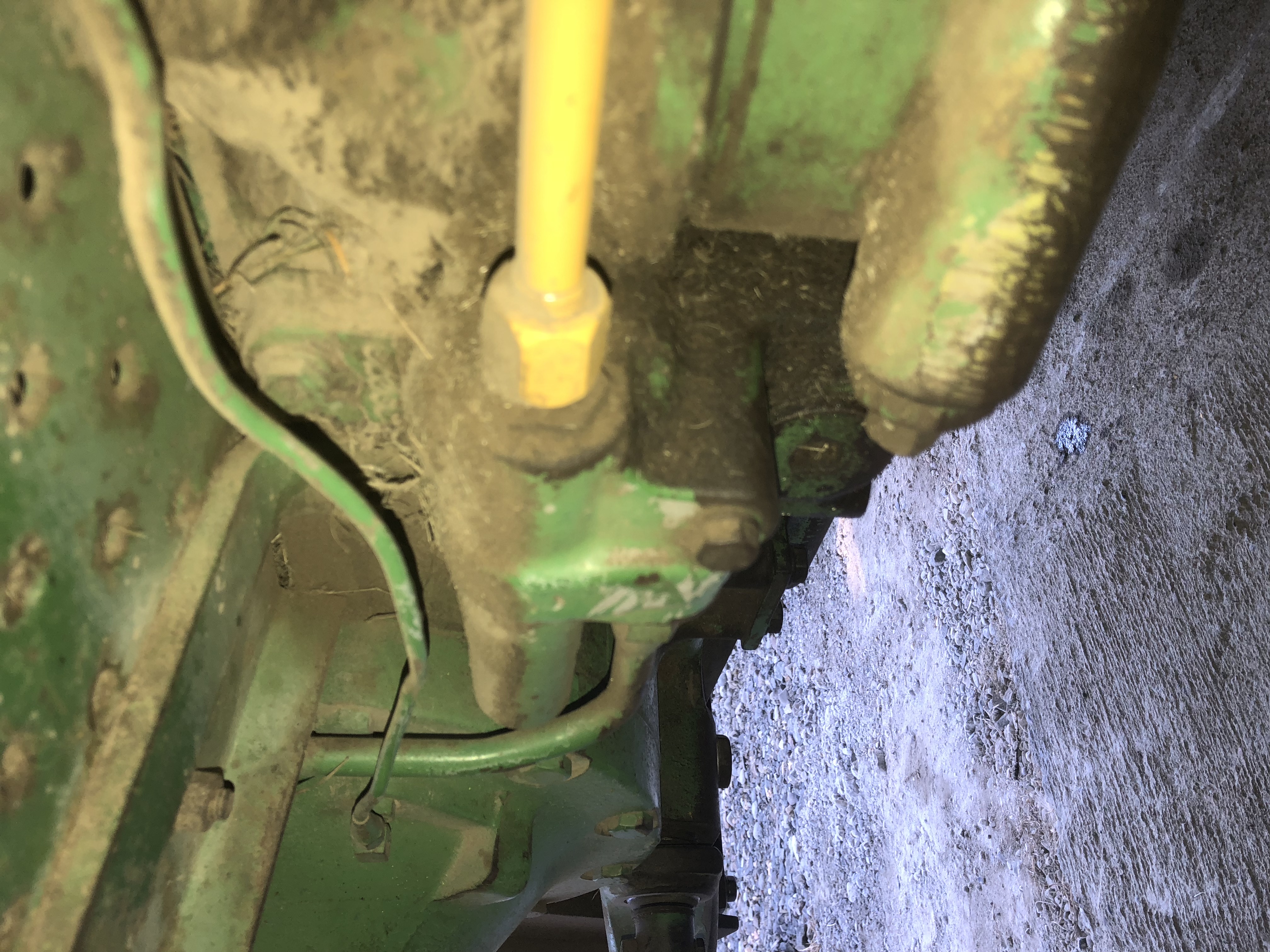

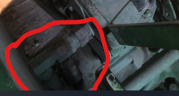

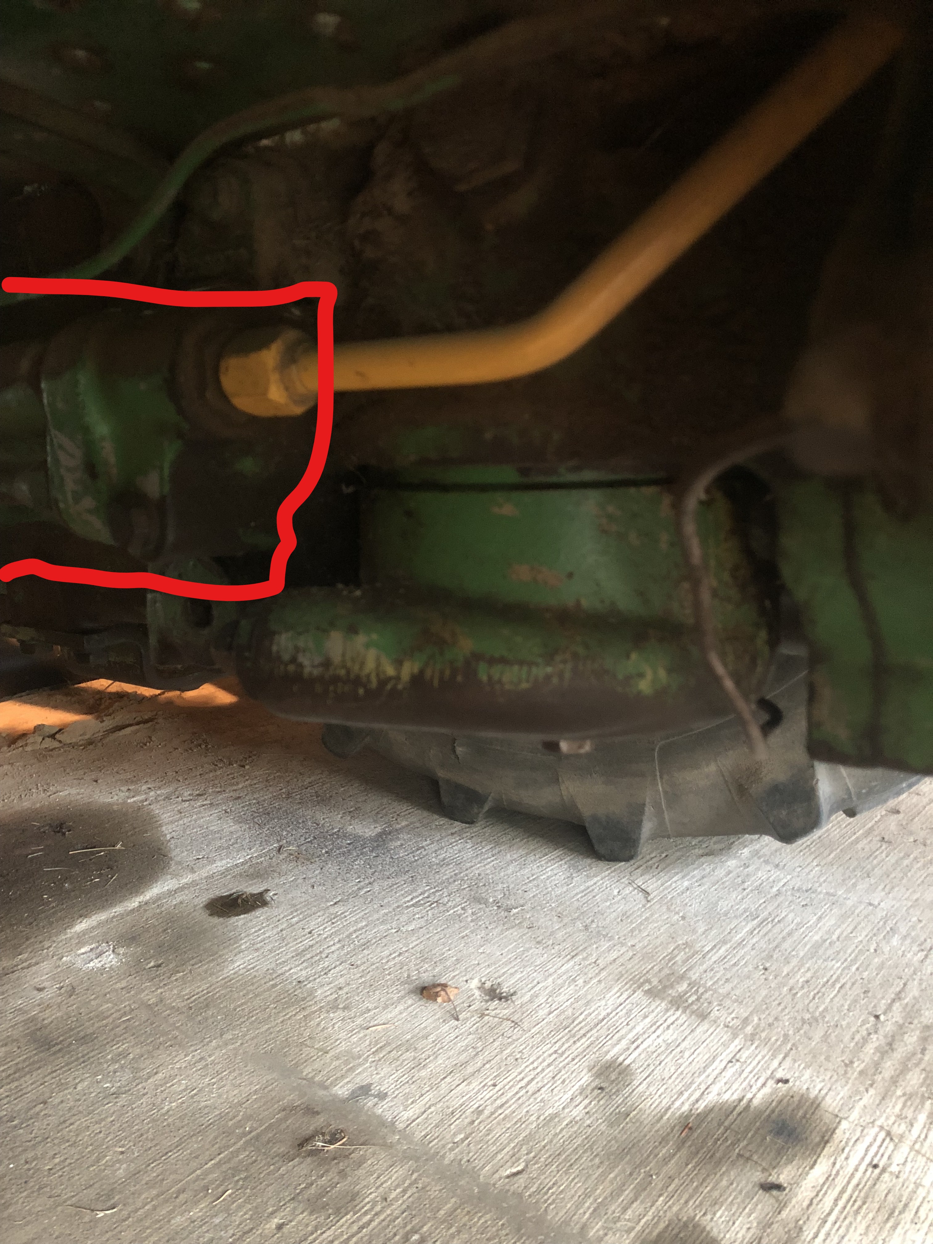

3) Then I see one hard line that exits the bottom front of the SCV block and makes a connection to an area "just behind" my filter cover??? InkedIMG_0553_LI II.jpgInkedIMG_0564_LI.jpg

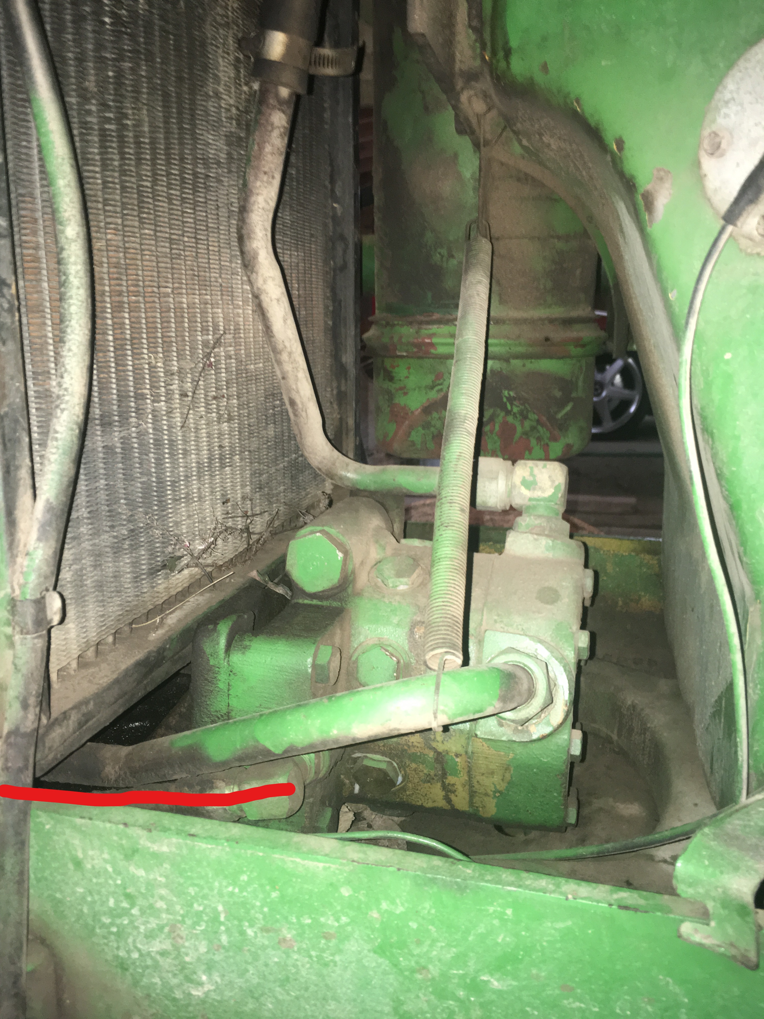

4) The yellow hard line that is shown then runs up to the front of my tractor and connects to my main hydraulic pump. InkedIMG_0564_LI.jpgInkedIMG_0550_LI.jpgInkedIMG_0159_LI.jpg

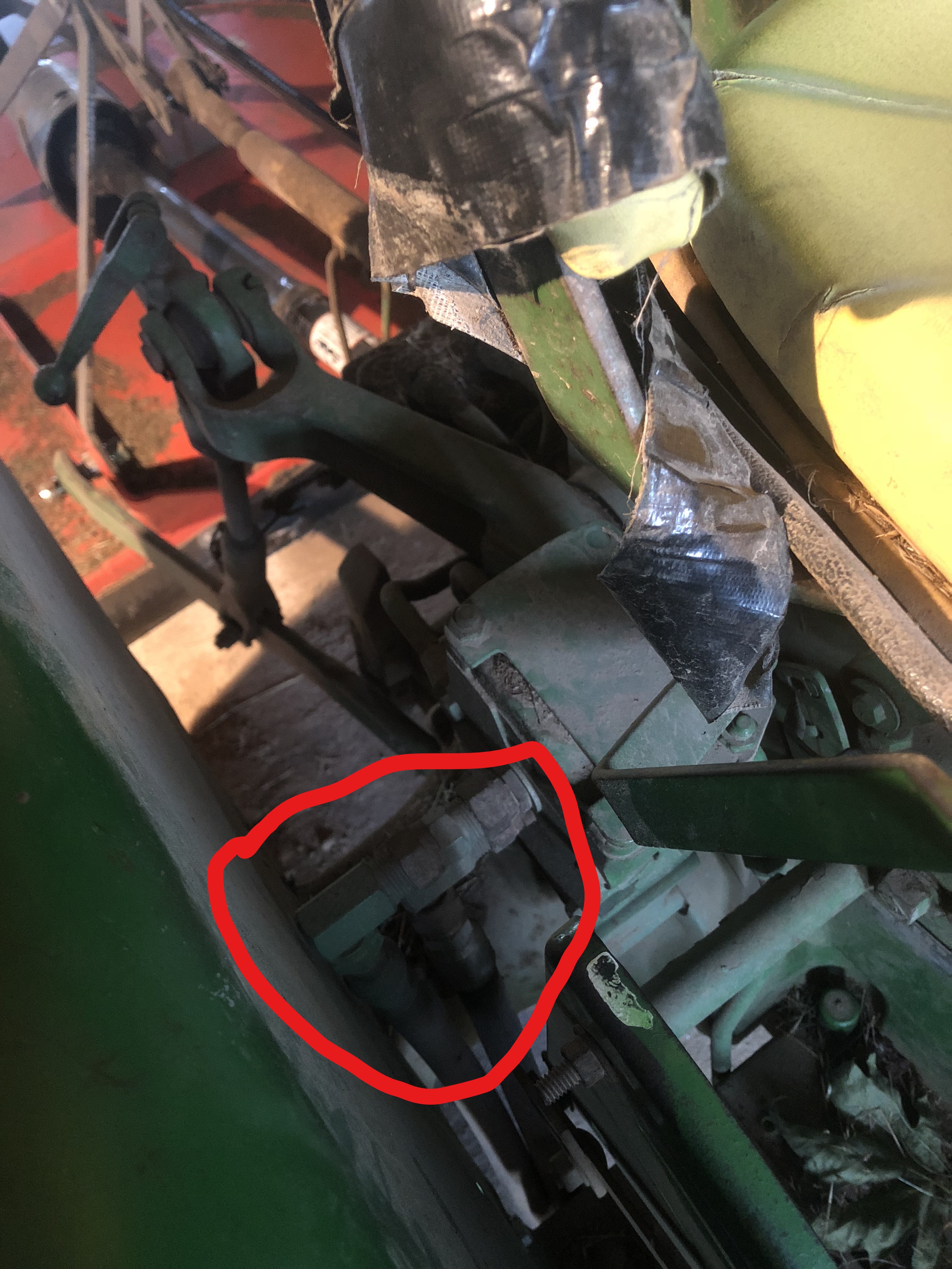

5) Here is what I believe is my "already" ported filter cover? What line gets connected into that "port", and what are the benefits, etc.? Knowledge please HAHA!!!InkedIMG_0564_LI II.jpg

Routing FEL control valve return oil to ported filter cover puts return oil back into hyd oil charge circuit much quicker than any other method of returning oil. This will give the fastest FEL reaction time. It appears your FEL valve is supplied oil via the side of the SCV housing(see photo below).

It does look like your loader valve is supplied off the out side of the SCV. Top is return, bottom, supply.

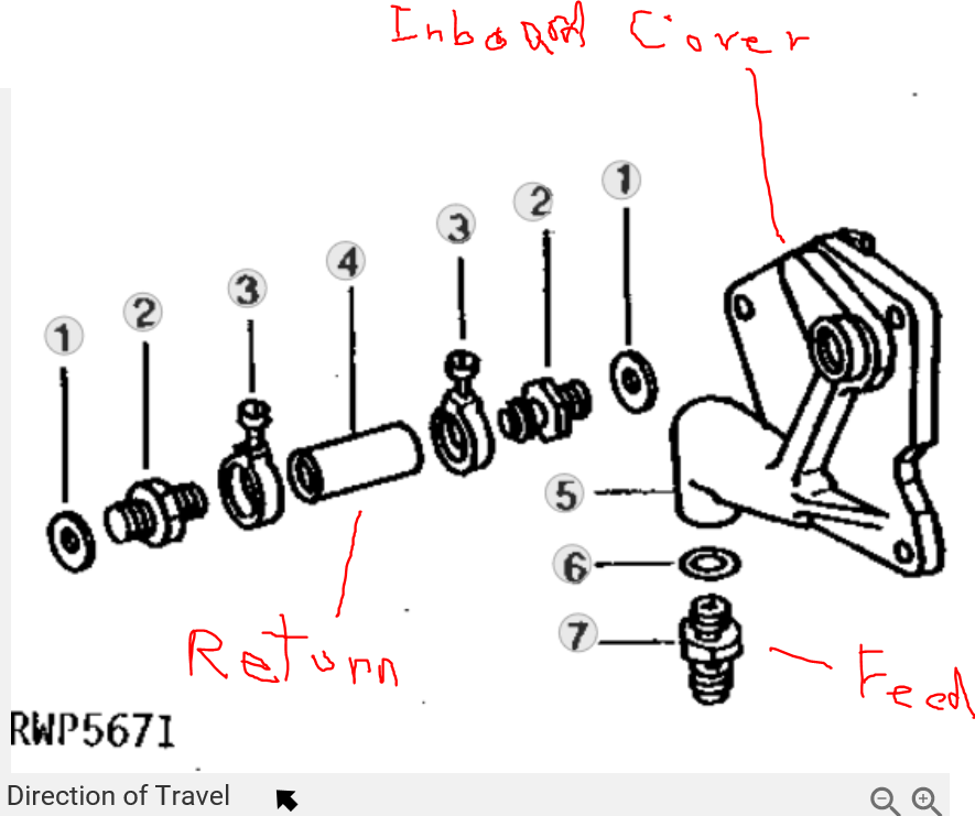

JD made a "Return to filter kit" for the SCV(s). It has plugs for the return normally used on the inboard SCV cover, and a hose to the ported sump cover. My two SCVs have this kit.

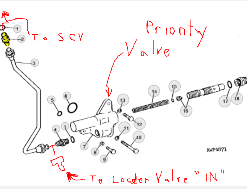

I could not tell if you have a priority valve (yellow line from front pump would hook to it) The a line from it,would go to the SCV, you show that line boxed in red. The Tee at the priority valve is how my loader is supplied.
I see no need to change your supply.
I would move your return to the ported cover.

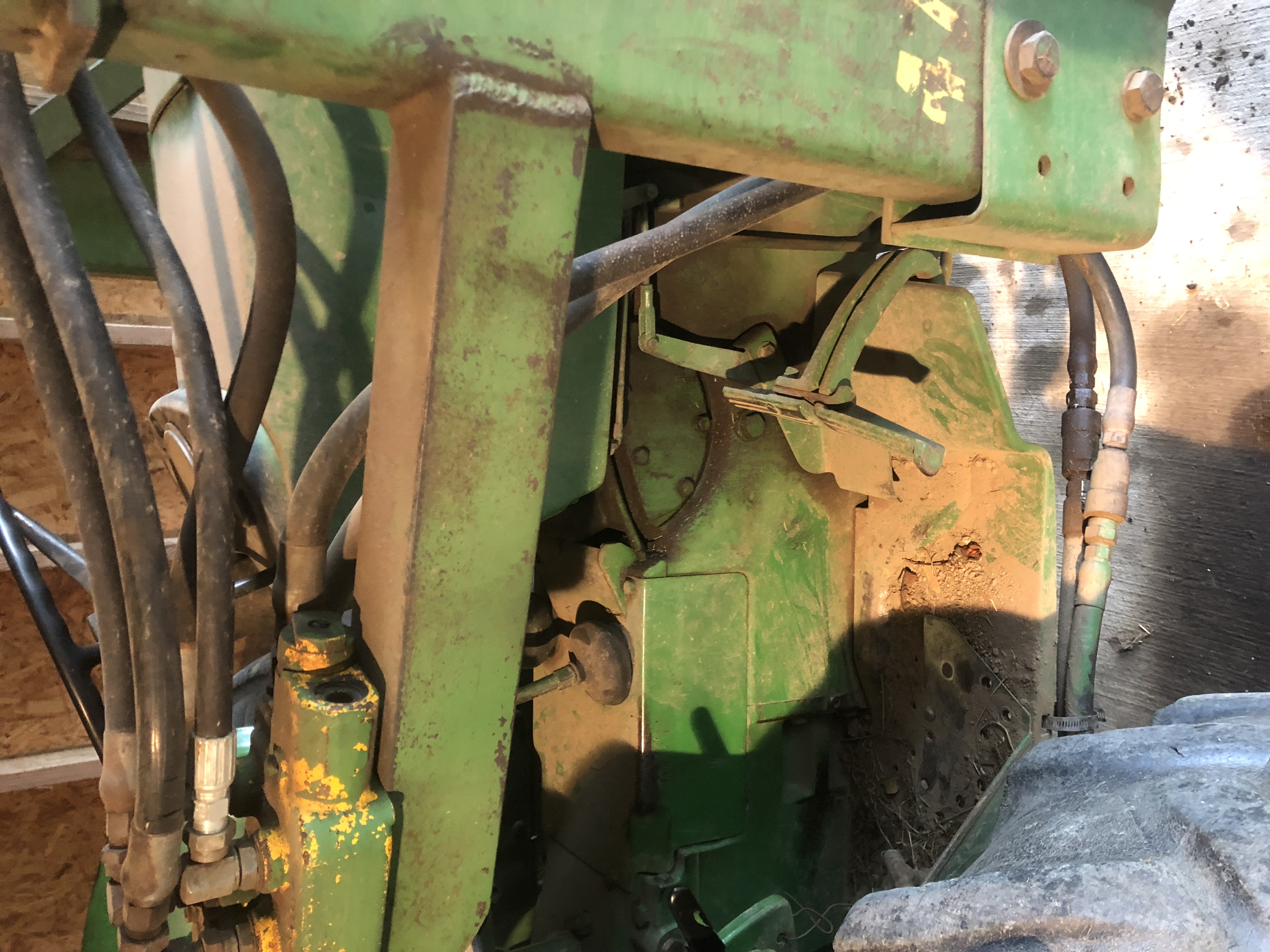

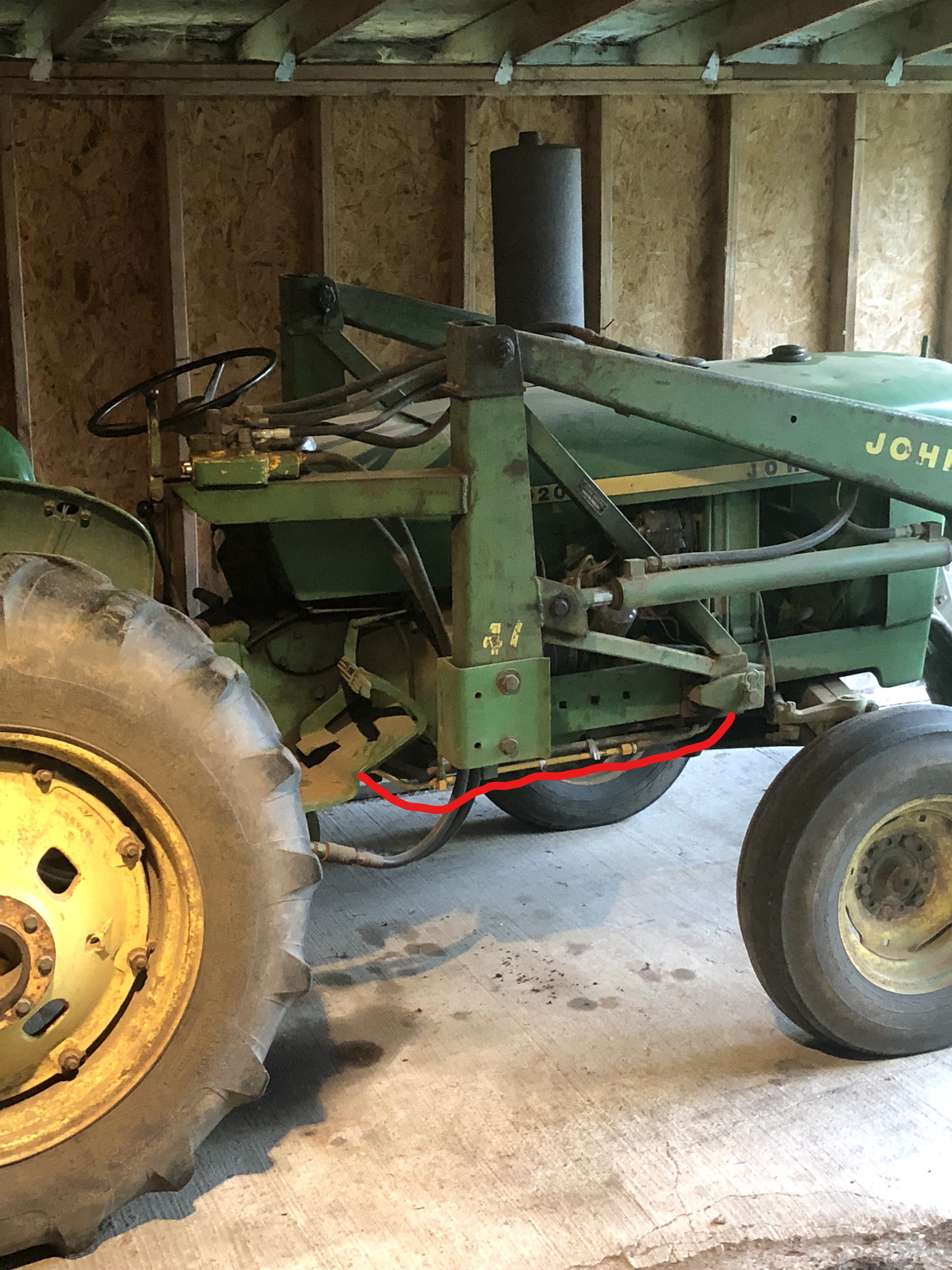

I believe lol? I have tackled this. It may not be as clean as the factory install but it does work.
I ran the tractor with the new routing and I could actually tell a difference!!! It was noticeable to me while using the box blade and the FEL to grade an area in the pasture. I did feel there was better "action" in the FEL. And also, the entire time our family has had this tractor (shoot 20 years now) and since I have really been running it, I would always notice that if I went to open the control valve wide open to raise the bucket the hydraulics would "chatter"when the bucket would get to 75% max dump height, and I would have to back off. That symptom is now completely gone.
Zebrafive, since you mentioned that I didn't need to change my supply, or you thought it wasn't necessary, I didn't. I retained the two quick disconnects so that if I ever need to, or decide to drop the FEL, I still can with more ease, etc. It def. seems that I do in fact have a priority valve? Also, my "inboard" ports on my SCV that supply your FEL, on my 1020d supply/route to my two and only rear aux. ports that I plan to add a hydraulic top link to (one day...). Is this wrong? What happens if I use my "lever" to operate my rear aux. ports for my eventual top link? Does that mean the FEL no longer can be used/doesn't have hydraulic power? How do I add another set of rear aux. ports with my current hydraulic routing/plumbing system?
What do you think Tx. Jim? There must be a simply bolt in way? I just don't understand how my single aux. "lever" will be able to run two sets of rear aux. ports? Is there like a selector valve that must be added, to therefore divide each set of rear aux. ports, so the lever is only acting on one circuit at a time?
Anyways, check it out. Here are some before and after photos. Sorry, I don't know why the thumbnails aren't the right orientation. If you click of them, they are correct.

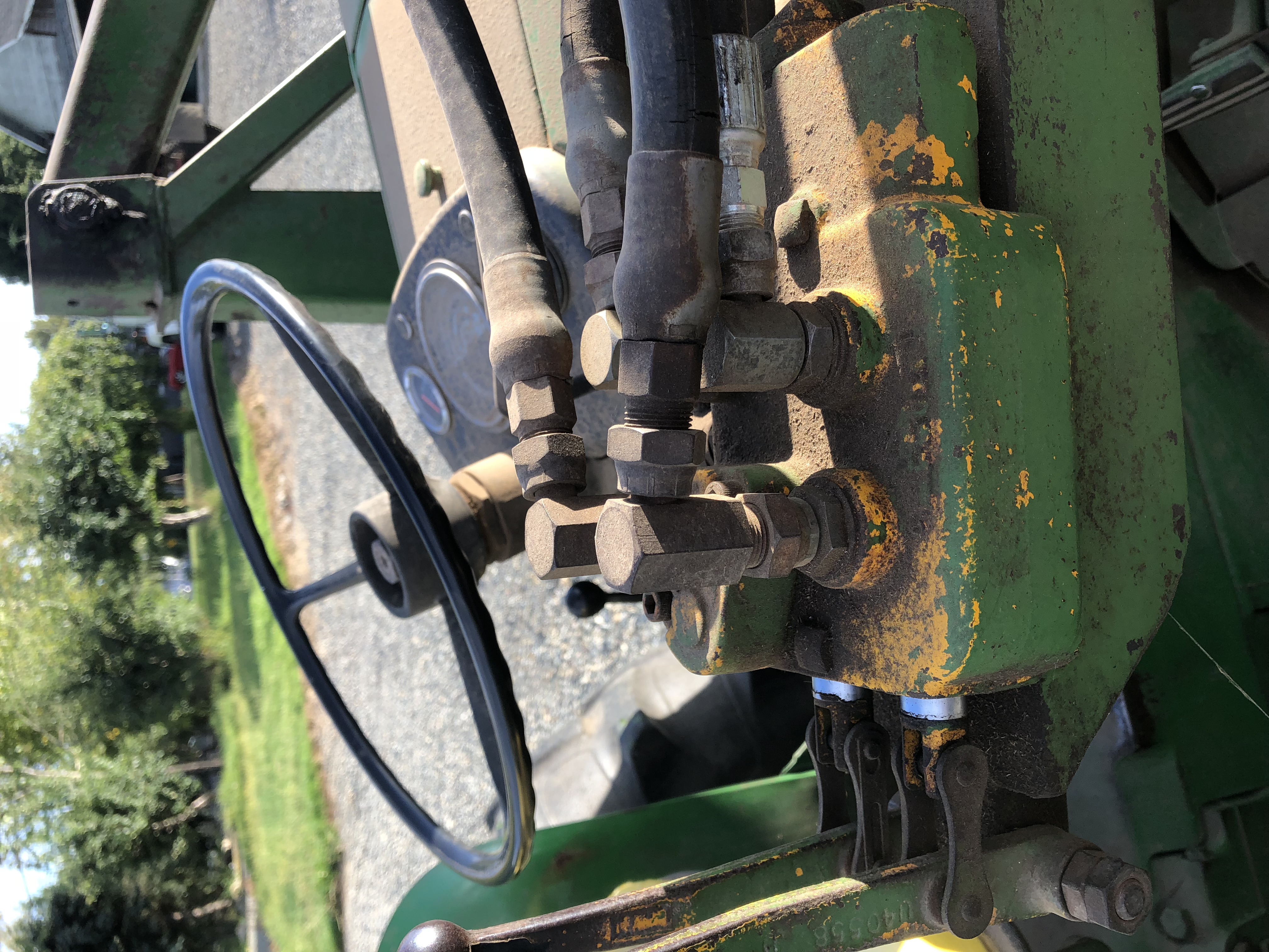

Simplest,cheapest method to add extra hyd control circuits would be to add a 2 or 3 spool closed center valve mounted on a bracket bolted to axle housing plumbed into existing pressure/return ports. You could add 1 more SCV similar to original SCV by sandwiching valve body to existing SCV body but the valve bodies are fairly expensive even used.

Here is what my control block for my FEL currently looks like.

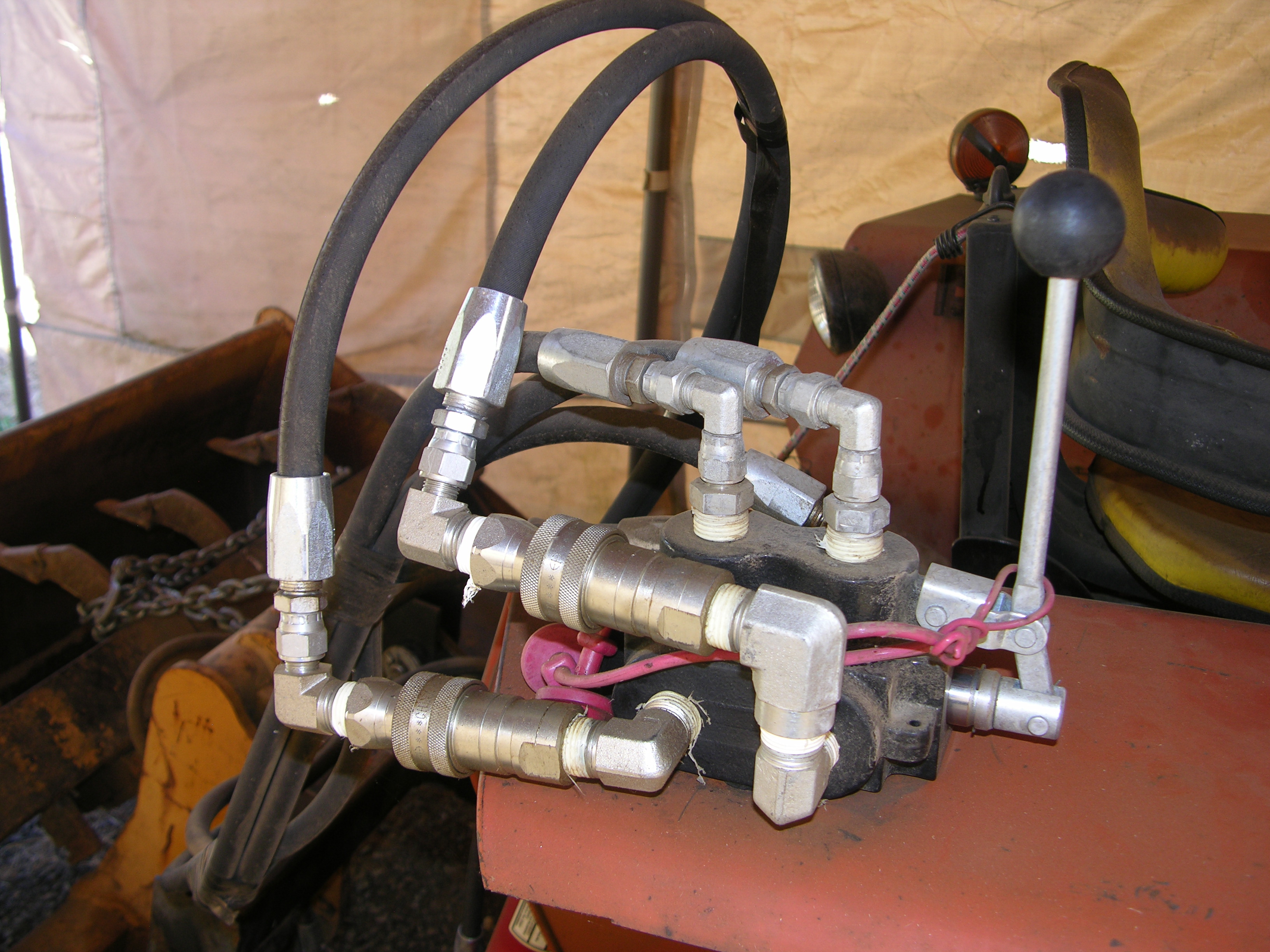

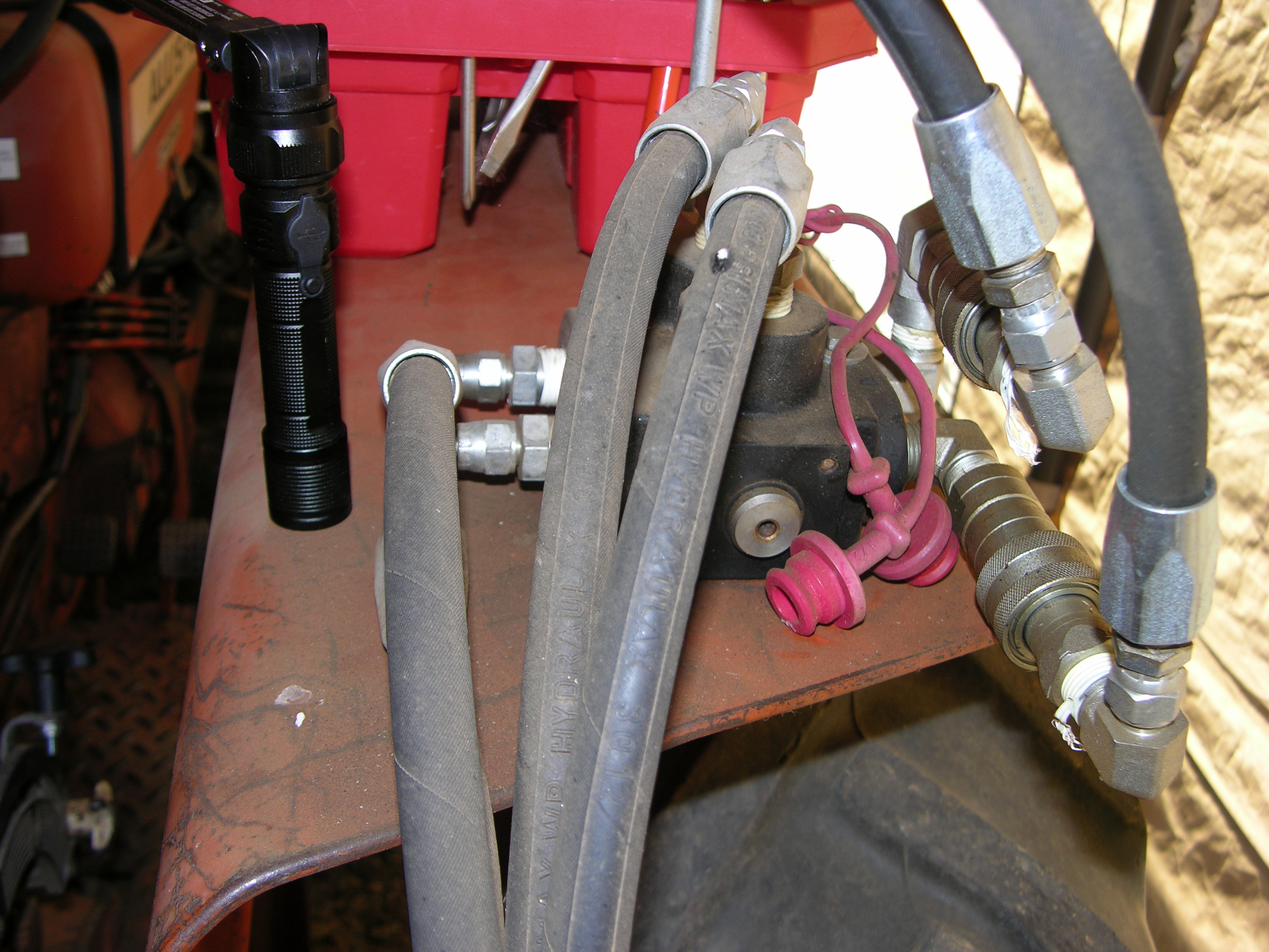

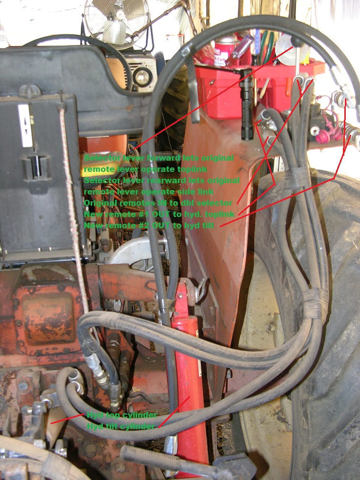

Here's an example of a dual selector hookup - this one's on my Allis 160. Eventually (already have all the parts, waiting for time) I'll replace that with a 4 stack PB valve, to be inserted between the original remote and the 3PH (this will give me FIVE remotes, the 4 new ones will be 2 normal spring center and 2 with added float. I already need THREE remotes at times, and long term plans include a fully articulated back blade.
The side tilt cylinder has a 10" stroke, and allows my 7' Gannon box to be more than a foot higher or lower than level. It's already proven itself in re-contouring a 60' long area to drain AWAY from 2 shipping containers instead of TOWARD them.
Here's a marked up pic that will (hopefully) make sense... Steve
AllisRemSelect.jpg Couple other shots from different angles -
They look different due to keeping hoses controlled, plus I ALWAYS want the hyd toplink so there's no QD's on that line...
Oh, with your curved fenders TxJim's mount makes the most sense - a "pod" coming up from the axle, if you want the controls where you can actually USE 'em, might need a brace from the stiffest part of the fender to minimize wobble... Steve
