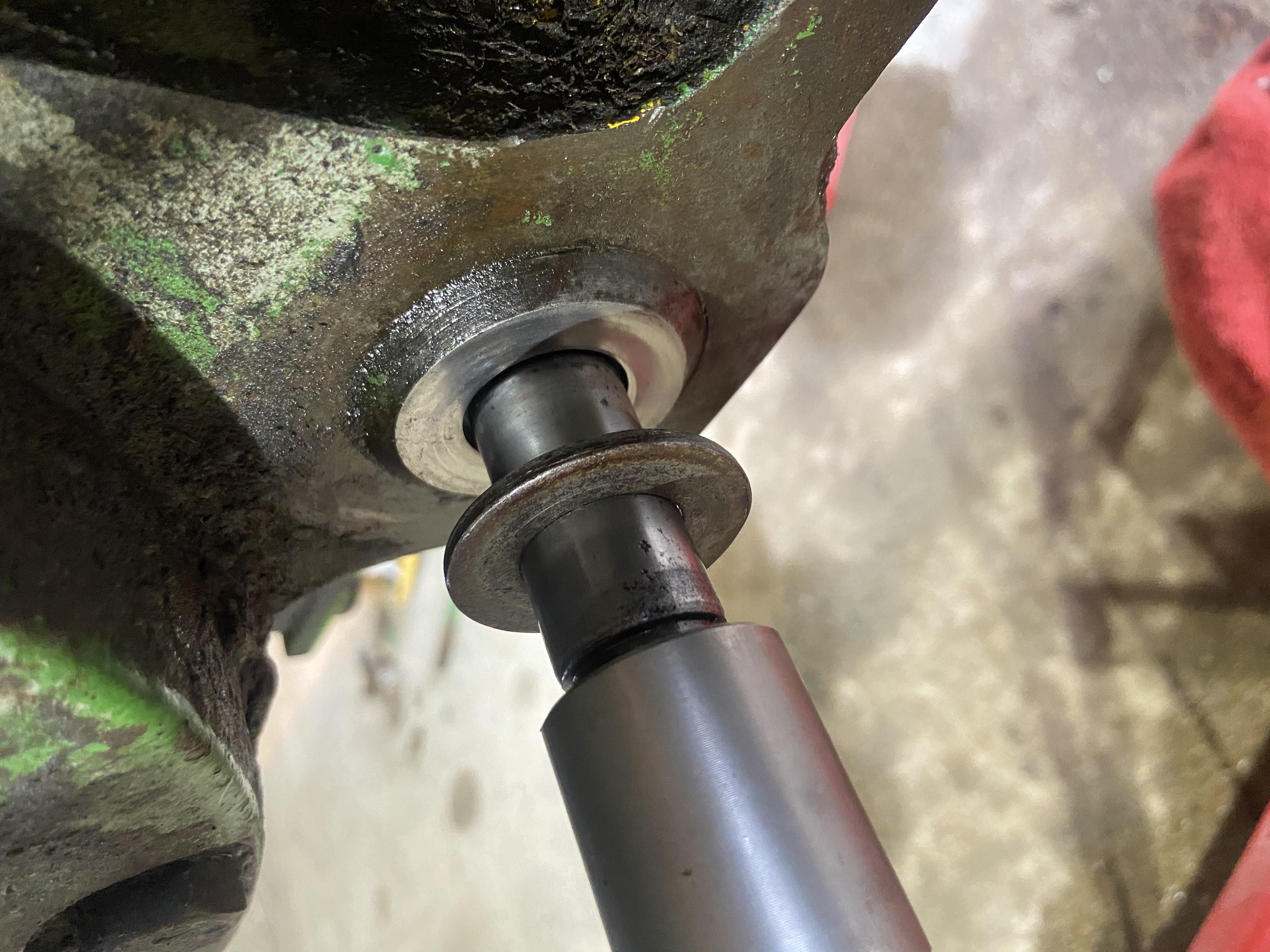

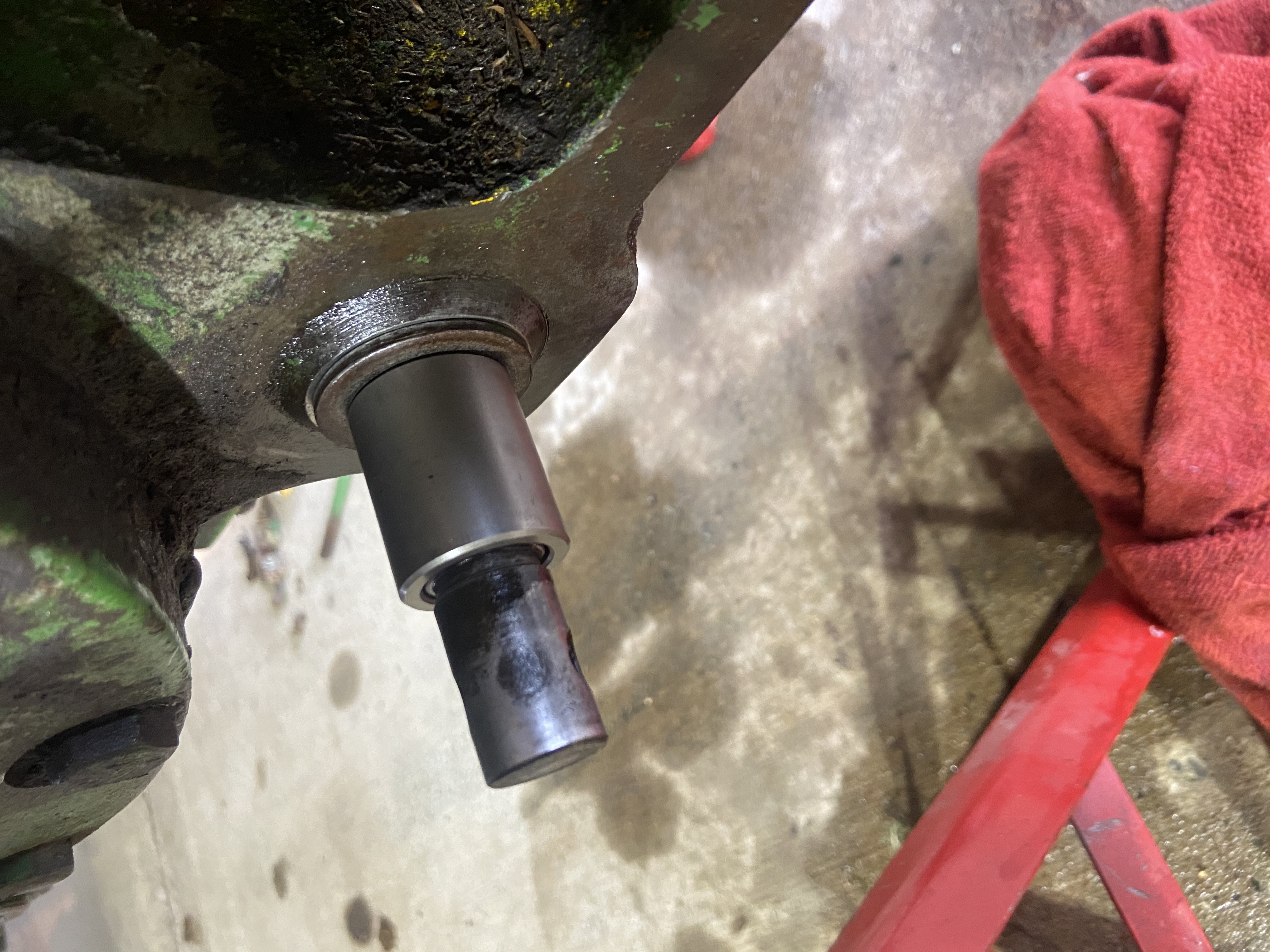

Knocked out the load control shaft o-rings, seals, and new outer shaft bushings. I put the white plastic seals into boiling water, and installed them. I cannot believe how difficult it was. I used a blunt object to install them but I still beat the **** out of them during the install process. It doesn't show any leaks after the shaft is back in place, but I am skeptical due to my mangling. With the thrust washers installed, it looks like there will be zero play.

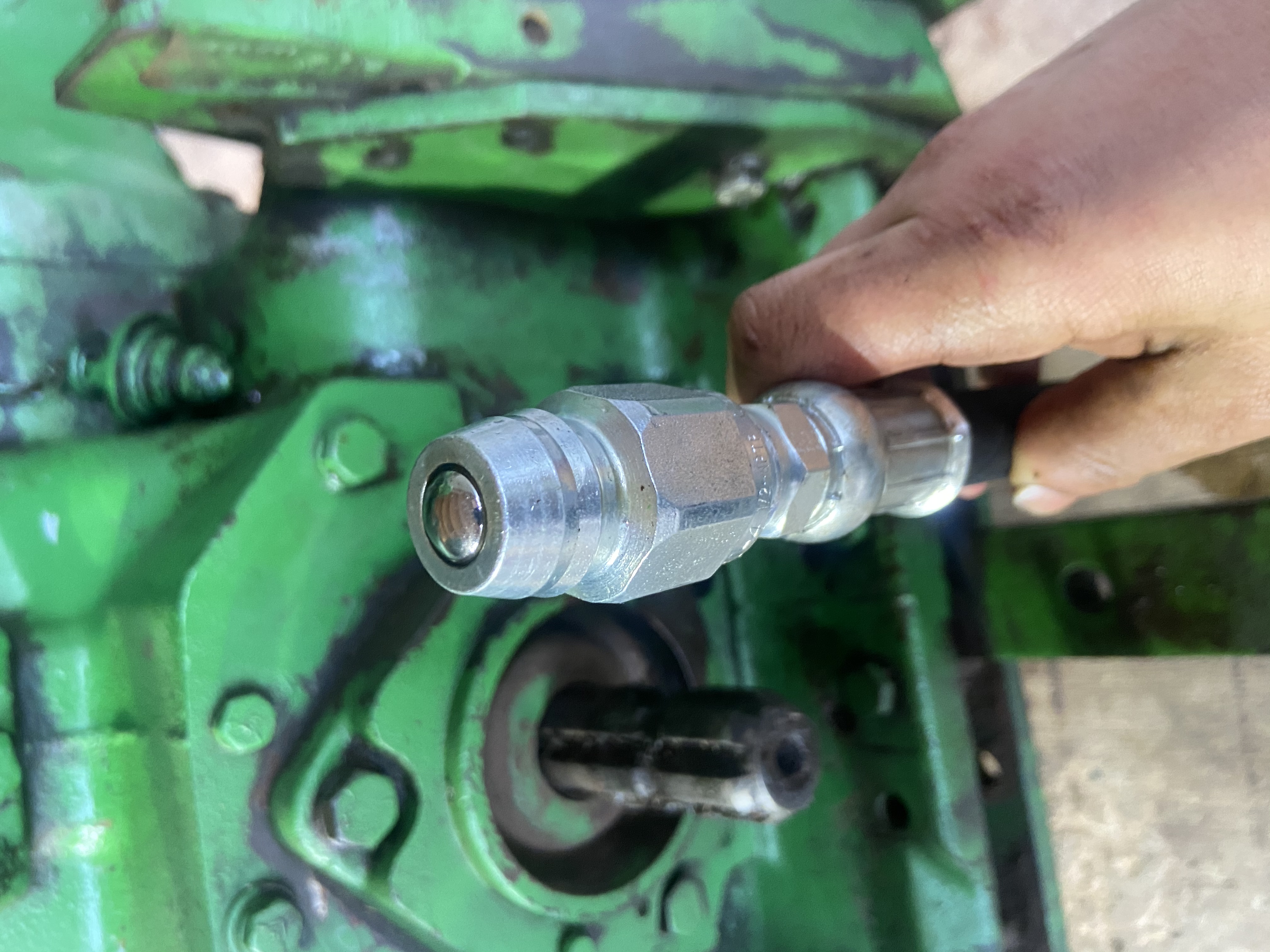

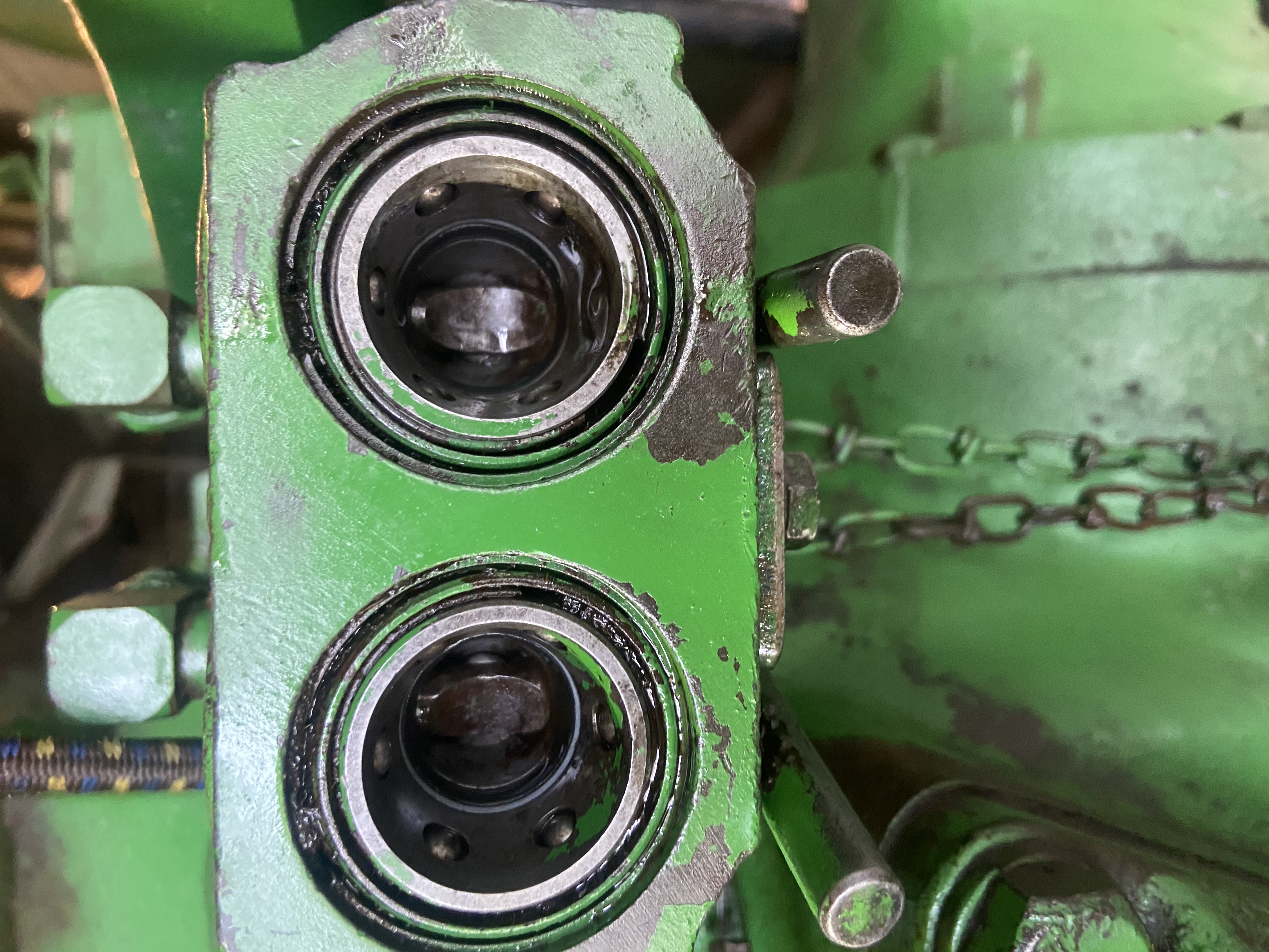

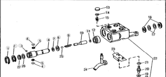

Here is the question. I bought these male aux. hydraulic fittings to fit into my rear remotes (Pioneer VP5060-4 hyd tip for 1/2'' NPT hose). They don't fit? What are the proper ones to use with my old JD style rear remote ports?
Thank you in advance all!!! I want to get my 3pt hydraulic top link going.

In order for those CORRECT male tips to be installed one must slide the barrels(item 6) rearward in cast housing so the retaining balls can spread out wide enough to accept male tips.

HAHAHAHAHA!!!! I knew I was probably missing something, and you in fact led me in the right direction. :thumbsup::laughing:
Ok, so I got the left one to function as you described. I will try again this morning on the other side.

Also, the lever on the bottom must be moved to depress the ball or poppet of the male tip and ball of female coupler.
The lever has to be turned 90° from parallel to the hose. Counter intuitive. JD should have made them so when the lever is parallel to the hose you have flow, not turned 90°.
The "post" of the lever has indents )( for the balls of the couplers when parallel to the hoses.
Off topic; the posts of these levers leaked on my 2030. I have replaced the O-rings at least 3-4 times.

Thank you very much Tx Jim and Zebrafive for the clarification(s). I was able to get the hoses installed and the new hydraulic top link going.
Your post Zebrafive was perfect for me to understand what was going on. I looked at my manuals as well. I will try to do a better job of searching/reading my manuals before I post specific questions to you all. But truly, I appreciate all the support and willingness to help.

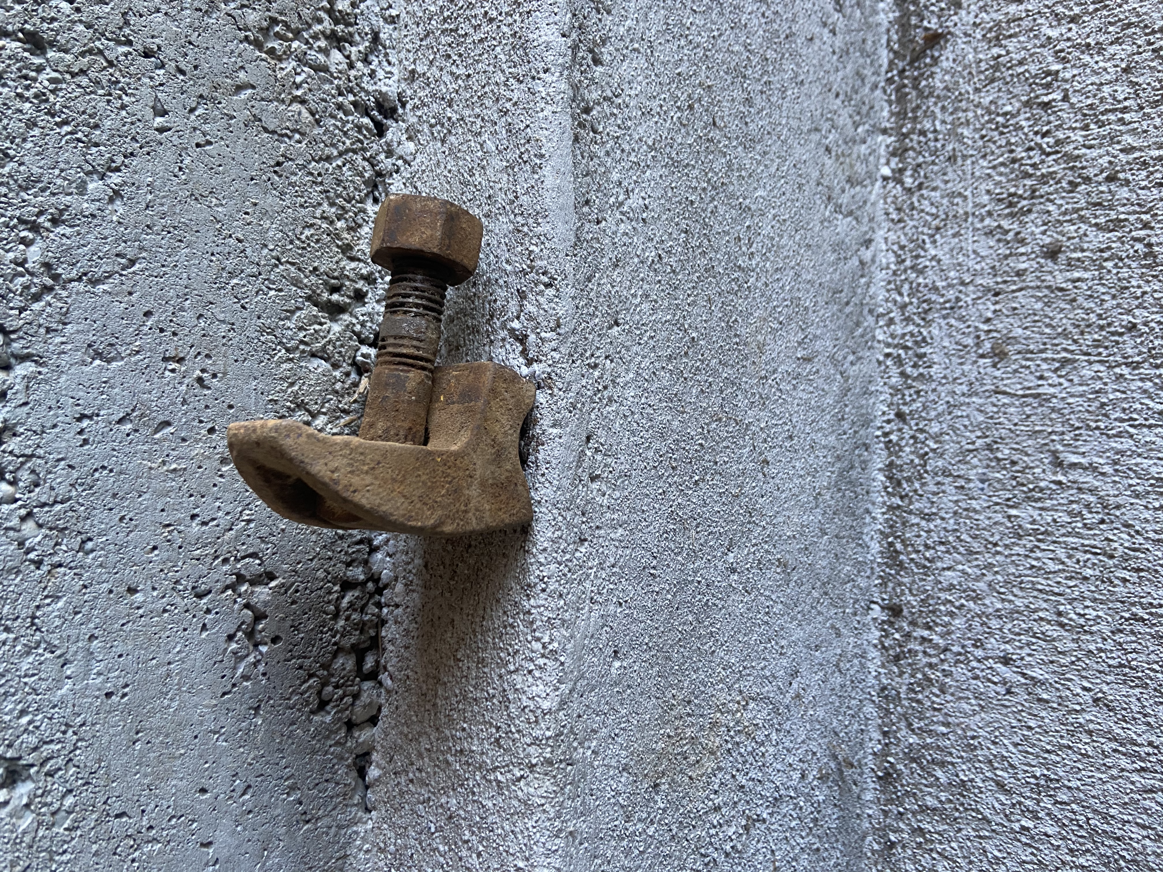

So I got the new rims and tires installed on the tractor. I installed them the exact way the old ones were done, and now I think I have made a mistake?
I don't know exactly what to call my style of rims (even after researching the JD parts catalog) but I am looking for clarification on the assembly that bolts the inner rims to the outer barrel. I have a square head bolt, nut, and these wedge style attachment clamps.
Here is a picture of how mine were, and are installed after I got the new tires and outer rim barrels.
I have the nuts showing on the outside. So the square head bolt goes through the wedge, and through the inner rim from the backside.
Per the picture below I got from another forum, are mine 100% backwards? Does it matter?
