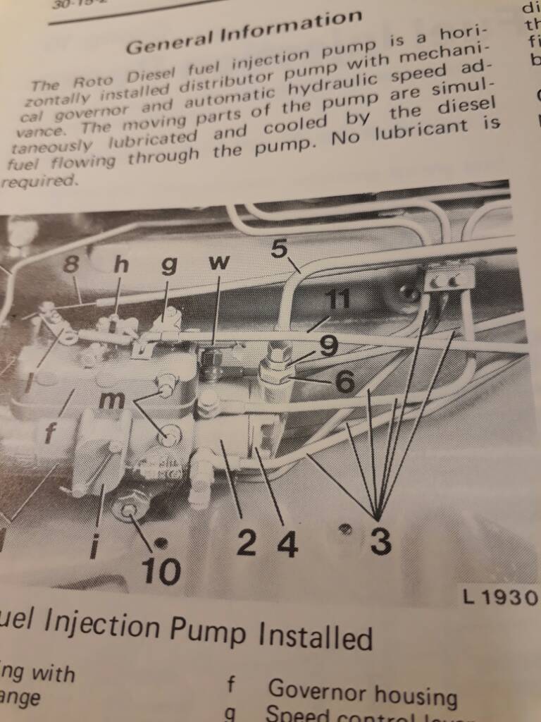

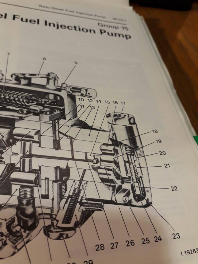

1972 ford 4000 3 cylinder diesel cav pump problem

You can remove the fuel inlet line.. fill the fitting w/ fuel.. spin the engine over & look to see if the fuel is gone, gone down..
THAT"LL tell you if the pump is spinning.. w/o taking it apart..
IF the fuel did go down.. the pump is rotating & the pumping plungers inside the pump are stuck & require disassembly..
I can do the rebuild for you if you like.. just send me a msg.. I do it for A LIVING..
