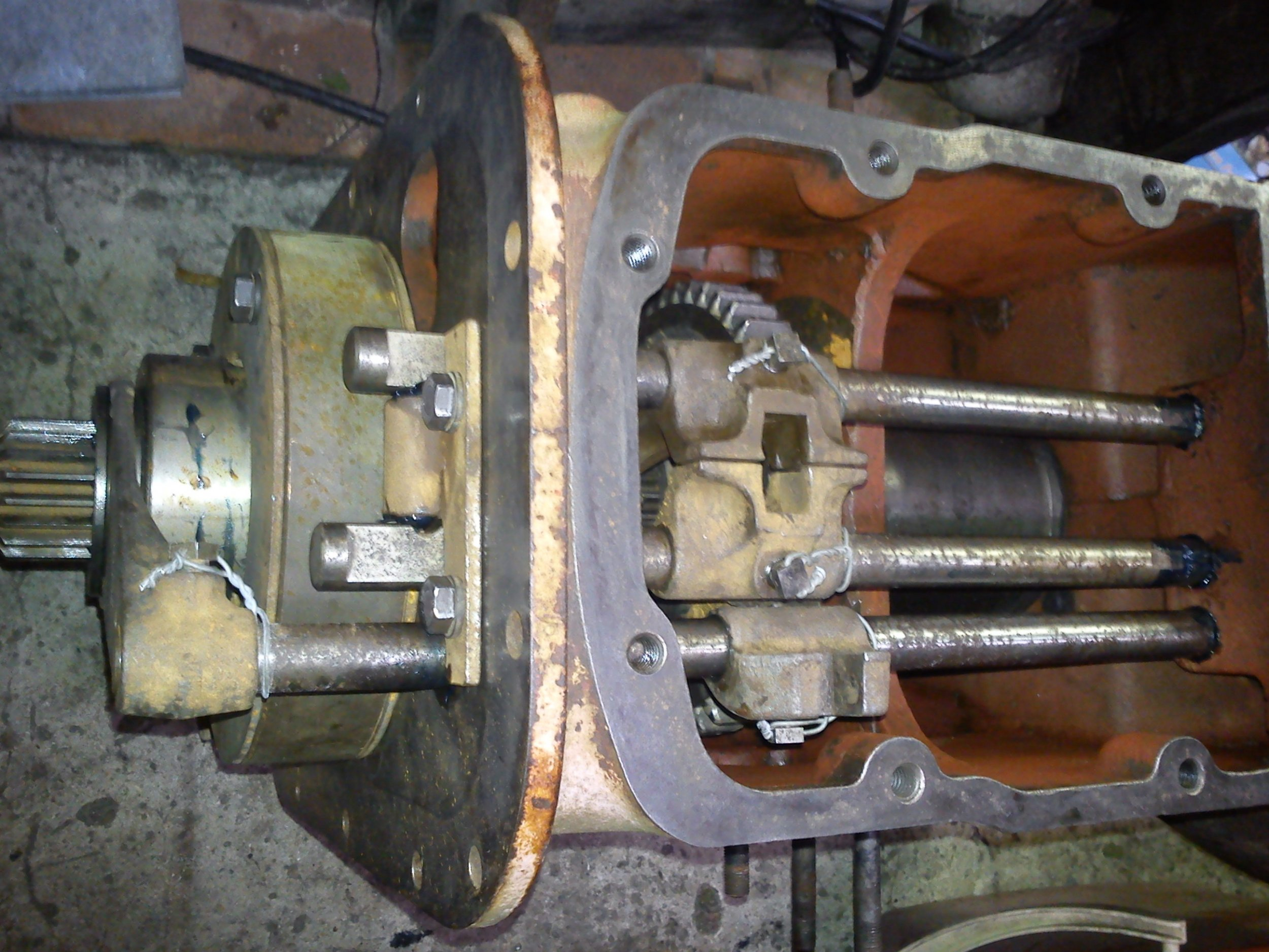

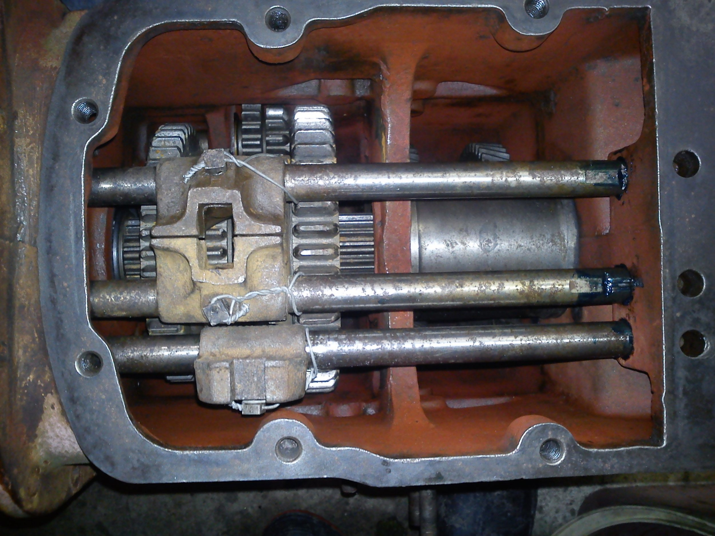

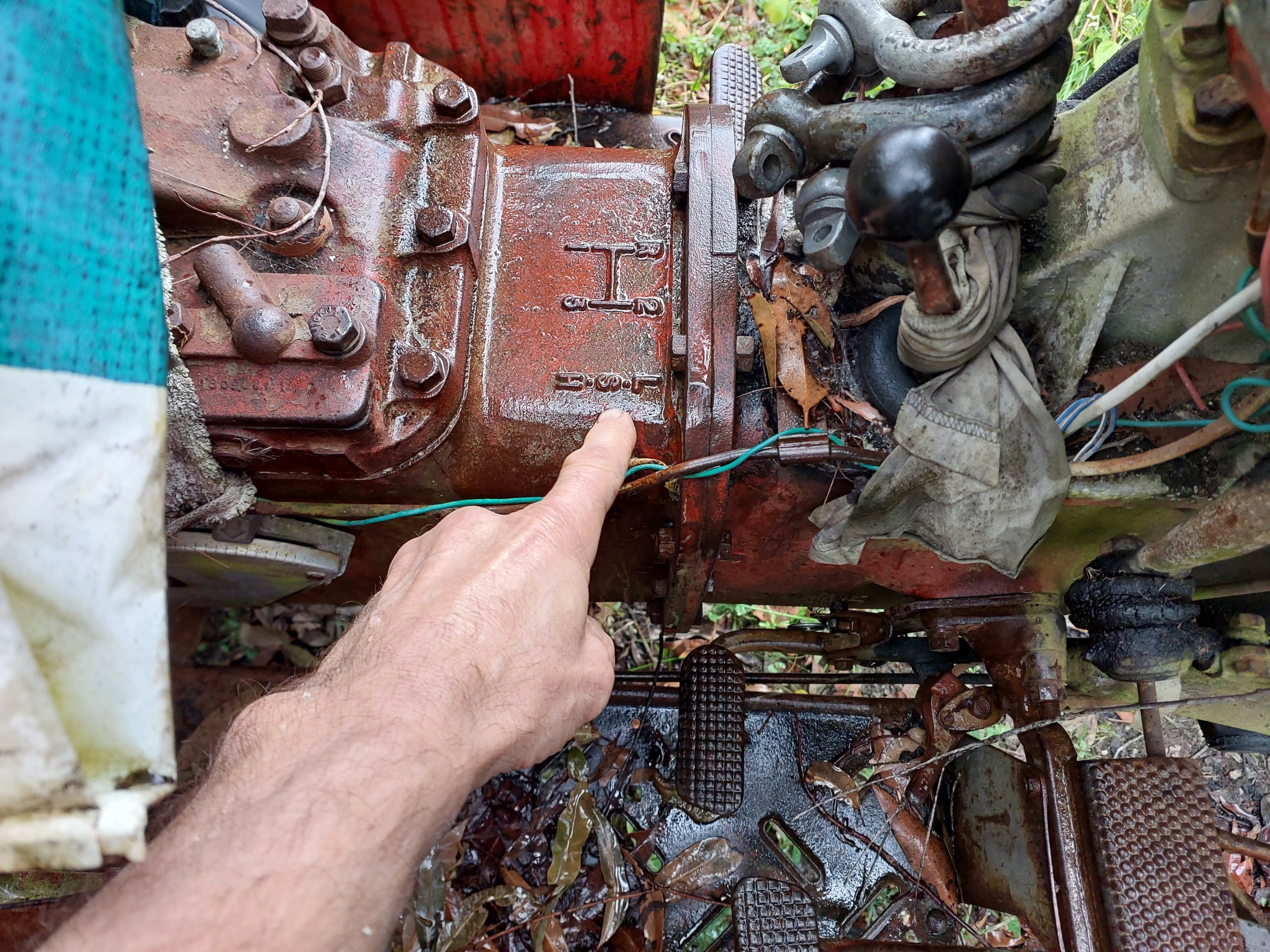

Just remembered that I have some pics of the gearbox from a friend's FE35 when I renewed all the bearings in it. I found these, thinking they might give you an insight to what yours looks like - it's the same as this one. They aren't as specific as I expected, but they're the only ones I have!
Pic 1 shows the low range reduction unit on the rear of the fully-assembled gearbox.
Pic 2 shows the same minus the selector cover.
Pic 3 is merely a closer pic of the selector rods and gate.
In Pics 2 and 3, the range change selector is at the bottom in each pic.
The square heads of grub-screws secured tight with tie-wire hold the selector forks and gate sections in place. They engage in recesses in the rods.
Hope this helps.

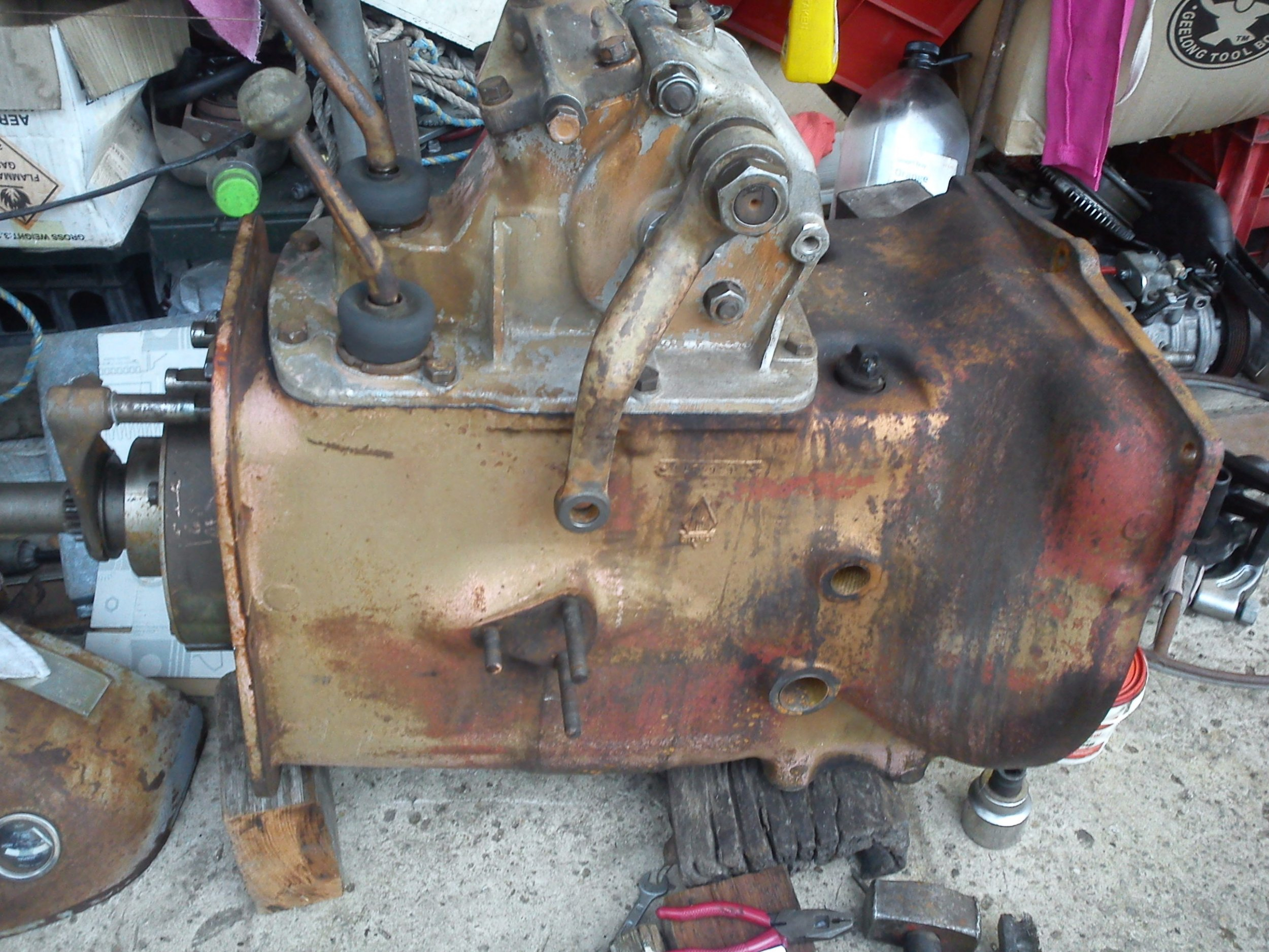

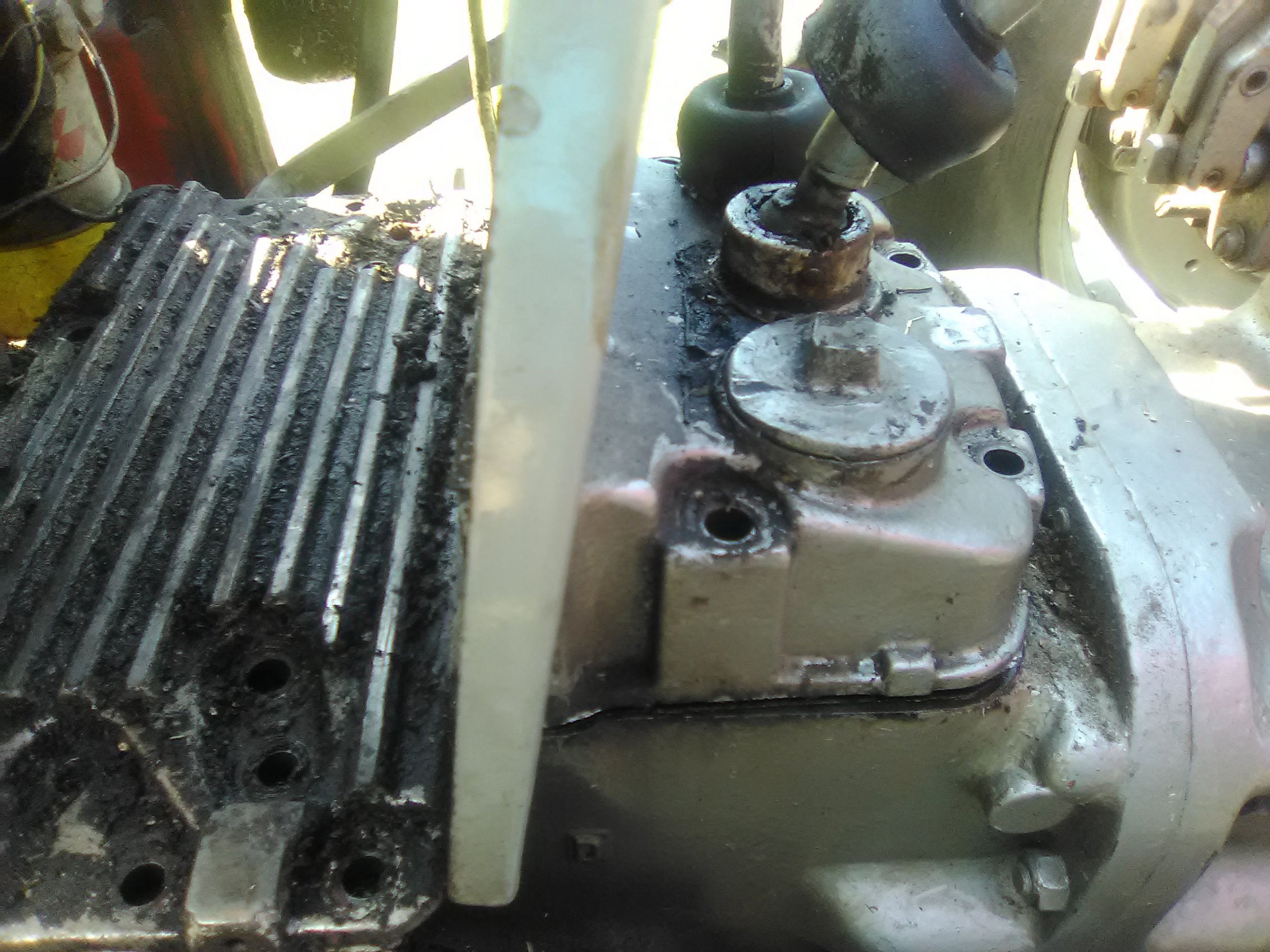

These photos are great, gives me an idea what I'll be looking at when I take the cover off which I'm about to do... I've attached a photo with the bolts out and ready to lift it off. Is there anything I should watch for as the shift mechanism disengages from the gears?
