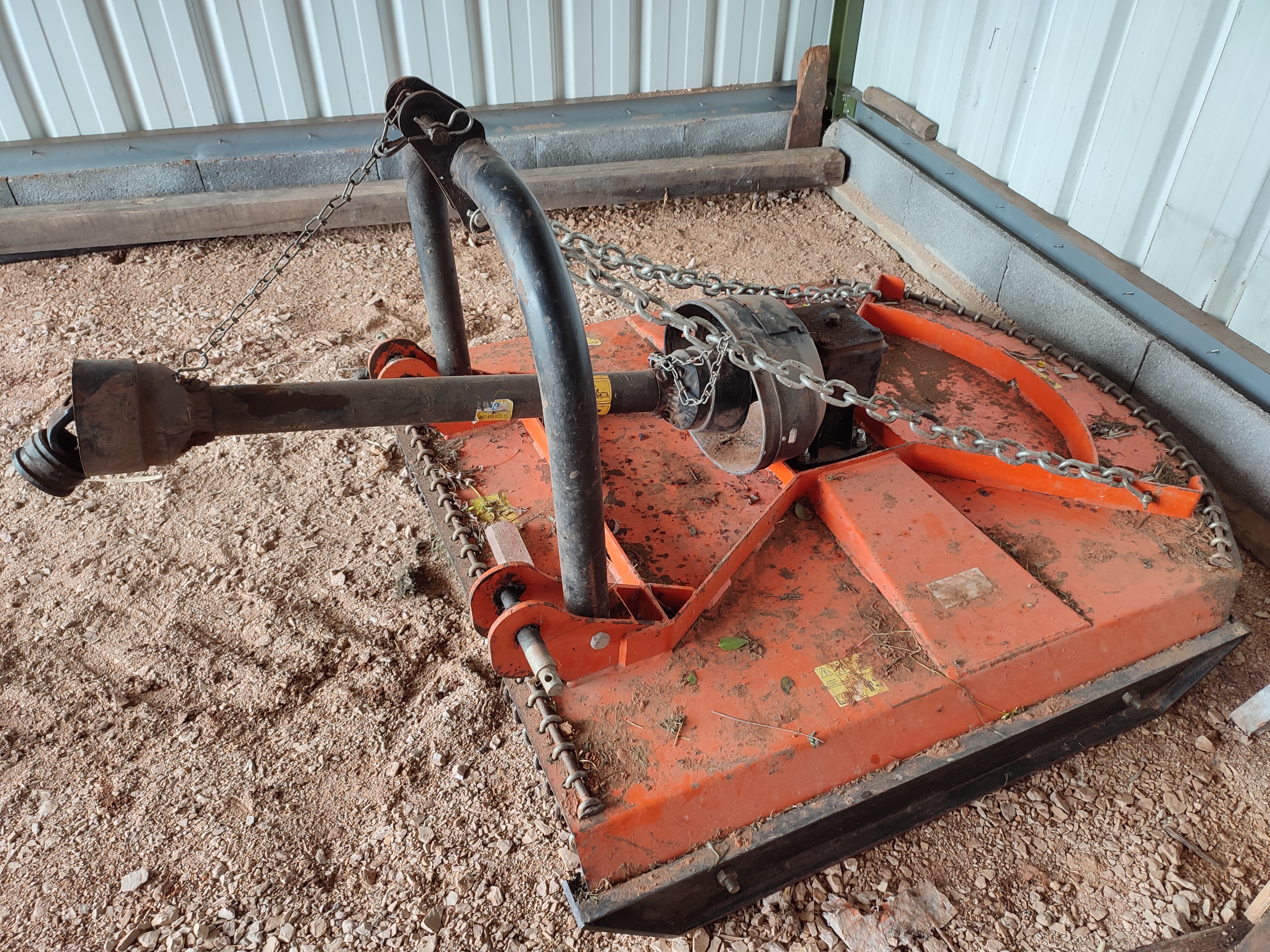

Never use a solid or hydraulic top link on a machine with a long wheelbase attachment. Supporting the tractor by the tailwheel and the front wheels (as in crossing a gulley) will eventually lead to some serious breakage (like tractor transmission case cracking, toplink mount broken, etc) . You should understand the mechanics of the inability of 3 supports unable to conform to local terrain. Use a chain or a rocker link assembly. This puts some slack in the 3 axle constraint (front wheels, rear wheels, tailwheel). Rear tractor axle weight usually wins. What are you you willing to sacrifice ?
Another vote for a chain between the top of the mower, and (in my case) the Quick Hitch.
The chain is barely visible in this photo. It is looped over the top of the QH.
Santa for your rough ground I recommend this solution.
So if I'm understanding correctly, you use a solid or hydraulic link to attach the quick hitch to the tractor, and then you connect the brush hog with the two lower arms to the QH and you use a short length of chain between the QH top link area and the brush hog? The only time the chain is taught is when you are lifting the hog?
I'd have to get my tail wheel working properly first to do it this way. I would imagine too that this is easier on your PTO.
   / 1st time at my new property & 1st time ever brush-hogging - some lessons learned
#24
It would be great if some of you that are using chains or flexible top links could post up close and clear pictures of your connections next time you're out. Learning here...
   / 1st time at my new property & 1st time ever brush-hogging - some lessons learned #25
Yes.
I happen to have a 3 ft piece of chain with a hook that originally stayed with my Farm Jack.
Now when the mower isn't in use I use this chain to suspend the mower's driveline clear of the ground.
Then for mowing, the chain is made into a loop just dropped over the top of the mower as well as looped around the top of the QH.
No need to duplicate this precisely. Just make some sort of flexible link back to the mower.

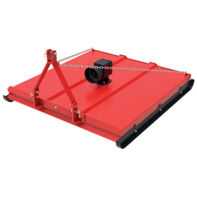

Many of the "slashers" used in AU have chains and no tail wheel.
Some instructions:
Bruce
   / 1st time at my new property & 1st time ever brush-hogging - some lessons learned #28
Some instructions:
Bruce
This mower has skid runners front to rear too, so it can ride on the ground without damage. The square deck increases tail-swing when mowing around things.

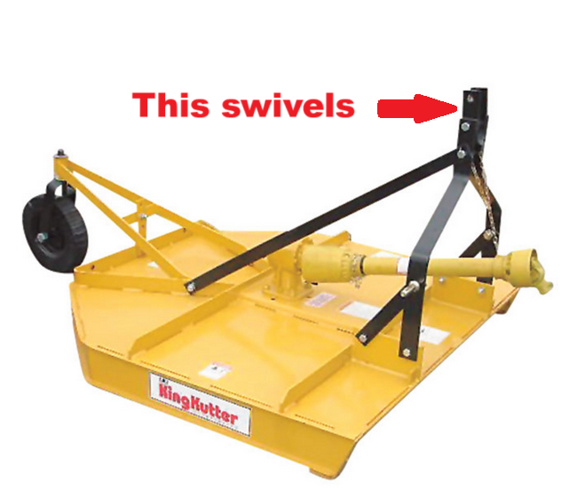

For my first attempt, I attempted to clear some area in the woods and quickly discovered that rotary cutters are not meant for uneven terrain. Besides just the shear difficulty of maneuvering with it, I experienced a lot of issues with binding my top link. Only after I got home and watched some more brush hog videos, did I discover going on uneven terrain was kind of a no-no, especially going in and out of valleys/dips/etc.
Other issues I had is that my hydraulic top link quick connect kept popping loose. Not sure why that was happening.
And the other fittings on my top link kept loosening, causing me to loose hydraulic power. I'm assuming all this was because of the binding. I guess I'm pretty lucky I didn't do any major damage to the PTO but it didn't bind up. But you live and learn. Kind of a tractor rookie here. Have some seat time, but not at doing anything more than a little light gardening work for years.
Make sure your PTO shaft isn't too long. That could damage your tractor.
Also, most rotary cutters I've seen have kind of a swivel at the top link so it can give some slack on uneven ground. Please post a picture of yours. If you don't have that, or its travel is insufficient, you may have to rig up chains to the back.
Mine came without that (from auction - not new, but still "unused"), but I couldn't see a good spot to attach the top link, which was a good thing, as I would've probably wrecked my PTO first time out. Instead I went looking for how to connect it and realized that swivel was missing and ordered and installed one.
Generally once I get the cutter on the 3ph, I adjust the top link so that the swivel is in the middle of its travel, so that the back of the cutter can be pushed up by the terrain (if backing into a hill, or driving up a bank), or the back can drop down (if driving down a bank, or backing towards a bank, like my pond's dam).
I should replace the A-arms with chains as @ptsg recommends, which will give even more safety margin to the PTO. I'm not sure there's an actual downside to doing that?
