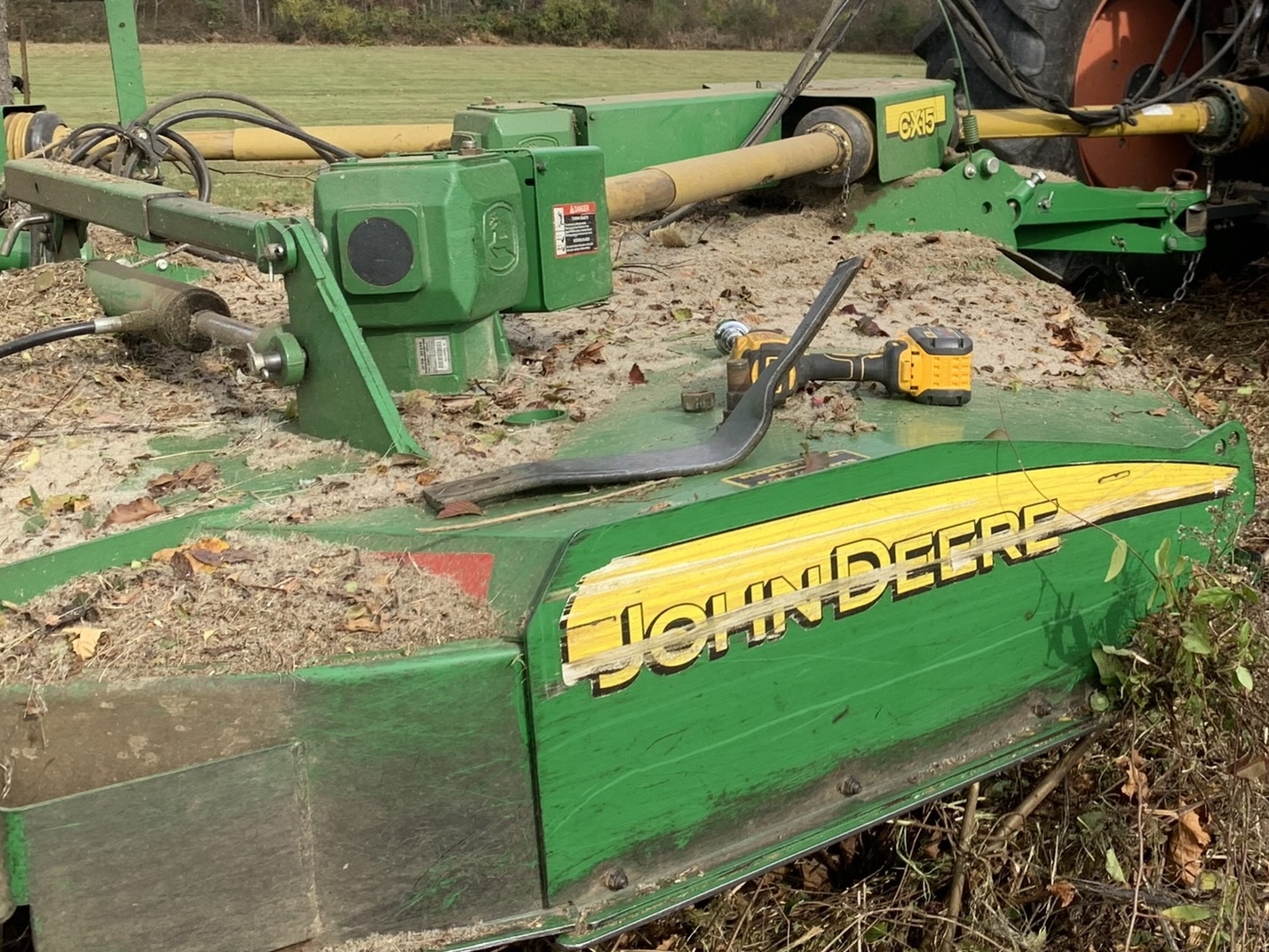

Rocks can certainly bend/break blades. Both times in recent years I bent or broke one, I did it while backing up.
Here’s a bent blade-real bent.

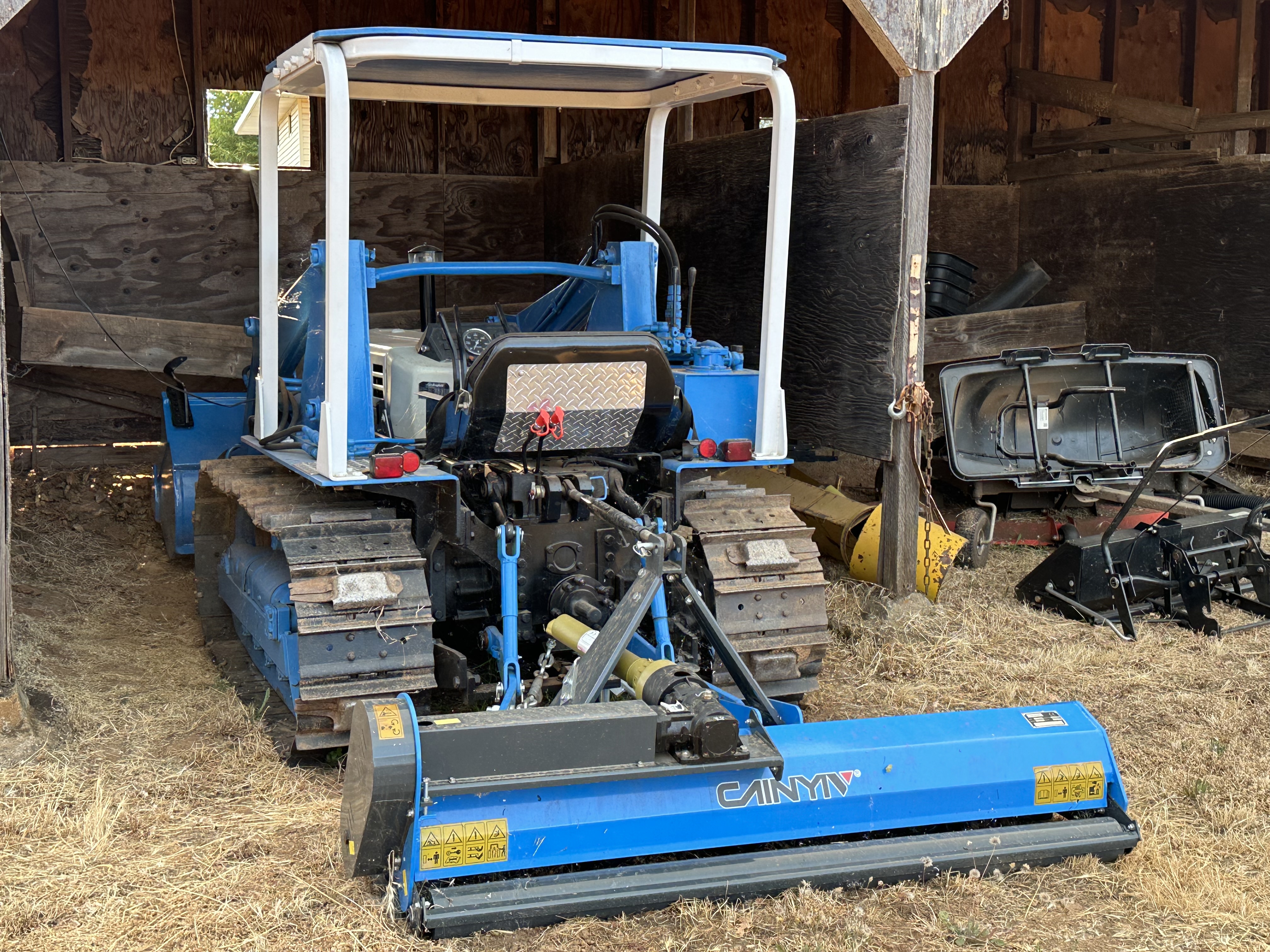

Here’s my mowing rig. I have 5 acres that are uneven, not hilly, but not flat. There are a lot of rocks in some areas. In this picture I haven’t actually used the flail mower yet, that’s why it looks so clean (you can see the PTO shaft isn’t hooked up yet). So far I’ve mowed most of the 5 acres twice. It works well except that I’m on my 3rd set of belts (it uses 3 matched belts). It is very good at finding old poly irrigation pipe and wraps it up fast on the cutter. Usually the first indication that it’s stopped is the smell of burning belts. A couple times I caught it and was able to cut the tubing out and keep going. I have a friction clutch at the PTO shaft for hard stops but the belts seem to be the weak link. But for mowing, it’s a beast. I mow through tall weeds and some small brush at a pretty good clip.

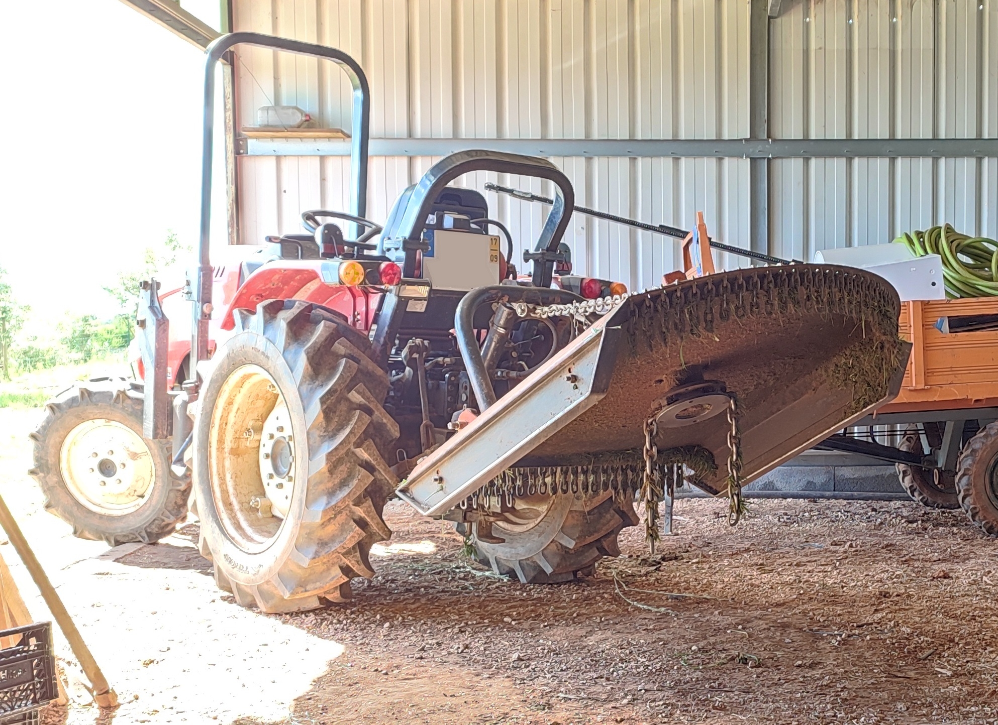

I hit rocks all the time... And stumps, stoves, walls, whatever. The list goes on. Just makes a loud banging noise, raise the cutter up, keep moving or move over and lower it back down and cut along. Chains just don't care about any of that.
If I don't know the land I'm cutting and it's tall brush, at last over 2 ft or so, I go in reverse. I let the cutter find all the "treasures", rather than risk damaging the tractor.
Worse case scenario, it shears the shear bolt. An 8.8 grade M8x50 mm bolt is easy to change and much much cheaper than a stump pulling on the suction line an dump all the fluid on the ground or breaking the hydraulic filter housing.
