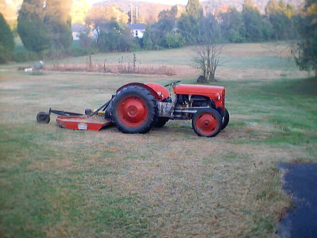

Seen your post over on another forum and answered there.
As other have said, drain the fluid out of the rear. The tranny & rear uses the same fluid. I had a similar water contamination problem on an old TE20 I had just purchased and an old timer told me to drain it all out then refill with kerosene. Run the engine and work the lift for a few minutes then shut down and drain the refill with a 90w GL1 fluid. My TE20 was still running great 15 yrs later when I sold it.
That leak in your pic is one of the high pressure hydro output taps. The plug may be loose or you may try some teflon tape on it. If the time ever comes to where you want remote hydraulic power then this is one of the ports to connect the lines.
Thats a very nice looking TO30, it's worth fixing.
