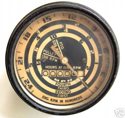

Whether I do or don't get one... Can anyone explain the markings on this one -- I think it goes to an 8N:

Yep.. that is a 8n or other 4spd tach.. the outter ring is the rpm x 100.. the inner rings numbered are the gear ranges and mph for ground speed.
For example.. at the listed 536 rpm onthe pto.. your engine speed is about 1500 rpm, and ground speed for 1,2,3,4 is:
2.6mph, 3.3 mph, 4.25 mph, and 10mph.. etc.
If ya want a tach, and don't want to hack and slash one on.. get a watch battery inductive pickup tach for a lawnmore or small engine.. i think northern tool sells them.. then wrap the pickup around a plug wire and stucky tape it to the dash...
