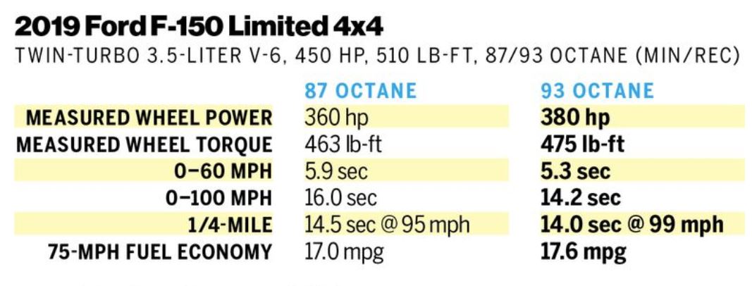

Car and Driver magazine recently tested several different vehicles to check the effect running premium versus regular would have on them. It made no appreciable difference to any of the vehicles - except the Ford Ecoboost. Premium gasoline netted better fuel economy and better power.
Is Premium Gas Worth It? We Test High Octane on 4 Popular Vehicles
The article refers to the "high output ecoboost" which is the 3.5L used in the Raptor version of the F-150 (450hp, I think). I wonder if the conclusions apply to the "regular" 3.5L and 2.7L ecoboost versions too.
They did not test the Raptor, they tested the Limited edition. Although it still has some awesome power ratings for such a small engine...That torque rating is better than my 5.9 Cummins!
Trust me, with a performance tune & 93 octane, a 2.7 F150 is a different animal. :D
I wondered about this. I also wonder how the rest of the drivetrain would hold up to more power 🤷*♂️
