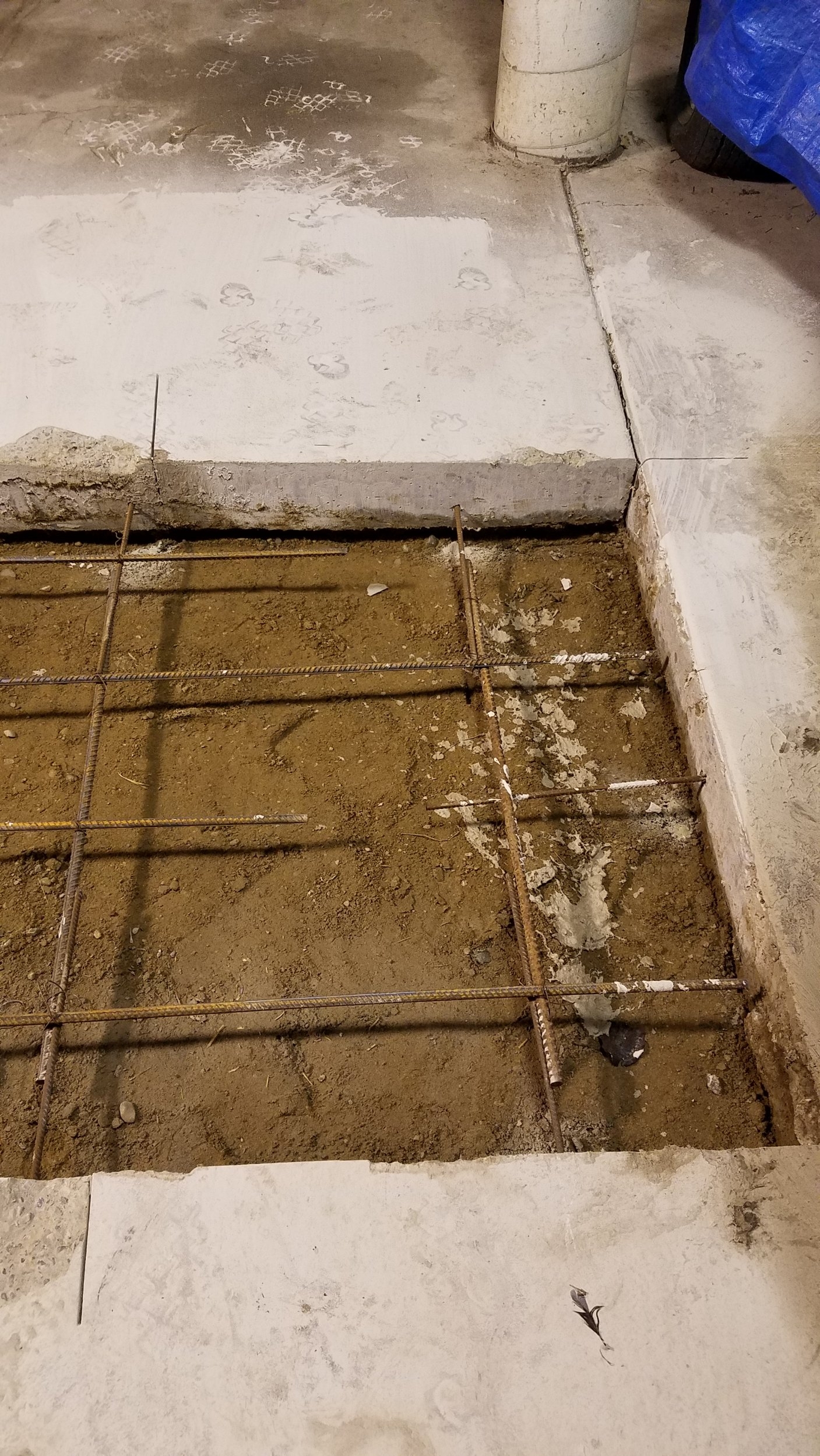

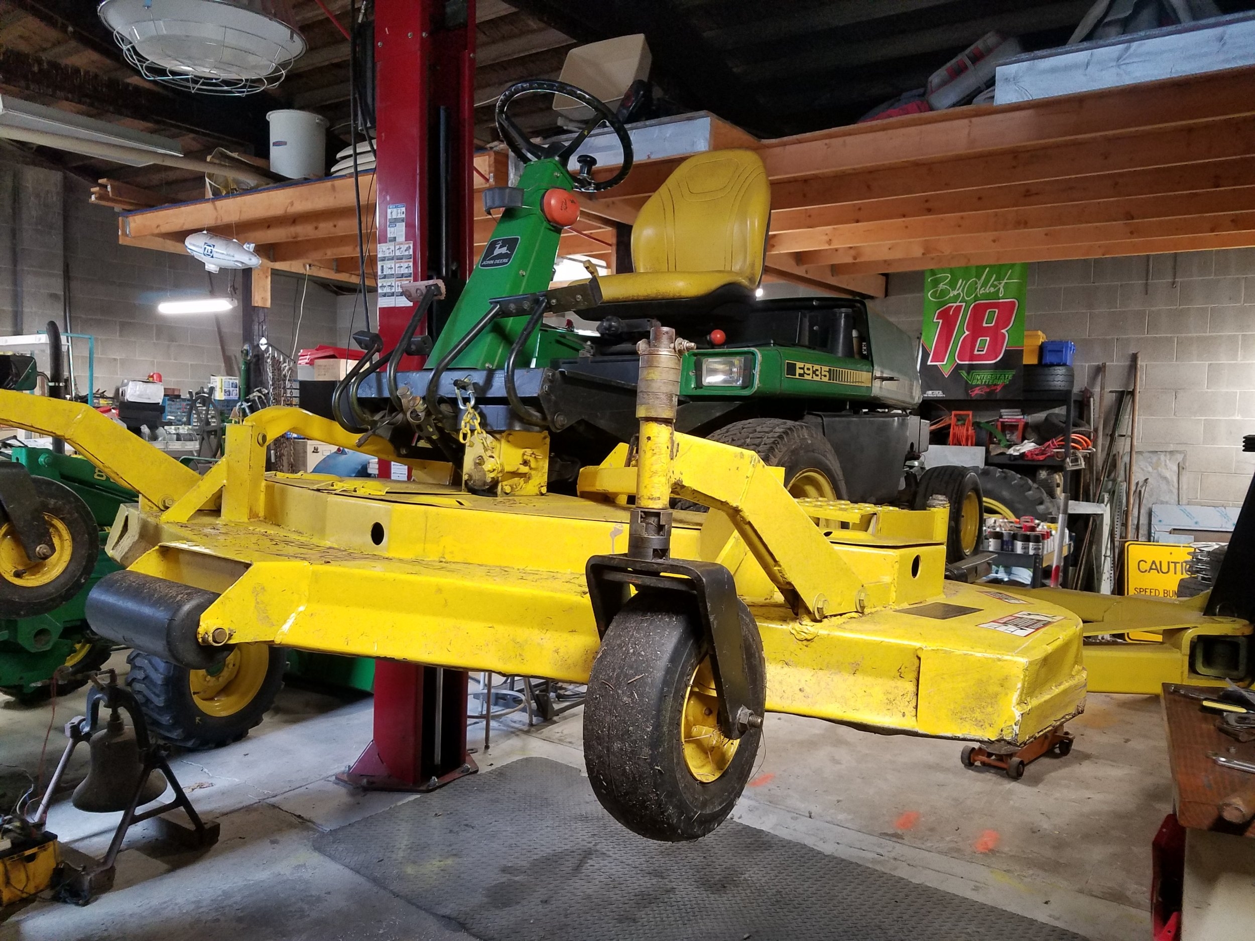

I like my Twin-post very much because it's not really used for car or truck stuff. Here's what my take is:
I used it to position and install the fully loaded 34" tires on my 1070 tractor. Stand them up on one of the arms, drive tractor in, remove old tire & wheel, hang on the other arm. Swing heavy tire into perfect position. Done. Nobody scared or hurt.
Have a pto shaft that won't come apart ? Well, those days are gone. A couple of chains and it's in 2 pieces.
Lawnmower blade sharpening and deck inspection ? No problem.
Have a Summer only mower to store ? up in the air all winter.

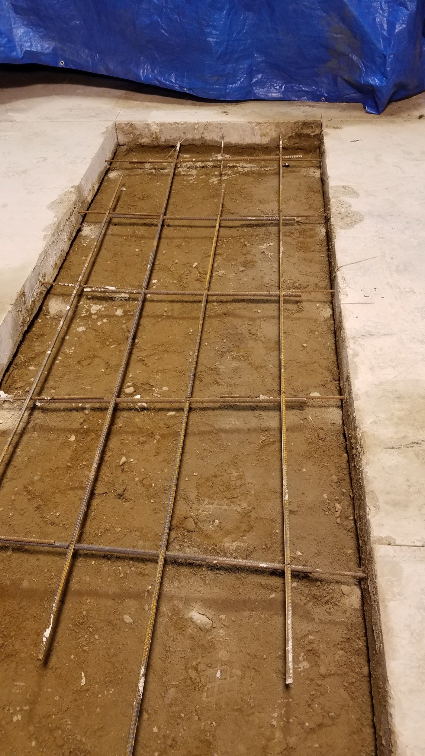

I did have to remove old concrete and install the welded rebar and a special concrete mix specified by the installing company and installers.
But, the mower servicing capability has really paid off.

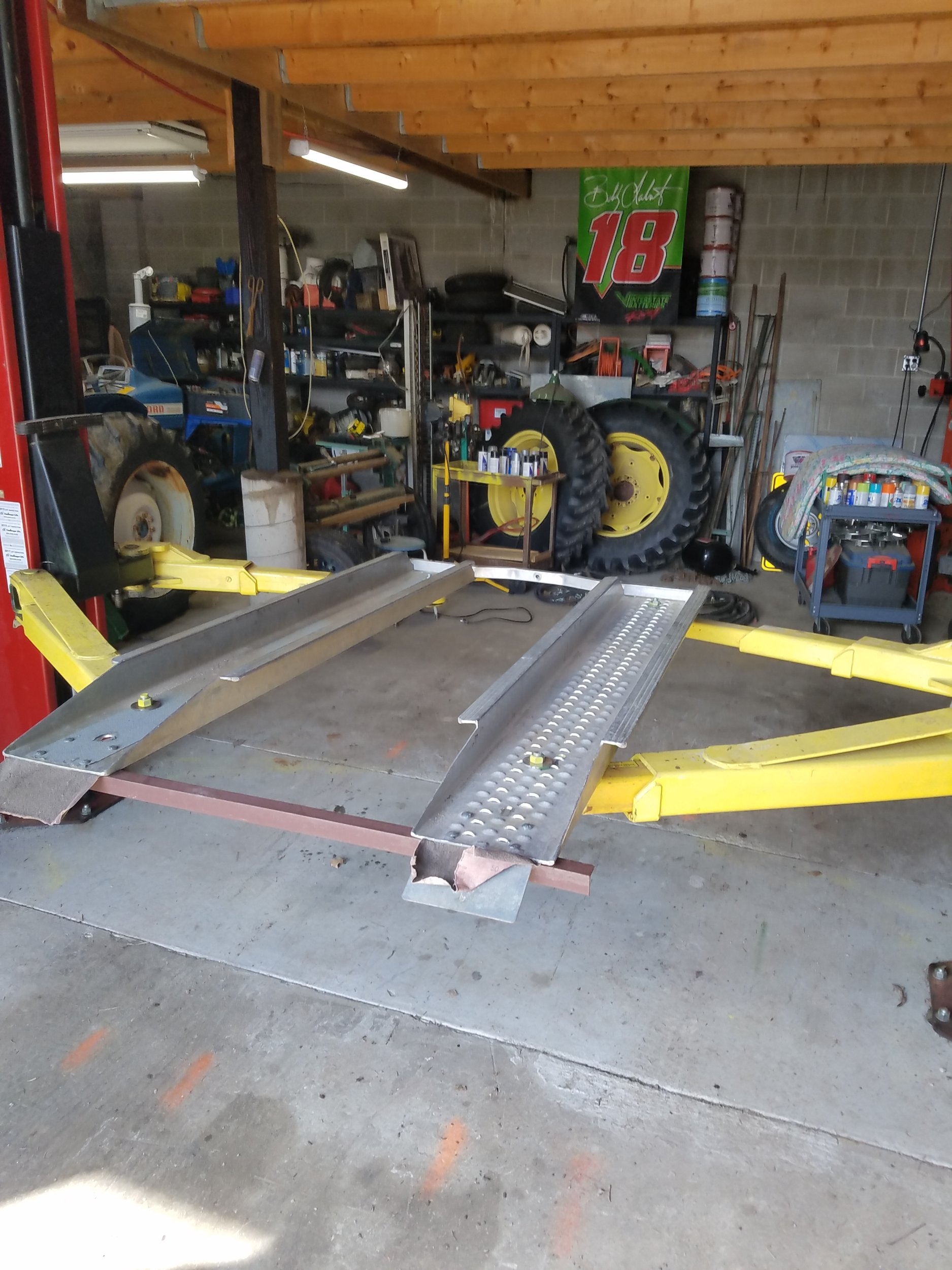

Here are a few pics I could dig up. The rack for the lawnmower is made from semi-truck car hauler ramps.
