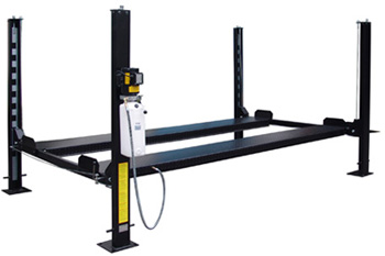

This would be the lift I would purchase. To change a tire very
easy to jack up one side at a time and no trouble to open a door
and don't have to mess with placing a padded arm to life vehicle
willy
That one looks a lot like the one I have. It was quite affordable.
Said not to have it outdoors, but that's where mine's been for about seven years now. Of course, I do keep the motor and fluid container covered, not to get rain and snow in the motor, and to keep the UV from ruining the plastic container.

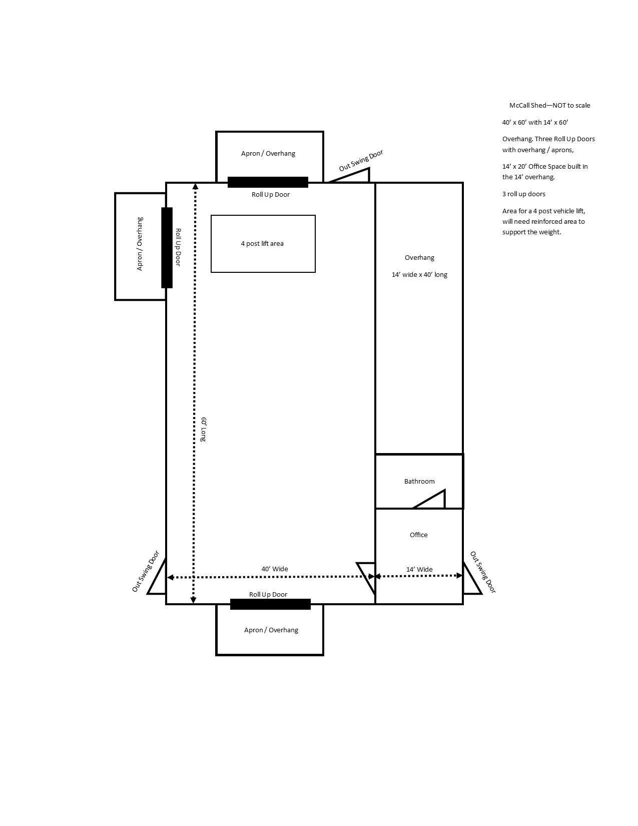

I searched the forums using the search function, and could not find what I was looking for. So, here goes. ADMINS, if this is the wrong forum for this topic, apologies. Let me know if it needs to move.
Ok, so... I'm recently retired from a very long 36 year career in the US Army. I bought property in South Carolina, and recently moved into my forever home. We just broke ground for my workshop, and here is my rough floor plan. I want a vehicle lift to work on my dually, my Jeep, my UTV, etc. but I can't decide on either a 2 post or a 4 post. I have read the pro's and con's of each, and still can't make up my mind.
My brother is a 30 year heavy diesel mechanic, and has a 2 post lift at his house. He has told me the differences, and his opinion on the matter. I've never had a lift before, but I know it is a must have for my new shop.
What are your thoughts, from those who have lifts. Also, which brand do you recommend?
My shop will be 40' wide, by 60' deep. I will have three 12x12 roll up doors with aprons, situated as shown in the diagram. I'm adding drains as well. The 14' over hang will have the first 20' finished off, and will be my office. There will be a full bathroom (toilet, sink and shower) in the office area.
Shop will be insulated, and wired with both 110v and 220v.
Looking forward to your insight. Much appreciated.
Doors on the side are best to me. I have one barn with end doors and one with side doors. Unless you just want to see outside the end door on the end with the side door and lift will be more trouble than benefit. You'll want that wall for tools and such with your work benches along the long inside wall. The other end door would be a waste for me. I'd put it in the side wall. You asked.
I have never trusted two post lifts since the day I drove up to the tire shop just in time to see a new pickup fall off and domino the whole shop. Operator error but still it fell. Access is better but there are things I value more. If I did put in a two post lift it would have deep drilled footings with plenty of rebar cage in them. As and engineer I've determined the overturning moment with a vehicle like my Ram diesel and didn't like the numbers, I know the bottom plates are designed for the bending and other forces but I still don't trust them, not with me under it all.
What about a high capacity mid-rise scissor lift? it is portable, you can build a welding table for it when not lifting cars, all four wheels are suspended so you can do brake work and tire rotation, the front is open to access the bottom of the engine. Yes, the tracks or rails do restrict access but it should be stable.
My only reservation for all lifts is the safety latch. I saw some reviews of scissor lifts with the lock track welds broken. Not comforting at all!
