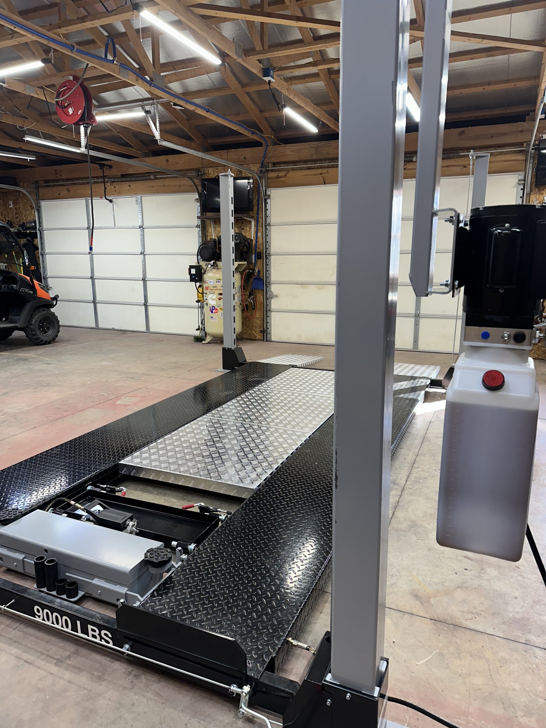

I really like that mower rack. I need to make something like that to do oil changes and the like. No reason you couldn't do it for a car
These are easy to install & remove. The lift arm pucks come out and the ramps then bolt in their place. I have marks on the floor to indicate placement when re-installing. Word of caution, though: The mower wheel tracks need to be the same otherwise the machine won't settle in safely.

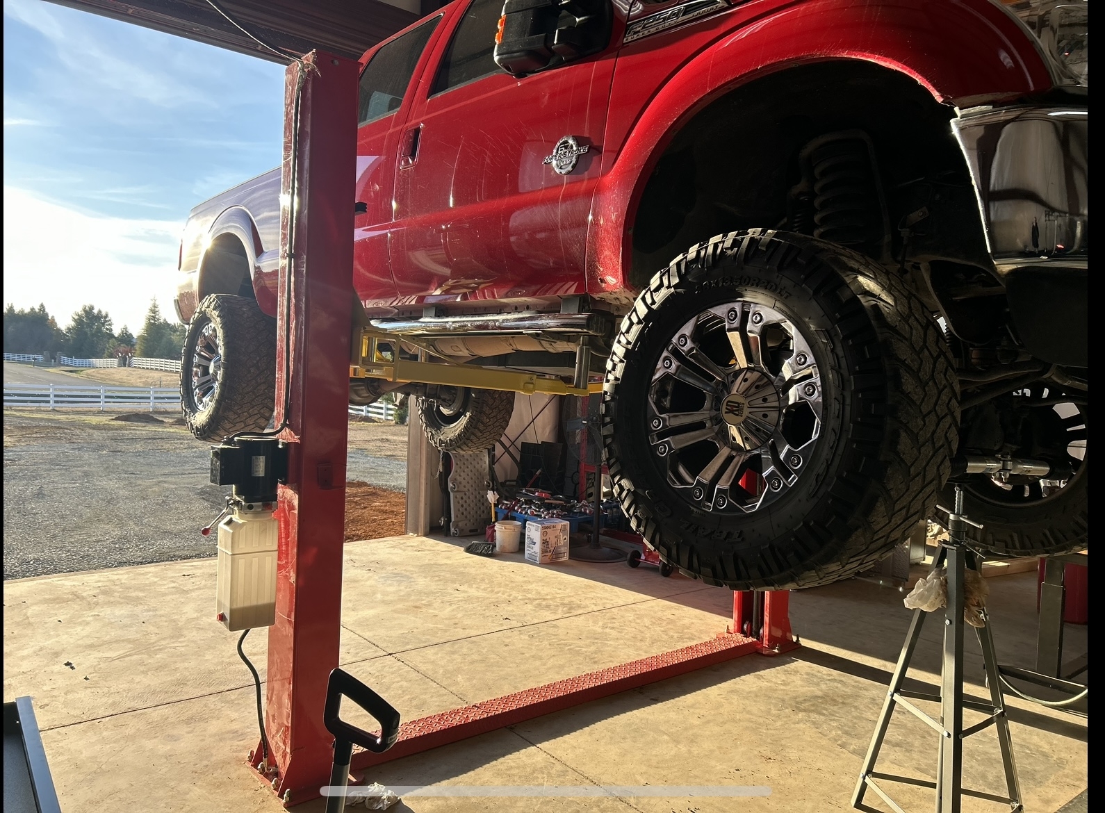

I have. A 2-post 9K auto lift in the right front of my shop. When I lift my crew cab F250, it puts my lift at its limit. I slightly offset it from the roll up door thinking I would need extra space for my tool box, but I am now in the process of moving it to center. Like another poster mentioned, keep it in the center of your roll up. I also agree that the electric should be run overhead. I did mine that way and have repeatedly found it to be helpful when moving the toolbox and hydraulic jacks.
The cons to a 2-post (IMO) is the spacing issue with the doors when on the lift. If I bought another one, I would look for something wider than I have now, but I would still do a 2-post. I have a hard time getting in and out of the truck/car when they are on the lift. Also, wouldn’t trust leaving a vehicle in the air unless I was using a car brace at one end, which limits your ability to get another vehicle under the one in the air. Lastly, as mentioned is having to get under the vehicle to find the lifting points. I bought the auto lift guide: Vehicle Lifting Points Guide (2024) - Autolift.org to help find the right points. Although any mods to your vehicles will throw off the lifting points(like an aftermarket gas tank or upgraded radius arms).
The pros to a 2-post are the minimal space it requires, the ability to work on tires/wheels and suspension, and varying widths of vehicles (lifting arm are adjustable).
I have a friend with a 4-post and he loves moving it out of the way due to the heavy duty casters. He can also park another vehicle under it without concern.
My last recommendation, as mentioned by another poster, would be to go larger. I have already run out of space. With your set up, if you go with a 4-post, go wider with your shop. If you go with a 2-post, go longer. If you have the money, do both!

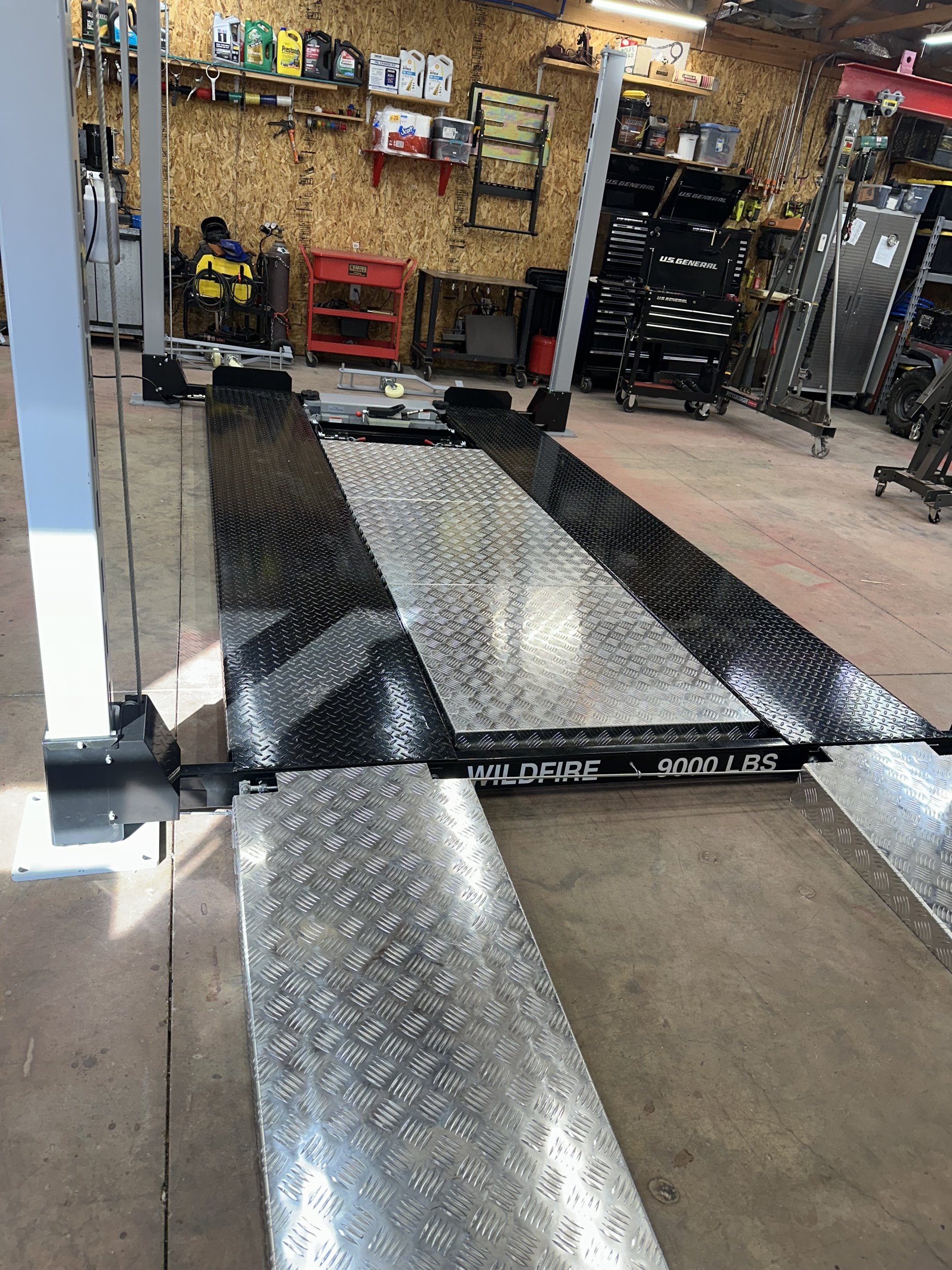

In the pic with the truck. I have a vehicle brace under the front. In the pic without a vehicle (screenshot from a video), the electric is run off the top of the post on the left and the lift is off center. I thought I would be able to pull straight in and swing the lifting arms under my cars, but that didn’t work as planned 👎🏼

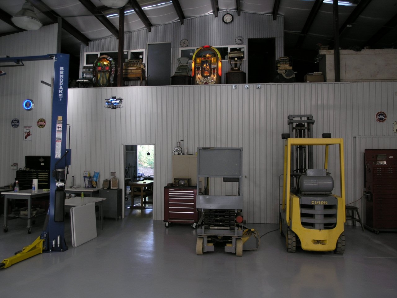

I am on home shop number 4. You have a a lot of pros and cons. One more thing is a 4 post takes up more space when not being used. I have had single post, too restrictive, I had a 2 post with both posts in ground, wasn’t too bad except for differential work. Now I have two 2 post units. Bend Pak 10K asymmetrical and a Nussbaum 7k. If you need to store a just add floor space. More useful.
One person gave reason commercial shops had both types. The real reason is they have enough work volume and workers.

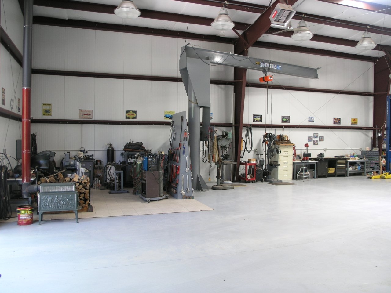

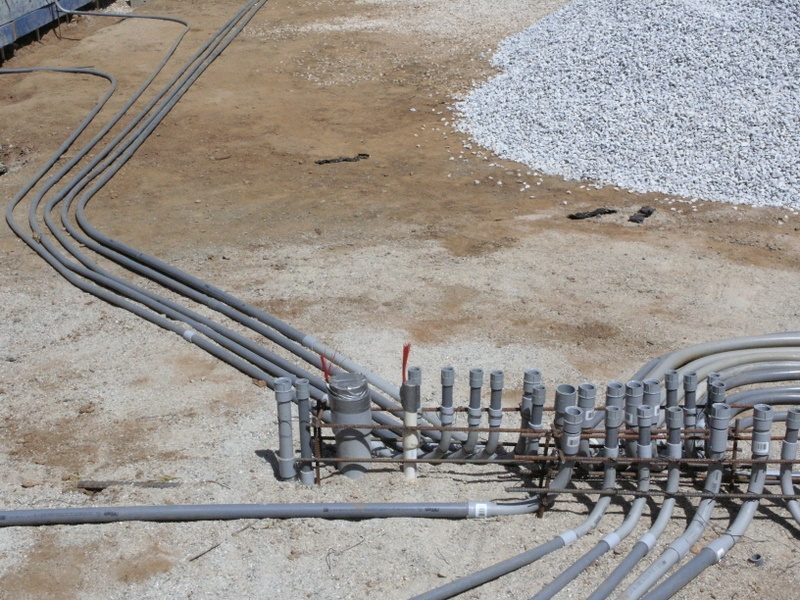

Now for the shop. Make the walls 20’ high so you can have plenty of clearance and add a mezzanine where you don’t need the height. Floor thickness 7” with steel on 16” centers and 4 bars minimum around a thickened perimeter footing. Consider electrical now and use all conduit and you can put conduits under the slab. Since you want insulation use foam insulated panels. Less waste floor space and quieter also. Look at AWIP for reference to find a manufacturer on the east coast. They are in California. Plan on infrared spot heaters as they heat the objects which is more efficient in bigger buildings.
