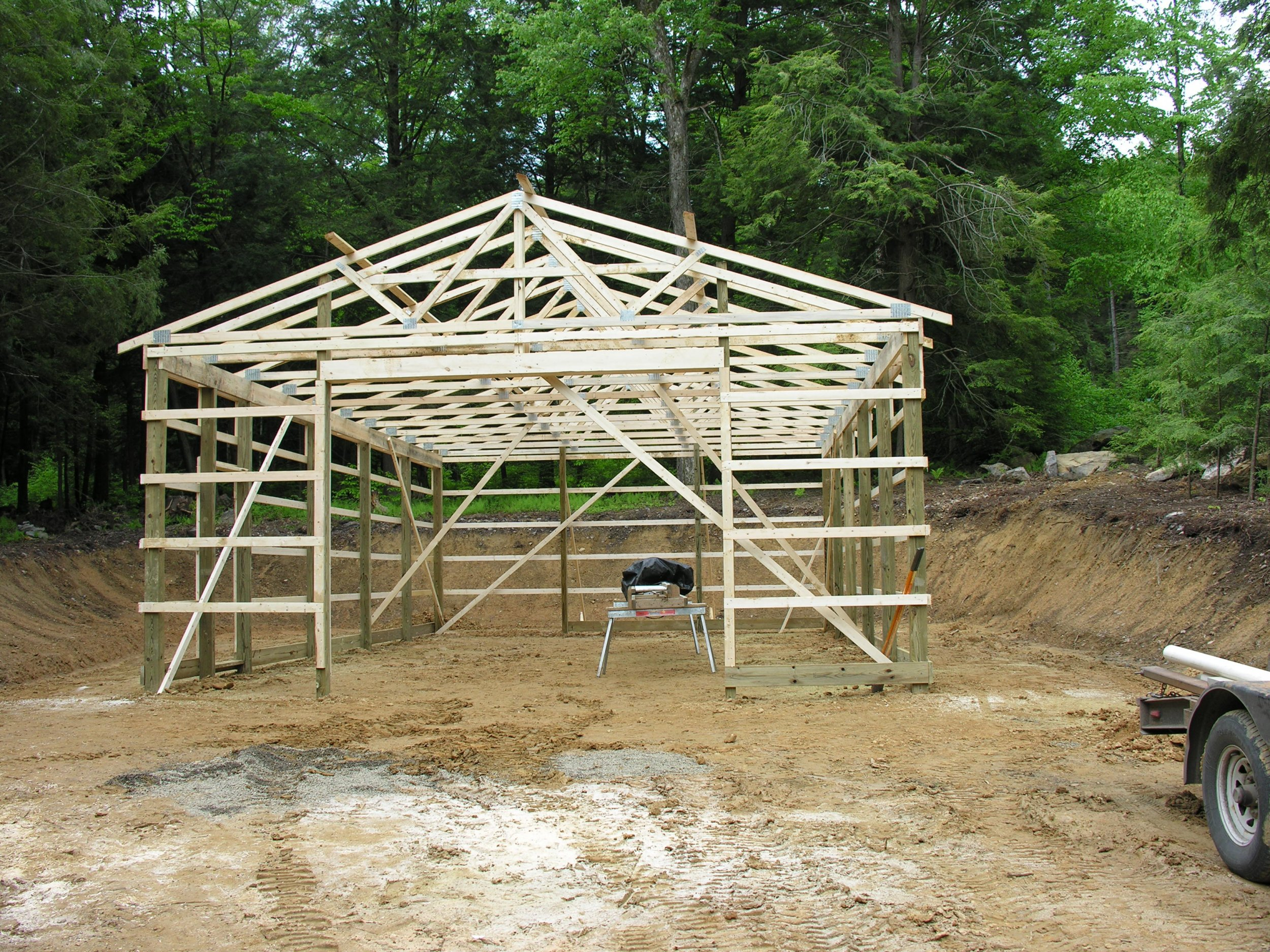

Side hill?
Dig into the side hill wider and deeper than than the pole barn. Dig & fill method. Get a nice gentle back slope to the excavation. If suitable use the excavated material to pad out in front of the excavation. Finally make a drainage ditch around the side and back of the excavation. Then use ordinary building procedures With cement floor.
Six foot depth may/will end up as less using cut & fill method.
This is what I did for my 24' x 40' building. That back bank is 7 foot high.

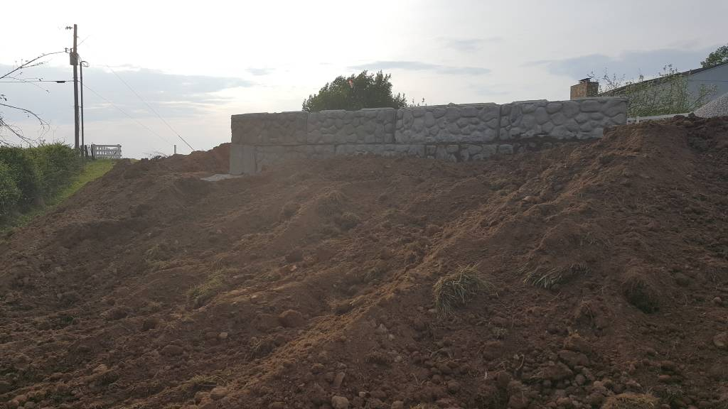

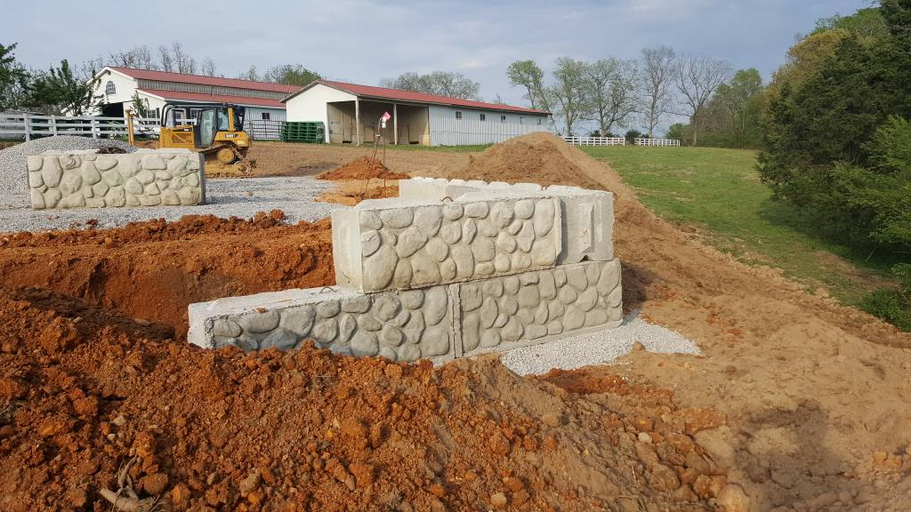

When i had the pad built up for my 36x66 shop we had the entry area at mid slope. Material was moved from up slope side (5') to downslope (6+'). The fill is compacted clay chirt. When i noted that the slope on one corner went too close to a boundary fence, the contractor pulled the slope back to original grade for the 10' clearance to the fence and brought in 17ea 2'×2'×6' blocks (3500lb ea) to make a retaining wall 5' off of the slab edges at the offending corner. The blocks are keyed and produced from excess concrete material. The exterior face of the blocks has a round river stone appearance. My wall was 3' high (2 courses). These blocks stack vertically. I should note that we are in TN, and our frost line is 6".

   / 20' X 24' Pole barn on 25% slope - best method? #37
What's the minimum setback per local code? 8' is legal, or are you just going for it? (Here we're at 30' minimum! o_O )

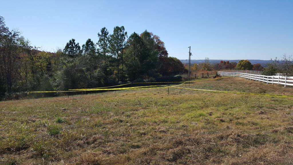

   / 20' X 24' Pole barn on 25% slope - best method? #40
Any way to move the building forward? Towards the garage door side? Gives the potential to have more slope to the road behind. Also your picture with the markers and sizes, seem lke the road is hidden by trees/bushes? This would be a lot easier if the ground sloped up and not down from the front. Good Luck. Jon
