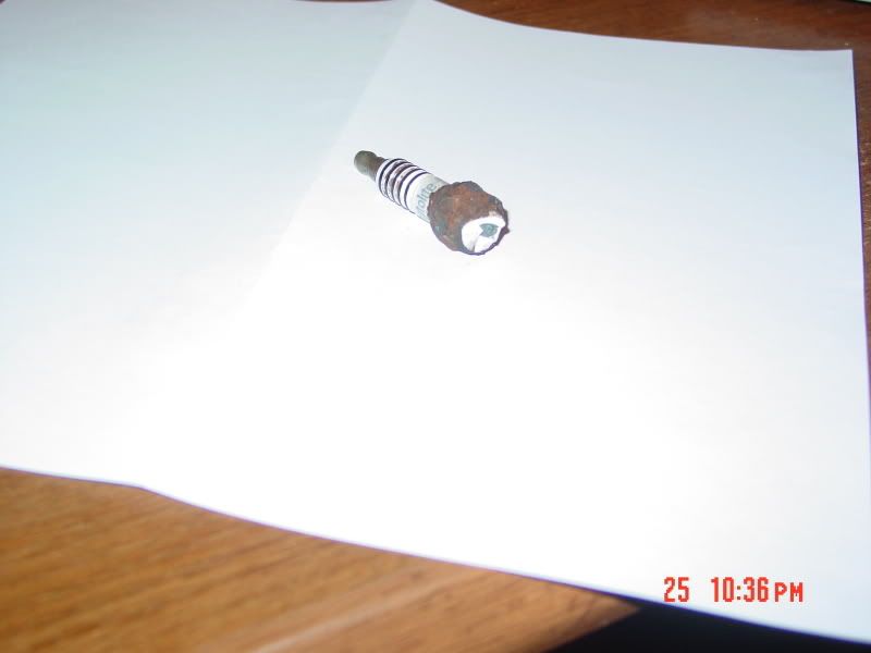

From various sites I've read online while doing research on fixes, it seems the early 5.4l 2-valve engines had 5 threads in the aluminum heads which lead to the blow-outs. They "fixed" that problem in 2002 with the 3-valve engine and 8 threads. The problem is they didn't redesign the head and instead went to a 2-piece spark plug design which was not fully threaded and that lead to the next round of problems for the Triton which was plugs seizing and breaking off in the heads...

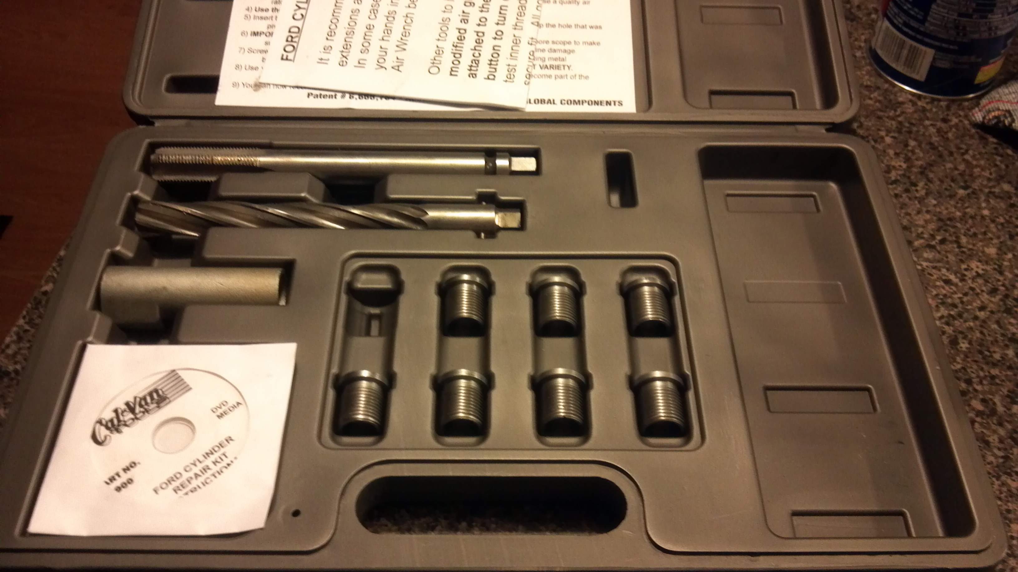

I found this kit from CalVan tools which is similar to the TimeSert kit and only $230 so I may have him buy this one instead. Either way, it will be a long weekend if we can get the tool in time.

First off, I'm not leaving the thread. I'm the one looking for help with this POS engine design. Dargo is just looking to start an argument as usual...
Secondly, the Mustangs had a different 4-valve head design and did not have the same problem. P.I. (performance improvement) heads were a Mustang (4-valve) thing as far as I know. I have heard of this problem with the 4.6l V8's too but not nearly as common.

For those still interested, we received the tool from CalVan yesterday. It was ordered through Amazon.com last week on Thursday using the standard 5-8 day shipping.
It took me a little over an hour as I've never done it before but it was very straight-forward and the informational DVD helped a lot. The kit as a whole is very well laid out and they thought of everything. Even a little hose with an air valve to find when the cylinder is BDC and the valves are closed.
After checking and re-checking, I connected the drill bit to my air ratchet and installed the guide in the spark plug hole. Slowly, I was able to drill out the old threads and clean out the debris with an air hose. Then I used the second bit that cuts new teeth into the aluminum head. Lastly was putting a little JB Weld on the new steel insert and threading it in along with a new spark plug to about 20 lb.ft. (The JB Weld is for the steel insert, not the spark plug). I let it dry for a couple of hours then started the truck and it sounds good. Much better idle, quieter and the two check engine lights (Bank 1 Sensor 1 Rich Condition and Lean Condition - P1131 & P1132) are gone. I must say, this tool is a MONEY SAVER!
I told him if I had to remove the head to fix the threads, it would be close to $1000 between gaskets, fluids, my time, etc... With this tool ($235 shipped) the whole job took less than 2 hours including prep and saved hundreds! I would have taken more pictures, but my hands were pretty dirty and I was excited to git-r-done!
Now to move onto the typical Ford rust in the door sills, rear fenders, rear bumper, bed supports, etc... :cool:
