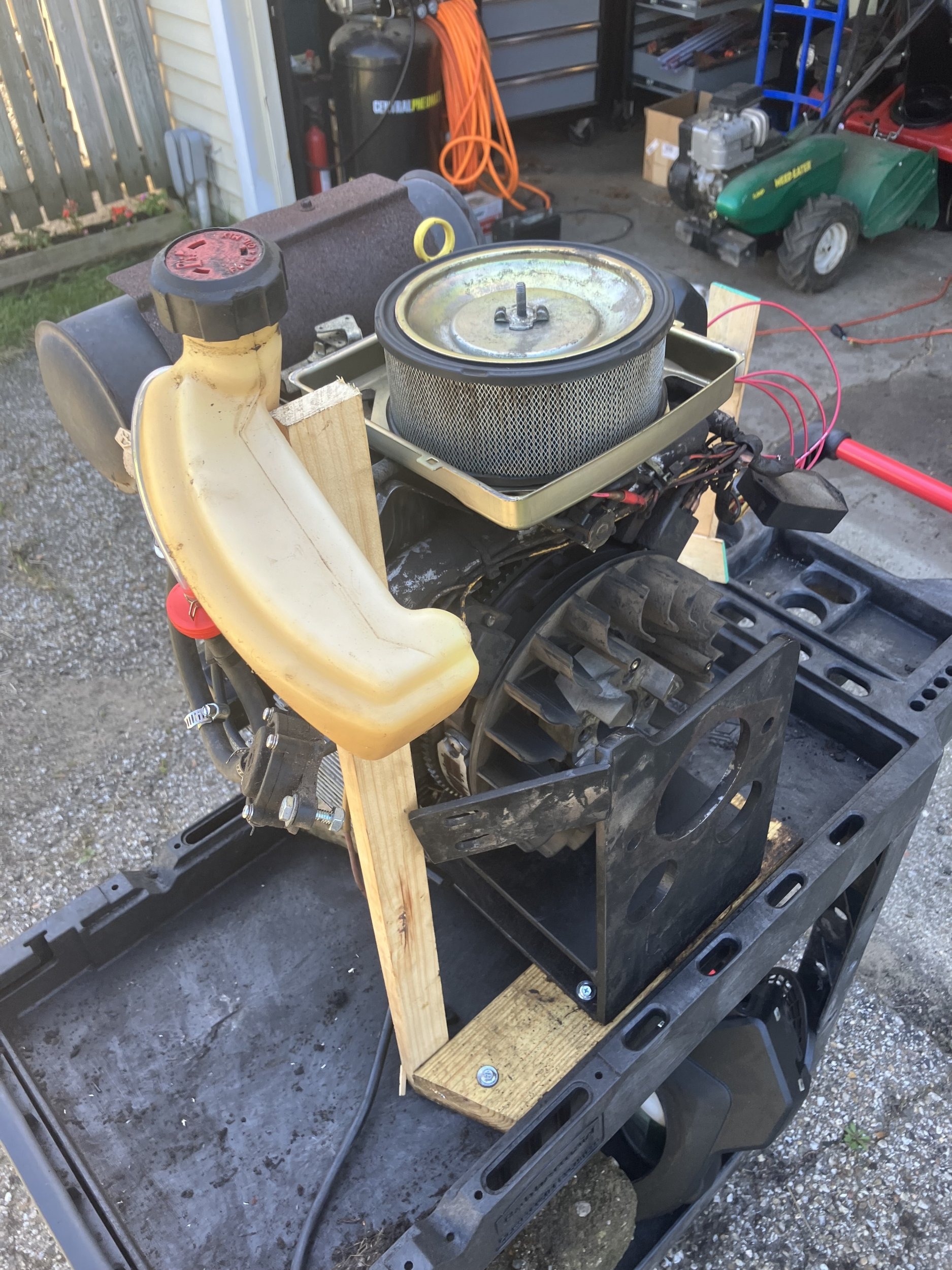

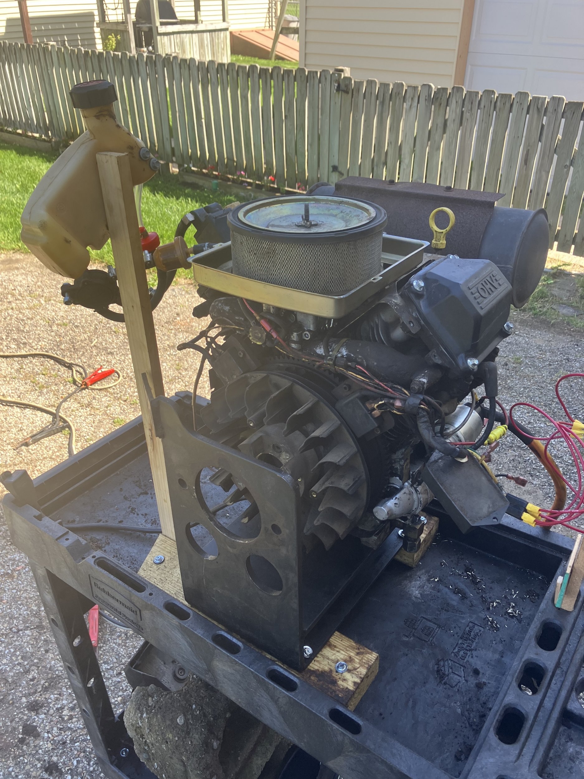

   / 2001 PT425 Kohler CH25 Oil Leak - Pull The Engine #65
Maybe best to find out first where the oil leak is and see what it would take to repair it.....
Just saying
Did you have someone to start the pt and watch to see where the oil is coming from before you pulled the engine? Is the leak like a weeping leak or is it spraying. If it is coming out of the tunnel, from the engine or from the pumps, or the oil tank? My 425 pt is a 2003 model and I have had to replace the hose for the quick attach, but I have noticed a few drops of oil on the floor between jobs. I think my hoses are weeping some but not bad enough to replace yet. If I ever see oil coming out of the tube going through the center section with the blue tube I plan on replacing them all at the same time . I will buy new hoses and fittings to connect the new hoses to the old hoses and pull in the new one as I pull out the old one. Last year I had to replace the fuel pump and the oil sensor. The fuel pump started leaking gas through the oil sensor and the gas went into the oil system and filled the oil pan up and it over flowed and pushed out what I first thought was oil but I could smell the gas and the dip stick was full to the top and you could smell the gas. Didn't cost much to fix , changed the engine oil changed oil filter and changed the fuel filter, it runs good now.
#66

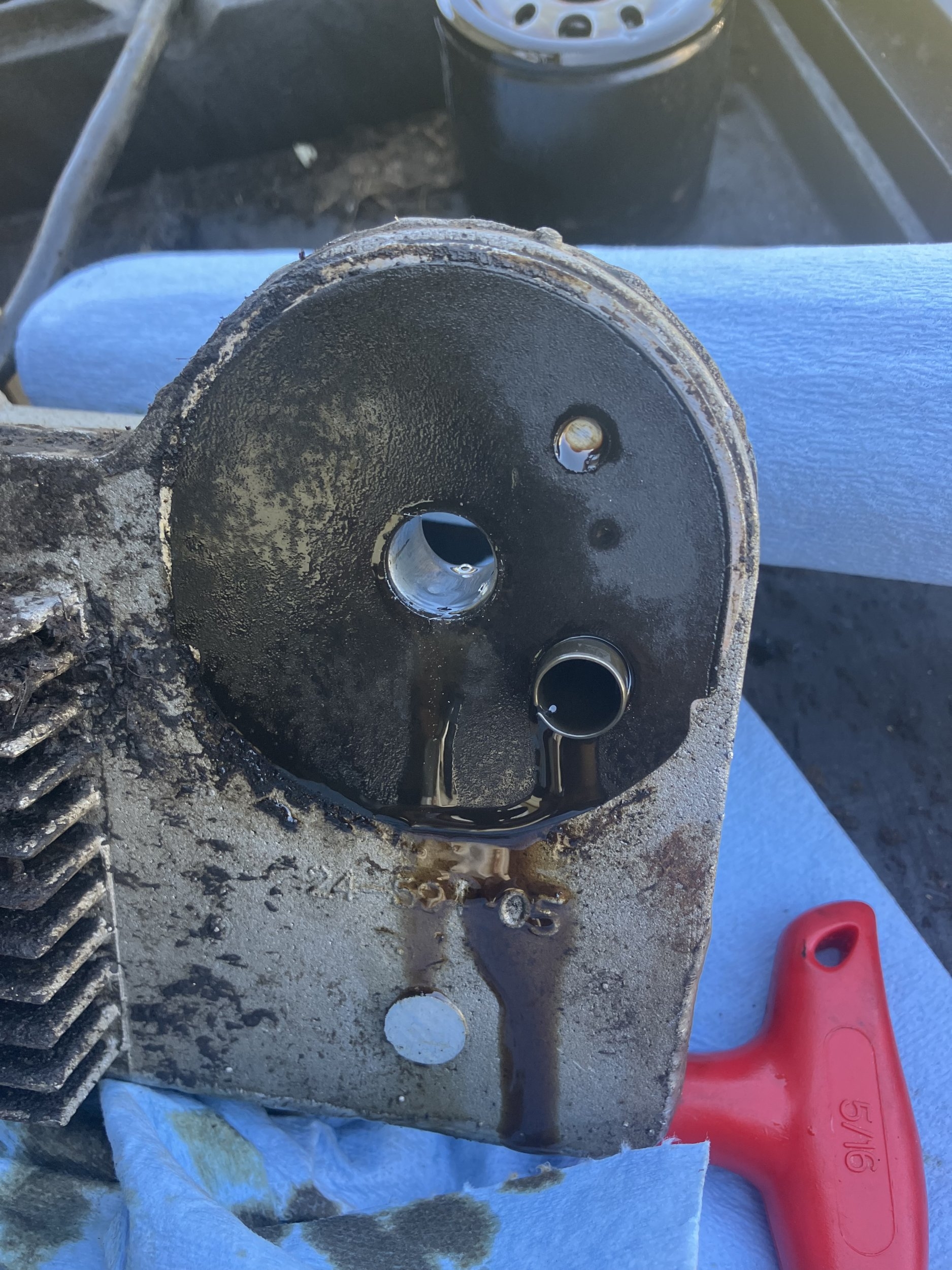

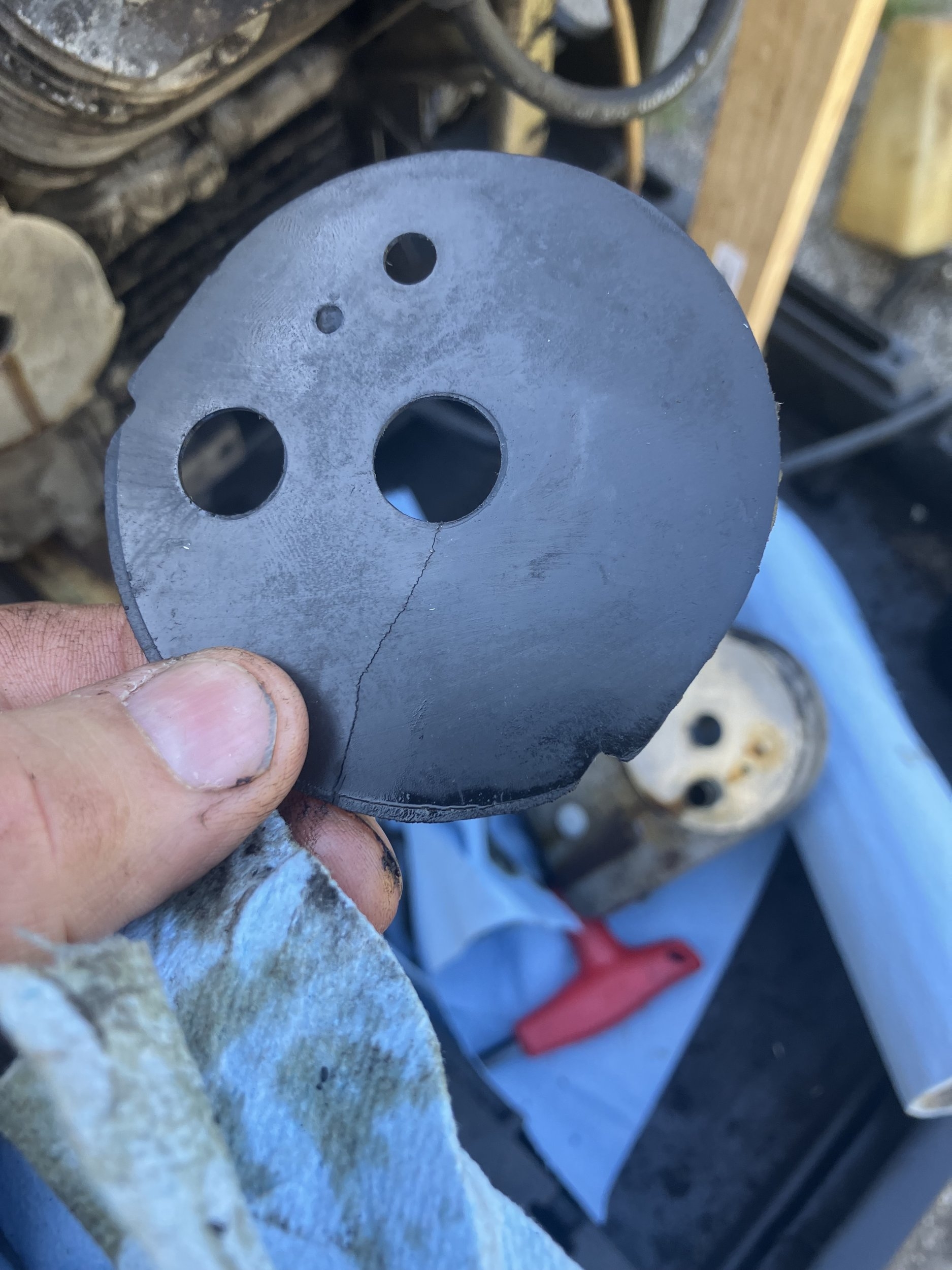

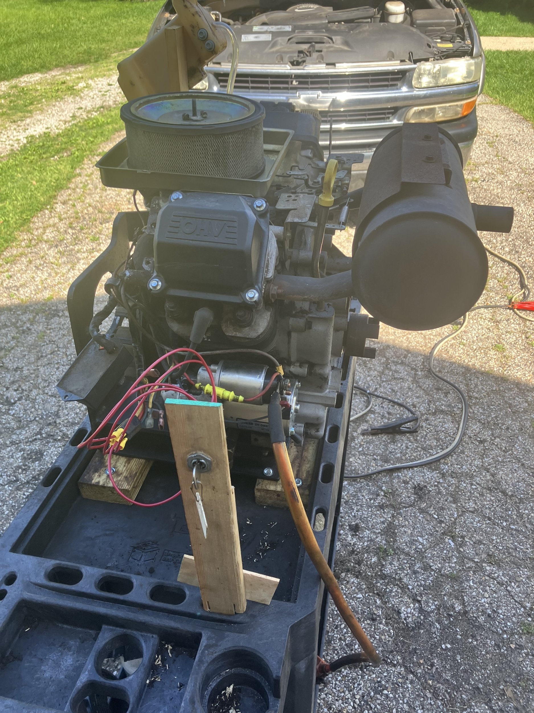

Finally got a few hours to put the engine on a cart, remove all the shrouds, find an incredible amount of oily dirt and debris packed in every crevice/fin possible, clean the heck out of it, figure out how to fire it up and had it run for about 5 minutes....
Found the oil leak! 😛
Saw the drips here...

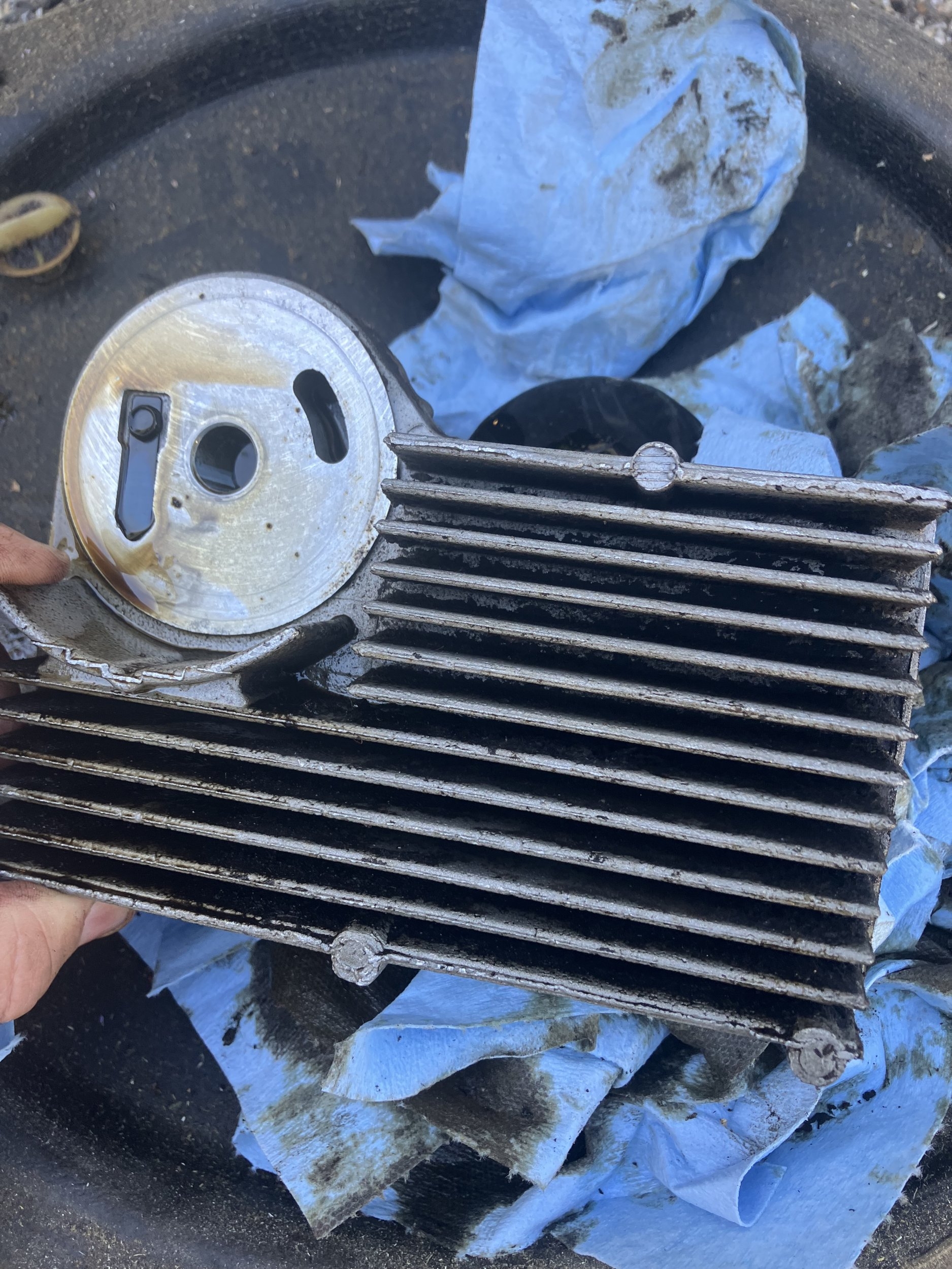

Looked up and it's coming from a gasket between the block and add-on oil cooler.
Pulled the filter, pulled the cooler.
This gasket is the culprit.
#67

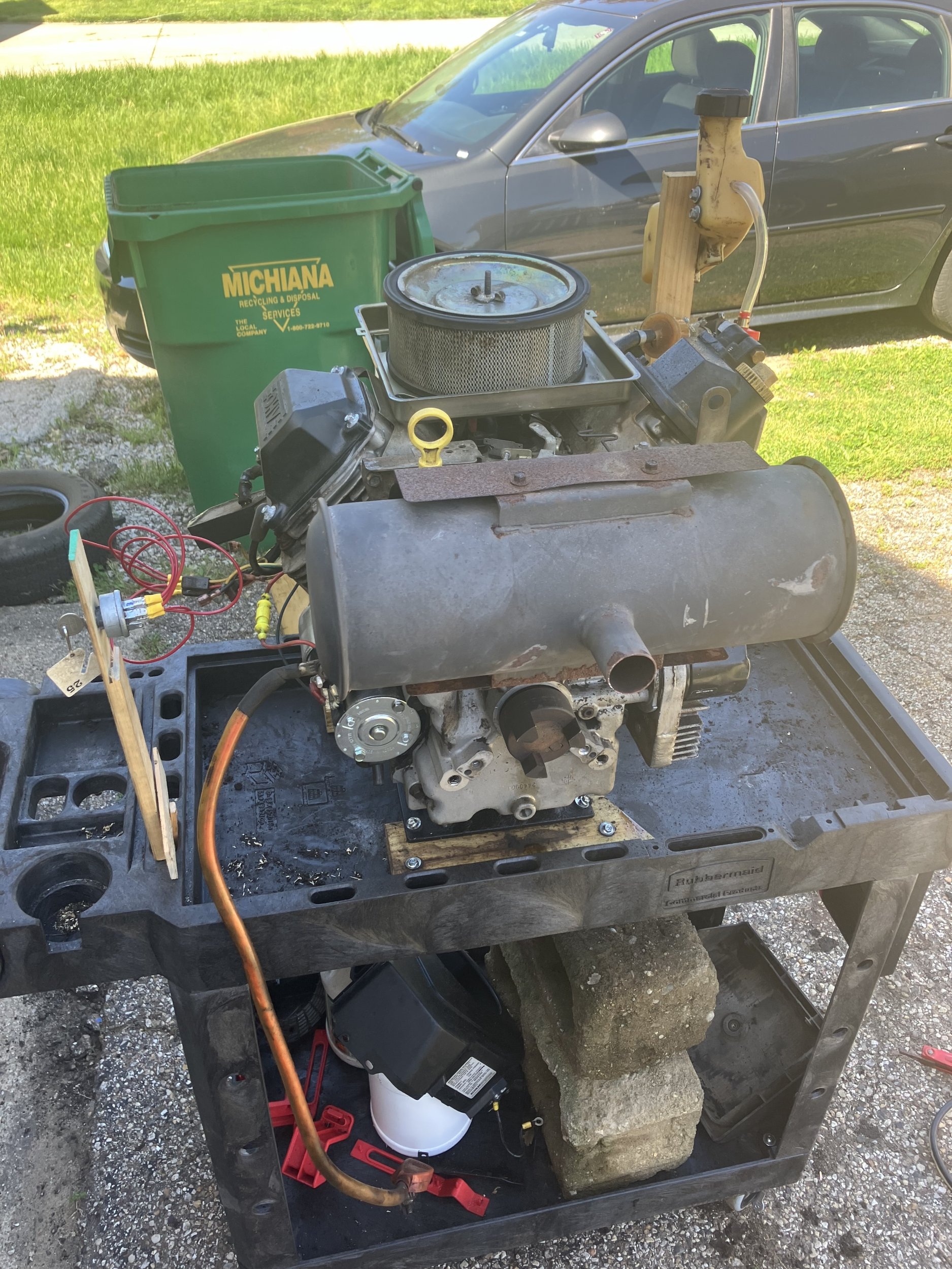

My engine cart.... hey, it works. :ROFLMAO:

I have a very similar design Vanguard 35 hp engine in a Vermeer stump cutter and am very interested to hear where the engine oil leak was once you have located it?
The oil filter/oil cooler setup would be the first place I would take a look at, followed by oil pan & crank seals.
Winner winner chicken dinner! 😛

Thanks.
Now to order a couple gaskets, clean out the rear tub, identify any badly cracked hoses, put the hydraulic pumps back on, drop the whole assembly back in, hook it all up and see what blows up next! 😛
