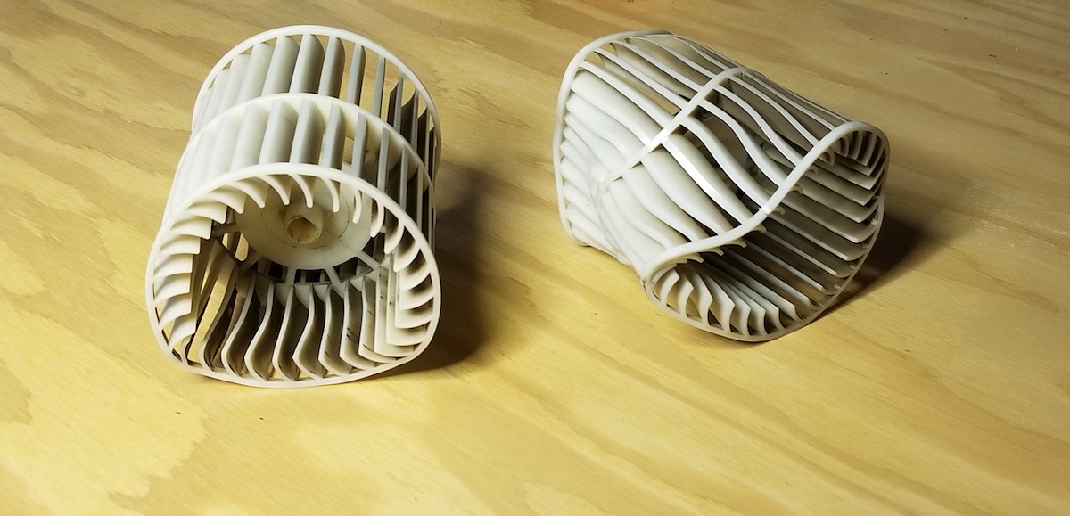

So I went to a bunch of local auto parts stores and none of them had squirrel cages for an 8mm rod. So I ordered a 5/16" rodded squirrel cage that was a little longer but the same outer diameter. I was figuring I could drill out the center of the 5/16 to make it 8mm and I would be good. That's the problem when I start thinking.... anyway I didn't take into consideration that the center plastic bushing wasn't the same length. The new part had longer bushings. No fear, I pulled out the heat gun and started modifying the plastic on the 2 new squirrel cages and it worked. It ain't pretty, but with enough washers, and moved around globs of melted plastic, I saved myself $310 and two weeks waiting time.

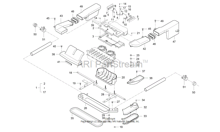

I put the new squirrel cages on and the air flow is better, but still not great. Is anyone knowledgeable enough to know if they changed the heater configurations after the 2002 model year, and if so, will the new heater fit in the same place? The venting of the heater seems like an afterthought in my system and it would be nice to have a heater that actually blows HEAT on to the front windshield. Or perhaps someone has purchased some sort of aftermarket heater which works better than the one I have???

Well, that literally is the polar opposite of mine. I need to turn on the air conditioner with the heater to get it warm enough to defog the glass. After running the tractor full bore for about an hour, then it is hot inside, but otherwise it takes forever. When the fans are on you can barely feel the heat coming out of the vents. This may be a cheaper alternative: https://www.summitracing.com/parts/sum-991106/overview/
