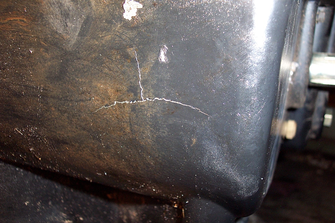

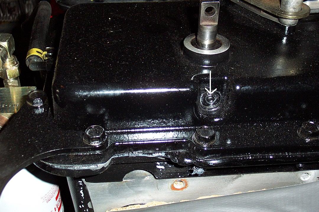

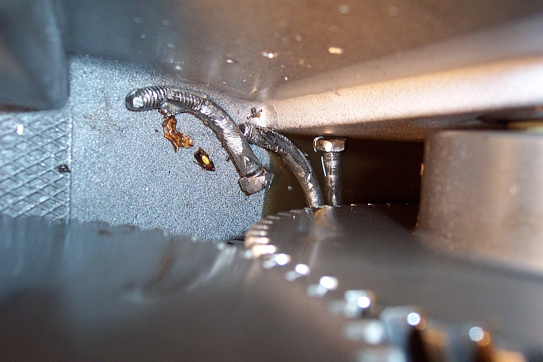

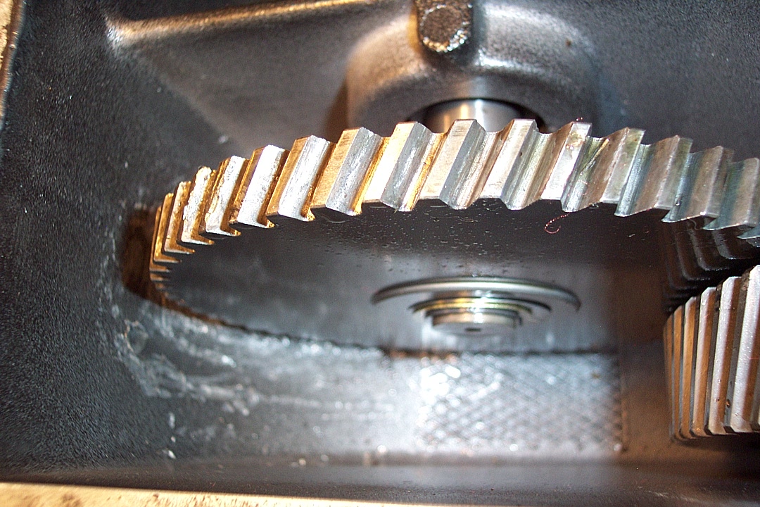

I bought a new 2006 (last year they made them?) with a front mount 48" snowblower for $6500 and found a new FEL kit for $2000 but just want you to see the transaxle problemI had at 130 hours.Dealer and Cub fixed it for free 9 months out off warranty,hats off to them.Replacement has different parts number and has an upgrade to fix this problem.
If you check your trans fluid and find metal particles you might want to look inside.
5 of the 6 (the 6th one was on it's way out) of the differential bolts backed out and one got into the PTO gears,locking it up and poping the rear mower gearbox in two.
