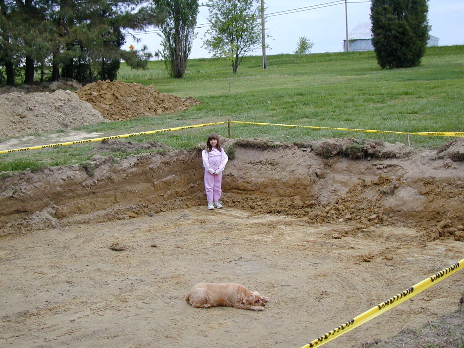

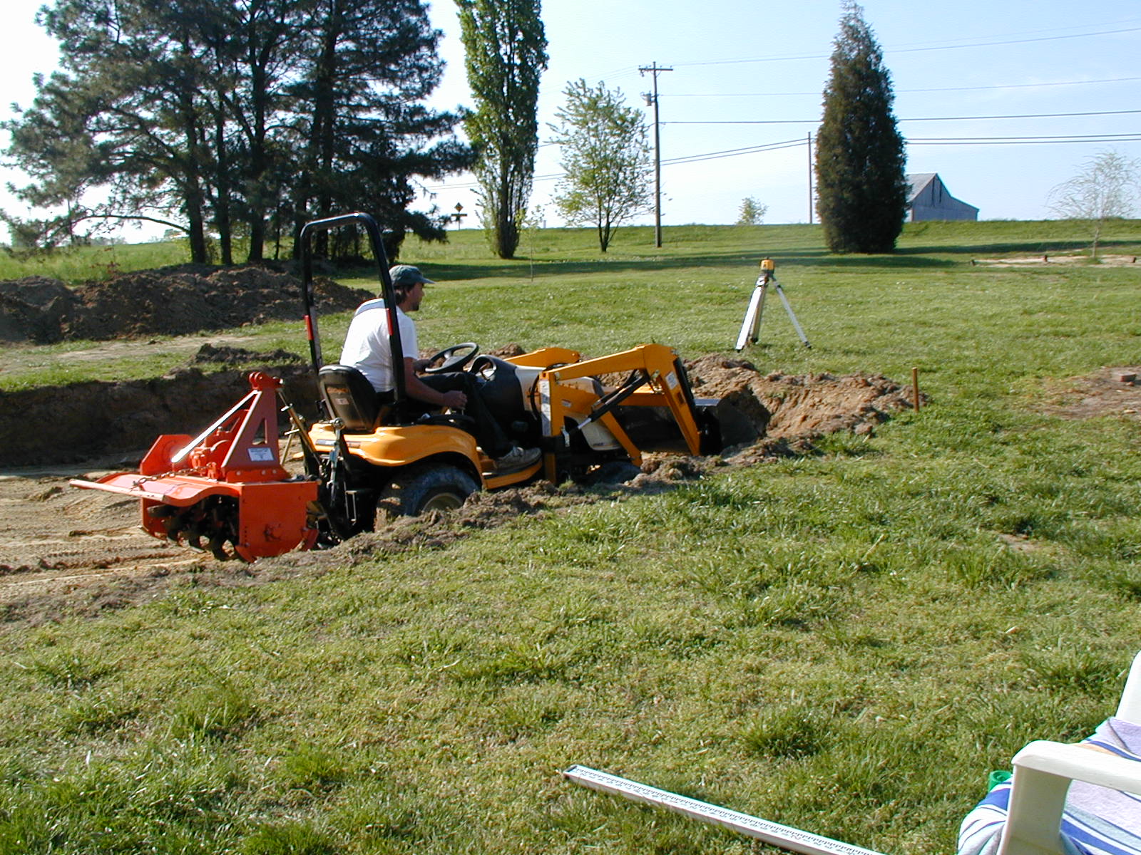

   / 2006 5254 Transaxle #20
Here's some pictures of the pool excavation done with the 5252. That's a tiller on the back. Needed for traction.
