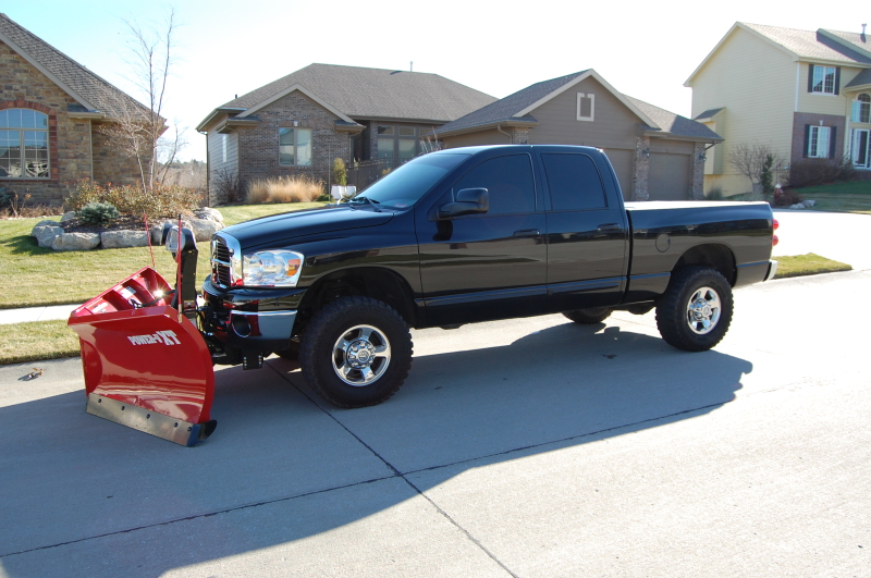

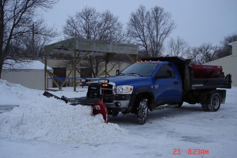

horse power is fun but how much do you really need I havent have anything yet that the 6.7cummins cant handle pull a kubota excavator with it at work load it full of dirt, gravel or cinders and salt in the spreader for plow and a 9ft2in Boss plow and it handles everything great, I might get rid of the 3500 if my company will give me a deal on the 5500.

Heres the Cummins the 3500 is mine got it real cheap has an R title but looks as good as new. and the 5500 is the companys truck but its at my house as much as the 3500. Love both of them. Normaly put grandpa in my 3500 and i run the 5500 when it snows.
Are you kidding me?
That's a good line of BS you had going on there.
Don't mean to start anything with my first post, but that "3500" is mine, and it's a 2500. The 5500 is not yours either, it is a guy's I know as well.
/ 2010 dodge ram 2500/3500 #37
Are you kidding me?
Is this serious? Somebody else is claiming to own your truck? :confused:
