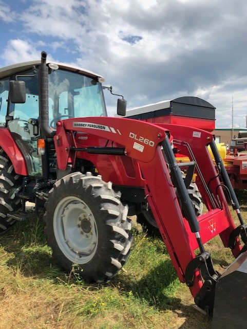

Hello all,
My father and I are close to buying a used 4609 4x4 cab with DL260 loader. Now my question is about the loader which the salesman says is the north american version of a euro quick attach. I'm not very familiar with quick attach systems as this is our first with it. So what exactly is it made for/compatible with? We need a bale spear and manure forks to go along with the bucket it comes with. Any help would be greatly appreciated. Awesome looking tractor by the way, an old farmer bought it in 2015 and is downsizing, only 400 hours on it. Spoke to him and said it has been great.

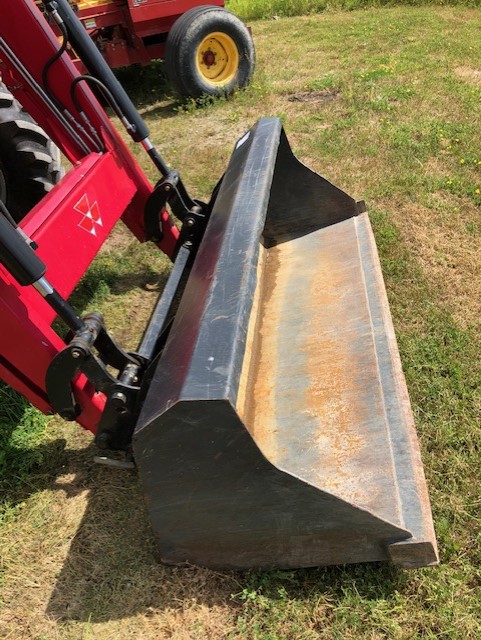

Here are photos of the loader and tractor. Is the loader attach system a Massey thing? Trying to find a compatible bale spear and manure forks.
/ 2015 4609 with DL260 loader #3
I bought a pin-on SSQA adapter for an Allied loader to convert from the brand's QA to the common North American style. Lots of companies make them. Mine was a universal.
Untitled 1 There are others like it. Universal Skid Steer Hitch Adapter Older Skidsteer & Loader, 8296
Everything Attachments offers them as well. I like those that are model-specific, wherever sourced. What I couldn't find right away was what you could buy in Canada and afford to have delivered. (I looked for some stuff for my Alled FEL and couldn't find dealers down here. Now I can't find equipment dealers in ONTARIO. :rolleyes:)
So if the tractor is priced to where another $1K would be justified, you could buy SSQA and only have to convert the OEM bucket. Ted from EA explains a lot here in about 3 min. How to Convert Pin On Style Loader to Universal Quick Attach - YouTube Hope this helps.

This is the guy I wish you had. It "QAs" to the Massey's E/GQA to make it SSQA. Buy whichever type attachment you find from then on to fit either style and use the original bucket without converting IT, OR using the adapter. That's a heckuva nice tractor IMO, so where can we find one, and how can we get it to a member in Northern Ontario??
