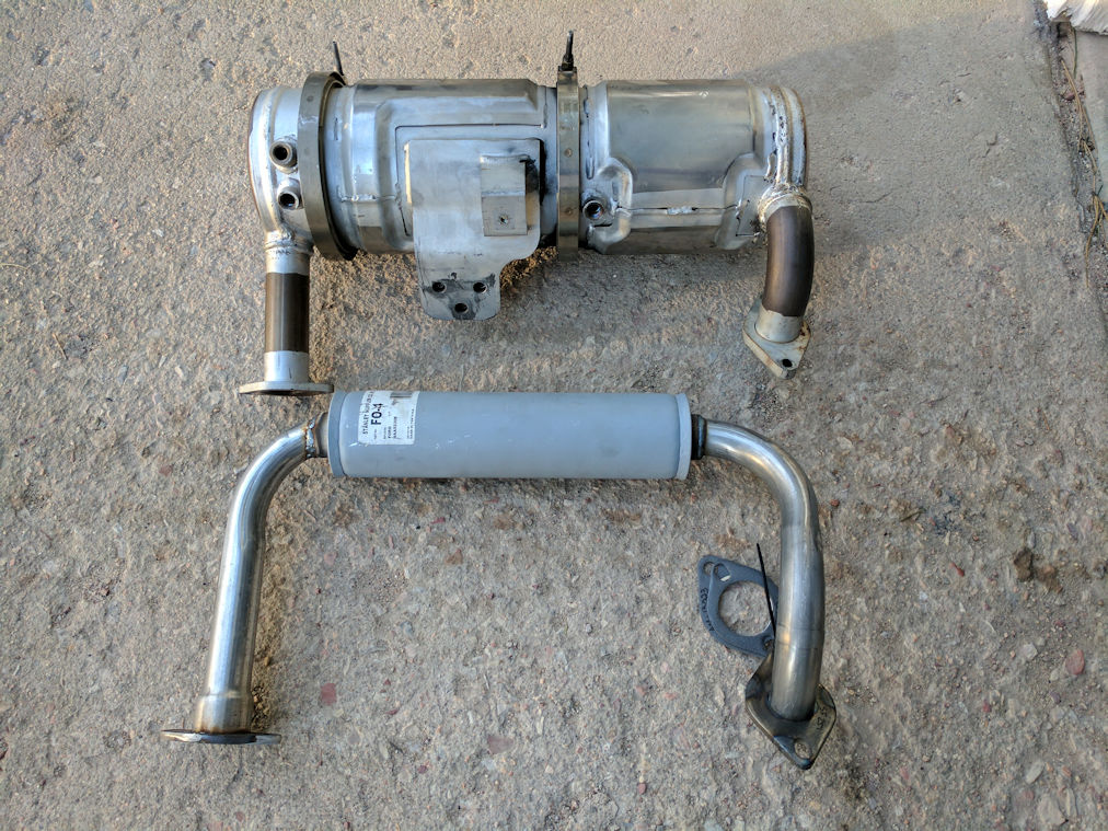

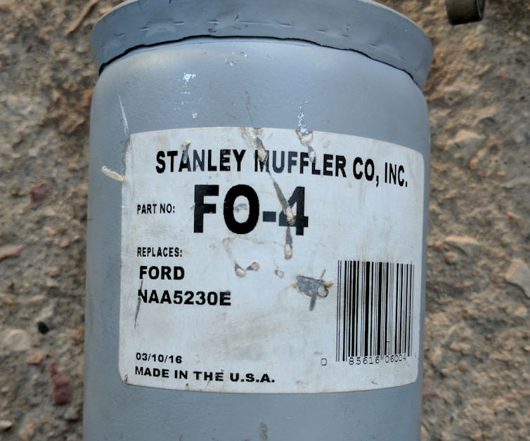

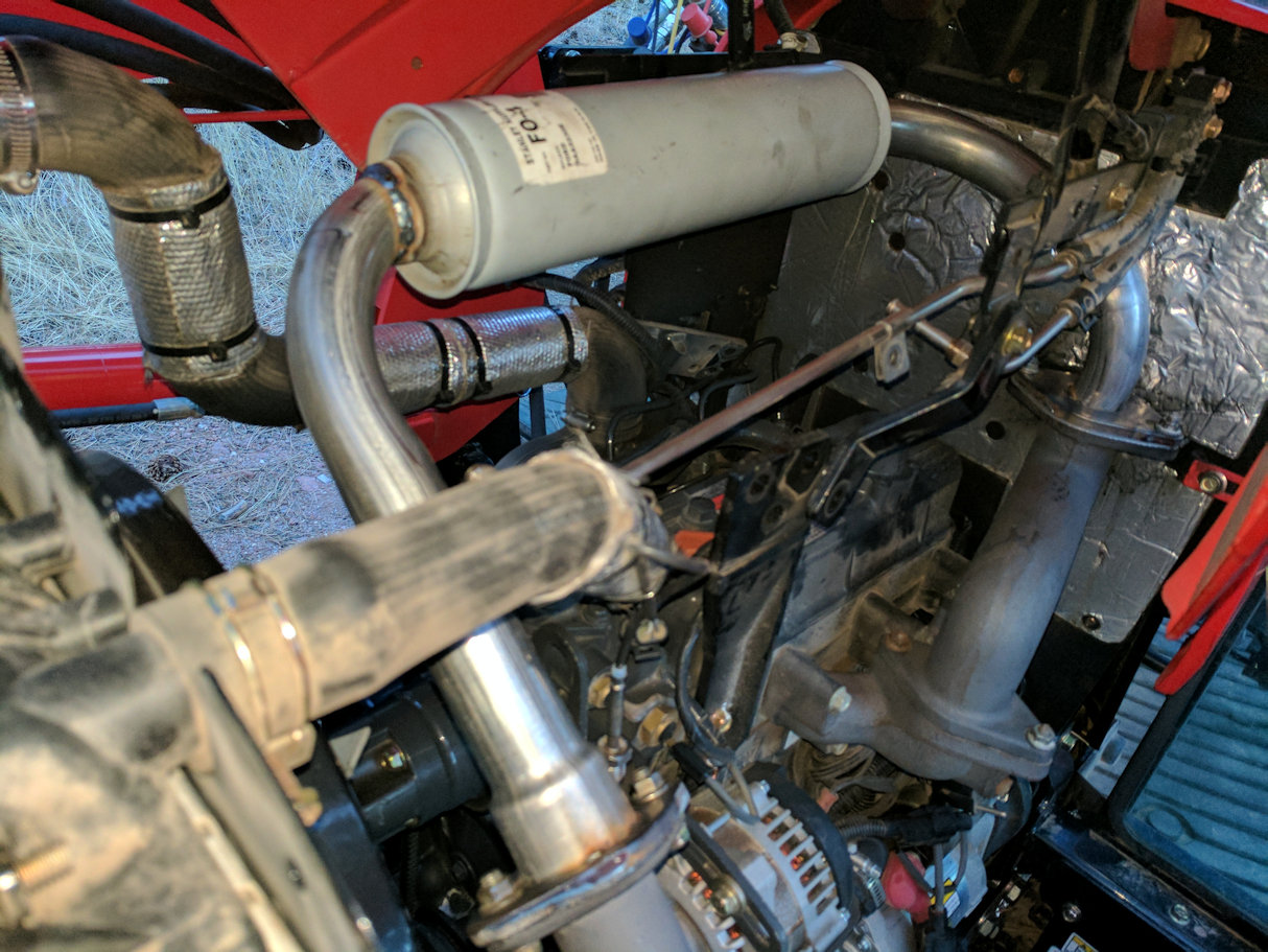

I left it like it was. The new muffler is a bolt in replacement for the DPF. I haven't taken off the sensors and data logger yet, so the DPF light is still flashing like mad. I just needed to get the tractor off of the road where it stranded itself a month ago. I'll pull it into the shop this weekend and clean it up. I need to remove the sensors and data logger, and weld up a bracket for the muffler.
With the muffler on in place of the DPF, it feels like it's been uncorked. It feels much more responsive and more powerful. If you had me drive one with a DPF and one without and told me the one without was turbocharged, I'd believe you. This little three cylinder engine is actually pretty hairy chested.
When I first started the tractor after installing the new muffler, it smoked like a gateway to he11. I ran the RPM up a bit and once it burned off the soot that had lined the exhaust manifold, it cleaned up a lot. The only real difference now is it is a little louder, and belches a bit of smoke when you first start it. When you accelerate it also puffs a little smoke, but once it reaches operating RPM, the visible smoke stops. Just like the diesel tractors I grew up on.
Pictures follow...
And for a video that shows me starting it and the way it sounds now...
YouTube
Hi Dplanton,
I am taking my 3520 to have a muffler installed tomorrow. 69 hrs and misses at startup because of the dpf. My question for you is does the data logger have to be removed to stop the dpf light from flashing? I have disconnected both sensors. Or will it stop once the muffler is installed? I currently have 3 holes in the dpf from uninstalling the dpf sensors. If you take off the data logger will the rest of the dash lights continue to work?
Thanks! Robin
   / 2015 Branson 3520h DPF Issue #99
Figured it out. Just unplugged data recorder and taped up the ends. No more dpf light! Runs better just with the extra holes from the sensors being out. Smokes a lot. Can’t wait to get the regular muffler on tomorrow and have it run how a diesel tractor should run! Run any rpm and not worry about it. I love this tractor and will love it more with no for emissions issues. It is a little workhorse!
   / 2015 Branson 3520h DPF Issue #100
It will breathe better and run a lot happier for sure. Heck! You might even find it more responsive and powerful.
