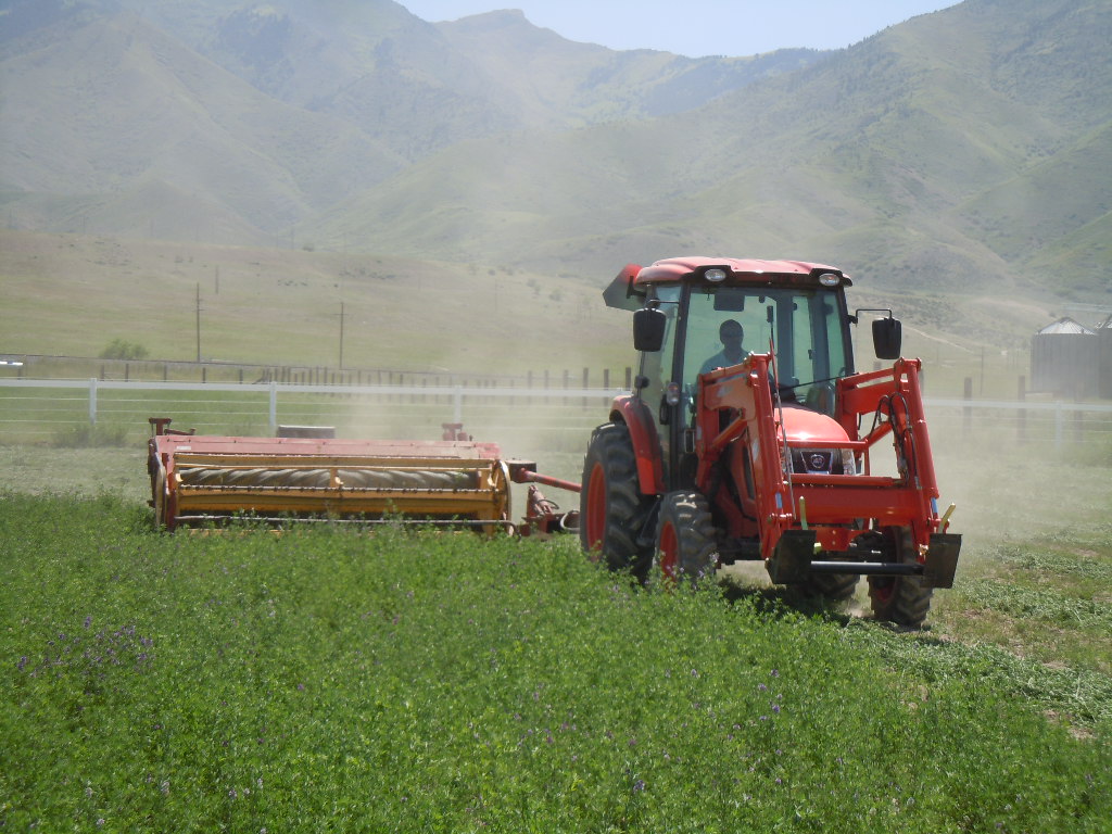

I cut 5 acres with my new to me 9' pull behind a few days ago, worked great. I did replace all the guards and every knife that was worn at all, along with changing the gear oil. I have never seen gear oil that looked as bad as what came out of that gear box. Looked like a 50/50 mix oil/water. It's all good now though. I plan to bail tonight when I get home with my new to me baler. I adjusted and oiled the chains, greased all the jerks and changed the lube oil in both gear boxes. Hope it works as good as the swather.

Back in the field last night, much better results. Only plugged up the mower a couple of times and only tripped the safety once. I believe it was because the grass was a bit damp the prior night. Because the mower is so old I did tighten the safety release a bit more. Should be able to get the last 5 acres tonight. Hopefully rake tomorrow and bale Sunday.
Only baled a few bales. The alfalfa was still too wet. Maybe tonight, I hope I can get it done because the weather is sure looking like rain. I will say the baler worked great for the few bales it did.
