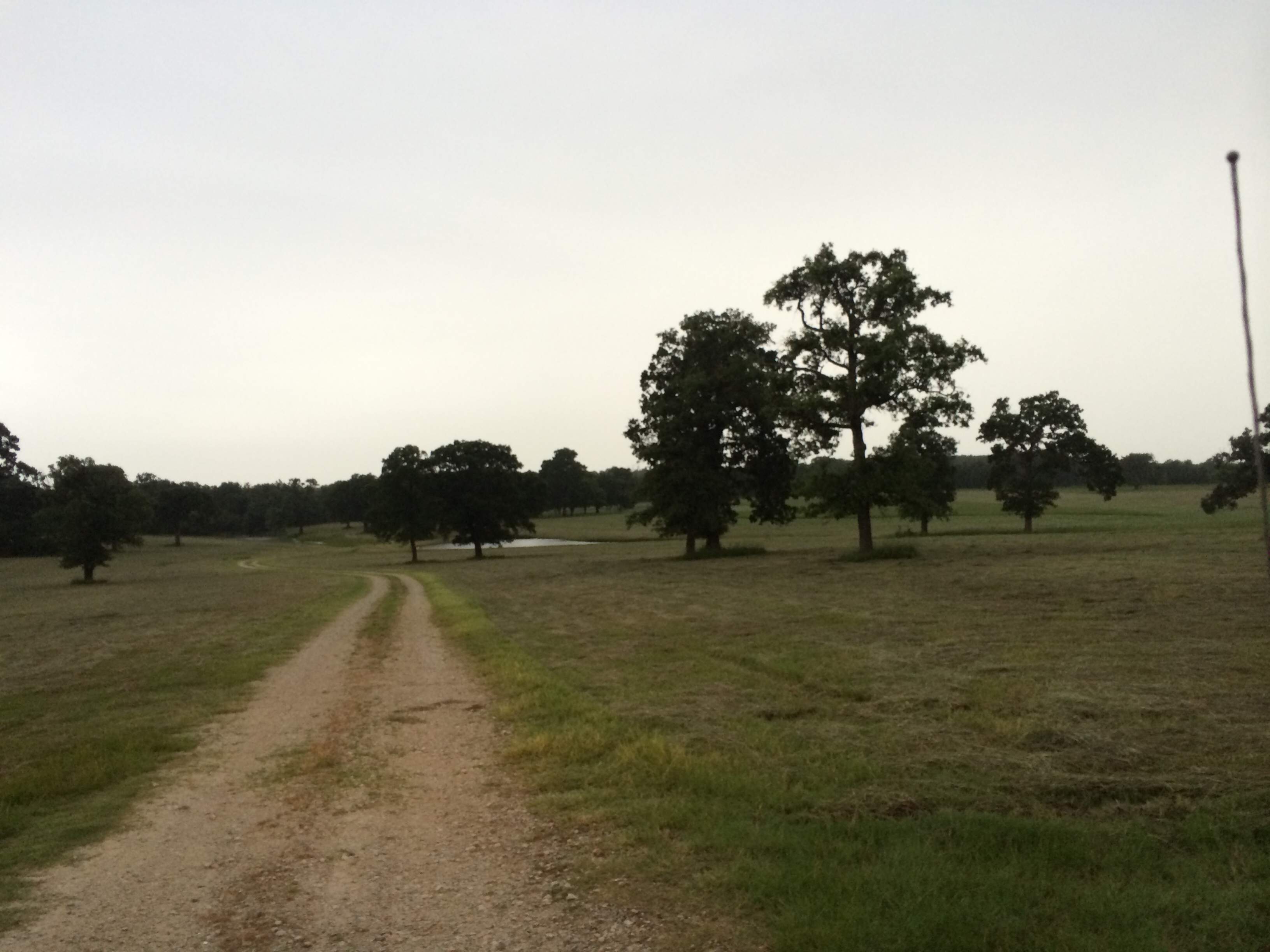

#198
image.jpg it has been raining for last 30min and not done...
