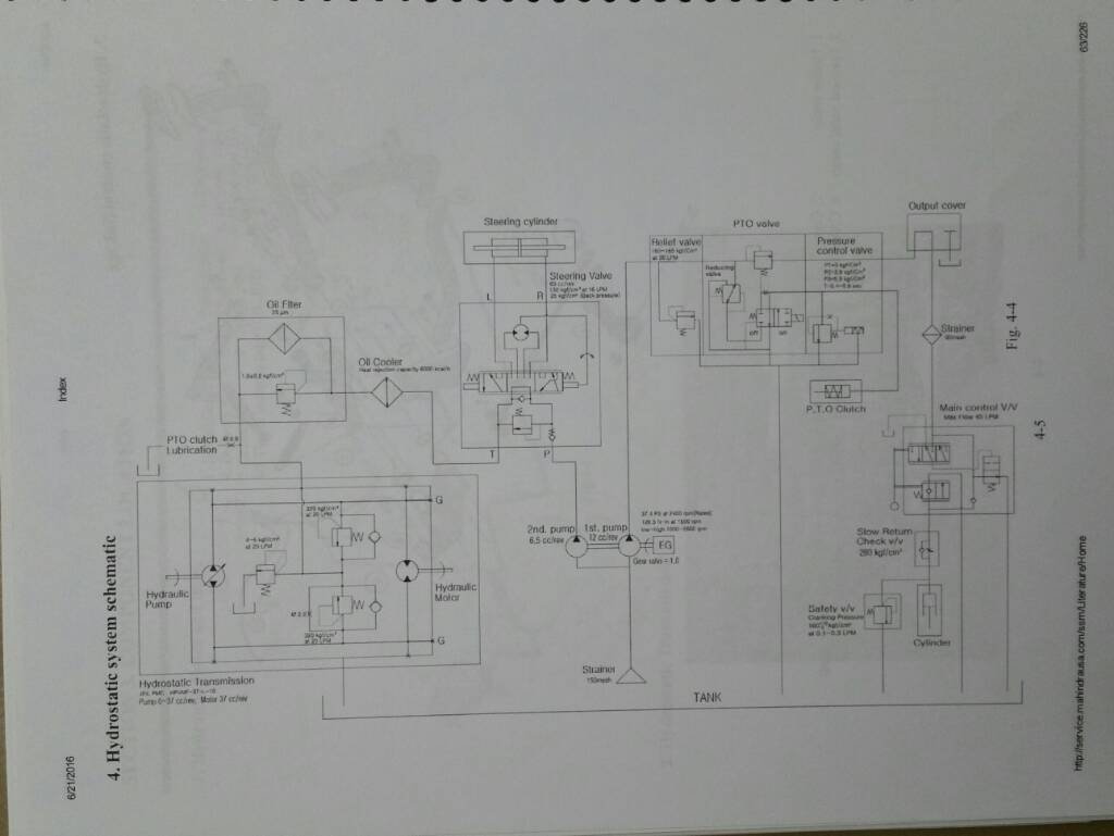

On my 2538 the back half of the pump pictured powers the power steering, then through the oil cooler and then through a spin on filter. After the filter the oil goes to the HST pump. May be the same for the 2555. I'm still not clear as to which pump the dealer advisor is referring to.
Back to topic, what you have is a closed loop hydraulic system. Two pumps tandem assembly with 19.5 cc output for the FEL and 3 pt and the 8.0 cc output for the steering and forward /reverse.
If you have the hydraulic circuit schematic you'll see two circles with a solid colored triangle inside pointed outward, this is the pumps driven by the engine, which supplies oil from the sump for the entire system. You shouldn't see any other symbol like this especially in the HST unit. The HST unit has other symbols that are hydraulic motors.
If you got the schematic for the hydraulic can you post a picture, it would help. I can only go by how my HST tractor is setup.
