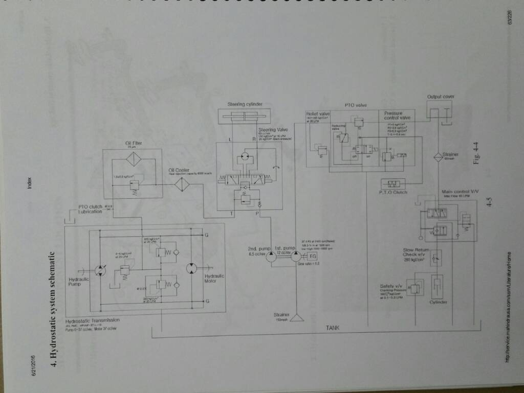

On my 2538 the back half of the pump pictured powers the power steering, then through the oil cooler and then through a spin on filter. After the filter the oil goes to the HST pump. May be the same for the 2555. I'm still not clear as to which pump the dealer advisor is referring to.
It would appear that the Japanese, Korean or Indian writers are not all on the same page when it comes to hydraulic labeling names on drawings.
The one they labeled hydraulic pump is the HST pump Bi directional powered by the engine and no parts available. The 2nd pump label is the tandem hydraulic pump
Which shows having higher parts usage.
HST units are really good and reliable units if maintain per the book, the biggest issue and failures is not doing oil and filters.
After having to change both my pumps I do a filter change yearly and oil every two regardless of hours, maybe overkill, but buying a new transmission or new tractor is not in the budget at all.

Alright, here's the latest. Service manager called today to inform me that the pump is the external one, and is therefore not covered under warranty. Parts, including flushing and replacing fluids, gaskets and other incidentals, is just over $1k. They estimate 3 hours labor at $82/hr. So all in $1400. Assuming that resolves the issue entirely, and there is no residual harm from the failure.

My apologies for the delayed follow-up. I just heard from dealer. They said it was ready for pickup. I asked if they tested the "internal" hydraulic pump to make sure it's operating at 100%. The tech said he didn't think my model has an internal pump - and that all hydraulics (lifting and propulsion) are handled with the single external pump they just replaced. He said he'd verify and get back with me. In the interim, I figured I'd ask here. I cannot seem to find an internal pump. Can any one else confirm?

I'm sure that the HST has a piston pump going just by the schematic but it's not serviceable, cant see a parts break down.. Thinking about the items you found in the oil they look like impellers from inside the hydraulic charge pump side which would explain why it was slowing down, the more parts broke the less oil was getting back to the HST. All the broken parts were going into the the sump and the filter would have stop them. So I really think the HST is OK, changing the oil and filters was the best insurance.
