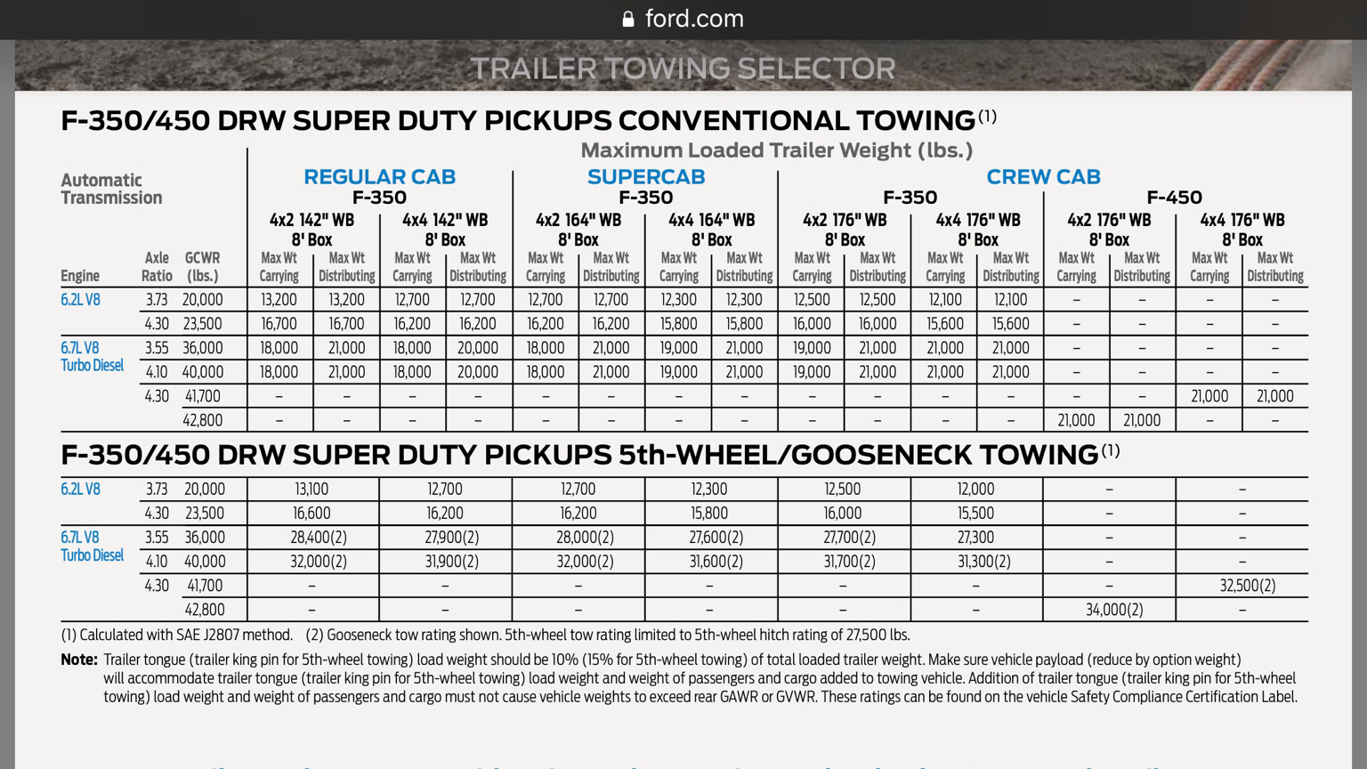

Not true. If talking pickups, the F350 actually has LESS payload than the F450. Both are class 3 trucks with 14k GVWR. The F450 is heavier due to the much larger axles, brakes, etc. The F450 is just a much more capable truck. Yes, it comes with 19.5" commercial wheels.
Yep, will be out in 2019 as a 2020 model. 7.3L.
V10 is only available in the chassis cab trucks now. It was discontinued due to fuel economy.
I believe we said the same about the F350/F450 DRW pick ups. Rated to tow the same but the F450 can carry more payload. IMG_1463.JPG
Same with my comment that the F250 SRW can tow the same as the F350 SRW but the F350 can carry more payload.
https://www.ford.com/cmslibs/conten.../pdf/guides/18RV&TT_Ford_SuperDtyPU_Nov27.pdf
   / 2018 Diesel Trucks - 3/4 or 1 ton - favorites and why #32
I believe we said the same about the F350/F450 DRW pick ups. Rated to tow the same but the F450 can carry more payload. View attachment 566776
The F350 actually has more payload than an F450. Both are limited by the 14k GVWR. The F450 weighs more, so less payload.
