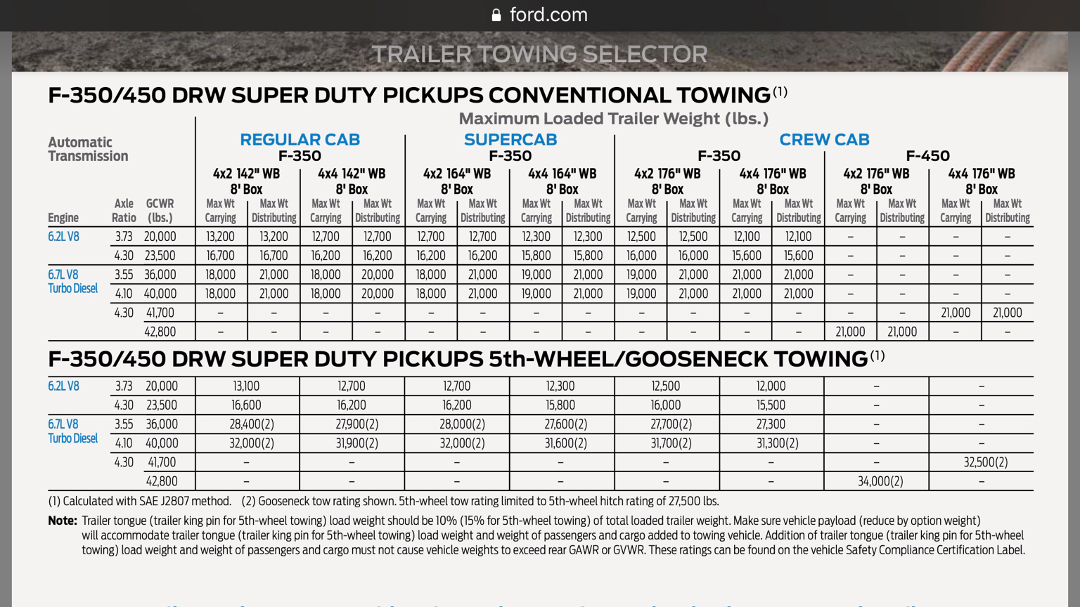

I believe we said the same about the F350/F450 DRW pick ups. Rated to tow the same but the F450 can carry more payload. IMG_1463.JPG
Same with my comment that the F250 SRW can tow the same as the F350 SRW but the F350 can carry more payload.
https://www.ford.com/cmslibs/conten.../pdf/guides/18RV&TT_Ford_SuperDtyPU_Nov27.pdf

The F350 actually has more payload than an F450. Both are limited by the 14k GVWR. The F450 weighs more, so less payload.
   / 2018 Diesel Trucks - 3/4 or 1 ton - favorites and why #33
Maybe on paper but the F-450 is twice the truck.
