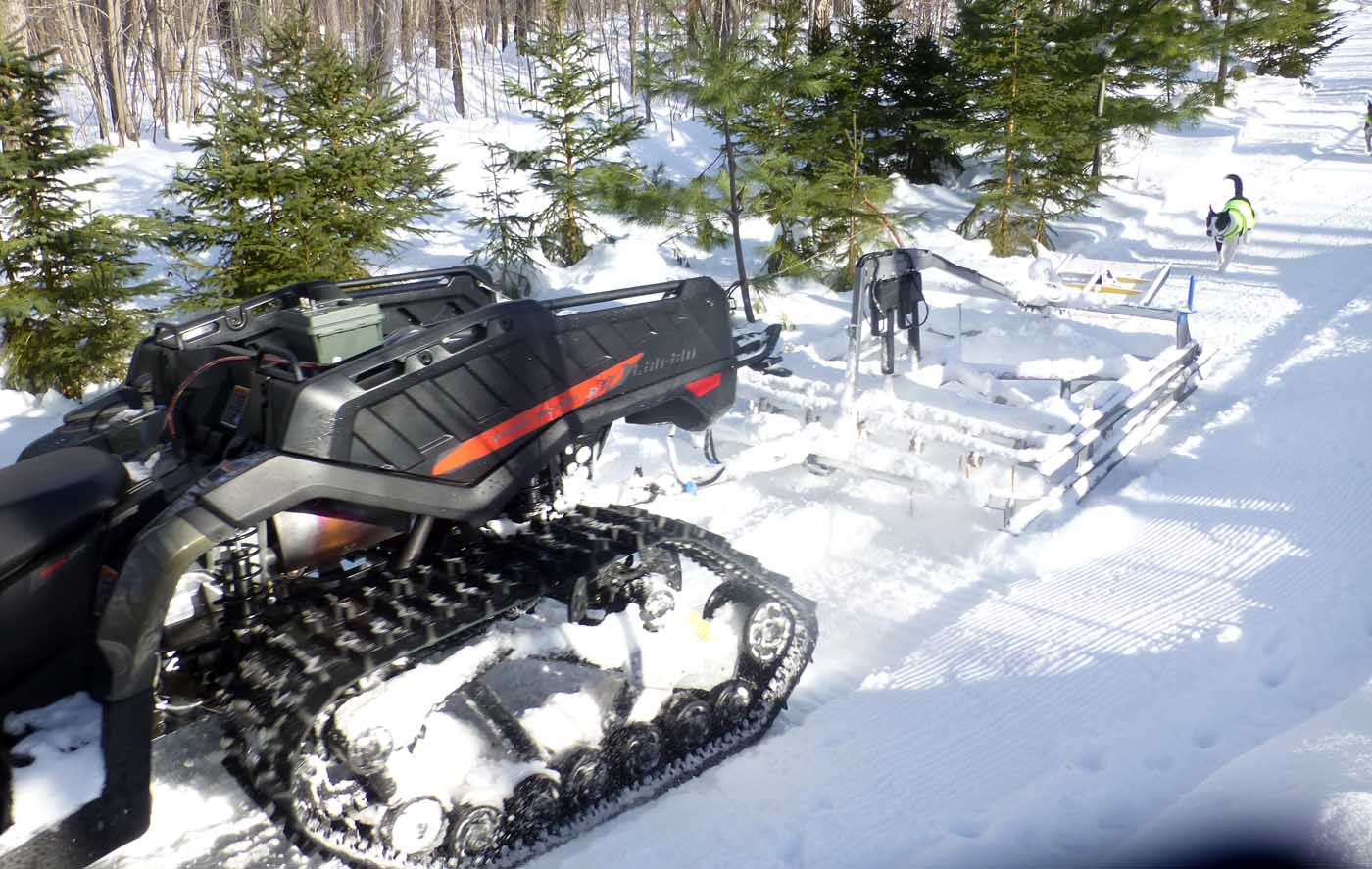

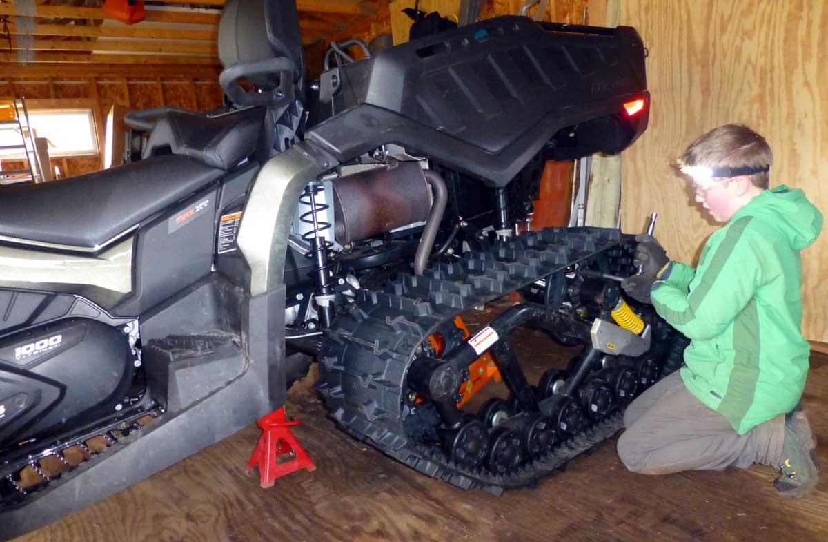

Imo its not good publicity for the can am brand if you need aftermarket parts / modifications on your drive line to prevent future failures. Anyways depending on how much your plowing and grooming with the boss especially using pods have you considered a aftermarket IR temp gauge for your primary clutch and drive belt? I believe another more knowledgeable member mentioned temp gauges for the drive line(primarily the primary clutch and drive belt) in a different thread awhile back. Good to hear the boss or whatever you've named it is back and doing what you bought it for!
   / 2022 Outlander Max 6x6 #153
The aftermarket shafts have a much thicker body but have the same splines where your shaft failed. The design of the splines/joint is not that strong because of the lack of contact area. The spherical cut axle spline fits into a pocket with a straight cut spline. It seems like it is a poor-man's CV joint design. I wonder if the added torque of running pods would necessitate a different design for the entire length of axle?
Lost my front drive.
   / 2022 Outlander Max 6x6 #154
Unfortunately I think the OP has found the weak point of what's going to fail when running pods plowing or grooming with this 6x6. imo apparently there's no give anywhere from the drive belt to the ground especially using tracks.
   / 2022 Outlander Max 6x6 #156
Interesting Wonder if it pays to thoroughly grease it during installation or add a grease fitting somewhere to be able to grease splines?
#157
I'd have to guess these couplers were well greased when assembled. Off snow season, we never even run 4wd so I'd guess we have about 10 hours with it in 4wd with pods. A weak setup? :unsure:
   / 2022 Outlander Max 6x6 #159
I'd have to guess these couplers were well greased when assembled. Off snow season, we never even run 4wd so I'd guess we have about 10 hours with it in 4wd with pods. I weak setup? :unsure:
Bad design that hasn't been fixed by brp since inception imo.
   / 2022 Outlander Max 6x6 #160
That 1st video was enlightening.
82 hp driving those front pods and big plow, big snow, with that small splined shaft, phew!
It seems to be nearly “shear pin”
It would seem that front tires or ski/skid setup maybe better?
