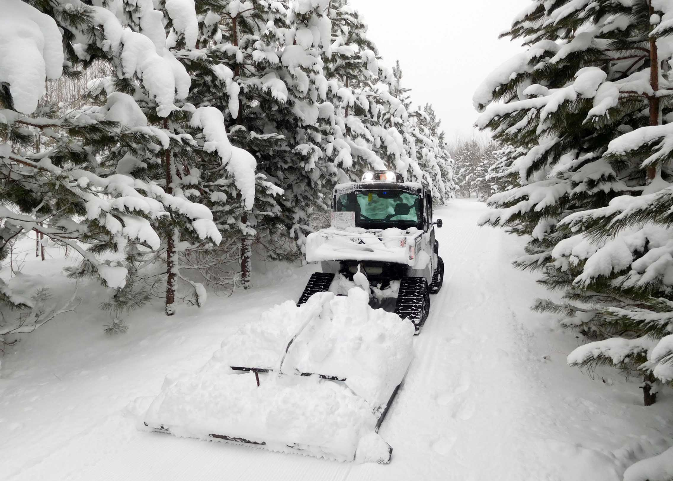

I could see where any manufacturer might decide not to beef up or redesign the front drive only for 1 model.
That monster machine is about as far as possible from a regular "ATV's" intended worse case design loading but probably running the same differential and axles as the 4 wheel 4 wheeler.
I hope that's not the case, but running the widened plow, the added weight of the plow multiplying the tracks traction, there's very little similarities with this hard working setup and a 4 wheeler playing in the mud.
Good luck Arly, I'd love to see that machine in person on the trail!
My comment is pure speculation that it's the same from drivetrain as the rest of their 4 wheeler lineup. I'm just saying I can see it being so for the company accountants.

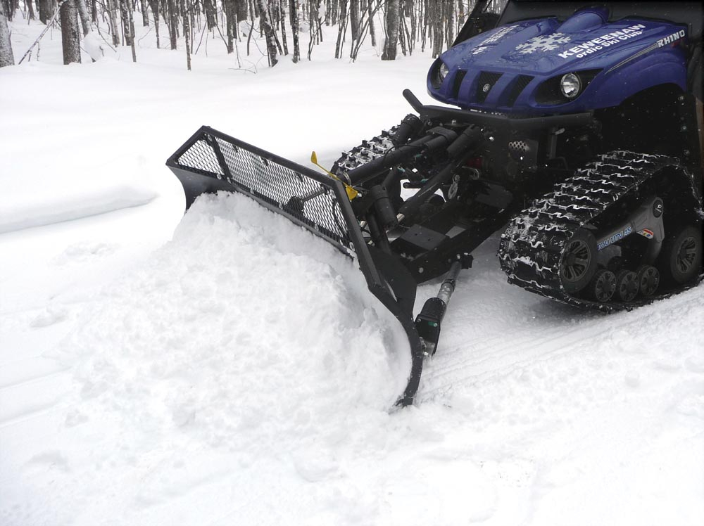

Pulling implements really takes HP but plowing is actually untaxing to the engine. Go figure. I'd say the drive shaft to the front is under-built.....
   / 2022 Outlander Max 6x6 #164
How is plowing untaxing to the engine and drive components? If that were the case plow trucks should have no transmission or drive train issues.
#165
I do not own a plow truck so I can not comment on those. I have operated many UTV and atv machines with plows and towed implements with them as well.
   / 2022 Outlander Max 6x6 #166
I still see don't how a plow untaxes a UTV or ATV engine. It seems to me that it is adding force the engine and drive train needs to overcome, not to mention the occasional shock load.
   / 2022 Outlander Max 6x6 #167
It is absolutely more “taxing”
Weight, force through drive components, rapid acceleration under load, sudden stop/ shock/ impact that propagates through everything
We all have plowed or towed
It is more taxing/more wear and tear
#168
People who don't use there atv's or utv's for towing snow implements, sure spent a lot of time tell people who do, how it works. :oops:
   / 2022 Outlander Max 6x6 #169
I think most of us here use them for towing/plowing
I only stated that I disagree with your repeated opinion that towing (is) but plowing (is not) hard on a machine.
“Plow is not at all hard like towing implements is. Done both jobs, lots.”
“Pulling implements really takes HP but plowing is actually untaxing to the engine.”
They both are more work for the machine and things break. Not a good thing or bad, it just is what it is and repairs are part of the territory.
I was thinking of your repair last night and wonder if reworking the drive line to twin u-joints with sliding shaft would be better (just like a mini pto shaft)
I’m just not sure how those splined cups are held into respective places in driveline.
Anything has to be better than 1” or less of teeth to drive those pods
#170
I only stated that I disagree with your repeated opinion that towing or plowing are not hard on a machine.
They are and things break. Not a good thing or bad, it just is what it is and repairs are part of the territory
While plowing the throttle is at 1/4 or less. Kinda low. While towing some implement and in deep, fresh snow I can hold the throttle at 100% and leave it there. But plowing takes more? :unsure:
