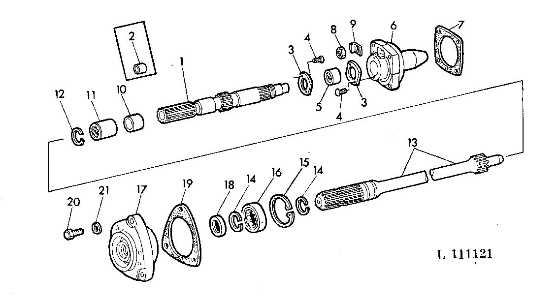

PTO disconnect on left heel only on models with dualstage clutches !!!!!!!!!!!!!!!!!!!!
   / 2040 PTO clutch not dis-engaging fully #23
This parts photo came out of a JD 2120 parts catalog #4164. Title of page is:INDEPENDENT PTO (540 RPM). Please explain without a pto rear disconnect lever/collar what transmits(JOINS) power from shaft(parts key#1) to shaft(parts key #13)???????????? After doing some more research in parts catalogs I do think some of the later model 40 series utility tractors did away(eliminated) with the disconnect lever for ind pto.
   / 2040 PTO clutch not dis-engaging fully #25
Remove coverplate over gearlevers and clean housing that holds the gearlevers .....if there is another lever between the gearlevers it is the IPTO lever ! Then you have a hidraulic problem ......low press sisteem .
   / 2040 PTO clutch not dis-engaging fully #26
All 2040's I've seen have a pto disconnect lever by left heel while seating in the seat irregardless if it is IPTO or dual stage clutch
I beg to differ !
   / 2040 PTO clutch not dis-engaging fully #27
I beg to differ !
You'll be happy to know that after some research of parts catalogs I found a few tractor moels that didn't have the pto disconnect by operators left heel but it was "very few" compared to total number of JD utility tractors of that era.
