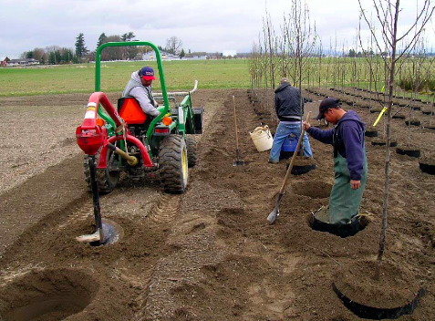

I have a TYM T474 and looking to use post hole digger for 21" hole to plant large trees. For a tractor my size, is there too much for it or has anyone else tried large post hole digger? Attached is picture of any tree farmer doing similar like I'd be trying.

It should handle it fine. It has the Hp and the lift capacity to lift it out of the ground.
Just curious, who makes a 21” auger? 18 or 24” are pretty standard. It should be able to handle a 24” auger too.

Are you planting an orchard using the Espalier method of cultivation??
You need to have the ability to penetrate the ground easily all the way to the
bottom of the hole and a tapered tree transplanting auger will do that for you.
The tapered design of the auger allows the auger to enter the ground slowly
without binding or rocking after impacting a rock as they are bound to do and to create
The tapered round hole you need.

Leonz - I could have used one of these this year - planted 40 5-6' Norway spruce root balls - used an 18" auger on a Bobcat CTL with down pressure as we have a lot of rocks and the 18" auger did a good job clearing rocks and loosening the soil.
Worked fine to get the holes "roughed in" but needed to clean up each hole with the BH - wasn't wide enough on the top.

Yes Saxon - you will find the PHD (Post Hole Digger) on your tractor will do a decent job "if" your soil is not too rocky or hard pan.
If you have rocks, ledge, or roots it will shear pins, and without down pressure you won't be able to apply force to the PHD.
If you have a lot of trees to plant (20-50 or more) with root balls 18-20" in diameter renting a Bobcat Mini Track Loaders with an auger https://www.bobcat.com/na/en/equipment/loaders/mini-track-loaders. They are small and easy to use but pack a punch when drilling in rocky soil.
They are $250 a day or $1000 a week here with a 18-24" auger, and you can easily put in 10 holes an hour, but depending on your soil, you will need to do cleanout with a shovel or BH prior to planting. I rented one for a week as we did 80+ fence posts and 40 trees and needed to get the fence posts in as we went along. Rocks are the biggest challenge, we got 8 + yards of rock from our project.
But if you have time and decent soil to dig in the tractor mounted PHD do fine.
