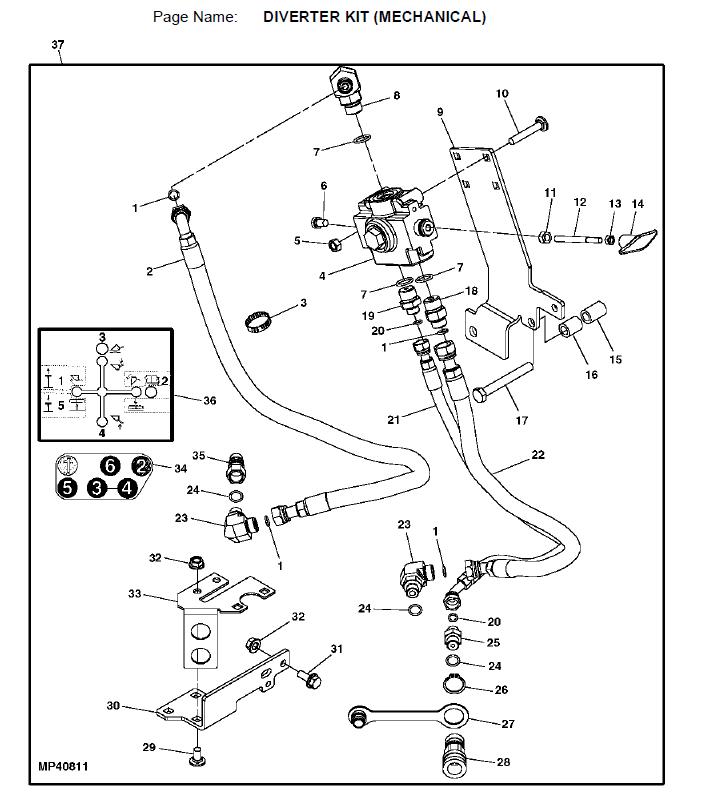

If you click the link to that thread on another forum, up a few posts, there's a PDF in there that contains drawings of the whole assembly.
Found it on the jdparts under alphabetic listing "diverter valve" too.
Yes, I have seen the JDParts drawings, I wanted to see real pictures of one installed...

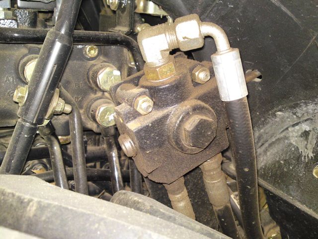

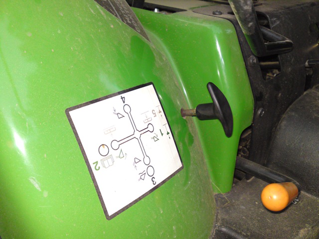

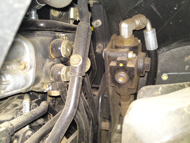

Can someone post a picture please? Is there a linkage to the diverter valve?
Hey Kenny,
I'll try to remember to take a picture of mine installed asap. There is no linkage. It's just a hydraulic valve bolted to the frame such that the actuator lever can poke through the fender (hole must be drilled at time of installation). Then, the hydraulic hoses are simply run back and forth to the hydraulic coupler bank, zip-tied in various locations.

Here are some pictures of the diverter valve I managed to squeak out as my 2305 was going on vacation to my pop's house for a couple of days. It was really hard to get a good angle.
