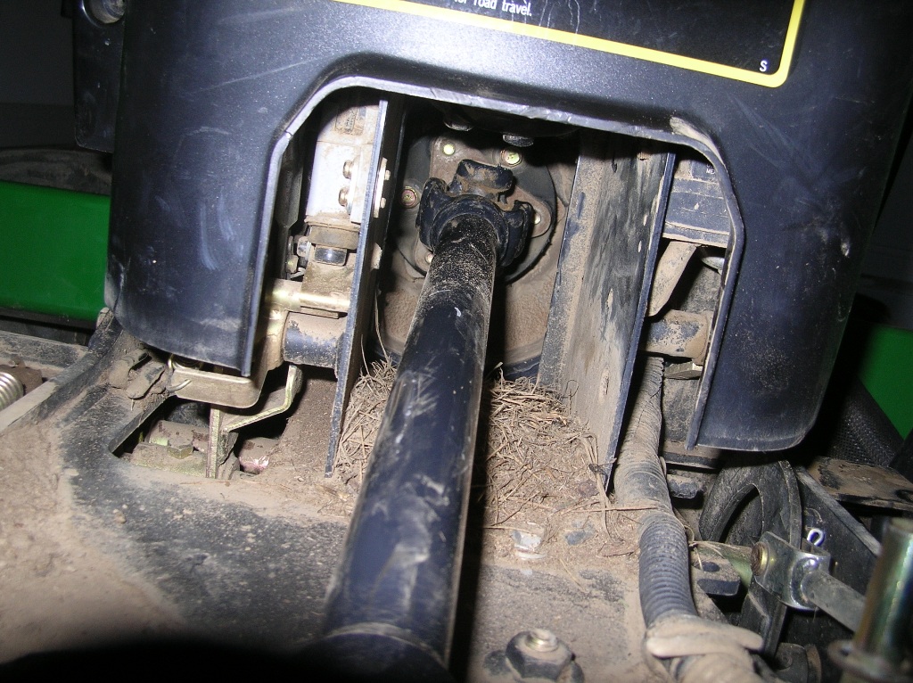

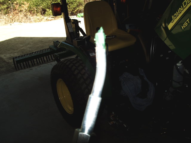

I am glad you are back in action. My head is spinning from reading this and similiar threads. My 2320 was made last September. The manual shows two U-joints to grease. I was under there today and could easily see and grease the tranny side. I could just barely see the front one and after spinning the engine a few times was not able to see a zerk. What is your advice to me.
Thanks alot
VP
Well, I got under there again with an inspection mirror and little Maglight, yep there is a zerk pointing backwards. I think I am going to call JD tomorrow to see what they have to say about this.
VP
   / 2320 Drive Shaft U Joint blew up. #43
I wonder if I could cut the hump part of the floorboard out and get to the front joint. I could conceivably cut out the plastic hump carefully and then modify it so I can reattach it somehow, any thoughts?

Look from below and see if there is an access plate located on the right side. If so you can get to that joint through there. There may also be a access hole on the left side you may be able to use depending on the angle of that Zerk. Problem is both of these access points require the lower skirt be removed, which can't be done unless either the dash is removed or the floor is removed.
I've thought about cutting a hole in the plastic skirt right where the access plate is located, but haven't done it so far.

Yes I saw the access plate on the right side. I dont want to get into taking the floor apart if I can help it. It seems easy enough to rmove the hump. So why doesnt a big famous company like Deere think of these things?

Mother Deere knows best is the only answer to your question I can think of. Gotta remember, for years the dealers were telling us that joint didn't need to be greased. We were told everything from that was just a production Zerk and the joint was actually lifetime greased and sealed, to "what Zerk?".
It seems like a good idea to provide access to that joint, but as to why they don't, is the million dollar question. My best guess is they just didn't think of it when the tractor was originally designed, and no one has seen fit to authorize the change in manufacturing process yet. Maybe someday, my friend, maybe someday.

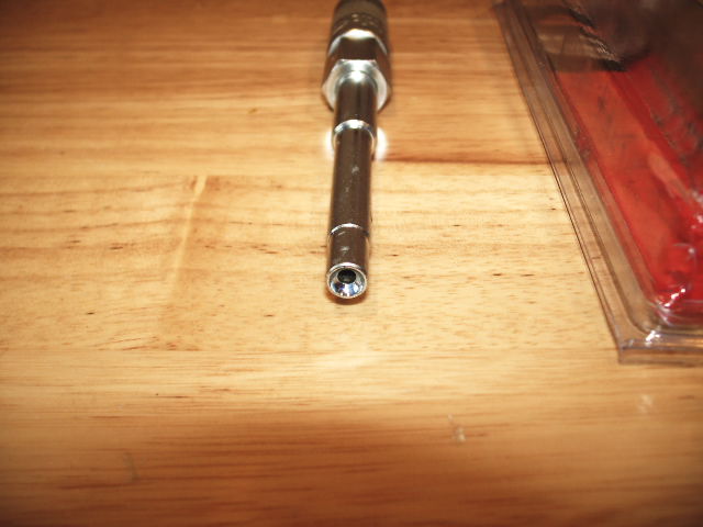

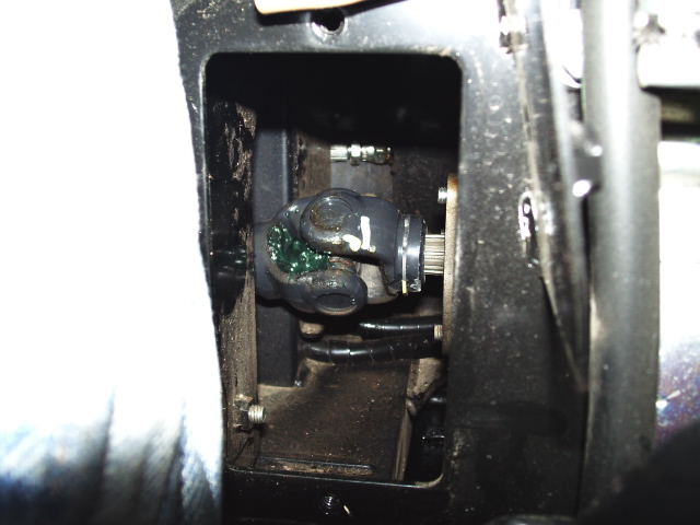

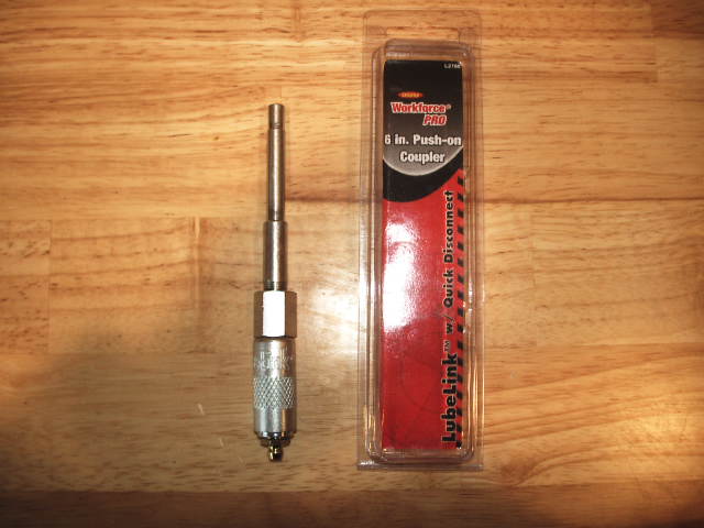

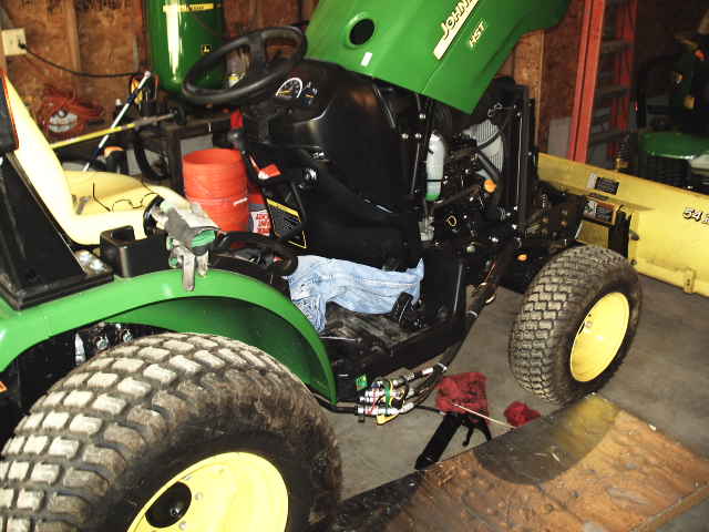

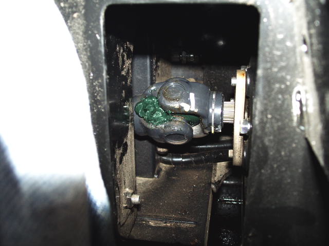

Eureka! The $%#@*&% front U-Joint is lubed! I attempted to lift the floorboard, after I had all the screws, pedals and knobs off it wouldnt clear the plastic shroud so I started messing with that, got it loose enough to expose the side panel. I held it open with some old jeans, I tie wrapped the connector that was dangling in the way. I looked in and saw the "Jerk". I attempted to use my standard grease gun and tip, it made a mess. I had lunch and calmed down a bit, boy was I cussing out Deere! They are going to hear from me tomorrow whether it will matter or not we will see. So I went to Tractor Supply and they had 2 kinds of grease adapters. a needle adapter and one with a bigger hole, that is the one I got. I tried it and again a big mess, the Jerk is in there at a %%$#&*angle, so I bent an angle to the adapter, worked great. I have some pictures, you can see a before and after picture of the grease on the u-joint. I hope this helps others as you guys have helped me. I think next time I wont take the floor apart, I dont think it helped at all, I just have to take apart the plastic shroud or try from underneath with the special grease adapter, although maybe now I have the wrong angle on the adapter, I may have to get another one. What about the poor souls that put 50 hours on their 2320 in say a month or even worse a week!
