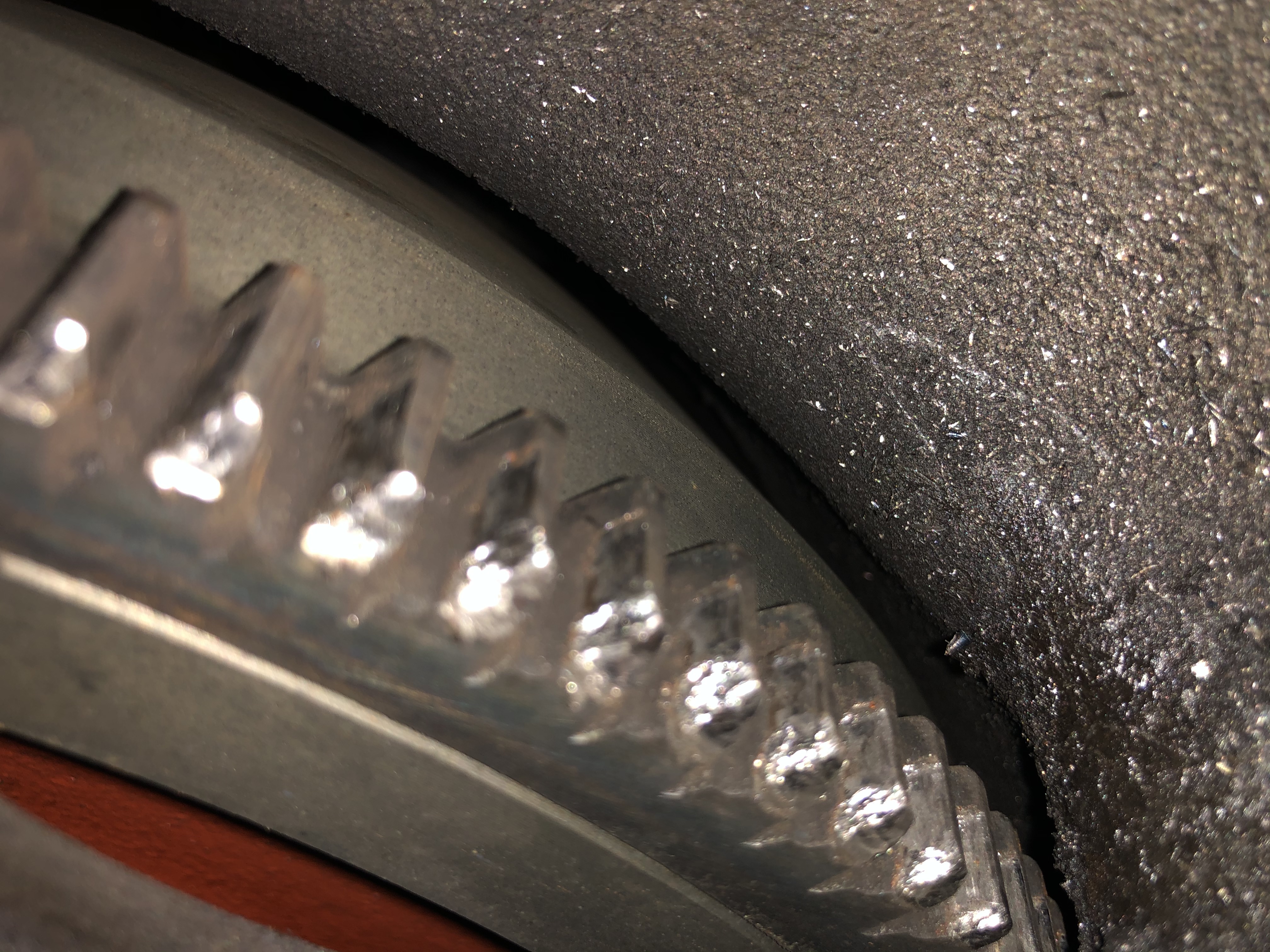

Good morning, Have been working through a starting issue on my 240D. The issue has been around for a while but I just worked through it or with it better stated. When you activate the starter it will sometimes whirl/grind and not engage. Sometimes it does this once, sometimes 4-5 times before it engages and turns the engine over. Have been getting help from Aaron at Hoyes and winston on tracing through the possible electrical issues with it. Changed the solenoid recently, two weeks ago changed the starter drive. Voltage to the solenoid (battery side) is fine (12.8V) . When the starter is engaged it drops to between 10+11. When it is whirling/grinding voltage is still 12+. Used booster cables as well right to the solenoid, values unchanged. As I was doing the booster thing, obviously tricky IMG_2755.jpgIMG_2751.jpg trying to have the cables, a voltmeter connected to the solenoid posts and ground and turn the key my ear was relatively close to the bell housing and the grinding seemed more obvious than the whirling (although still not terrible). Different than when you're in the seat turning it over. This caused me to think that perhaps it was more than just a starter issue. Removed the starter to view the ring gear. Marked the spot I could see and with the decompressor open turned the flywheel through the 360 degrees. There is wear all around, but for estimate 80% not too bad in my opinion. there was section that seemed more than the others. Could this have caused the lack of engagement and the whirling/grinding? I 've attached two pictures. It would explain why the engagement is intermittent and random. It would depend where the flywheel landed when it last stopped. I did record the noise it makes but that file type isn't support on this site for uploading. Any opinions or advice welcome. I'd replace the ring gear if that will solve the issue but splitting the tractor is a lot of work and want to feel comfortable that is probably it.
Thanks guys

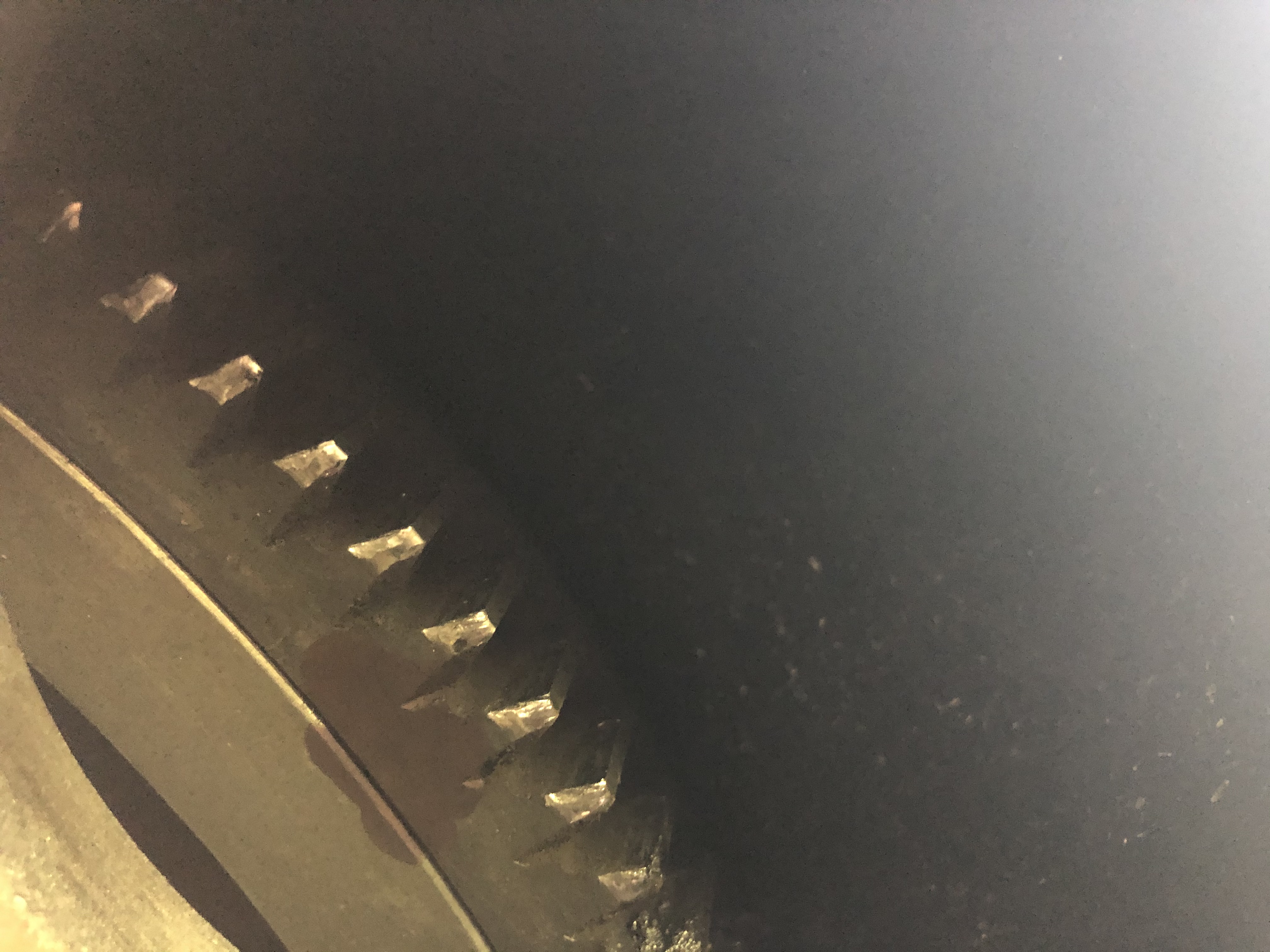

I should add the photo on left is the 20%"worst" on the right is representative of the rest. The black "blob" on the right photo is a mark I made so I would know when I had been all the way around.

What does/did the starter gear look like. Generally speaking the starter gear wears more than the flywheel gears. The worse wear may be enough to cause engagement issues. (On my phone that photo is not crisp/sharp focus).
That said, I tend to think you still have some weak components in the starter—possibly the spring or other electric components.

Hi Winston-I did notice it was available and it may come to that. I suppose I'm looking for someone to express an opinion on the state of the ring gear. Having changed the solenoid and the starter drive recently (interms of hours on it) I'm down to changing the starter and seeing if that works. The ring gear change doesn't look expensive but splitting a tractor is always a ton of time (at least for am amateur like me) Appreciate your help and good to see you on this forum as well as others,

I have had flywheels on vehicles that basically were missing a tooth (damaged to the point of all but gone). If the starter gear could grab the next tooth it would usually advance it enough to start the vehicle. It might take a few attempts, but usually happened. Of course this was always a need to go and not able to stop and do repairs. It did often lead to a meed to replace the starter gear as well, but....
Again my display of your bad teeth on ring gear was out of focus (may be my viewer) so hard to express an opinion on the ring gear. The second picture should not cause any issues.
A new starter sounds like the way to go and I would guess will fix your issues.

To chew up a ring gear like that my guess is the pinion is the wrong one. Typical of aftermarket rebuilds. Maybe the starter is wrong too. From the wear on the ring gear it looks like the pinion either has the wrong tooth count, or not enough engagement, or the starter body has the wrong pinion/motor mount casting. Get another one while you still have some ring gear left.
