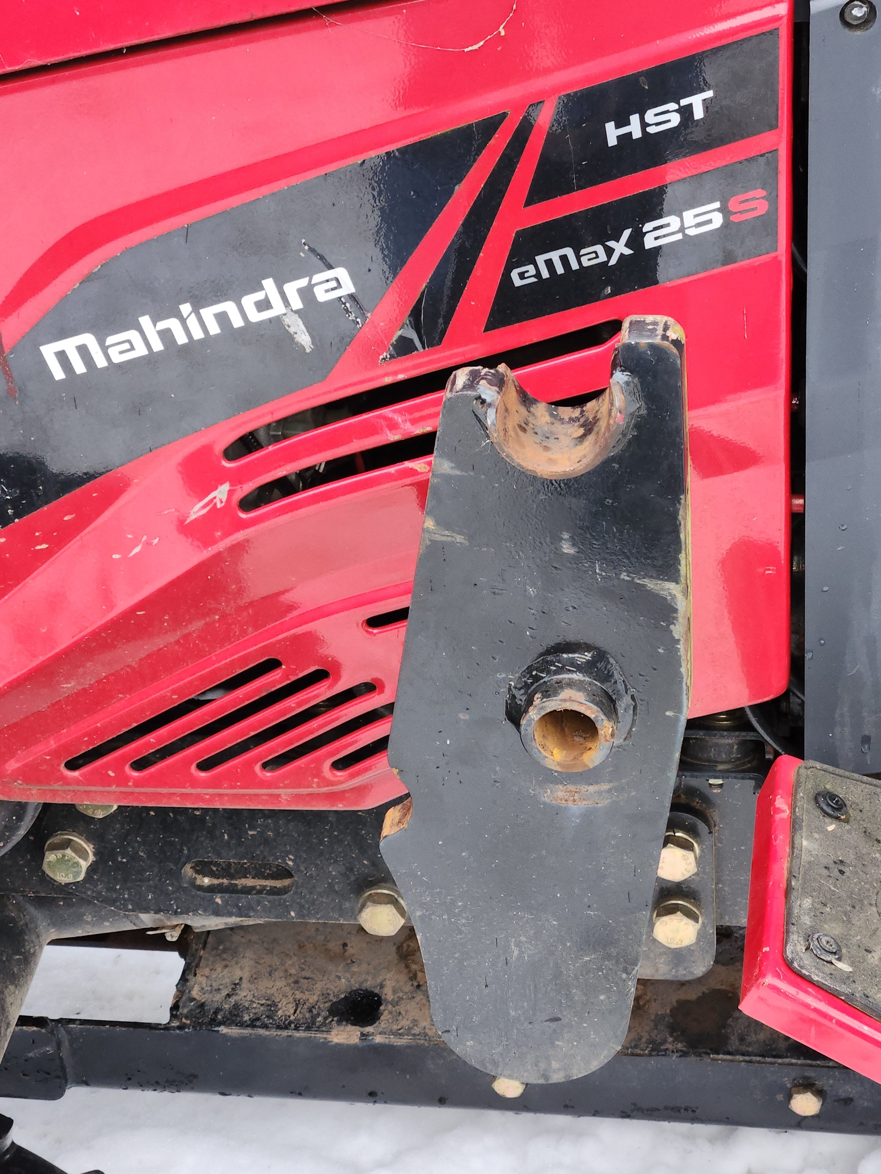

Little 9mm open end wrench fits the bolt on the left side.

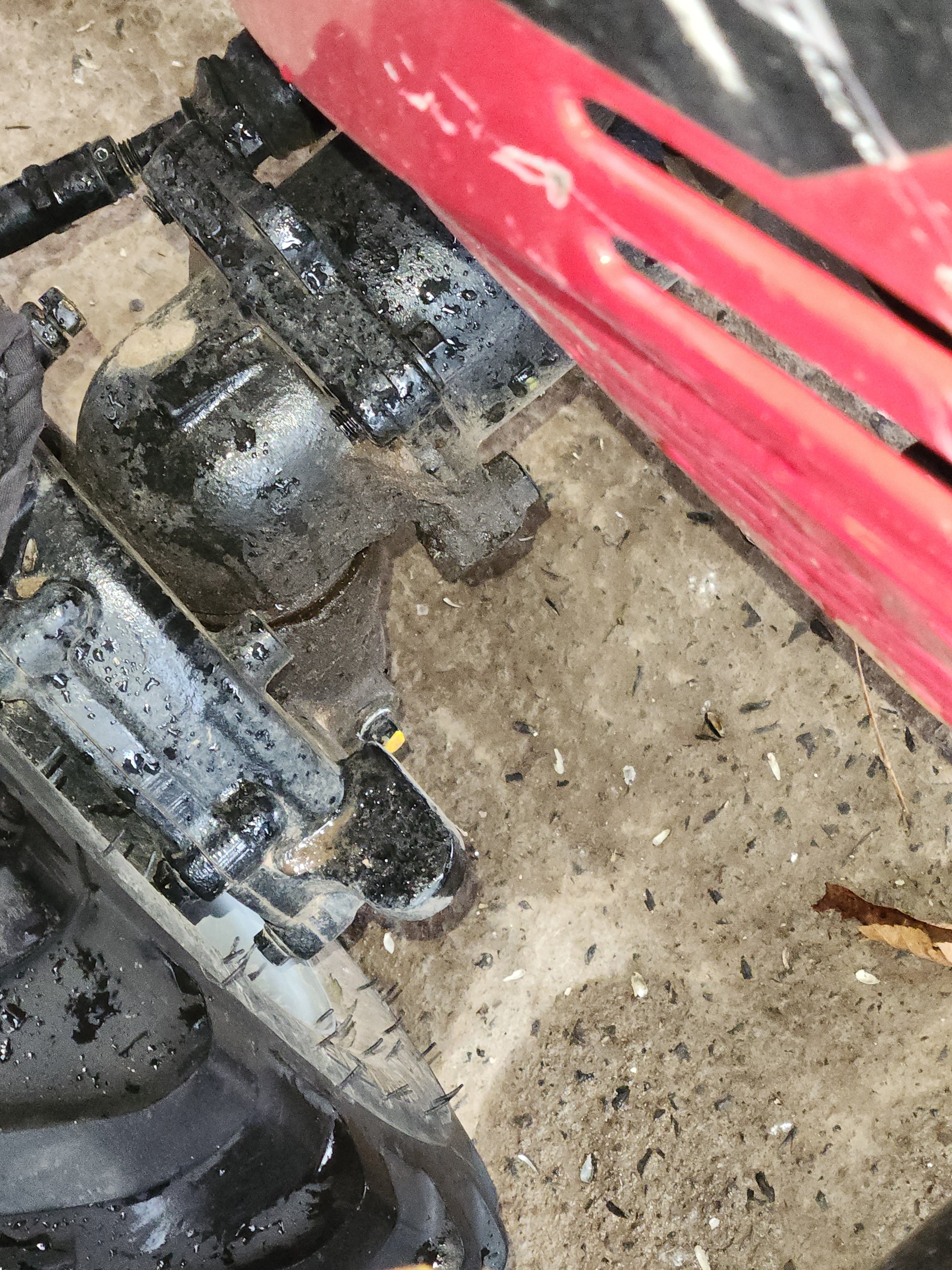

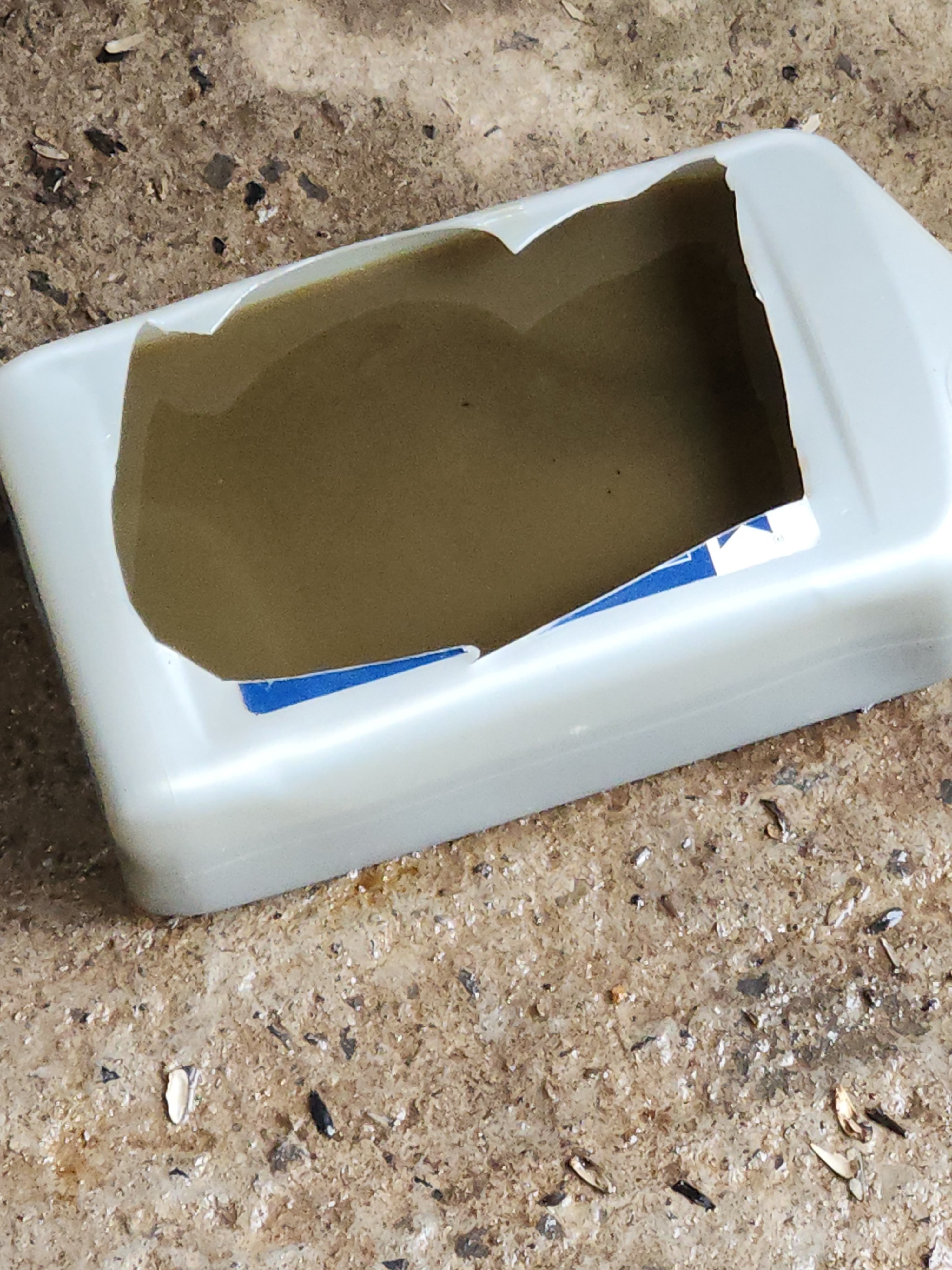

Some of the fluid drained out of the left front. I'd say there's water in there. The front right wheel was seized but from what the dealership told me, they are connected at the front.
   / 25 HST 4wd front right tire locked up in cold weather #14
Sometimes folks cleaning equipment with a pressure washer blow water in past seals
and other places it doesnt need to be
Edgar

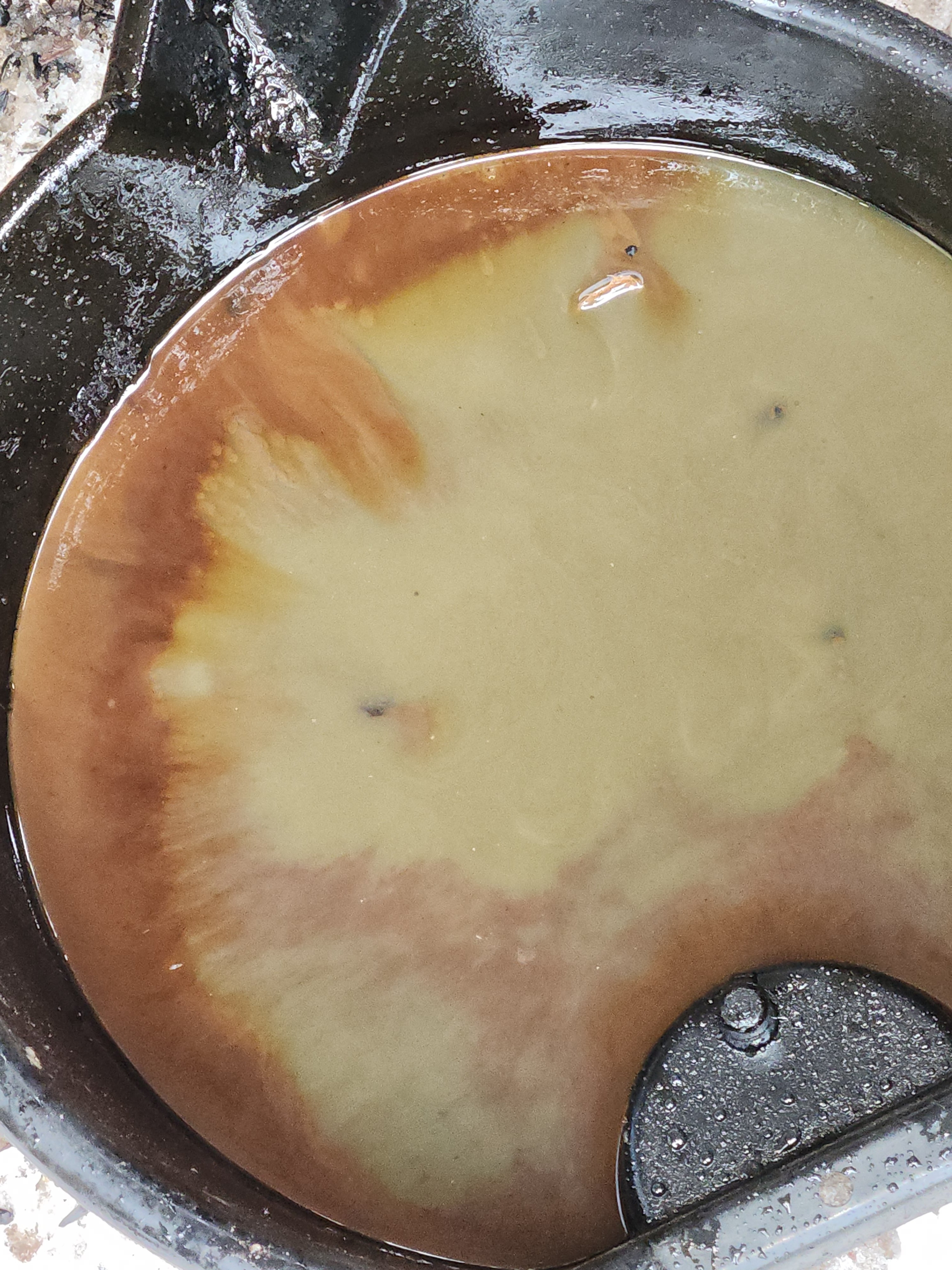

This is a larger container that i put the front axle fluid into. You can see the contrast between the brown edge (which is oil from vehicle oil changes) and the chocolate milk color of what is coming out of the front axle.

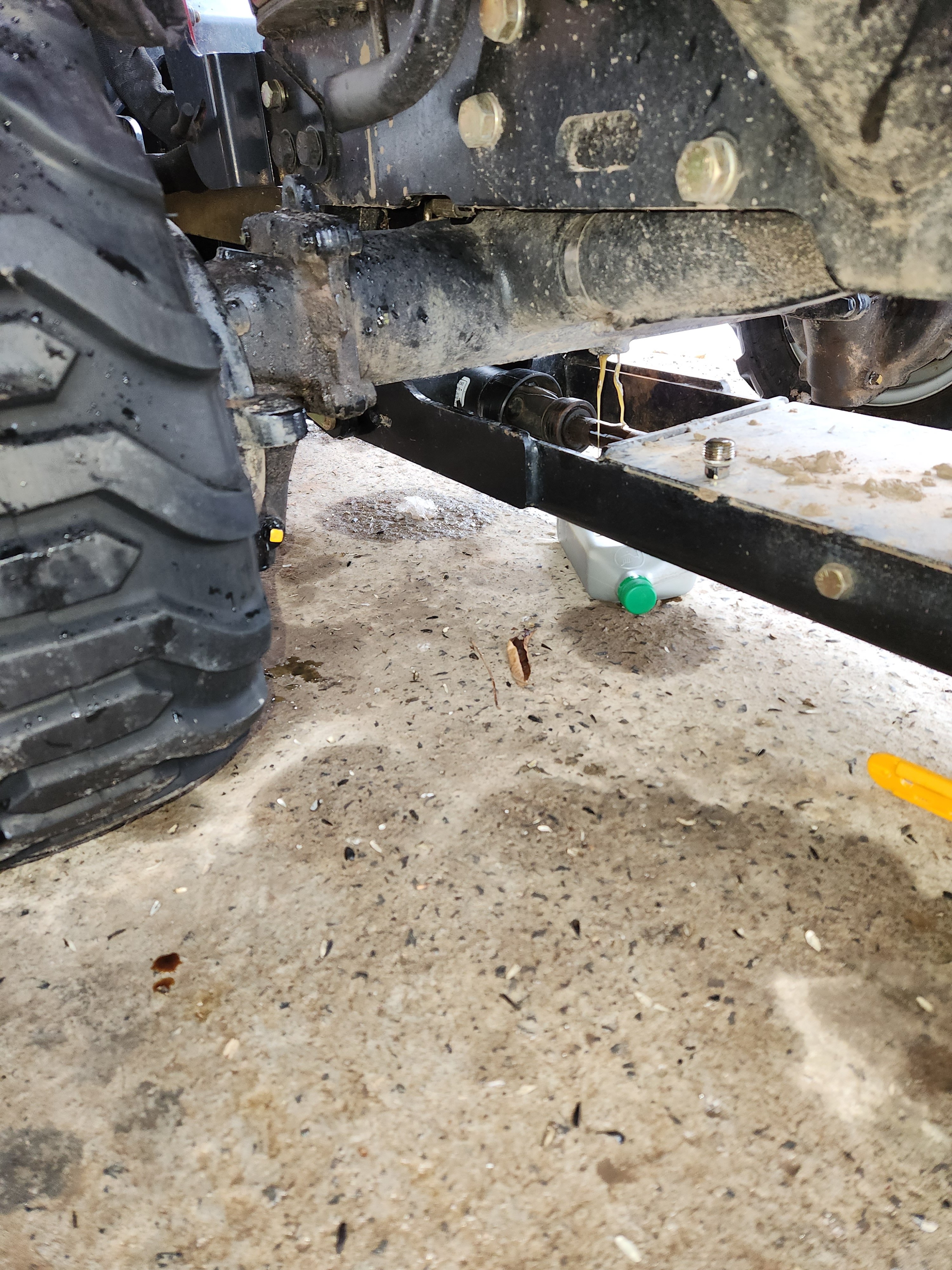

14 mm bolt in the center of the front axle. It was on tight! I assume this is metric. The reason why I say this is because my elcheap harbor freight open end wrench had a loose grip on the bolt. Definitely chocolate milk coming out of the center!

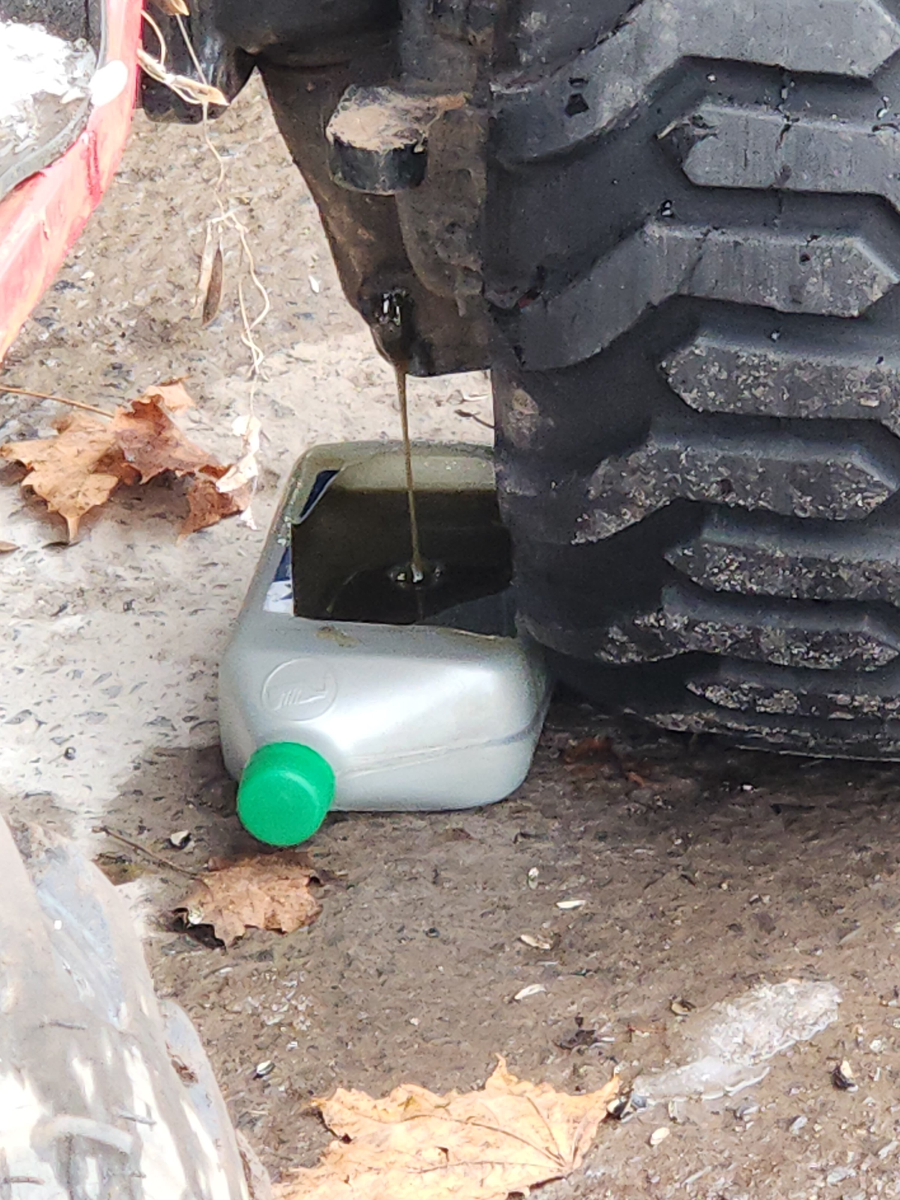

Finally opened up the front right 9mm bolt next to the tire that was seized. Pure water initially came out. That was the issue. Next time I have it serviced I'll ask the dealership how the water got in there. I, myself have never pressure washed it.

Most of those aluminum castings draw moisture from temperature changes add in heat from using it in 4wd it will draw moisture. This goes the same for Hydraulic or hydrostatic these systems draw moisture. You had tractor since 2014 at 188 hours you need to change fluids annually or every two years if low hour usage to keep moisture from destroying unit. Especially true if unit sets outside. Nature is tough on machines.
