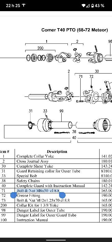

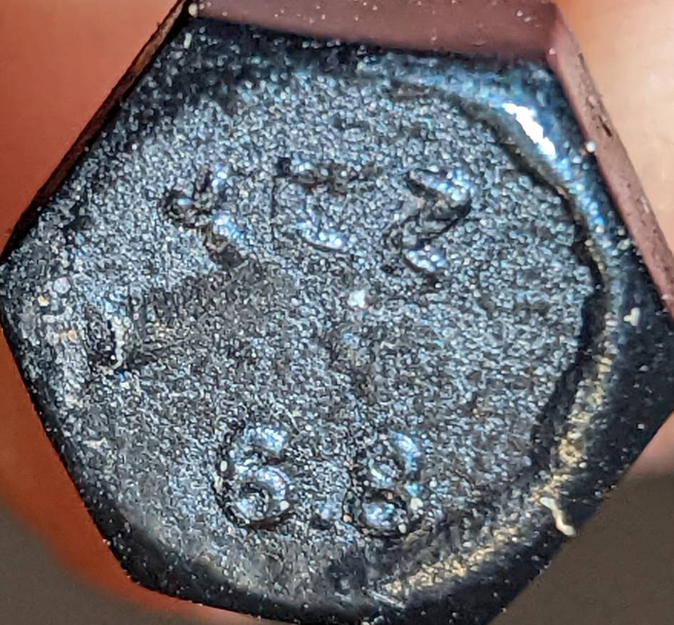

Hmm, not sure what to make of this. What seemed like 8.8 written on the sheared bolt head is actually 6.8 as shown on the picture below
But the PTO thought mentions 8.8 in the manual as shown in this manual screenshot.
   / 2nd shear bolt broken #6
I DEFINITELY see your point. I would suggest calling the manufacturer and see what they have to say. It could be that 8.8 is OK but I would want their input prior to going to the higher rated shear bolt or machine bolt.
Also - there can be a significant design difference between a machine bolt rated 8.8 and a shear bolt of the same rating. Be sure you ask if its OK to use a 8.8 rated machine bolt. It could be that they will recommend a shear bolt at 8.8 OR a machine bolt at 6.8.
This can get quite confusing. Some will tell you that the rating must be X but that there must be no bolt threads in the "shear area". Also - I've found that the true shear bolt( 8.8) can be a whole lot more expensive than a standard machine bolt( 8.8).
In my case - an approved shear bolt( 8.8 ) - $6.75 each. An 8.8 machine bolt ~ 1.50 each.
The good thing - you know that a machine bolt rated at 6.8 will not cause damage to the tractor PTO system or the blower.
Both shear bolts were very easy to access on my blower. So - I went with a grade 2 machine bolt on the blower and a grade 5 machine bolt on the PTO shaft. Had a bag of both on the tractor and went on my merry way using them for 27 years. The setup for the shear bolt on your PTO is exactly the same as was on mine.
DO let us know what you find out.

I guess I'll have to call tomorrow. They are in Ontario and it's a Family day holiday there.
But found this further down the manual, so twice there they mention grade 8.8 for the PTO shear bolt. Don't know why the original was a grade 6.8...

FWIW,I've never seen a 6.8 bolt thread.
4.8,8.8 & 9.8,but never 6.8.
I have to wonder if the bolt head is poorly stamped?
Good Luck!
Yeah, if you look at the posted picture, there is like a dimple on the left side between both halves. That's what I thought it was, 8.8. I'll get confirmation from them today.

Gave them a call. They confirmed that it's an 8.8, so that 6.8 is a misprint.
Now all I have to go get are grade 2 1“ 1/4"D shear bolts and locknuts for the auger.
