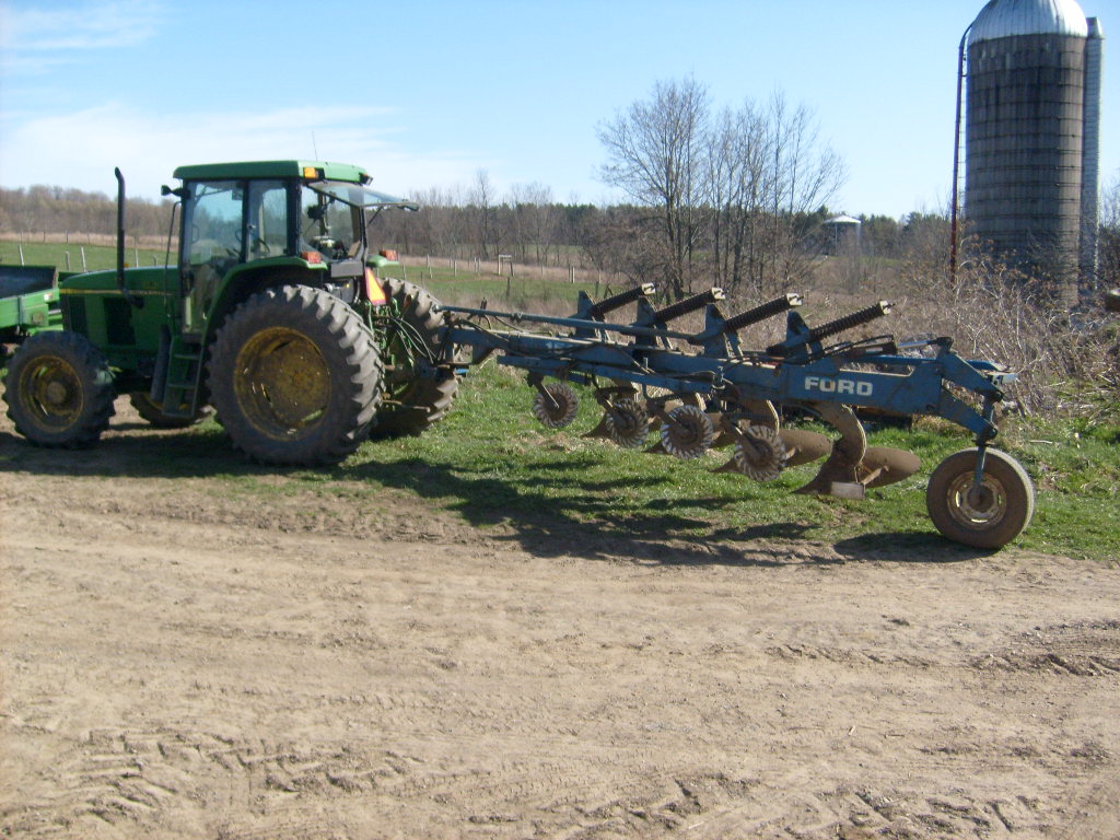

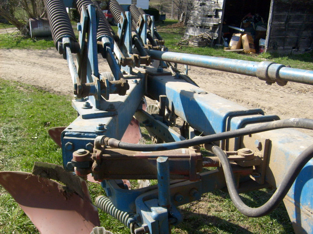

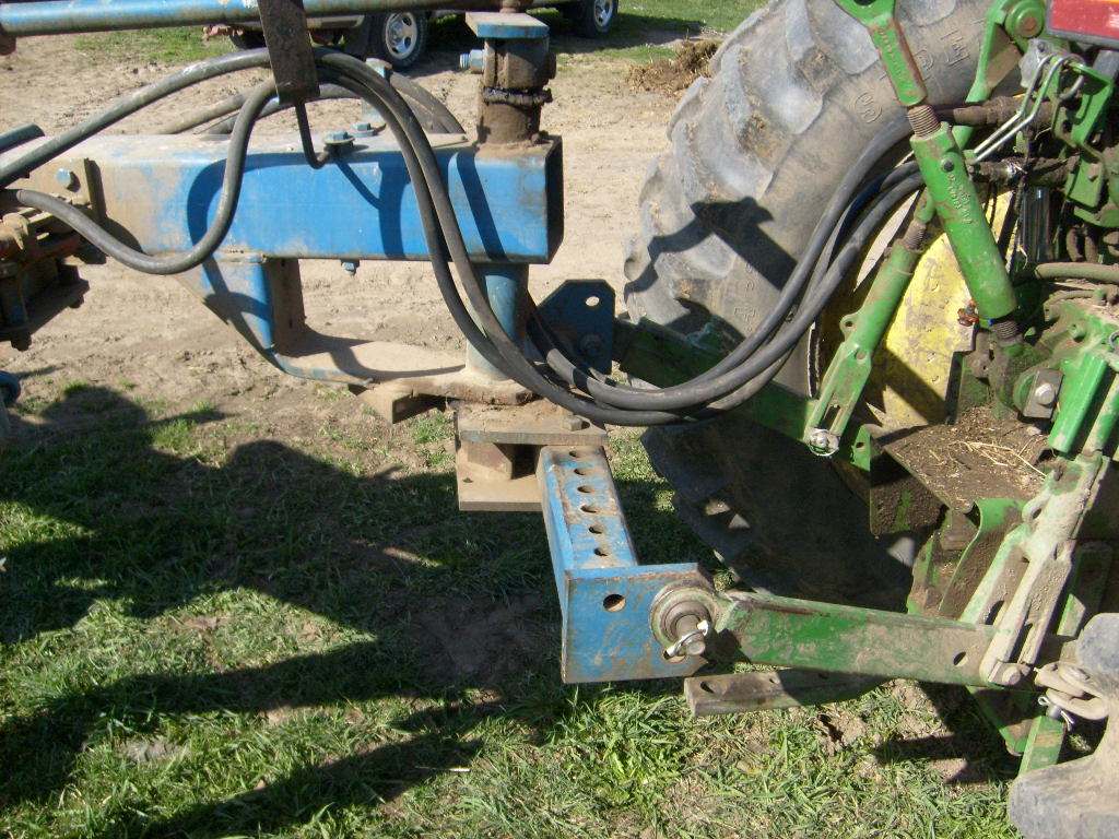

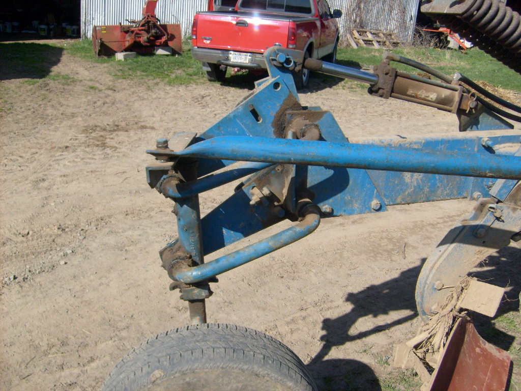

Here is the plow rig I use. It's a good friend of mines equipment, but he let me find it for him. 1st it came down to a Deere 7000 series tractor or a Kubota, at the last minute the dealer offered us this 6605. I found the plows for him a few weeks later. The only dislikes I have with the plows is they are not trash friendly and the sidehill shift pivots the frame instead of sliding the hitch. Other than that, great plows. These are the same as White/Oliver, etc.
We had Deere plows before, as Farmwithjunk stated, they pull hard. For a time Deere was actually putting Kneverland btms on their plow. Don't know if that is still an option or not.
The 2nd picture shows the tail wheel. It had a double acting cylinder, the depth is set with a stop bolt.
