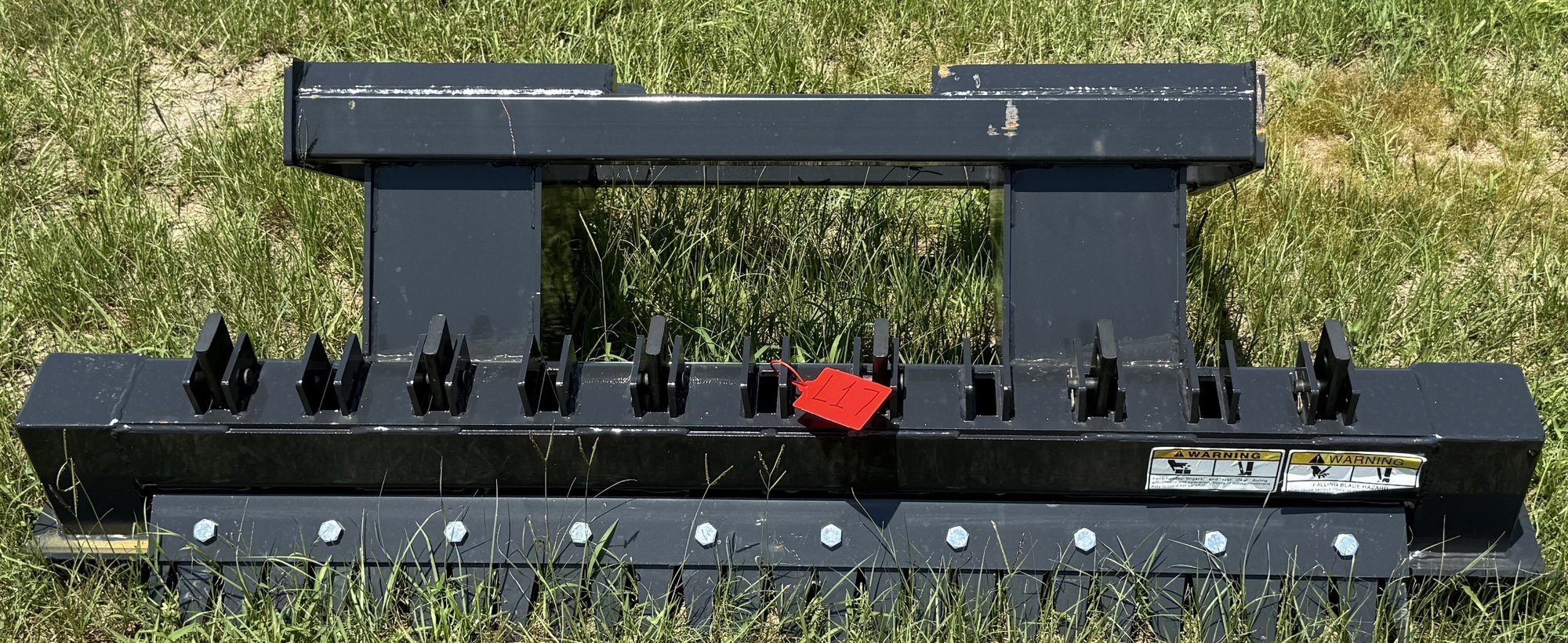

Ok heres my question. I bought a 3pt hitch catogory 1 hitch, I haven't put it on the tractor yet because the hooks where the implement pins will insert seem to large. Do I have to get some kind of adaptor sleeves to to make these fit? The instructions state to make sure all connections are tight befor using. I bought it used at an auction so there may have been sleeves with it when it was new but they didn't come with it. Any info would be helpfull because I have never had one of these before.
Here you go.. yes you will need the bushings. shown on this page.
Agri Supply - Search
Look around you may be able to find then cheaper elsewhere, now that you know what you are looking for.

Tractor supply has the pin bushings too if that is more convenient for yoo. Although I use some (maybe most) of my attachments with the Pats without bushings and don't have a problem.
   / 3 Point Attachment Switching not enjoying. #48
Or you could just buy the Speeco. It has the proper size hooks.
