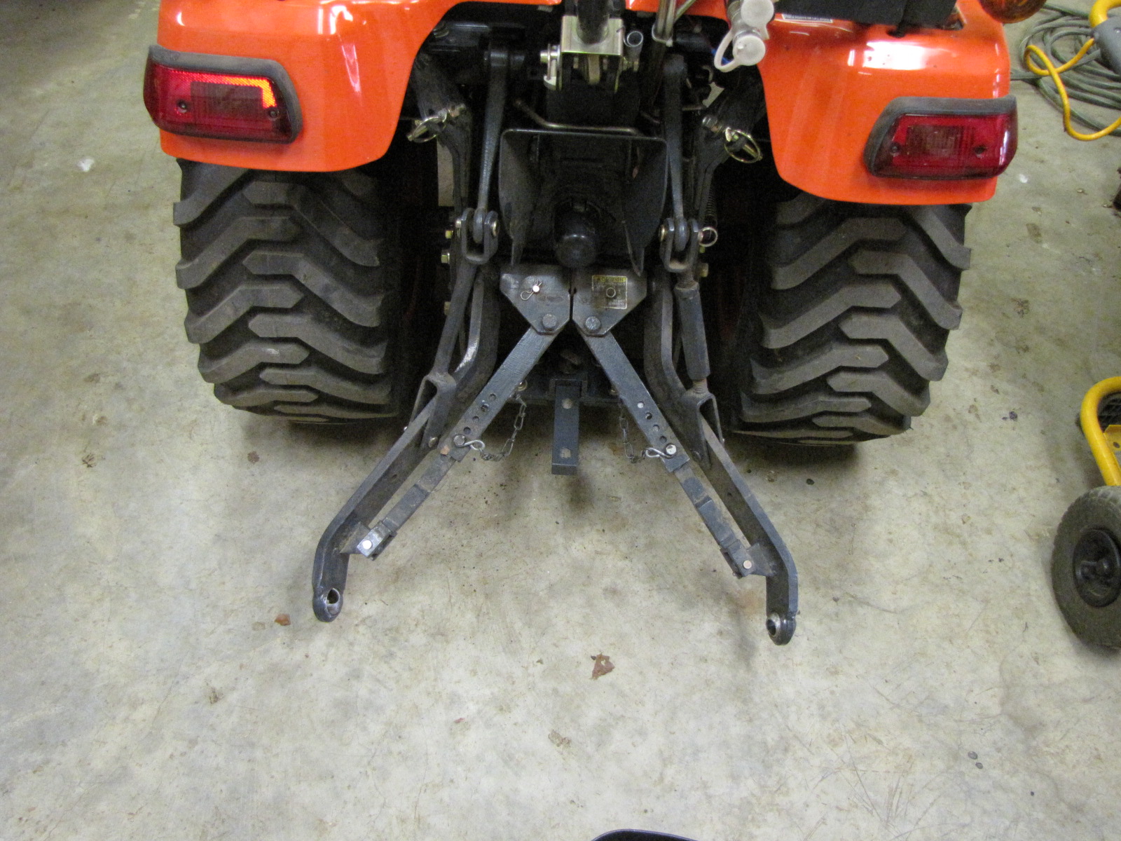

Glad you got that figured out. Looking at those turnbuckles...I don't think I would like them, either.?? Do they "dangle" when you have them loose.??...I think Not.??
Like I said before, my carry-all is a bugger to hook up. Part of the reason is that once you install your planking of wood it leaves no space for the 3pt. arms to go back beyond the pins. I know, it's hard to explain.....
In your last series of photos look at the first frame. Look at how your 3pt. arm (the very end) is flush to the frame of your carry-all. Now, imagine your carry-all with the wood in place. The arm is going to collide with the wood, leaving no wiggle room to hook up.
The thought just came to me to leave a void in the wood where the pins are.
Does anyone understand.??:laughing:
My carry-all is the lightest attachment I have and it is the worst gosh darn hook up that gets to swearing everytime. I'd rather hook up my snowblower, as I mentioned earlier in this thread.
Kyle, it is important to understand the turnbuckles. When you get a heavier attachment on there you'll want to be certain that the attachment will not "sway" into your tires. A bit of sway is good in most cases, but keep it to a minimum....say no more than 2 or 3 inches of sway. (or less).

The turnbuckles do not dangle, they are rigid. When I was taking the pictures I was thinking the same thing about there not being any room to hook up the lift arms...About it swaying, I watched a video earlier and the guy explained all about the swaying...

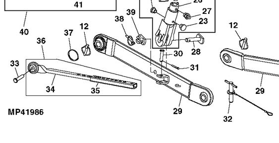

This is what I did. I hate the turnbuckles. I'm making the adjustable side links now.
