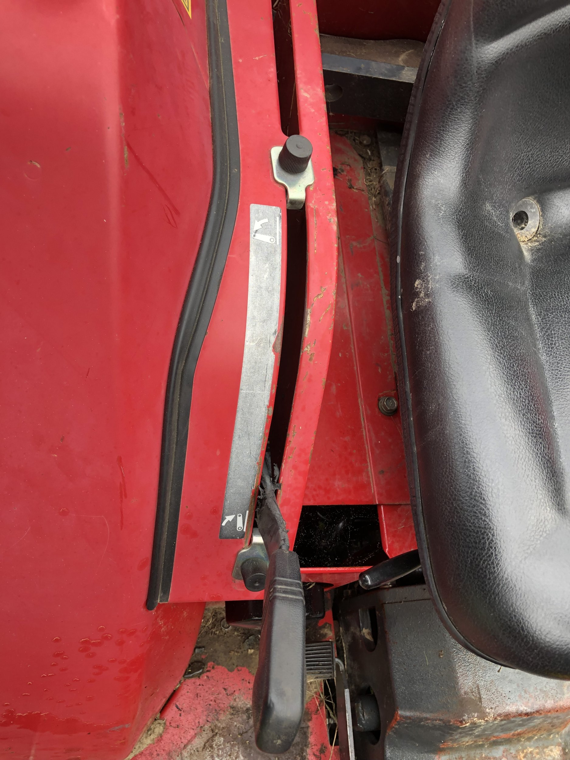

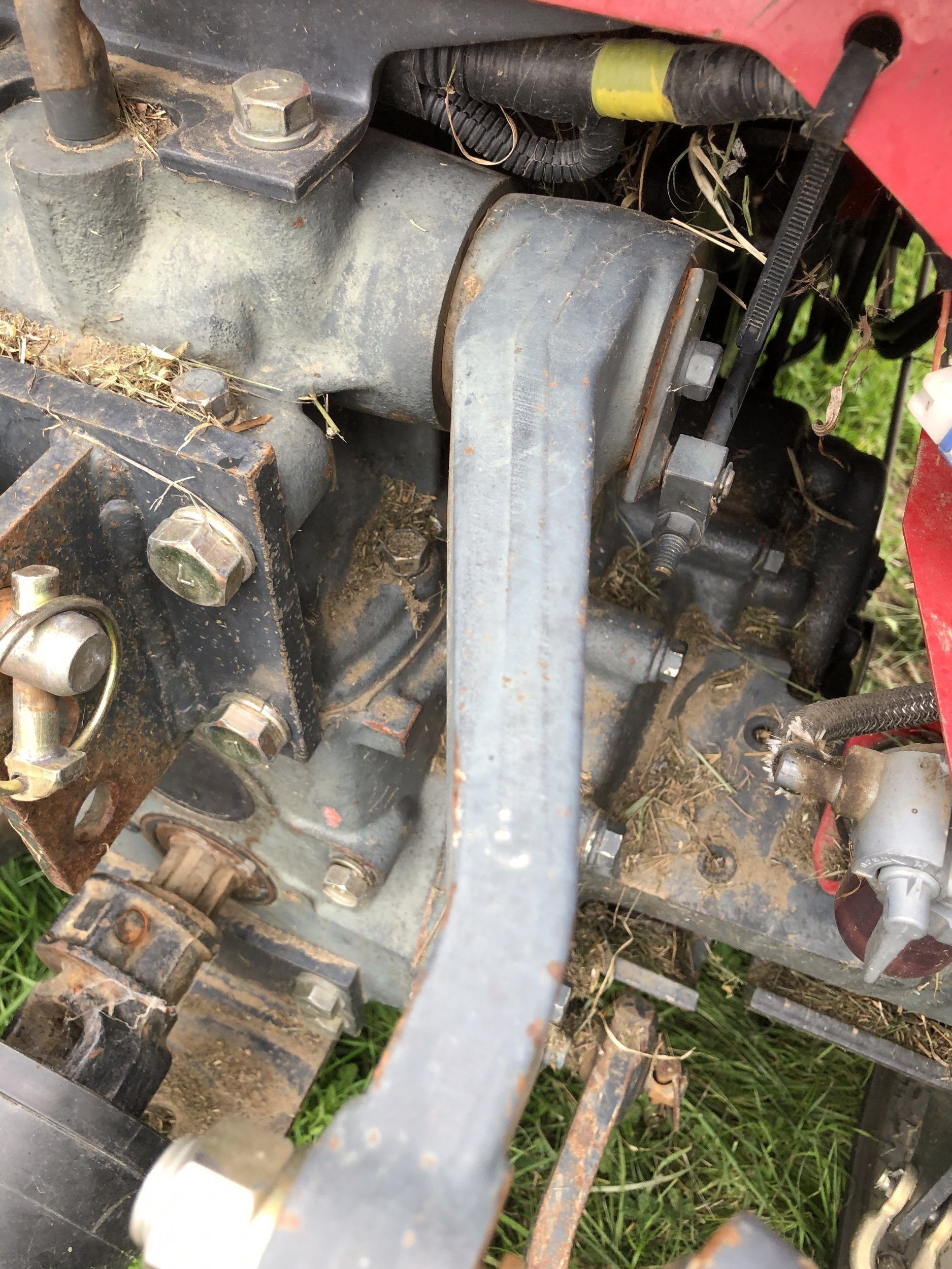

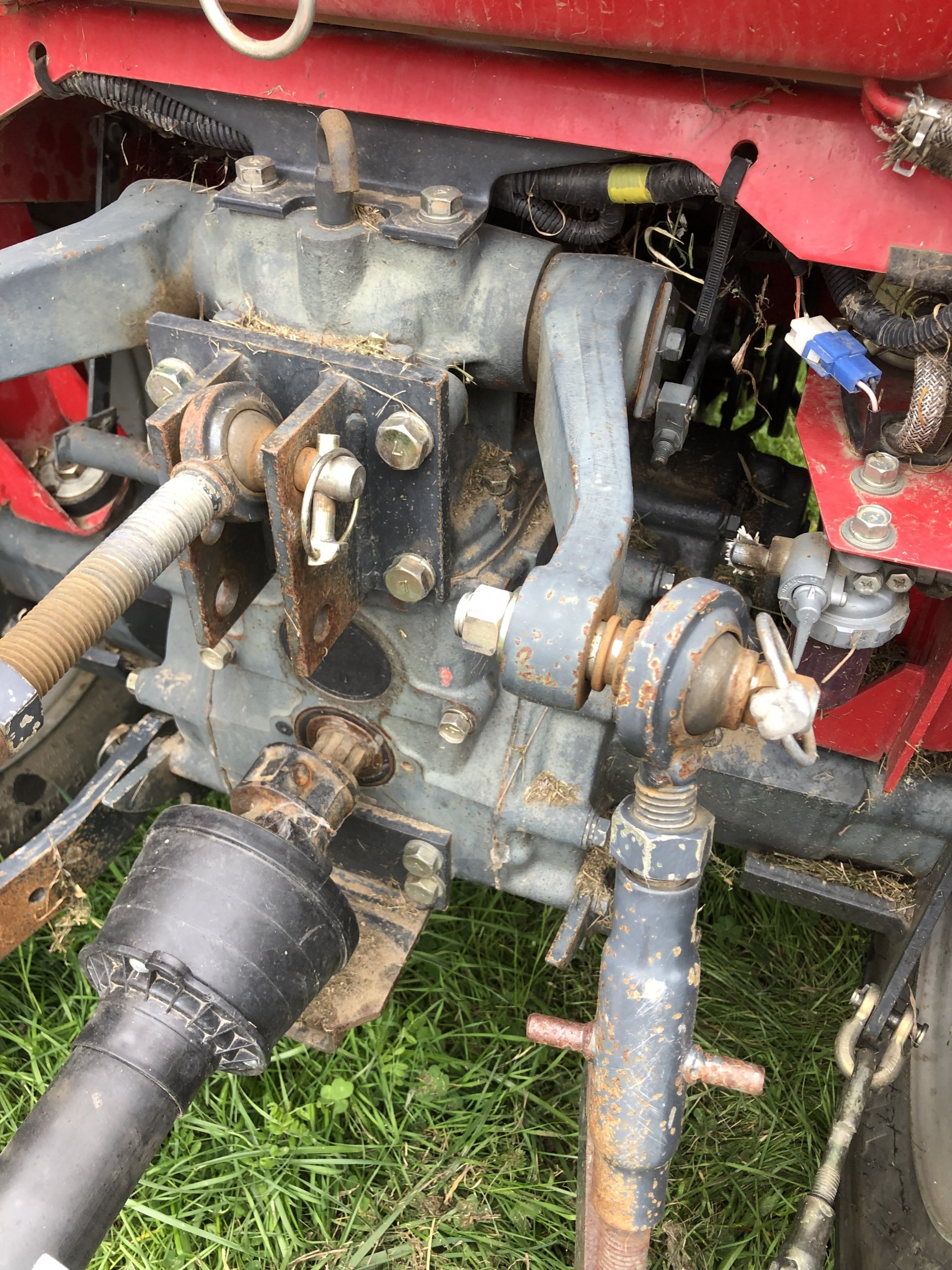

Can you post a photo of your tractors rockshaft(3pt) control handle in the lowered position? I'm curious if your tractors 3pt linkage has a feedback rod similar to my Kubota
   / 3 point Hitch won't go all the way down
Here are some pictures of the rockshaft in lower position. There seems to be a feedback rod on one arm, I have never adjusted this rod before, curious to hear what your experience has been with this part.

Have you tried it with the PTO shaft disconnected or ensured your PTO shaft moves feely throughout it's full range of motion?

You're manual should tell you where that rod should be adjusted at, it could be related.
#9
I had a three point which wouldn't go down all the way. I found a stop clamp on the three point control. After I moved it to the end of travel I could move the three point lever further and the hitch complied by going down further.
Thanks for your reply, all my stop clamps are locked on both extremities (see picture above) so it is not the issue.

If it were me, before messing with anything on the tractor, I'd take the attachment off the 3 pt and then see if the arms go down further with nothing attached. That would eliminate that at least. You would have to push down on the arms after the leer is in the lowered position.
