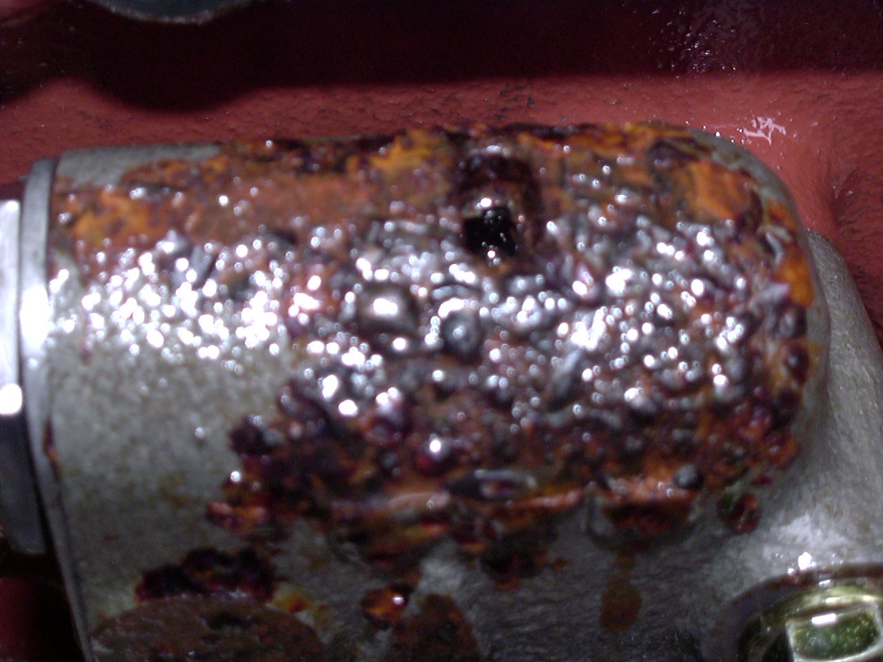

Yes, I'm now sure the rust is inside the top cylinder and parts.
Note on the pdf that the 2 #20's are o-rings in holes that expose the guts of the bottom 2 clyinders. What isn't shown in the pdf is the hole directly on top of the whole unit (#1).
Look at this pic and you'll find the hole that exposes the top clyinder guts (sorry, a bit out of focus).
The rust actually formed to block half that hole and I can see where it oozed onto parts #8 and #7 inside the top cylinder.
If this (top cylinder) can possibly cause my lift problem then I'm pretty confident it has.
Unfortunately, the rust is so bad that soaking alone isn't going to do the job. I'm going to have to take plate #10 off and clean the top clyinder parts.
The 2 #20 holes allow enough solvent (gas) to get inside so I'm not going to mess with taking those parts out.
Once I have the top clyinder parts cleaned and back in place I'm going to take your advice and spray WD in all the holes and shoot air inside as the final cleaning.

Yikes, the hole looks pretty bad. The casting of the valve assembly looks pretty thick. I hope it has not penetrated where #7 ( Hyd valve) is. Is your tractor parked outside all the time or was flooded at some time? Mine after 30 years does not have a slightest trace of rust inside. If the breather is plugged condensation during change of season can not go any where and trapped moisture can really damage. What surprises me is that the whole area of lift cylinder gets constantly sprayed with the lot of oil (I.e open center, live hydraulic)as long as the tractor is running. There should be ample oil film on everything protecting the metal from rusting. Well, I keep my fingers crossed, hopefully it won't be for naught and you won't have to get a brand new spool valve.

Yup... pretty bad!
I do believe it has gotten to #7 which I'll find out how bad as soon as I can get the 2 bolts and #10 plate off.
Yes, this tractor was (and really still is) a workhorse but my father died (original owner) in 1987 and this tractor sat out in the elements unused until last year (explaining why constant oil didn't protect the spool) when I needed it to build a Pavestone wall.
One of the country neighbors got it running last year because he wanted to borrow it to move some road base around. He put on (but Mom paid for the parts) a new battery, 3 FEL hyd hoses, fuel bowl and filter, hyd & oil filters, and new fluids. He had to drain off the fuel tank as well.
She fired right up! He used it for about a week then I went and picked it up and brought it to the city. The tractor has moved lots of dirt and Pavestones for me the past year but now I'm working on a picket fence for my home and needed the post hole digger.
In my use of it she blew another (old) hyd hose, leaked at the priority valve, and now this.
All in all... considering the abuse she got sitting in the elements for so long, I'm very pleased with her performance and I've found out there's nothing I can't repair on her (with your help).

Well... I finally got the one bolt off from the rusted chamber. The nut, o-ring and spring all look good. Unfortunely, the "unloading valve" is rusted to the cylinder wall. I'm soaking it in WD-40 right now but fear it will take something stronger to eat away the rust.
Any ideas???
If I can't get it out today I'll probably put it all back together and hope that the problem isn't caused by this piece. It doesn't take much to dissassemble the control valve and take another stab at it if what I've done hasn't fixed the problem.
BTW... NH said they don't make that control valve and the "unloading valve" is special order and $72. I understand that NH came out with a new spool valve so maybe my part number for the whole unit has been changed to reflect the new spool valve.
