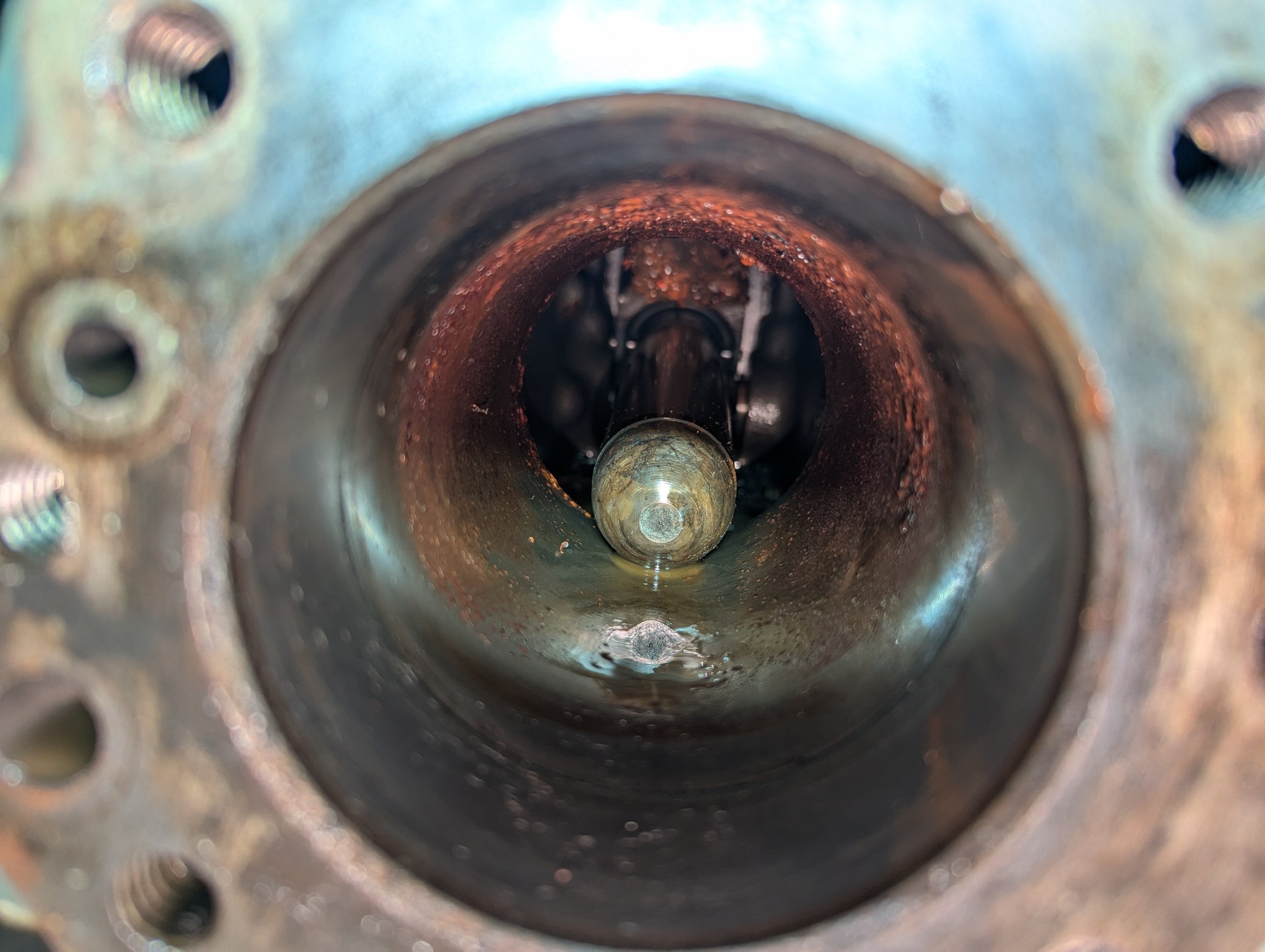

Pretty sure I figured out the problem, 3 point cylinder is rusty and the piston was stuck at the front of the cylinder
Looks like the problem. My Org.2000 The Hyd. fluid was super nasty when I first changed it! 1" that was as thick as Crisco in the can on the bottom of the pan. Water Moisture and whale oil............
