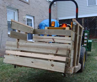

I bought mine at TSC, the smaller, non-dump one, for about $92. I bolted a pallet onto the bottom and some wooden "standards" around the edges into which I slid 2x4s for the sides and back. Bolted some 1bys to the vertical part of the L-shaped frame, which is predrilled.
Attached are a couple of pics. The back side has a couple hinges to allow it to be folded down mid way.

Nice modification. What do you think your capacity is??

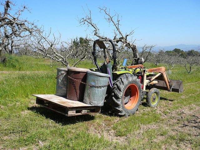

In another carryall thread I described a rear carrier I had just built, showing the design.
http://www.tractorbynet.com/forums/attachments/94866-pallet-forks-rear-3-pt.html#post1076414
Here it is again, decked with a pallet and a sheet of plywood, hauling water down to some new trees.
Lifting capacity: I tried five 30 gallon cans of water on the pallet - the hydraulics couldn't lift it but it didn't hurt the forks. Four, likewise. Finally 3 cans (about 750 lbs including the forks and pallet) lifted easily and off I went.

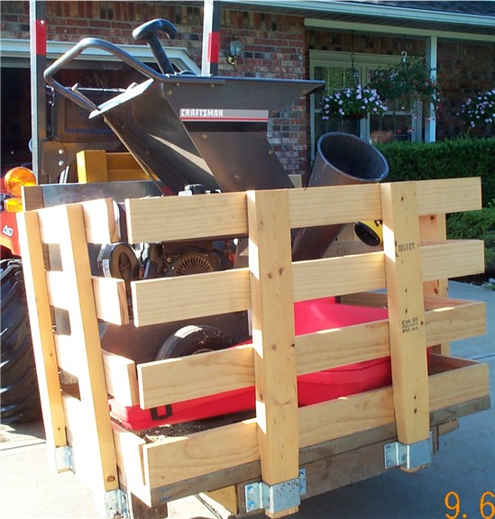

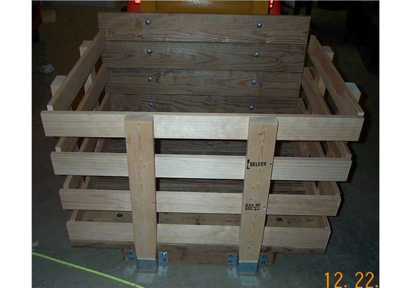

Here is another TSC version. Very easy to build and a very usefull implement.

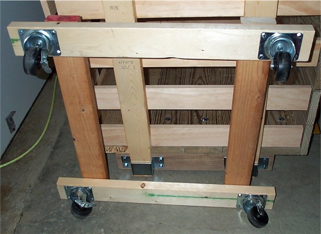

I just put castors on the bottom of the pallet structure that I bolted to the carryall. Don't need a dolly.

Attaching the casters directly to the carry all frame is a good idea in most instances. I originally had casters on the frame but they raised the platform a couple of inches. In my case, one of the primary uses is to transport my chipper/shredder from site to site. The two inches of extra height made it harder to get the C/S on the platform and also made it harder to operate the C/S once I got to the site. Another problem that I had was that the casters were always getting caked with mud. I probably I could have resolved both problems by recessing the casters a bit. Casters or no casters I think the carry all is one of the most usefull implements that I own; and least expensive also.:D
