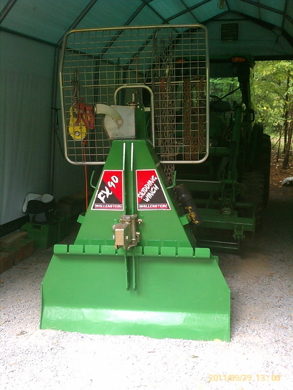

They are all good but you can't beat a Farmi. Here is mine on a tractor your size.
