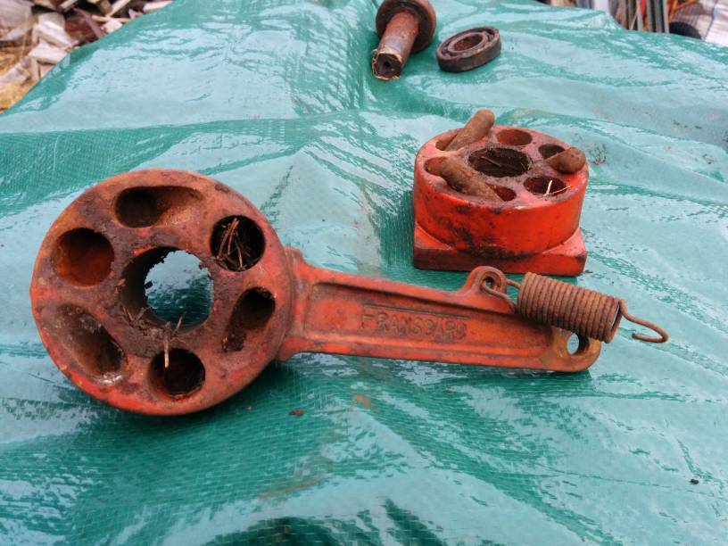

Thanks 52wej. That U.S dollars. That would be $3500 Canadian. If that's a cheaper price the others are pretty expensive. Just wondering how the clutch works in them? From exploded assemblies i see that they have a friction plate on the spool and one on the chain gear/cog that's rotating by the pto but I'm not sure how they come together when you pull the string. same as your standard vehicle or some other way.....

Very simple construction that pushes the spool against the large cog wheel, some has a nailed/glued friction plate, some has friction pads on the cog wheel. All brands are very similar in design on the clutch.

The engage system on my Fransegard winch

I kinda figured that's how it works to a degree. But I didn't know if it was possible to be able to torque enough to make a good contact between the two clutch plates. I'm amazed it doesn't slip easier under such forces. I didn't know it was on little twisted roundstock type set up. I was thinking two bushings cut at a taper so when you try twisting one relative to another one has to slide axially, pushing the spool into the chain sprocket. What keeps them apart, spring loaded or they naturally separate as one would be spinning at all the time. (chain sprocket.) Also, in your pics you sent Avgv, its hard to see what is there for a chain tensioner. Their rare hear. In fact, I don't think I have ever saw one on the island here. I heard of one guy that had one I believe. So no way for me to look at one.

Yeah I see it but it looks like steel the chain is riding on......the tensioner looks like it's a steel round billet putting tension on the chain. Also, does the spool just slide back and fourth when using the clutch on the shaft using bushings? Thanks for the pics
