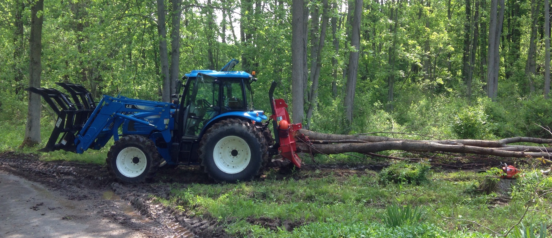

I'm no logger but my thought on the subject would be not letting them dig in the ground, seems like that would waste a lot of fuel, I kinda pictured getting the front off the ground a little? What about a logger duty boom poll, the reason I ask was because I thought about pulling tops out of woods and feel I would buy a boom poll to lift up a little rather than drag dirt with the logs.
If you are winching over a distance and/or uneven terrain, the log can dig in. When you get the log(s) to the winch you do lift them for transport. Some winches you can pull from the top pulley and that lessens the chance the log digging in.

Especially when the logs weigh over 2,000 pounds ea. and are being pulled through soft ground!

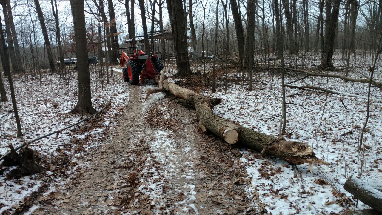

Of course, we all do what we gotta do, and I've dragged logs through some stuff that I probably shouldn't have myself, but today reminded me why I love cutting wood in the winter. Just a skim coat of snow over nicely frozen ground. Just perfect logging conditions.
I didn't have a ton of time, but I skidded in this elm log that I dropped on Friday, along with a few other sticks. rps20161210_231136_260.jpg
The winch is a Farmi 351. I bought it because it was just about the only used winch in decent shape that I ever saw. Didn't give any consideration to brand or features. :)
