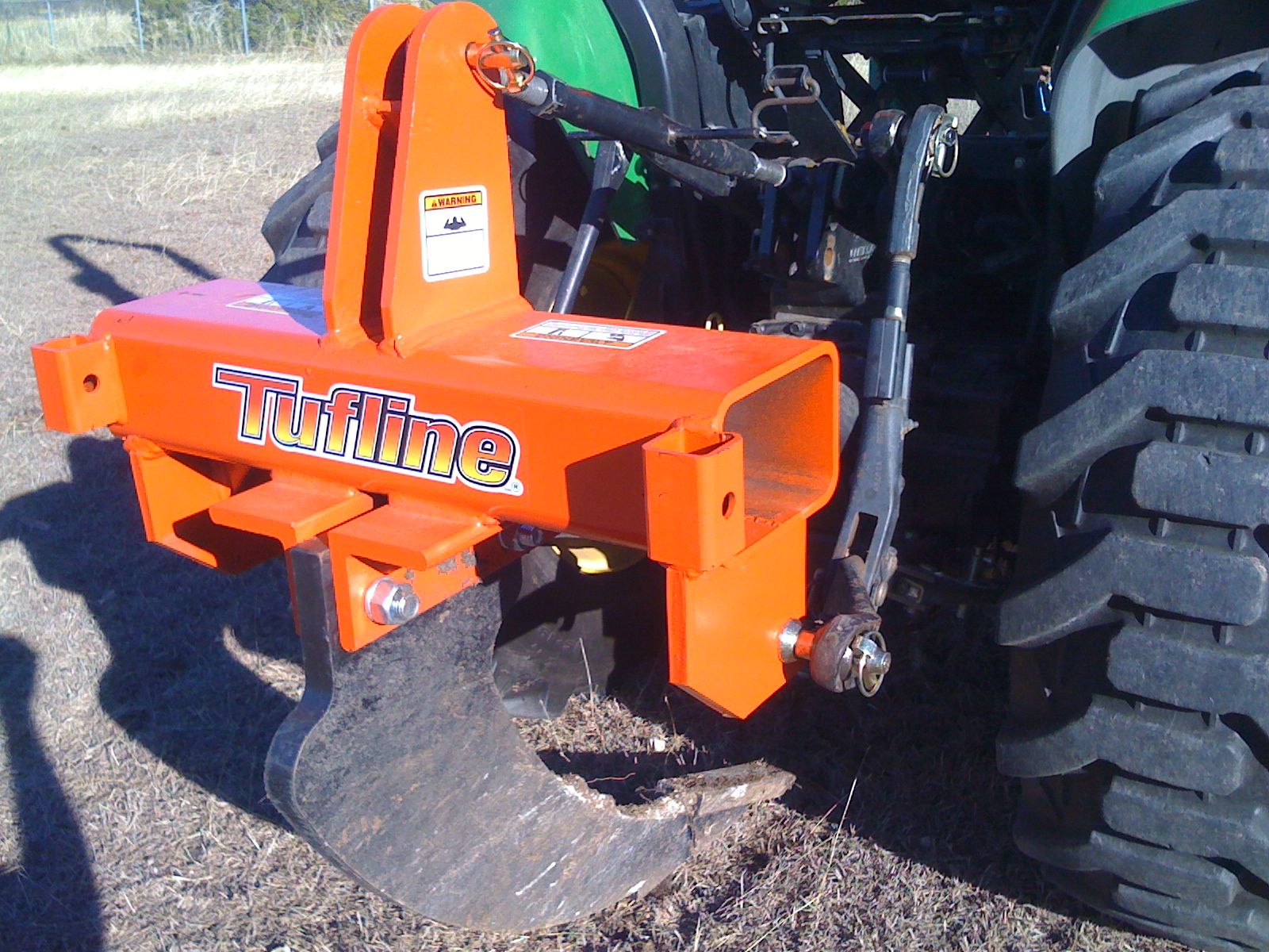

It'll take some grunt to pull the Tufline, even the single shank. I pull the two shank with my 7610S NH and the diff locked, and can still lose traction in the right ground.
Very true!
I have a JD 3520 (37hp, around 3700lbs with FEL) and pull the Tufline 24" single shank with lots of effort. I've read that the curved shape of the Tufline sub actually makes it easier to pull through the soil. I can only pull it at max depth in MFWD, and only when the soil condition is optimal. I need more weight. :)

How deep are you going with this and what type of soil do you have?
Max depth is around 18-22 inches and soil type is medium/heavy clay/clay loam. Here are a couple photos:
